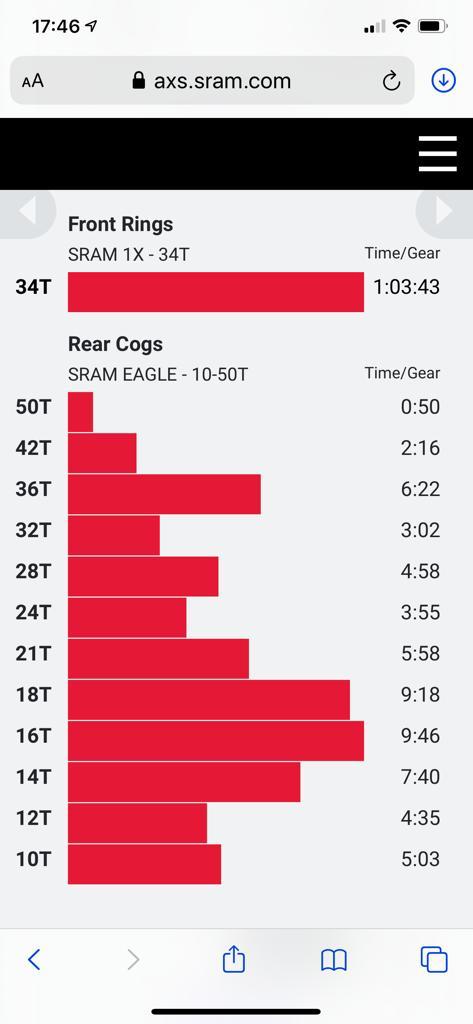

Installed Eagle Axs on my decoy as a replacement for the the e-13 cassette and di2. Nothing wrong with di2 but the cassettes from e13 are not good had a replacement and that was equally as bad, can’t knock e13 on warranty but their recent cassettes just don’t work.
Bit the bullet and upgraded to Sram eagle axs and not had an issue, the system runs almost silent and shifts soooooo well.
using the app it connects to Garmin 1030 (not lower models) and sram app outputs the data shown below.

Yes they are any+ but only compatible with the 1030 which I found out to my cost?!?! Gives a full screen showing selected gear etc. The sram app is cool to
I have my AXS displayed on my Edge 830, and used to have it on my 820 before I upgraded.
Can get a report of how many shifts you’ve made during the ride etc. I just like having the number of the gear I’m in on the screen - it’s like having the old indicators on your shifter!!
