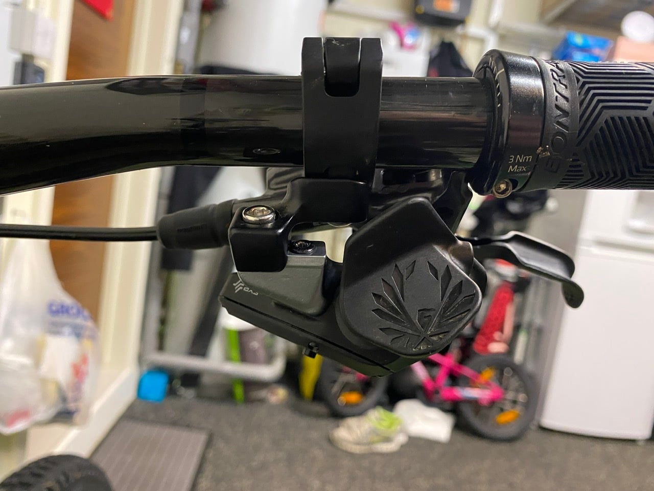

I looked for adapters for matching XTR BR-M9120 brakes with SRAM shifters, but a couple of months ago Problem Solvers said they were in the process of designing I-spec EV MisMatch adapters and expect them to become available summer 2020.
Does anyone know of another company making adapters?

Spotted another, but they're in the US
ShiftMount
MM-ISEV is for a SRAM Matchmaker shifter mounting to a Shimano I-Spec EV brake
[edit2]
Found them in stock in the UK too and ordered one :)

MM-ISEV is compatible with but not designed for SRAM AXS. With SRAM AXS the shift lever will be further towards the end of the bar, or closer to the rider's hand than is ideal for most riders.
Not really for AXS the the adaptors on the Mondraker that has the AXS shifter and Dropper remote are not these adaptors .
also the wold tooth is right shifter only so no good to me as need both right and left having the AXS reverb .

BUT ...i have actually found what they use with a lot of diggging about and looking at close up pics of the AXS/XTR set up . ..
and so far only one seller i can find on the web that sell them ..
35 Euros delivered to UK.. a bit expensive but they are the only sellers of this .. and im 99.5% these will fit perfect and what im looking for .
3min19sec Matcher I-Spec EV Adapter
Thumbnails is what silverfish gave me .. thats all they gave me as they have not got any part number for the adaptors .
looking at angles these are 95.5% the ones !! fingers crossed .

I ordered the same 3min19sec adapters for my bike (standard sram and xtr) after receiving the wolftooth adapter. They arrived yesterday and Imho they're better quality and value compared to the wolftooth mount.

The bike I’m going to collect on Monday (Trek Rail 9.9) has Shimano XT M8120 and SRAM AXS / Reverb.
Is the 3min19sec pair what I need? The less clutter on the bars, the better!

As far as I can tell for the left side, yes. I like my shifter close to the grip so the Wolftooth worked for me on the right and a standard Sram clamp fits between the mount point and extra bump on the new XTR brakes so I have my dropper fitted that way.
Interested in these to get rid of that clamp though.

@flash looking at the options at Wolf Tooth Shiftmount which option did you get?
I got the MM-ISEV. They don't recommend it but it works great for me.

Anyone know how to get one of the 3m19seconds adaptors to the UK? Bike Components dont ship here any more...
Hi Rob,
TFtuned have some that look very similar to the 3min19sec ones

Nice one. Might not have any choice but to pay the 14 euro shipping!!

Even better! Ordered :) Thanks for this!
