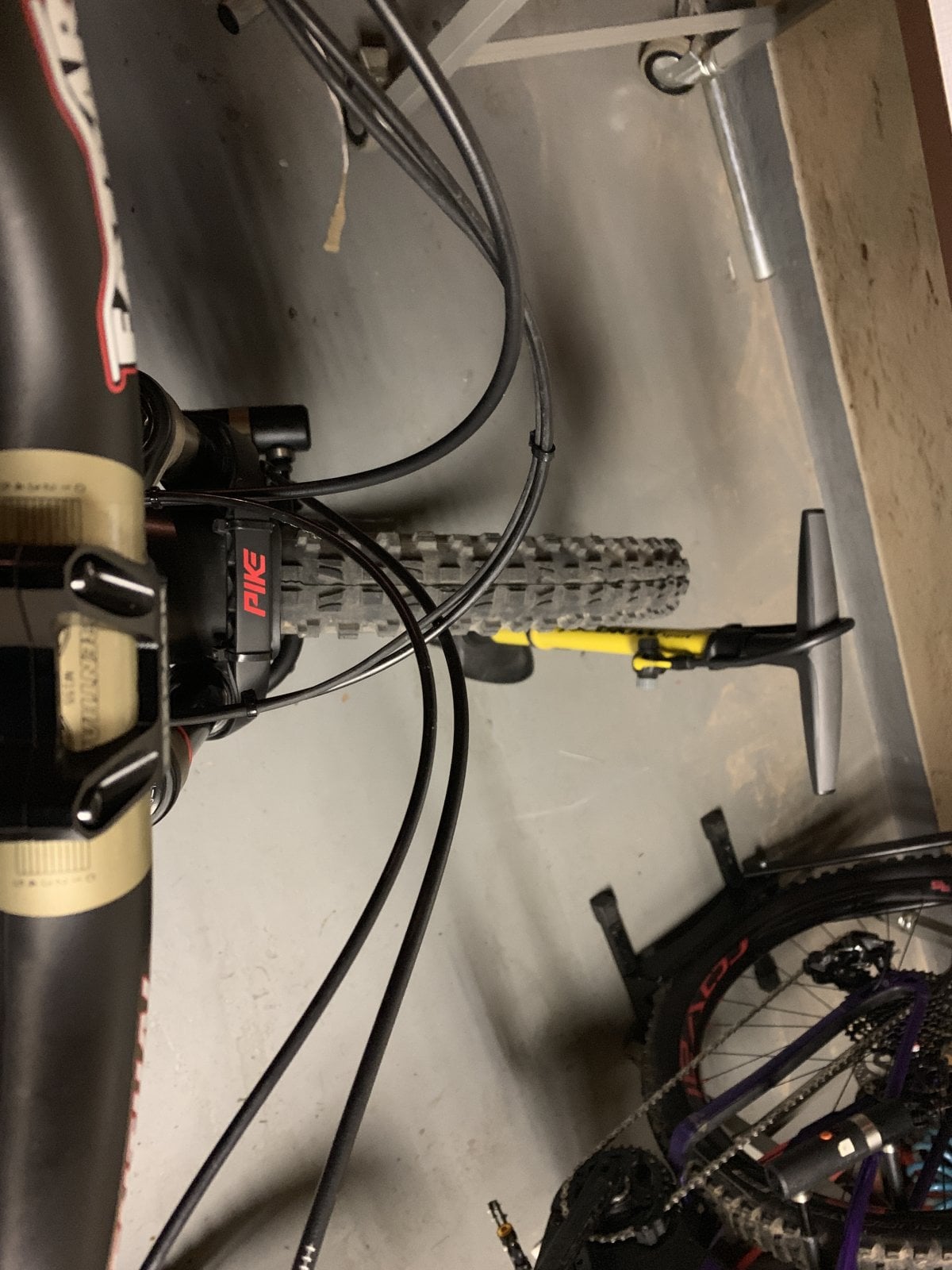

Your suggestion is actually rather good regarding the handlebar but I’m already seeing my front axle in front of the handlebar by a good measure so I have plenty weight on the front end.
Wife is already very happy about her Levo(Fox 34 Factory) and I can afford the Lyrik but again, I would not buy if it did not make a difference ;)

Er axle in front of handlebars means you are back not forward, axle behind bars means you are forward.
I always aim for axle below the bars ( cant see axle) when im riding seated
Well seems to work for me
Er. No. It is the other way around. By all means sit on your bike and lean forwards then backwards if you need to. ;)

Dave,
This is how I see axle, if behind bar I have to literally sit on the rear wheel. The more you move to the front, the more the axle will be ahead from my perspective. When in attack position my axle is just under the bar.
