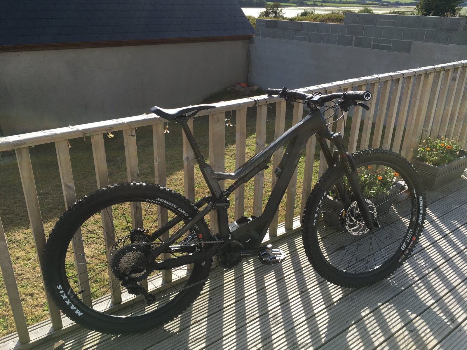

I know it’ll be over stealthed for most but my bikes always end up looking like this. It is what I like.

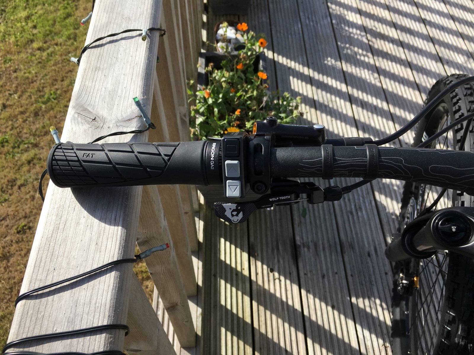

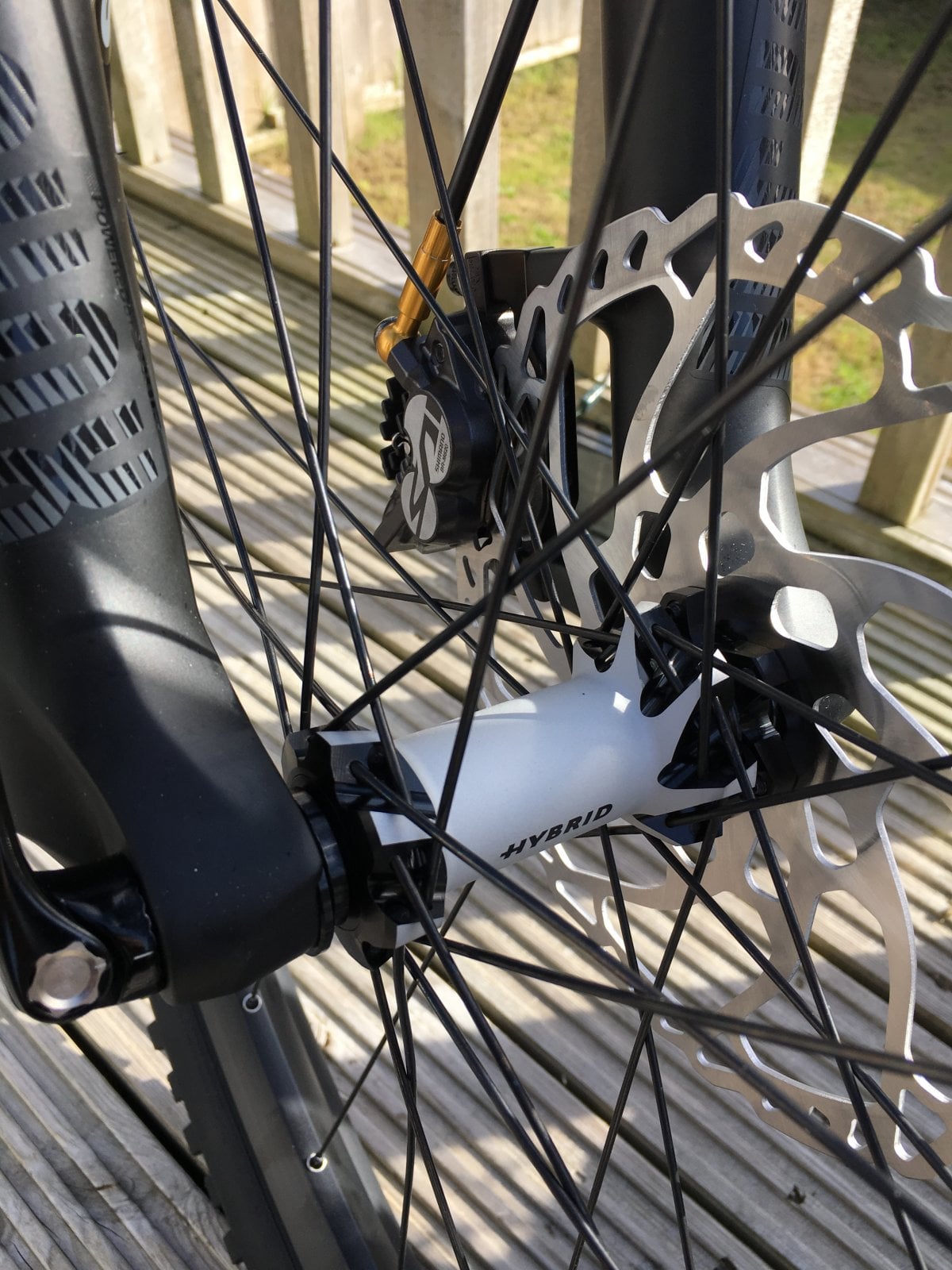

Brakes are on, wolf tooth dropper lever, E6000 switch and torque caps. Not easy running the brake hose over the motor from the left hand of the frame to the right where the cables are all routed. Routed worse but a few times wished I’d stuck with the Zees. Had the Saints here brand new and boxed ready to sell though so went for the bling but probably marginal if any improvement. Match the pedals though. ? Torque caps unnecessary but look nicer and do make lining the front wheel axle up.
Only rolled it around the decking but loving it so far. Looks great to me.

Super nice ?

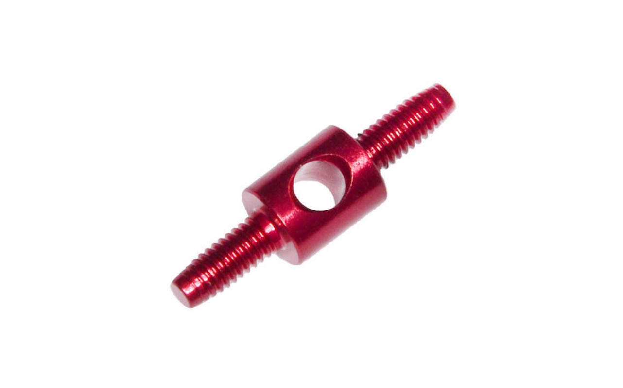

Nice job. :) How did you route the brake hose? I have a threaded hose connector that once came with the Reverb and using that everything is a two minutes job... OK, maybe three as the Zee/Saint etc hoses are coming out/going in one way only so you have an extra step... :)
I've used those before and made the job much easier. This time the old fashioned way with insulation tape and spare hose. Made it harder for myself really.

I should've before I started swapping parts in case it had to go back but thankfully just literally flew up and down a few hills to bed the brakes in. And keep @dwr budr happy. ?. All worked perfectly. Flew down a few lengths of steps and the suspension felt really plush. Few hill starts and the motor pick up felt great. Can't fault it so far. ?
