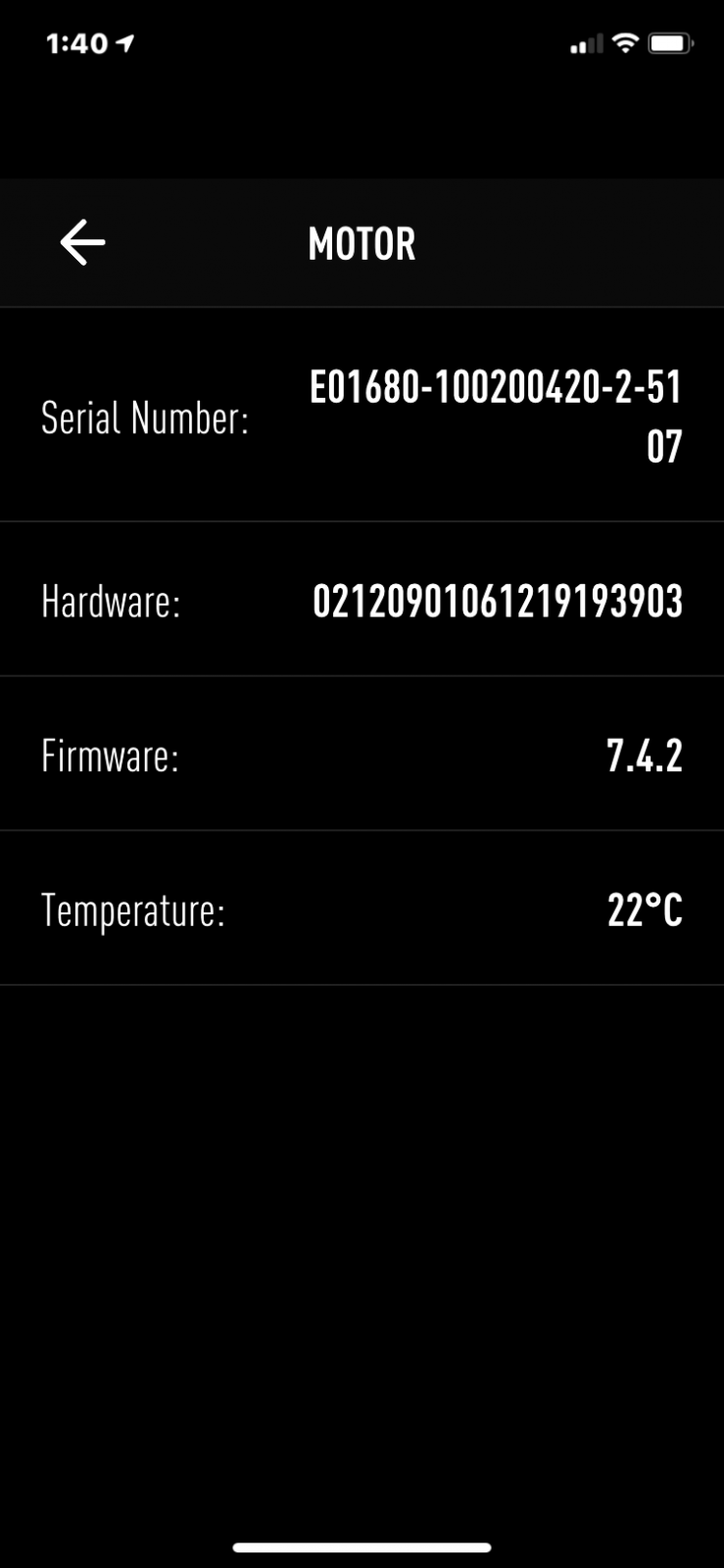

I can’t tell...
The LBS said the packing list listed “2.2...”.
l
I can’t tell...
The LBS said the packing list said “2.2...”.
lView attachment 59343
Your motor seems to be manufactured exacly a year ago, 20. April 2020.
My motor was replaced in August 2020 and has production date 30. June 2020. Great, so I have 2.2 motor also :ROFLMAO:
