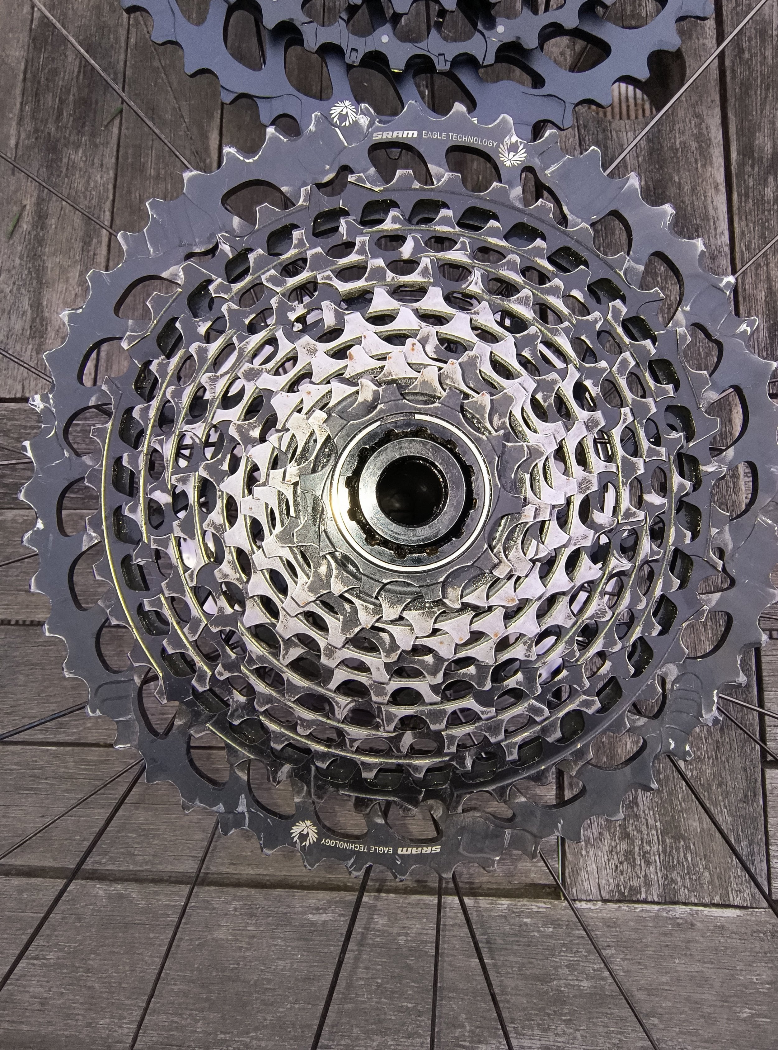

I’m new to emtbs (Tero 5.0 w/GX AXS and 12s 11-50) and still refining my technique to reduce hard shifts. Ive found, through trial and error and a lot of advice from the forum, that if downshifting while pedaling, especialy in higher assist modes, I have to stop pedaling, wait about a second to allow run-on to stop, shift, wait another half second or so for the stars to align, and then continue pedaling. This makes for a smooth, quiet, low stress shift, and also causes a lot of lost momentum, but I bought the bike for fitness, and the lost momentum also means greater effort so more exercise.
There is also an element of patience involved that I’m still working on. When I’m concentrating on making an unexpected short technical climb, I generally forget technique and just blast up it and then regret another hard shift. Out on the road hills are longer, usually more gradual and predictable, and so all this is a lot easier, but that doesn’t apply here.
Also I would think that SRAM would want that cassette back to examine it so you might approach a warranty claim from that angle, contacting them directly as well as your LBS (probably interested but not able to help) and Specialized (probably not even interested). I’ve had very good results with SRAM customer support and they would probably be interested in examining of the part(s) involved since this “wear” is definitely not normal.
Happy ending to the story! Cassette was fully replaced and installed under warranty (already) and thanks to you guys I have learned a lot avoiding this next time. Like rzr mentions, down the road I may be looking into a more tolerant drivetrain.

Looking at the photo you probably leaned your bike or dropped it without knowing.. bent that tooth slightly... chain bent it back straight and it broke.. aluminum only bends once.

Good news for you. If it were me i'd take the warranty cassette and just keep running the broken one until it wore out. honestly one tooth on the biggest cog isn't going to make any differencr really - so may other teeth for engagement. I had same GX eagle starting out on my ebike and had some hard shifts....its really quited durable. I wore out my middle cogs and no other damage before replacing.

I personally think the jump up to the 52 first gear is too big for the SRAM derailleur geometry to handle properly. I've just swapped back to a 500% one because I was tired of hanging gearshifts, caused by inadequate lateral chain deflection.
To set the derailleur up 'correctly' for the bigger gear requires a B-screw adjustment that brings the derailleur away from the cassette, and because that leaves a longer length of chain between the upper idler and the cassette the chain deflection on shifts is reduced and shift quality along with it.
Ironically, having every other tooth missing from first gear will probably IMPROVE shift quality.

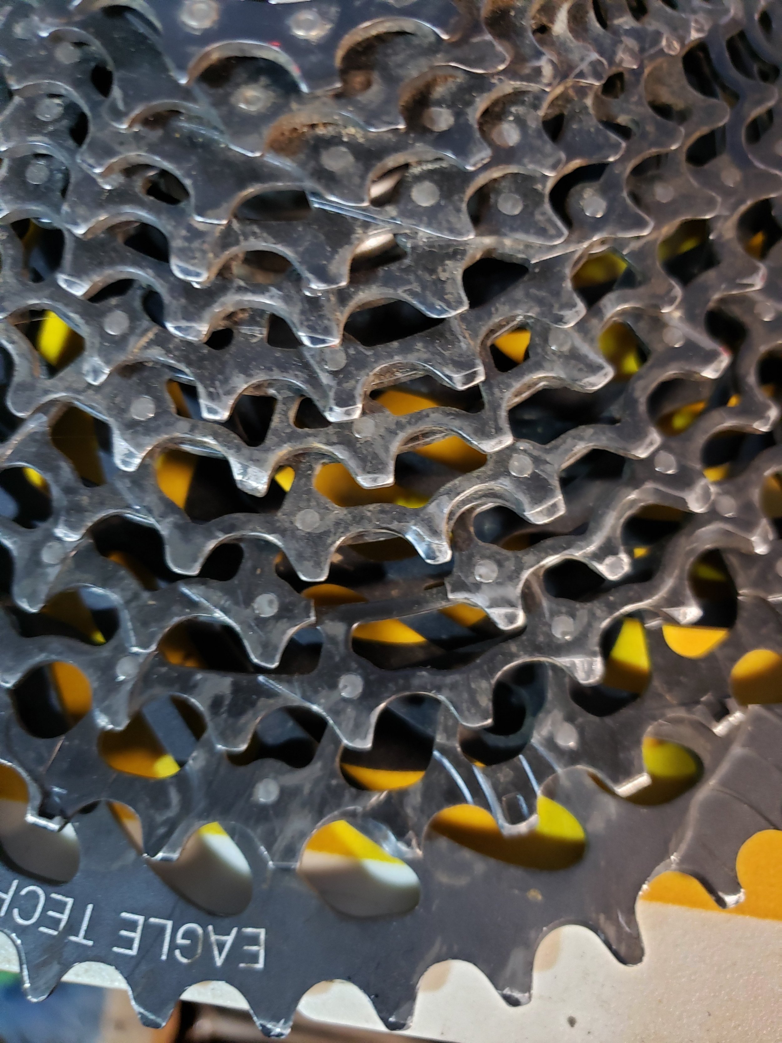

Hello everyone! 1st post. I have been riding for decades and recently bought a Comp Alloy. At 100 miles total, I have damaged the cassette. I had no idea a bike so expensive is so fragile. Yes, I shift to 1st gear to climb hills under duress. I can literally put my other "cheap" mt bikes thru hell and never had to repair ---- so I am pretty disappointed. I sincerely thought I was buying one the best most durable bikes on the planet and I paid as such.
Can someone explain or justify this to me? I get light weight vs strength.
Any suggestions going fwd for replacement? Buy same $230 cassette and baby my bike and stop when I encounter a steep hill and gently shift this bike?
Thanks for listening :) and the help!

Please send the cassette to SRAM, they'll send you a new one. Please do this on faith, I had an AXS derailleur with 300 miles my local bike shop refused to make a warranty claim, they claimed "trail damage". Another shop called on my behalf, SRAM immediately sent a replacement without any supporting docs, nothing.
I've had nothing but great warranty results from both SRAM and Shimano, don't let a bike shop get in your way.

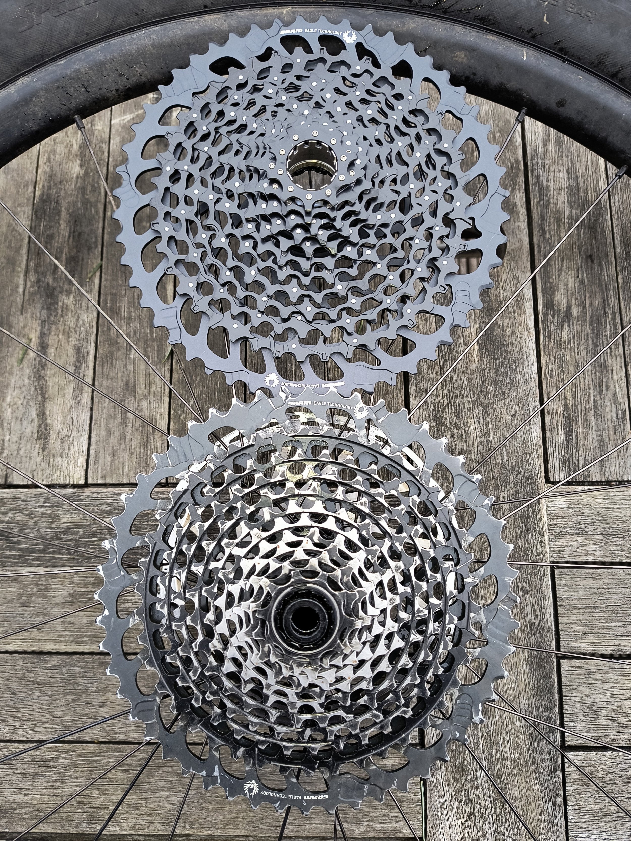

Shop reckons my cassette needs changing after 800miles. My old eyes can't see enough damage to warrant it. New lower spec cassette also in image for reference. What do you think? 🤔

Perhaps, just perhaps trail damage? My drive trains last 600 to 900 miles and I break a derailleur at least once a year. My solution is to buy the cheapest drives possible like M4100 the shifting is not as crisp, but work just fine and they seem every bit as strong , I stock, chains and derailleurs at all times. Perhaps I'm hard on drive trains, I've broken cassette just like yours.
Someone weighed in on 90 newton meters of torque, absolutely breakage and wear.
View attachment 130920 View attachment 130921
That looks nicely run in to me! :)
There are no burrs on the edges of the teeth and the roots of the teeth are not extended. Also, no shark fins.
Unless there are cracks in the material that don't show up on the pics, then I'd run that cassette until a new chain won't run on it without skipping. Then put the previous old chain back on and keep running! :)

Time to find a new bike shop! It may be also that they need to replace their chain gauge!

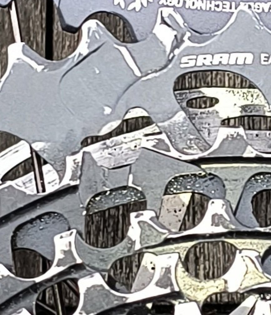

I know nothing about Sram cassettes (always use Shimano), but to my inexperienced eye this looks ugly:
It looks like you use the high ( small cogs) a lot and they have the smallest chain wrap so will be the first to cause chain slip ( assuming that is what you are experiencing). If I was you I would use the previous chain ( even if beyond 0.5%) and also check your B tension. As chain and cassette wear it can often work to "close" the B gap a little which will add tension when the chain is at its slackest on those small cogs. As long as the mech still clears the lowest ( biggest cog) you use, the gap can be closed a little. Personally I avoid using gear 1 and gear 12 on an Eagle cassette!
I picked a Kenevo expert this spring, my chain was done in 500 miles. Your cassette looks pretty “sharks toothed “ to me so yes it’s done. 2 things, 1… your biggest cog is alloy, not steel so it wears faster. Try to ride in the lower cogs. My trick is I have my chain keeper adjusted so it drags in the biggest cog to remind me to shift down. 2… buy a chain gauge like the pic. Drop it in your chain every week, it hits .75, replace the chain.

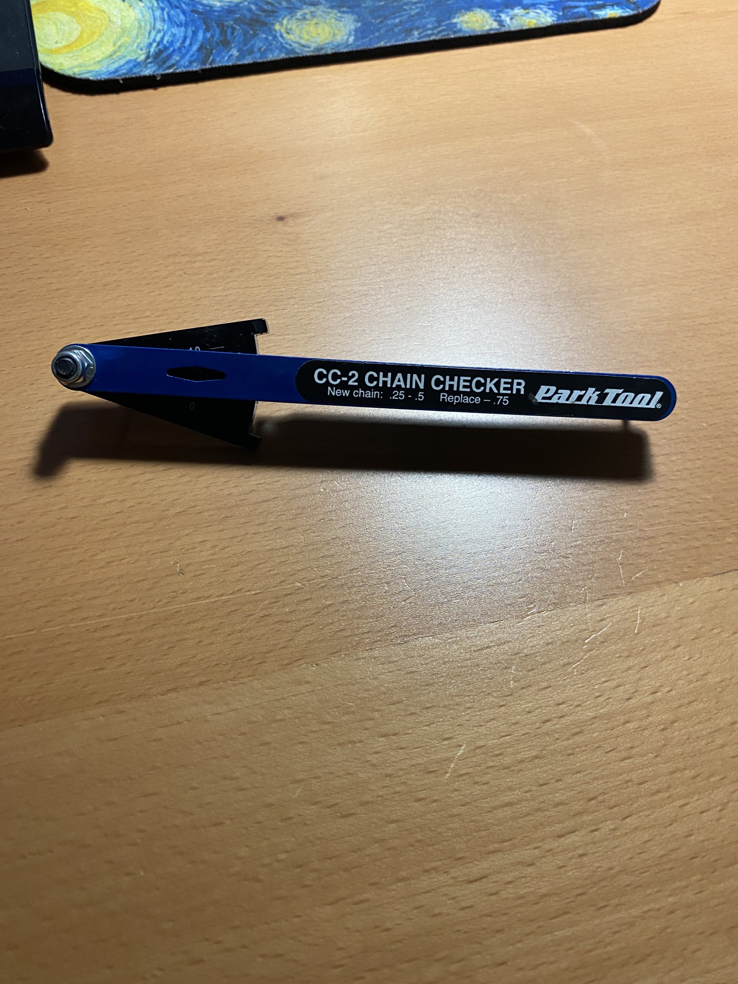

Also have the Park Tool CC2 chain checker. Replace chains when just over 0.5 and well before 0.75.

the only "shark Teeth" on that cassette are the ones that are designed that way.
Look at a new one next to the old one…. As for broken teeth on cassettes , never use to happen when th 8 an 9 speeds. The plates are thicker with the old gear sets. As for it being only a sram issue…. I have seen more than my fair share of bent and broken Shamano cassettes. At least sram doesn’t have micro spline creak. If you change gears like a n00b, you can brake any cassette on an e bike.
