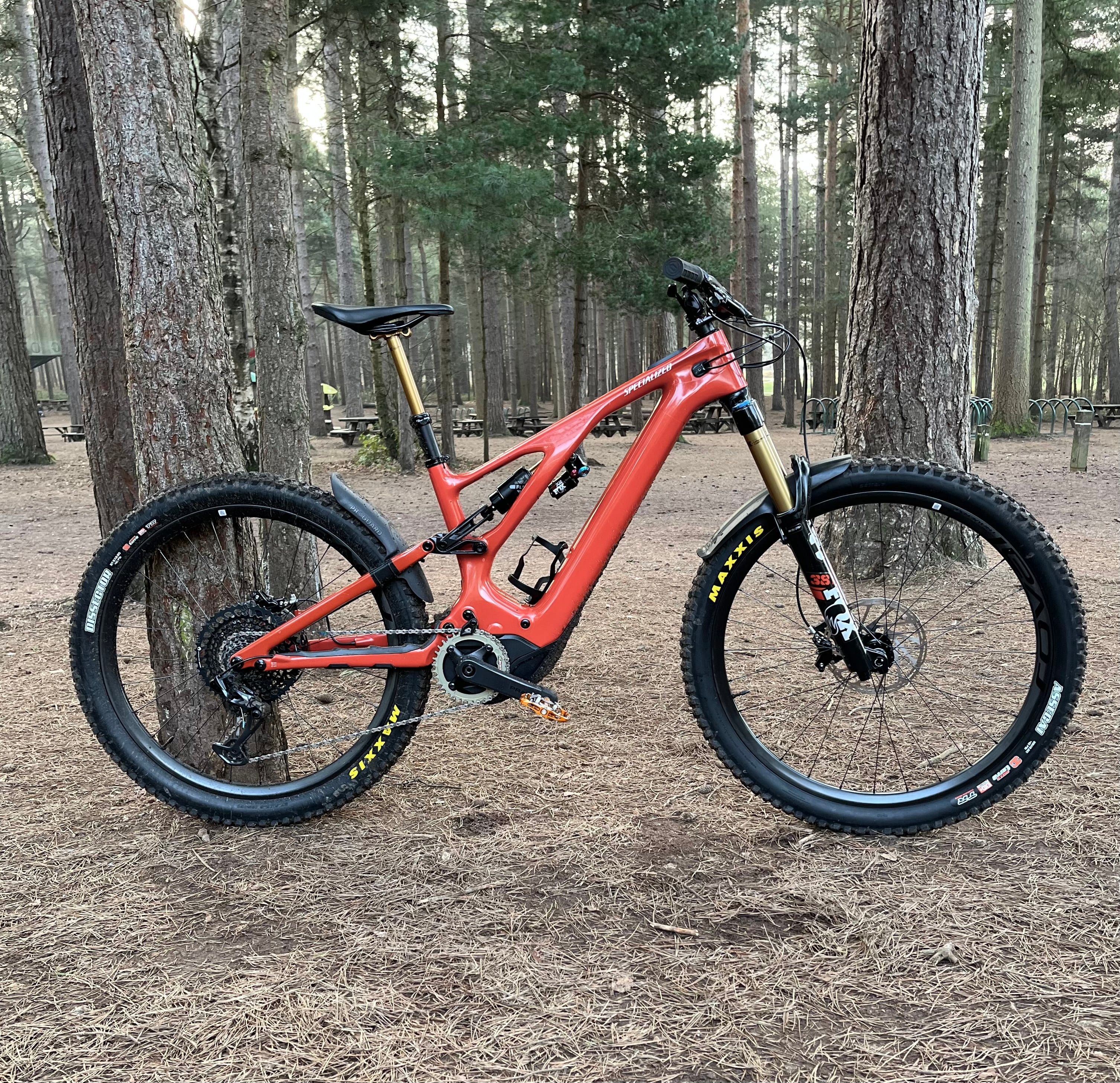

I’m on my 3rd levo 2016 expert 2020 expert now 2022 pro yes I have had a couple of motors go over that time all swapped out under warranty the same day. I wouldn’t be that concerned if I had a motor go out of warranty because you can get new bearings belt etc done for about £200 which is a lot cheaper than a xo1 sram cassette at £380. I was unsure about getting the new levo with it be a mullet but its an amazing bike
View attachment 106929 lovely bike…need to line up your tyre logos and level your cranks before your next photo though 🤣

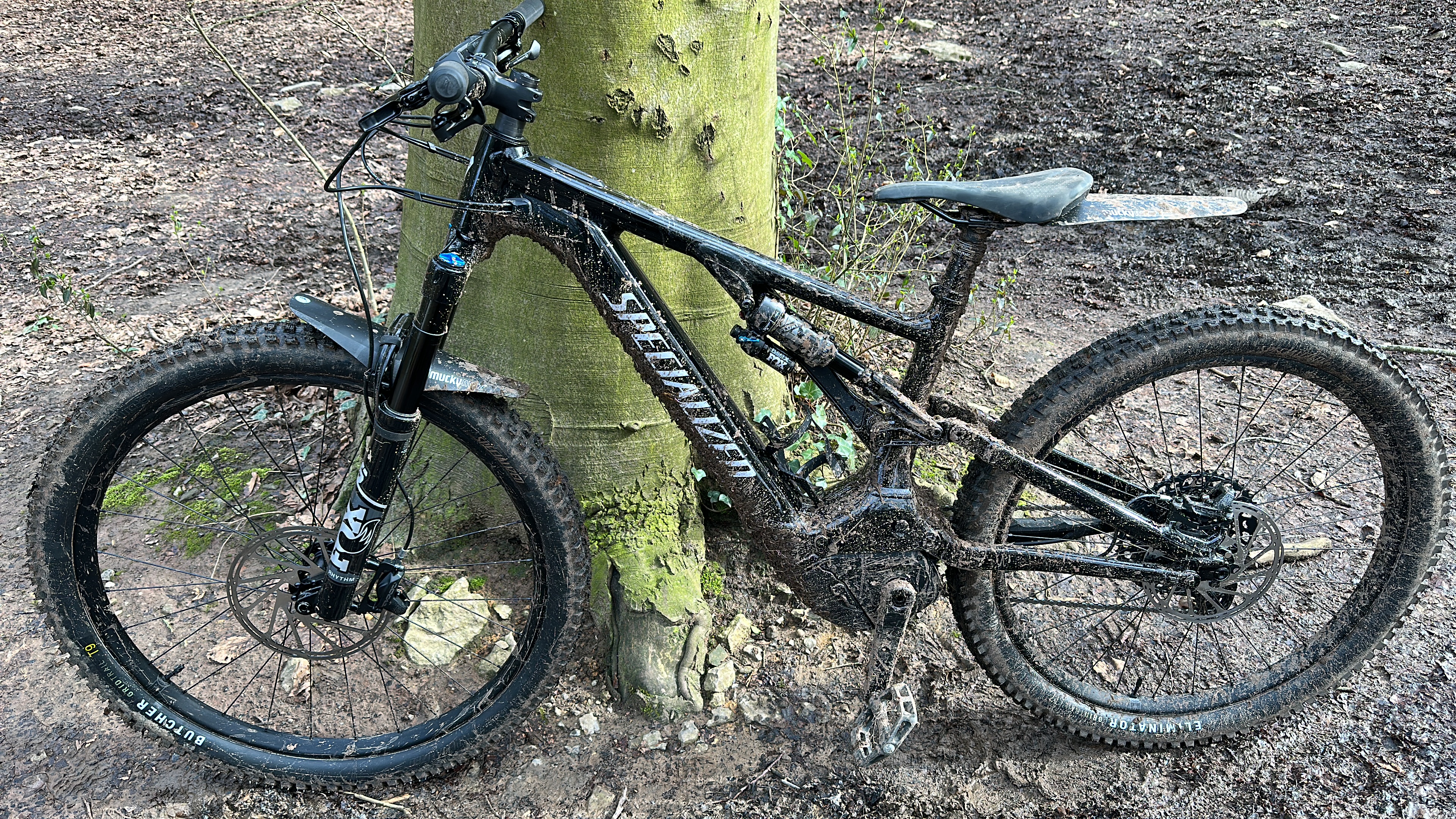

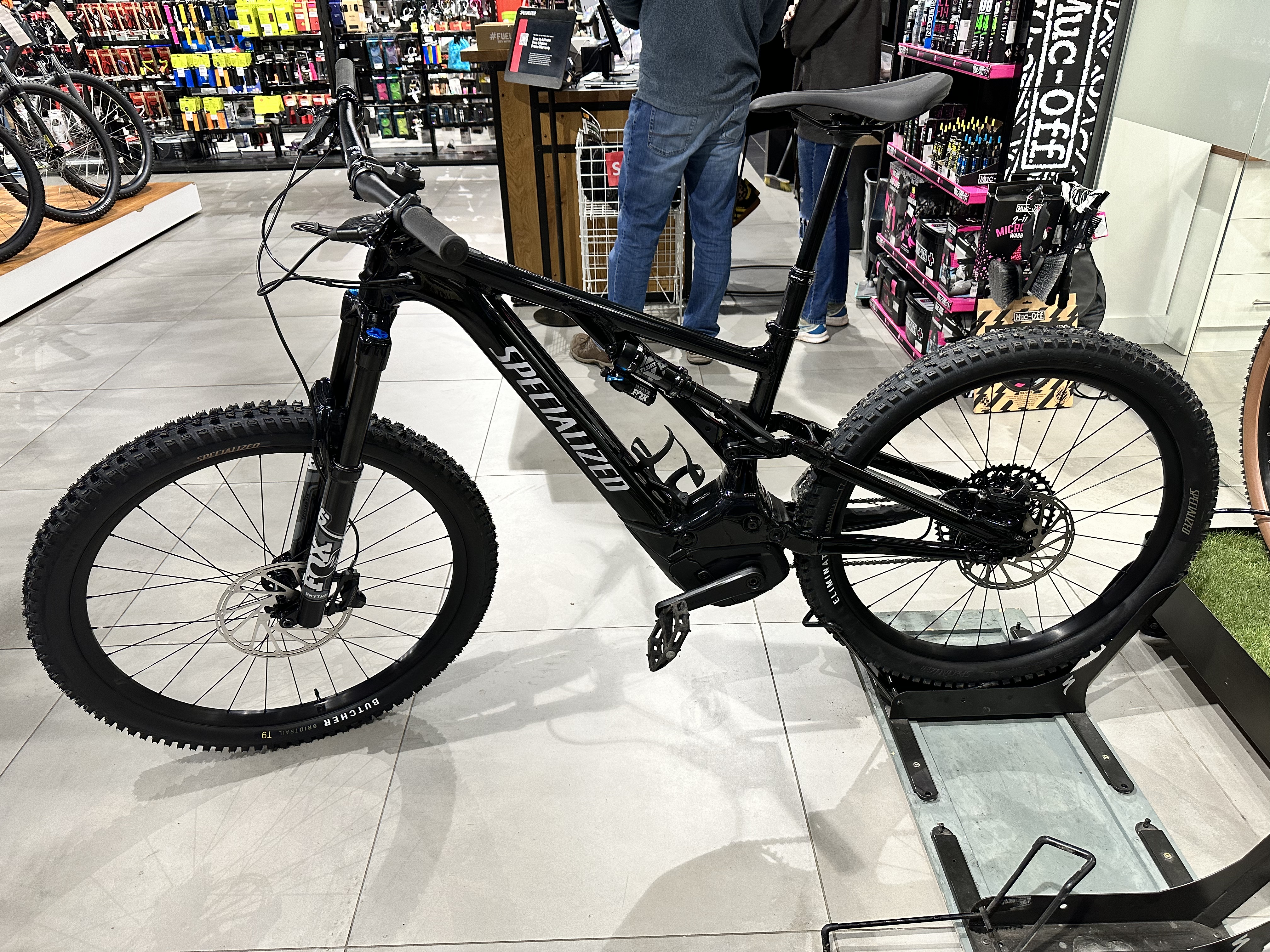

Well I test rode a Levo yesterday. Just an alloy one, but it was brand new from the store and we've had a lot of rain recently, so I certainly broke it in for them!
Before and afters below.
I noted that the motor in this thing is silent... Like nothing. The cassette was noisy as hell, but the motor didn't make any noise that I could hear.
However, when doing jumps a few times there was a real loud clack that may have come from the rear suspension, or could have been the motor.
Any ideas which it was likely to be? Don't think I was bottoming the suspension out, maybe it's a normal noise for the motor, but it sounded quite alarming!
The bike was great though. The difference was night and day from the last time I was out riding with my friend. We covered way more miles, he never had to wait for me and I enjoyed it all so much more.
I described it as like being 16 again, and on steroids. Initially I just kept in Eco mode and considered if an SL bike would be sufficient for me, then realised how much extra speed I can carry through a trail with the additional boost that trail mode offers. Also the more tired I got, the more I used the higher modes. A few times I found myself feeling knackered again, then I'd look down and notice I'd changed it back to Eco and forgotten. Popped it back in trail and it was like having fresh legs again. It's a great crutch for someone like me who has been out of MTB for so long and lost all their fitness, but wants to get back into riding. I still had sore legs at the end of the day, indicating a good work out, but I had ridden much further, much faster, for longer and had much more fun. My friend was also pleased not to have had to wait around so much for me.
Now I just need to sort out a bike of my own...
