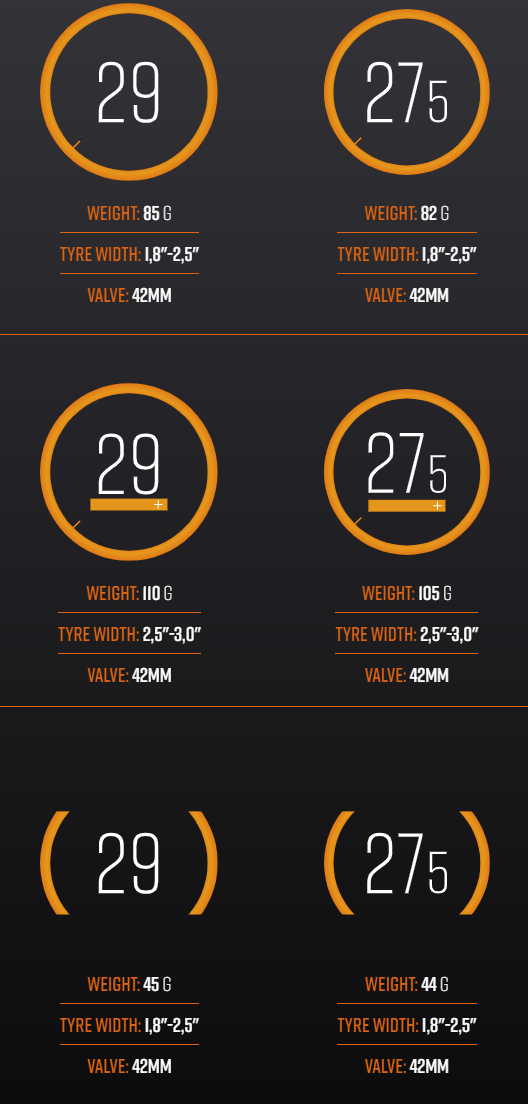

The Tubolito and Aerothan tubes actually claim to be twice as puncture proof as "normal" rubber tubes despite being lighter. These are some of their example weights: (The plus tyre width versions are heavier). But also note the 45g ones (which I haven't tried!) - and which are mainly meant for emergency repairs only.
I have noticed some quality control issues with Tubolito in the past (like a slow leak from the valve over a few days), so considering trying the Aerothan ones at some point since they are a newer design made by Schwalbe.
If you're going to the cost and effort to buy and fit superlight tubes, you may as well go tubeless. It's as quick, if not quicker to do. I have serious doubts that a tube tube weighing a 1/3 of a normal tube has twice the puncture resistance. If it works for you though....crack on.

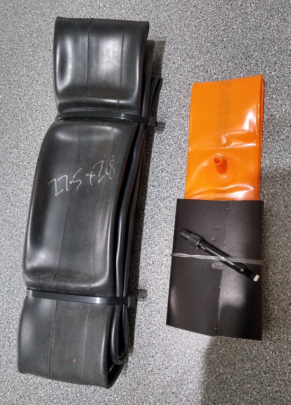

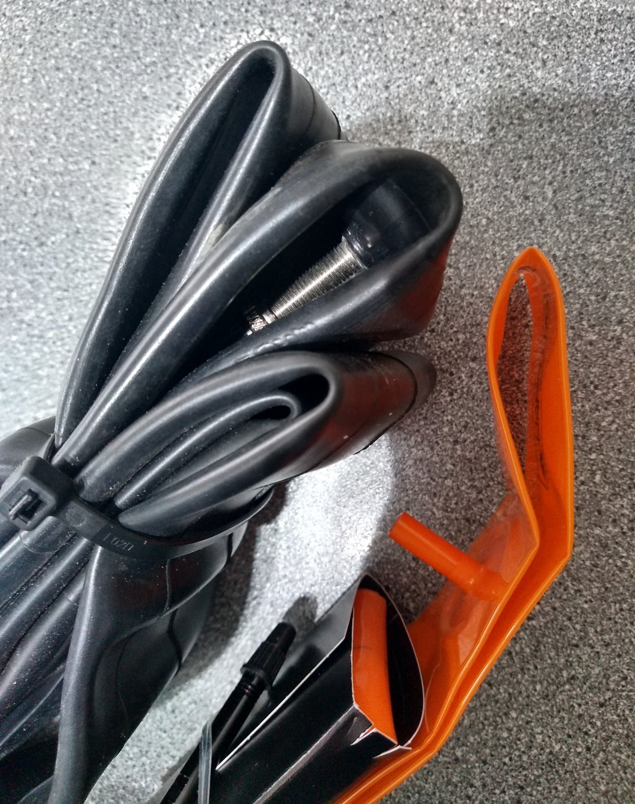

As I have said earlier on this thread. I run tubeless. But I also carry spare tubes just in case I get a flat that the sealant won't seal. That has only happened 3x in 12 years, so not a lot to worry about. But each time I would have had a long walk and a ruined day if I hadn't had a spare inner tube to fit (plus the tools to remove the tyre and so forth).
When I got a mullet bike that became two spare inner tubes. And of course, because it's an emtb, they are big tubes! They add weight to my pack, but more importantly, they take up a lot of room. Elsewhere on this Forum, someone drew my attention to Turbolito inner tubes. These are expensive, but very light (45gm) and take up very little room. See pics.
Those Turbolito tubes are now out of their boxes and in a zip-lock sandwich bag at the bottom of my pack and they are just not noticeable.
