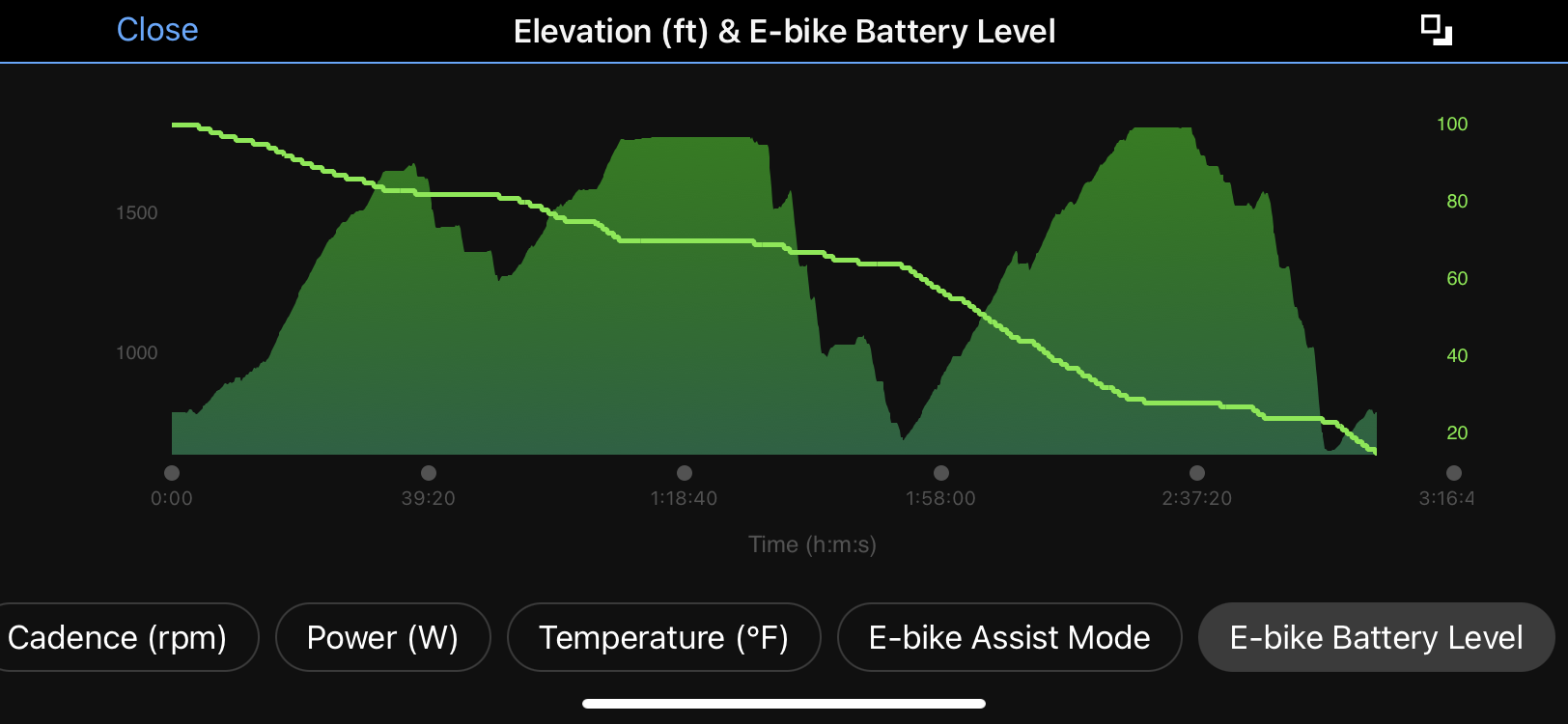

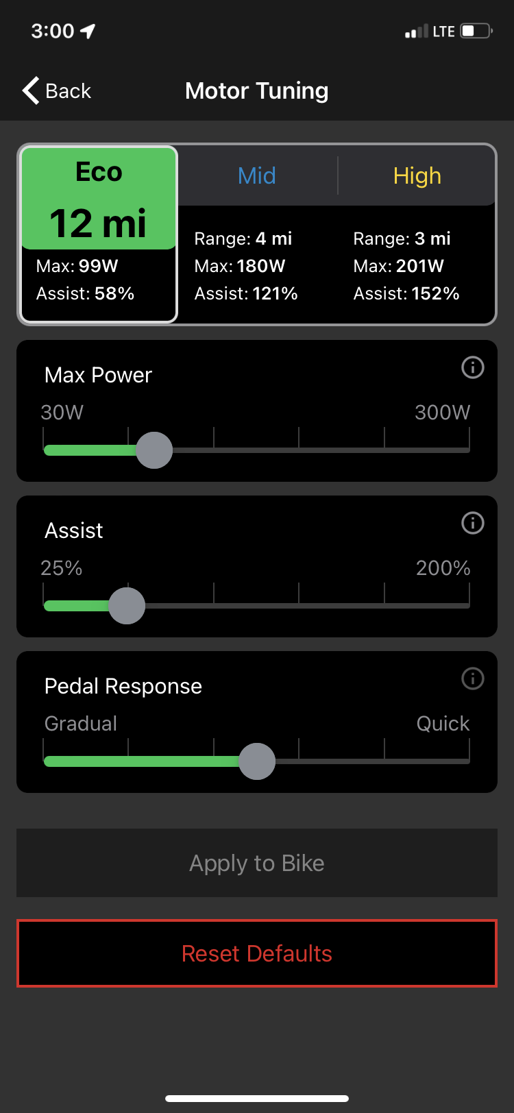

Stoked- I got 3307’ up&down today and still had 30% left at the end. I used the settings below and did the first 1500’ in tuned-down Eco, then the rest of the ride in trail mode. Threw it in boost for the last traverse, why not. I think warmer temps and drier trails are improving range.
61339C8E-A56A-41CB-A8FF-0C7461493328.png 798CEA43-1FD3-4B46-8EA5-0F8FE3C1EE44.png

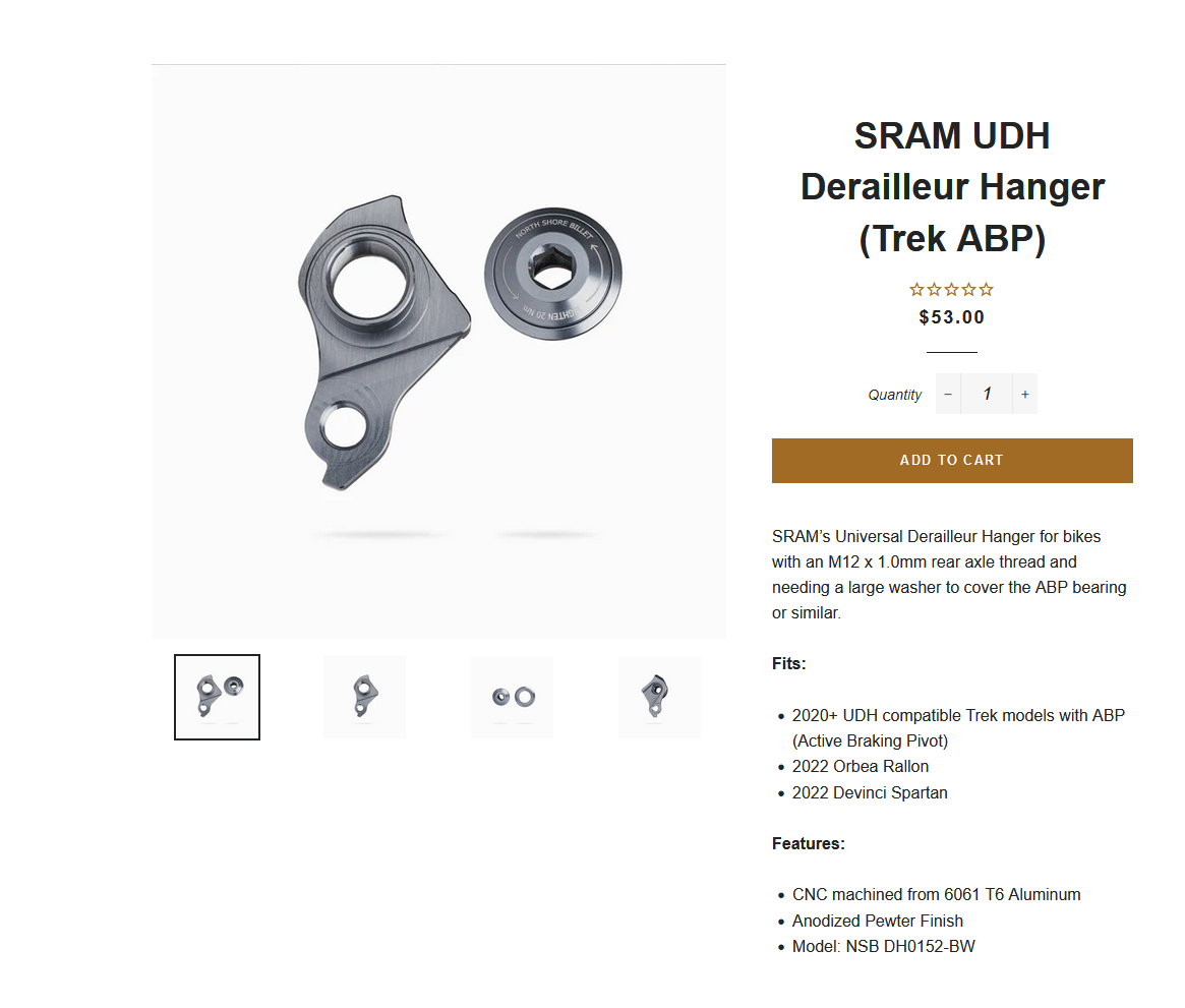

And on a side note, the UDH that came on the bike is a chinesium POS. NSB makes a nice one, but make sure to get the Trek specific one.
Yes, but with the pivot placement you'll be clamping the bearing at 35 Nm. No idea if that's fine or has the potential, at the very least, to shorten the life of the bearing. Could also restrict the movement of the pivot? Not saying either of those will be an issue, but it's at least worth pondering. Great point that was made in the NSMB review.
where do i find this NSB hanger
