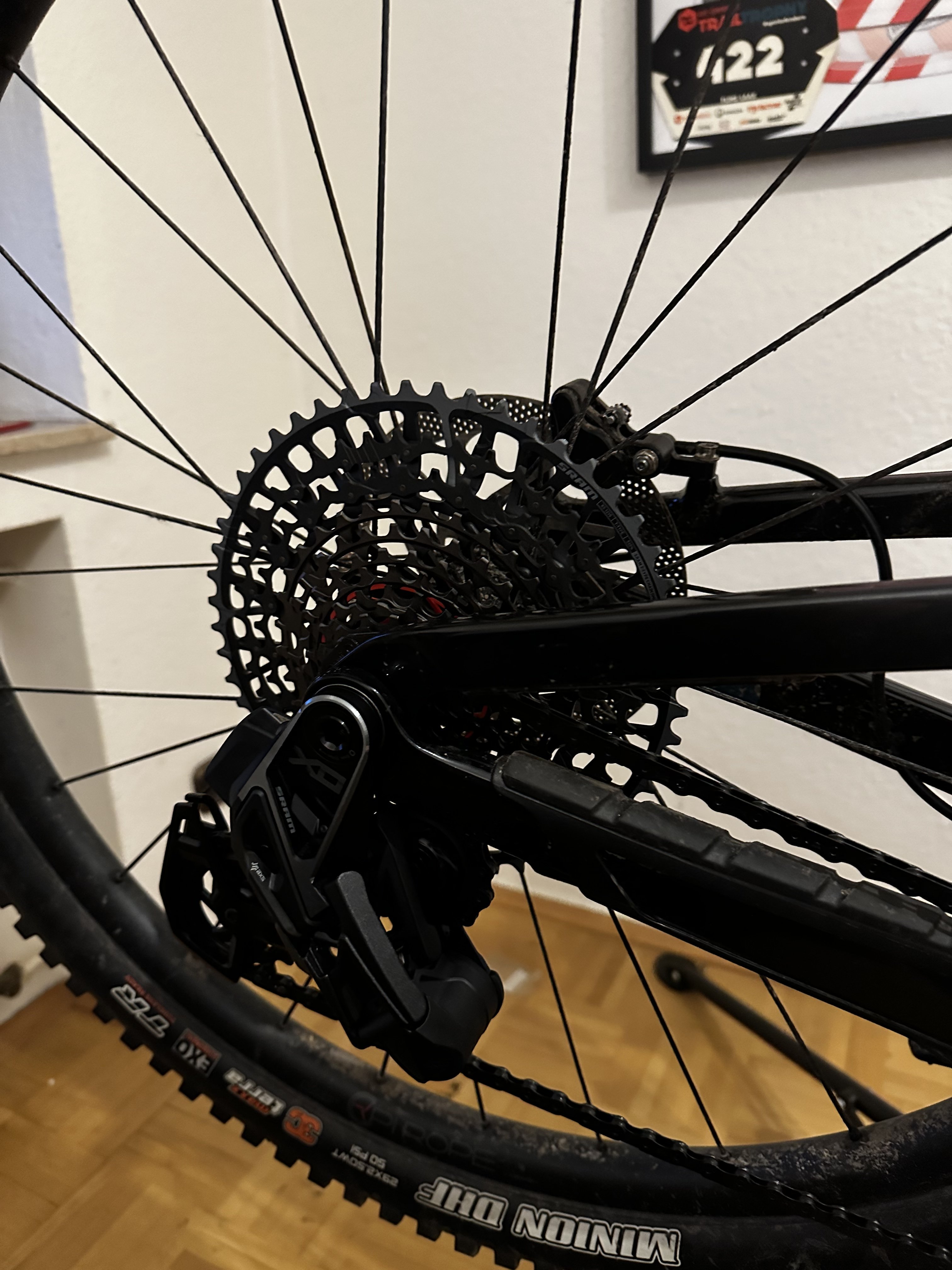

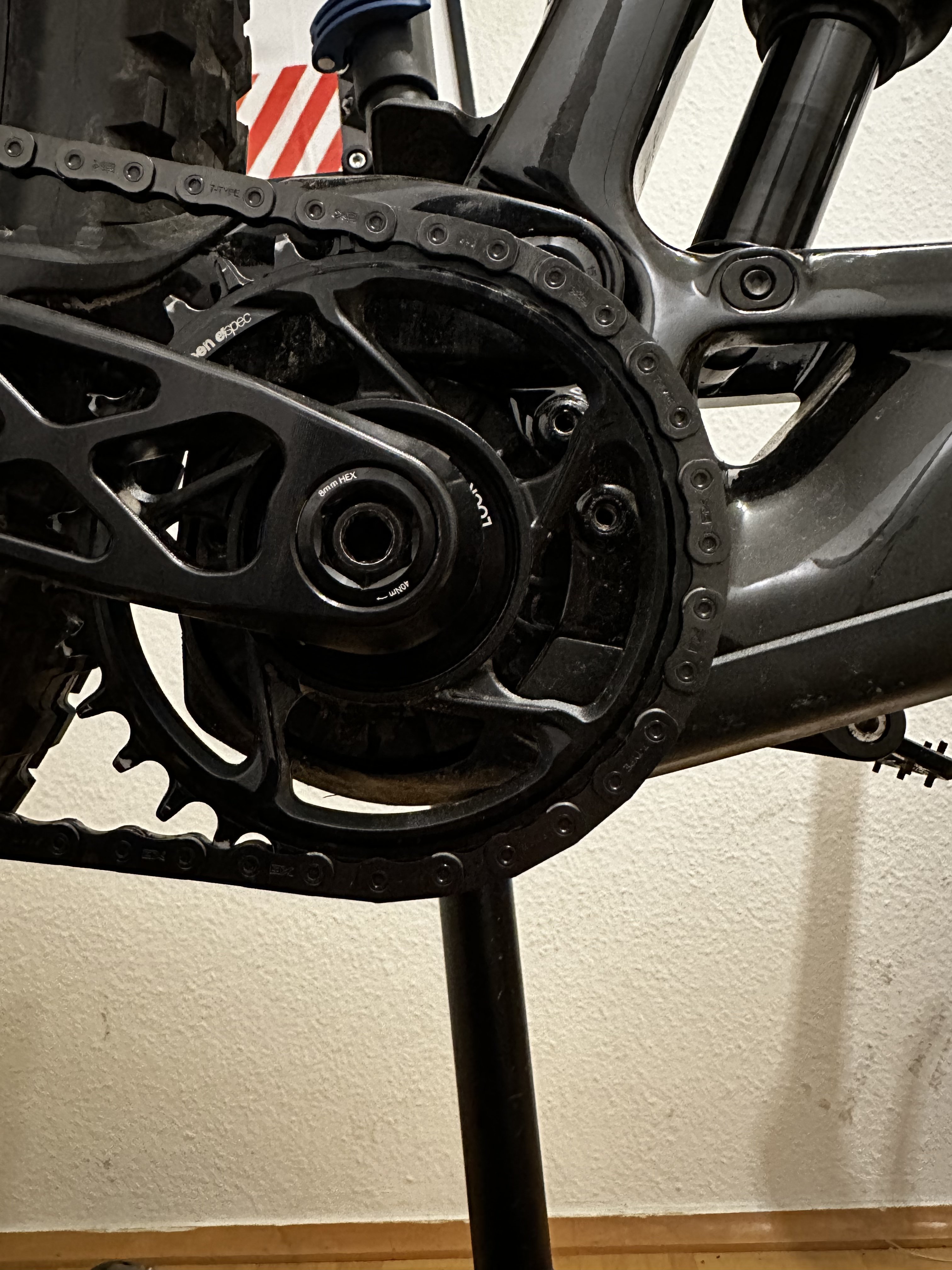

I‘m just done with the installation. Had no problems so far and it works fine on the bike stand. I‘m going to ride it tomorrow.
