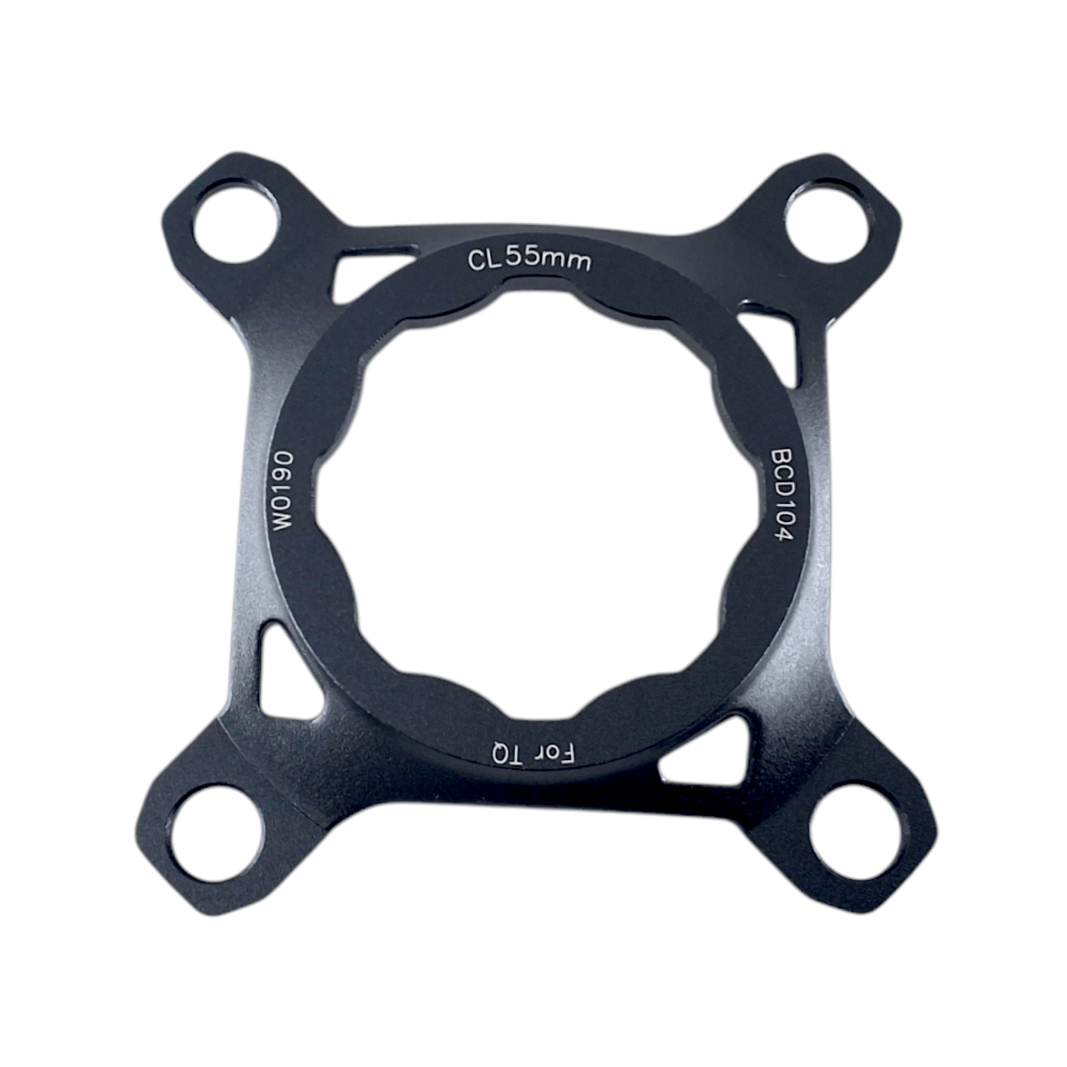

All Shimano models come with a direct mount chain ring from E13 (E13 e-spec), the Sram models come with a spider (from FSA, unfortunately not available on the aftermarket so if you have bought a Shimano equipped model it is rather difficult to switch). You can see this also on the service book from Trek (there is a link to it in another discussion of this forum).

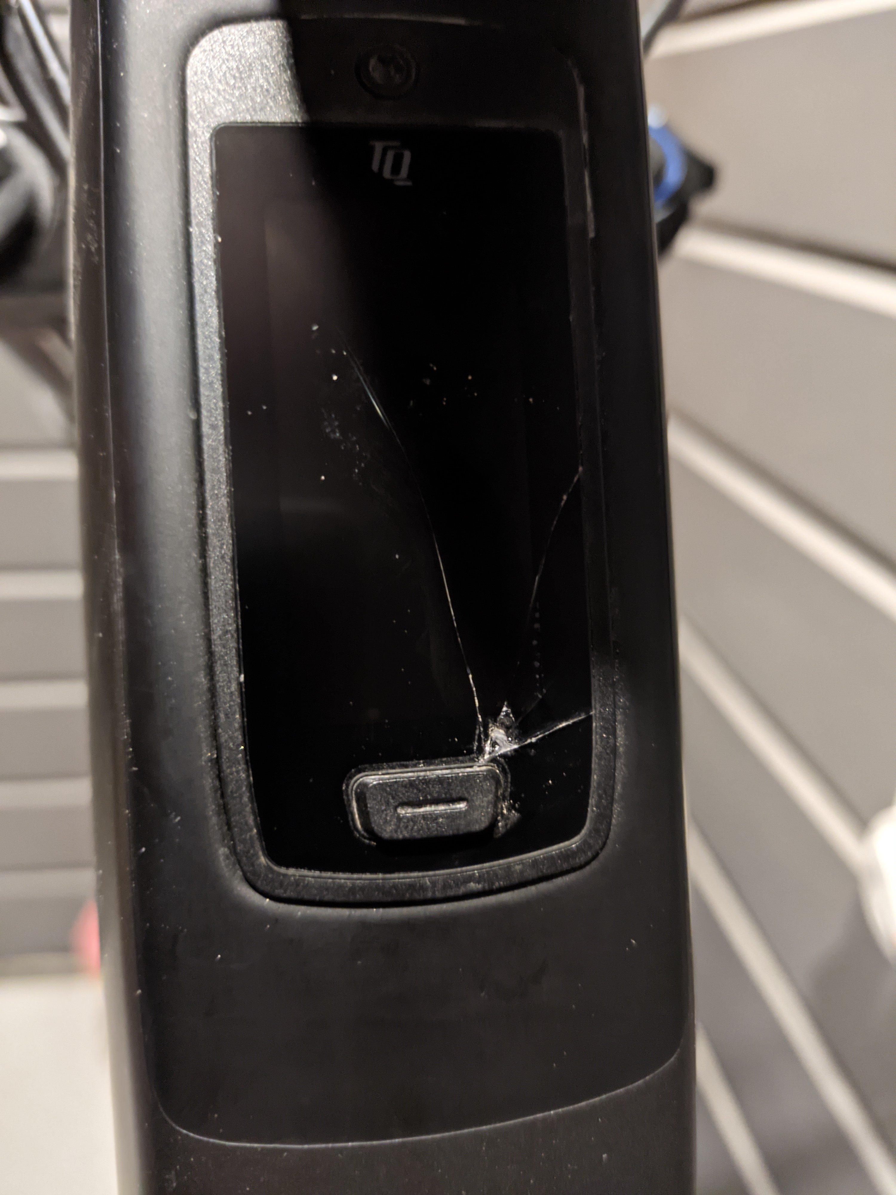

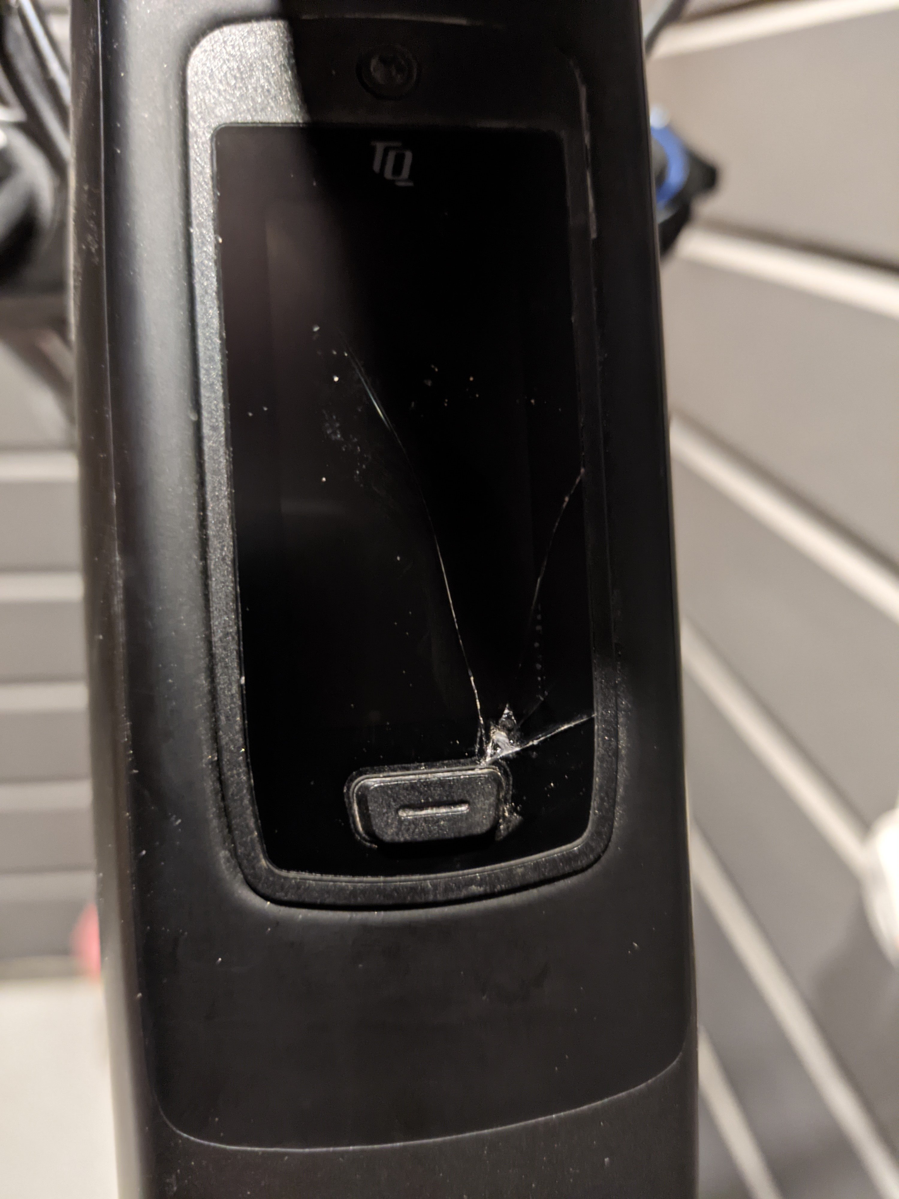

A friend took my bike for a ride on a flat gravel track and the screen cracked.
Could have just been a fluke stone and I'll buy a replacement (I even had the screen protector still on it) but I'm just checking this isn't a first gen issue that TQ are addressing as I've seen others with cracked screens too.
You can get the FSA spider after market. I have and my wolftooth ring and bash ring just got in. Still need to source the chainring bolts but first wanted to have all 3 pieces in hand. Also, anticipating some mods to the chain guide are going to be required.
Will report back when I get around to figuring it all out.
Can you send me a link where you have ordered the spider? I am living in Italy and I am not able to find it...
These are the closest I can find
not in stock though
Could have just been a fluke stone and I'll buy a replacement (I even had the screen protector still on it) but I'm just checking this isn't a first gen issue that TQ are addressing as I've seen others with cracked screens too.View attachment 108749
Were they riding the bike upside down?
