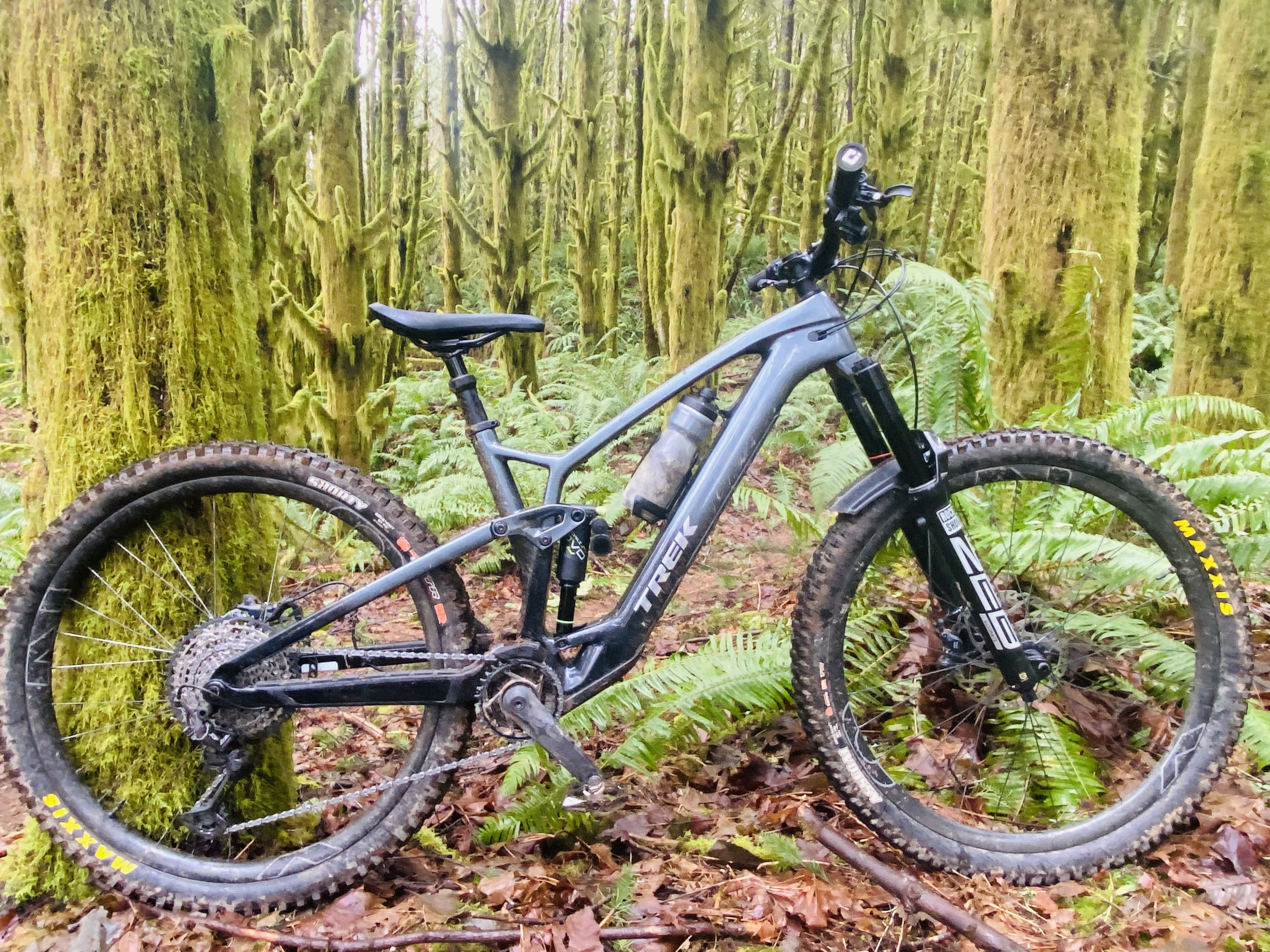

Actual range is completely dependent on rider weight, trail surface and assistance level. Saturday (below) I killed my EXe battery in 2900', but that was climbing in snow with full-power eBikes. They all finished with >50% battery. On other rides I've gotten 3800'+ and finished with battery left. That's on a mullet with DD casing minions and 185lb rider.
