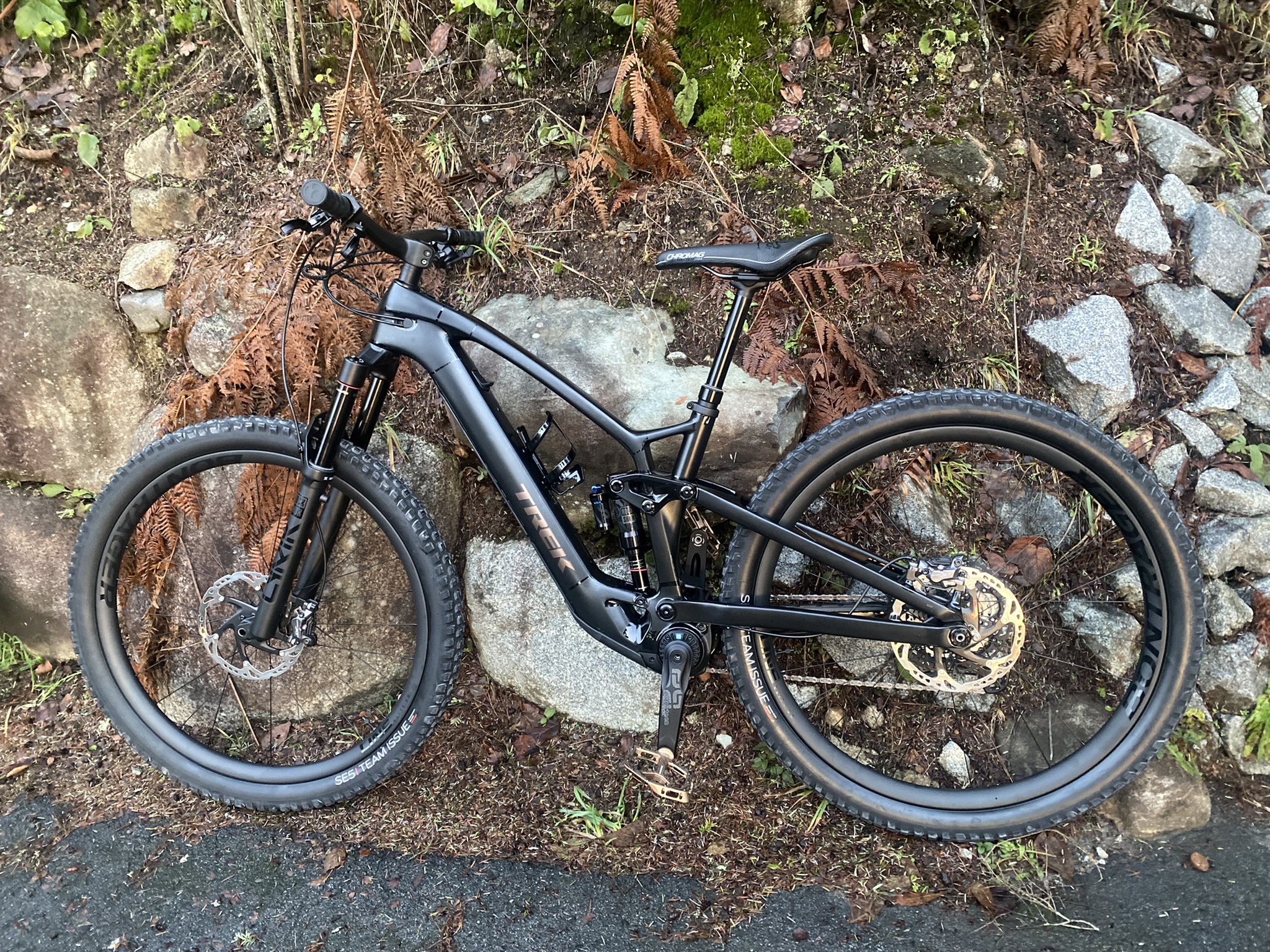

Joined the EXe club! Came of an Orbea Rise small size, got this one in a medium… pretty excited to get out on it!
Got the 9.8XT, and ridewrapped it with the matte ridewrap. Cashmoney Raceface pedals as an accent!

let us know your thoughts with the EXe v. the Rise. I also came off the Rise. My only complaint is the range. Your bike is really nice.

Same! I like everything about this bike better than the rise, except I feel that with the Rise I would easily get double the range. Today was my first ride and I rode a mix of eco and trail, only couple boost minutes here and there for steep corners.
Rode for 2.5hrs, 600m of elevation on very very technical climbs, no fireroads or road, for 12km - much more of a workout than the rise, but I liked it! Ended up using 50% of the battery. Was hoping the range would be a bit better than this, but I can manage! Will get the extender once its out for extra long rides.
On my rise, this same lap would be maaybe 30% and I’d be able to use a lot of boost.
My friend is on kenevo sl and she only used 30% and she was in trail the whole ride (vs me using eco quite a bit too).

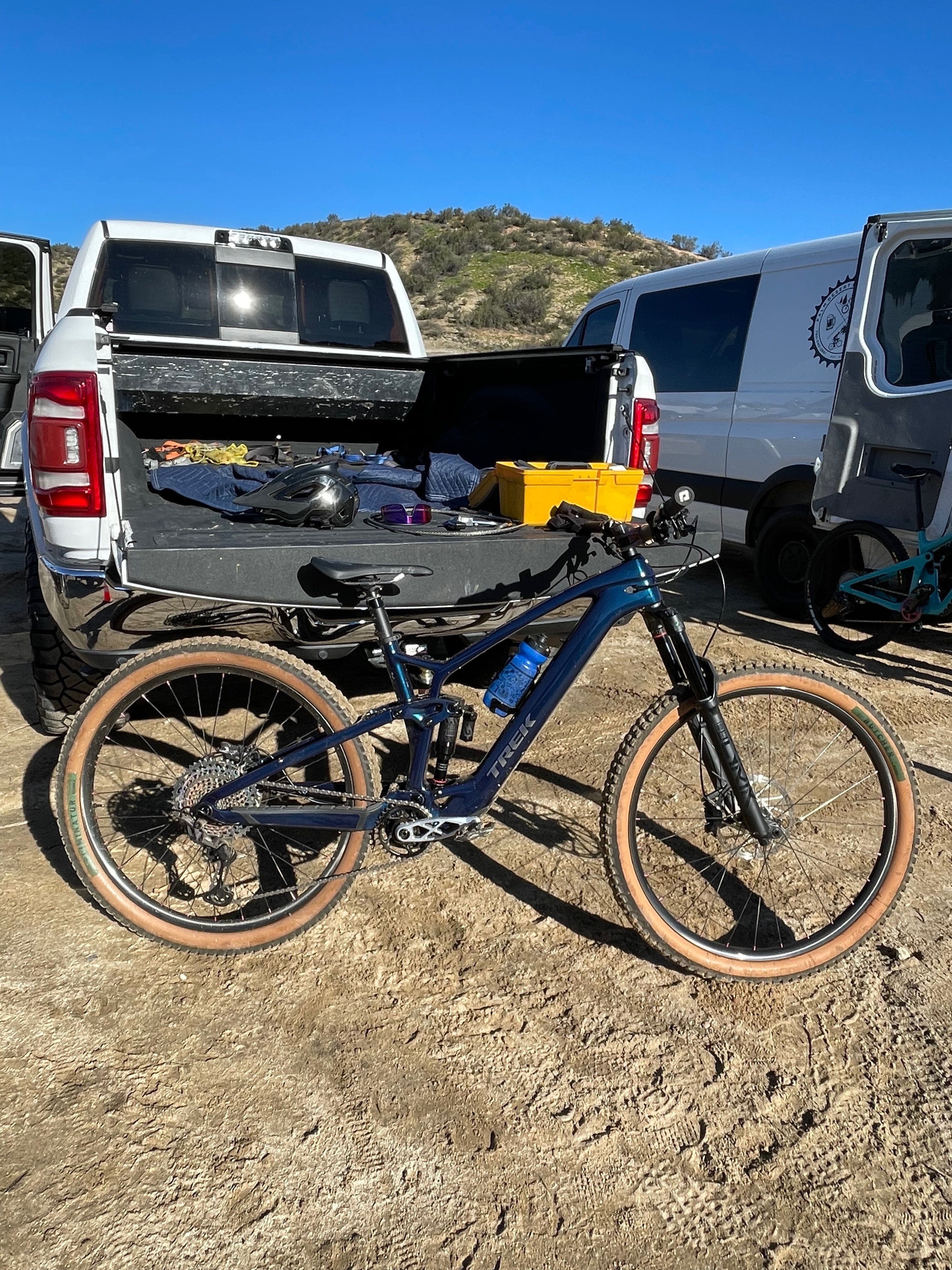

Made a few setup changes and got my first ride in yesterday. Installed 160 5Dev cranks, 5Dev Ti stem, WA1 Union wheels (had these in my garage from another build) and headed out.
First off my bike came with the new Charger 3 damper in the fork instead of the Charger 2.1 that shows on the spec sheet so that was a nice surprise. Didn't have time to really play with suspension setup, but out of the box the new RockShox stuff is really good. My only complaint is that the Bontrager dropper is absolutely horrendous. Lever is really stiff and the action on the post itself is painfully slow. Easy fix to install a PNW or something similar though.
I was using the bike to pre ride some courses for my Enduro race yesterday and it worked perfectly. Rode mainly Eco with some Trail and a few kicks to Boost on steep fire roads. Only used about 30% battery and still got a nice warm up in. Need to change my stem to the 32 mm instead of the 48 mm, but other than that everything feels great. I am planning on installing a 160 air shaft in the Lyrik, but other than that just ready to put some miles on it.
