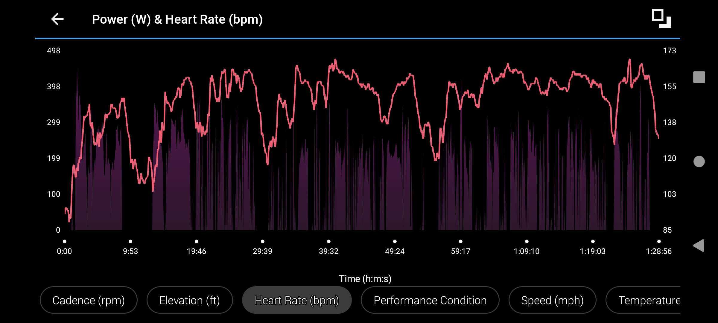

Yes, you just pair the fenix 6 up with the bikes power meter (and battery monitor, cadence sensor,speed sensor,and power assist mode indicator), then whenever you record a ride using the fenix all this data and your heart rate data from the watches wrist HR sensor get stored and transferred to Garmin connect when you upload the ride.

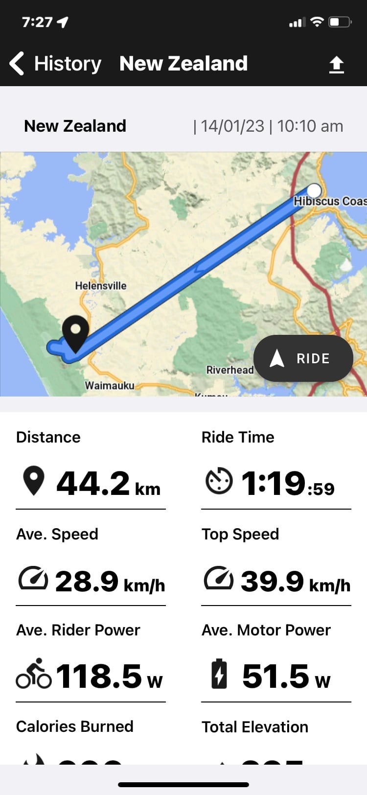

See below for a screenshot from Garmin connect showing power data overlayed with heart rate, this was recorded on a fenix paired with the bike
Ahh fantastic, so I'll try doing it that way round, rather than pairing HR to the bike! Thank you.
