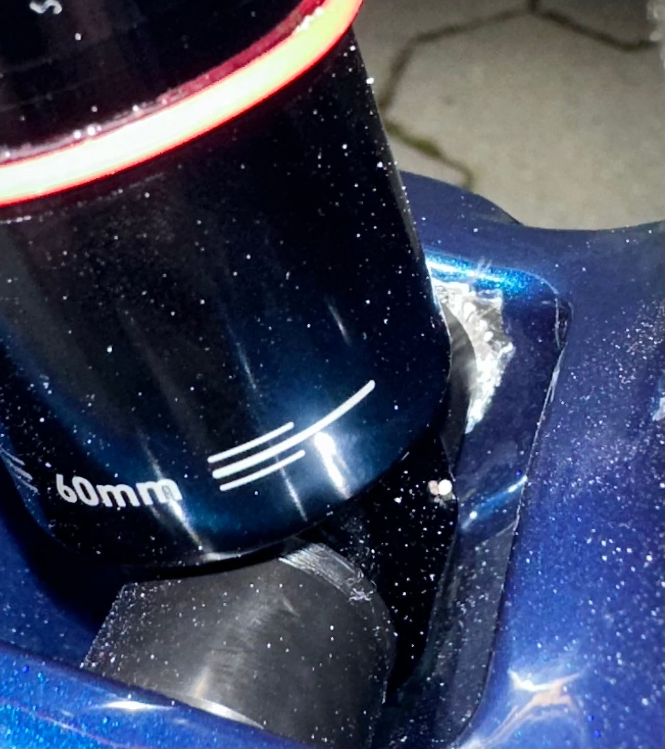

Collected my 9.8 GX AXS today and went on a ride after setting it up. Rides super nice. However, I also noticed there was some knocking coming from the shock/motor mount. After checking I found that there's some play in the lower shock mount when lifting the bike by the saddle. The spacers are moving up/down for like 0.5mm. Checked torque, 15nm like it says in the service manual. Also looks like there' are some paint chips / scratches around the marked area.
Anyone heard / read about something similar happening? Rear shock is a Super Deluxe Select+.
I had this with my 9.7 with a Fox shock. Trek replaced bike with an upgrade to same bike as you. No problem with this one even though it has those same chips.
Yea I saw a service bulletin for fox shocks, haven't found anything like this for rockshox though :/.
What do you mean by 'same chips'? Yours also has some paint chips in that area?
This is how the one side looks, after a single ~20km ride. There's already carbon visible in the top right corner.
Yes, exactly the same chips at the lower shock mount.

I believe it was fox, and I believe there was talk of the bolt being an issue and they had one made. Idk, I read the whole thred before buying mine. Haha seems like the tolerance for the space is hit or miss on Treks part. I have a RS shock and no issue. Somw were pointing at Fox early on since that was the primary shock having issue, now you have issue with RS. I would take it to the dealer and get it sorted. No excuse for this. Their tolerances are off a little. I found out when replacing my headset with a CK. The bottom bearing did not fit cleanly, had to nearly press it in, whereas on my Santa Cruz's, it just fits perfectly.
A buddy of mine also has a 9.8 XT with the same shock. No issues, no paint chips. Kinda sucks, as I planned a ride for tomorrow.

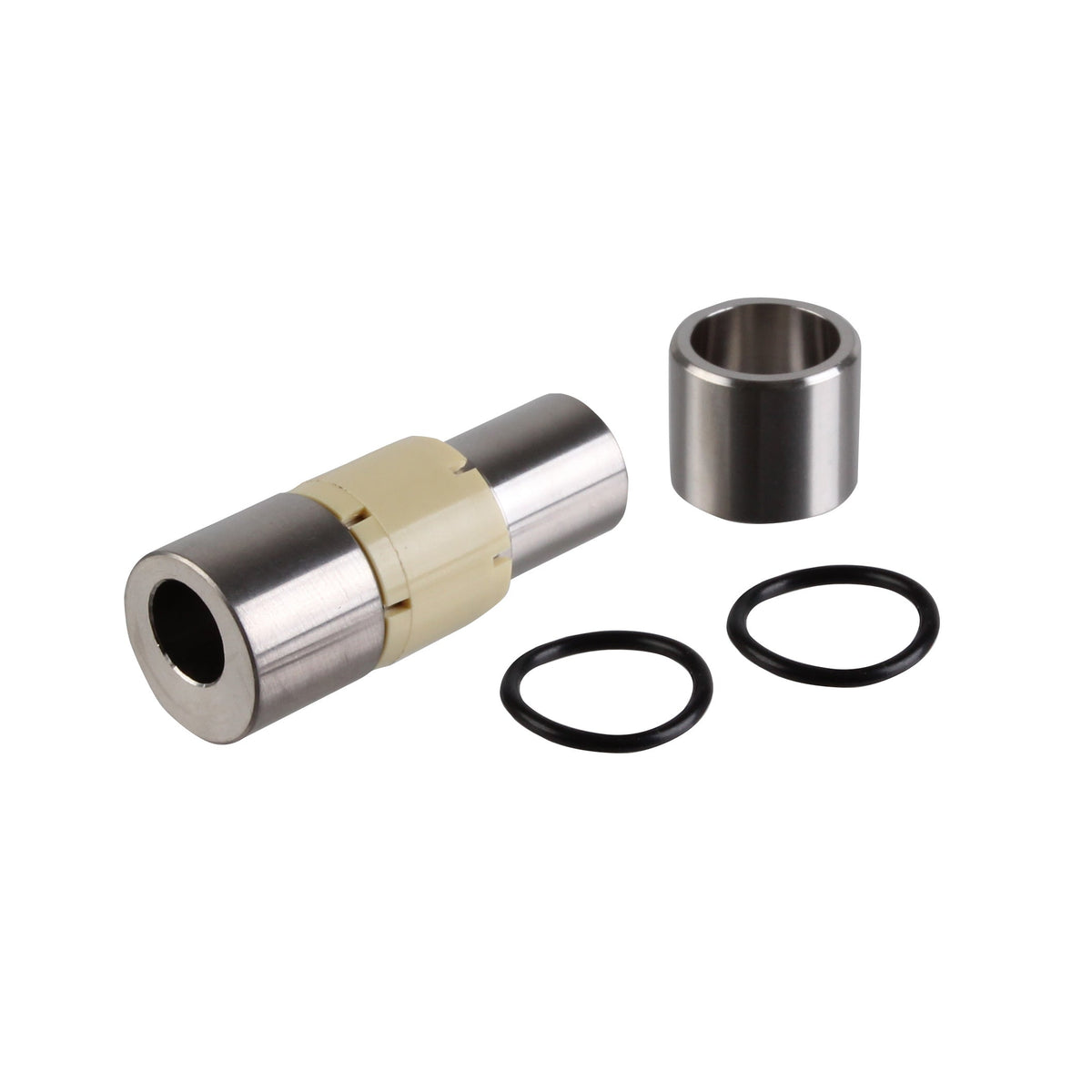

I haven't had this particular issue, but it should be as easy as swapping out the lower bolt & shock hardware which isn't specific to Fox, Rockshox or Trek. A good LBS should have everything you need - 40mm width, 8mm bolt. I just put some burgtec shock hardware on my other bike, nice stuff. Unless you are replacing the bushing, you won't need a press.
(Doesn't include the M8 bolt)
Cheers mate. Will hit up my shop on monday (wasn't trek directly) and see what they do. Guess they'll probably file a claim with trek and then I have to wait. Also, it's a bit of a bummer with the paint chips on such an expensive bike, but I reckon it is just cosmetic damage for now. Question is whether I do my planned ride regardless. 😅
With play, it can certainly cause more damage, but consodering that should be warranty, not to worry?...
Cane creek also has bushings and spacers. Better bolts may be a source for a bolt...
I'd certainly hope that it will get warrantied. Found this (#2,973) post - seems like this is happening due to cheap / wrongly sized bolts?! I'll see whether I can measure mine tomorrow.
Thats the problem!!! You can replace any amount of shocks of any brands and any type of 8mm shock mounting hardware, that WILL NOT HELP!
Only solution is to replace original cheap standard bolt to custom bolt with right (7,99mm) diameter to precisely fit 8mm shock mounting hardware. Otherwise you will NEVER solve this shock knocking and frame damaging prob! Maybe you can hide it for a while (because you tightened mounting hardware more against frame), but if gap between bolt and shock mounting hardware will be present, problem will come again with bigger frame damaging. Shock mounting hardware is ALWAYS exactly 8mm inner diameter, so replacing it with any other brand will not help!
I had a lot of frames in the past and all of them were fitted with custom mounting shock bolts. Dont understand this cheap crap bolt fitted by Trek to so expensive frames ...
What shock did you install? is anything special required to have the shock installed?
It's a Fox Float DHX 1024018-0038-T with a 475 pound factory coil. The orange coils are much lighter than the standard black version. gives around the same travel as the air shock. You'll need some additional hardware for the shock to be fitted.

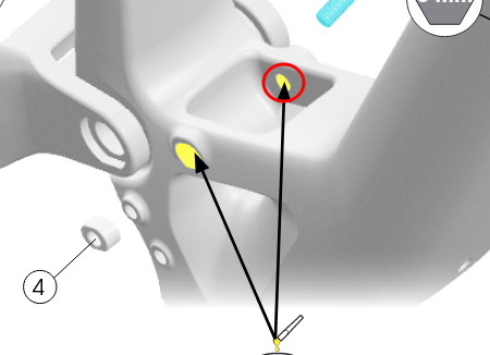

Any clue where to get a properly fitting bolt? Don't have the possibility here to get something made. Service manual has specs as - Lower bolt, M8 x 1 x 60 mm. They link to this bolt in the trek shop. Confusing af, manual specifies 1mm thread pitch and for the bolt in treks shop specs say it's standard M8 dimensions (1.25mm) thread pitch.
Edit: Also just saw that this bolt is steel + zinc coating, stainless steel or even titanium will prob. lead to corrosion in the part were it threads into...
Linked bolt from trek is standard bolt you can buy anywhere and will cause shock rattling and frame damaging.
We solved it locally, asked garage guys to make few custom 7,99mm stainless steel bolts for us. No gap, rattling, knocking any more even shock bolt is tighten only 10 Ncm.
A little anti seize helps with corosion. Has anyone asked Better Bolts? I bet tbey could source one. Otherwise, would check McMaster Carr. Not much they don't have.

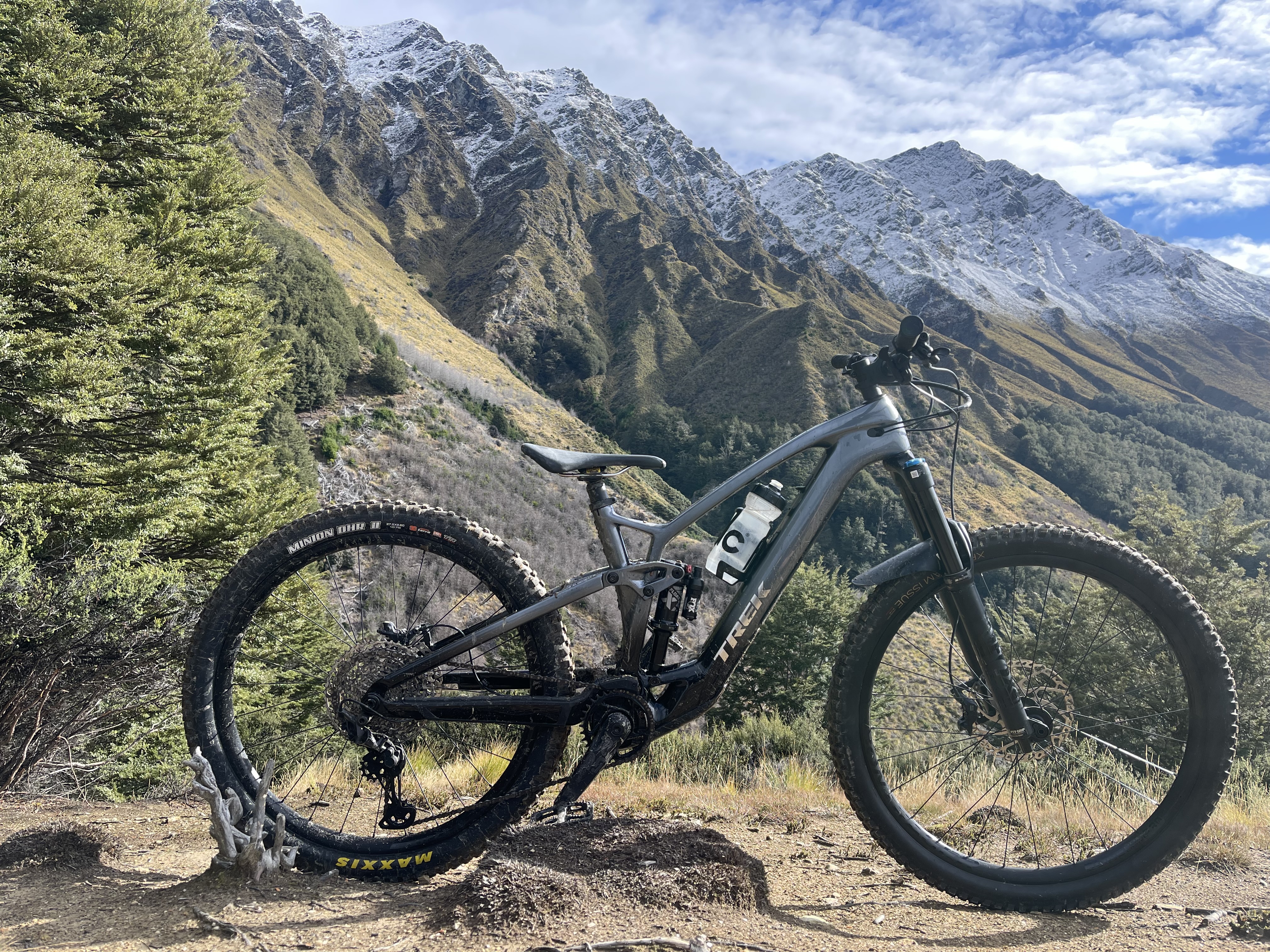

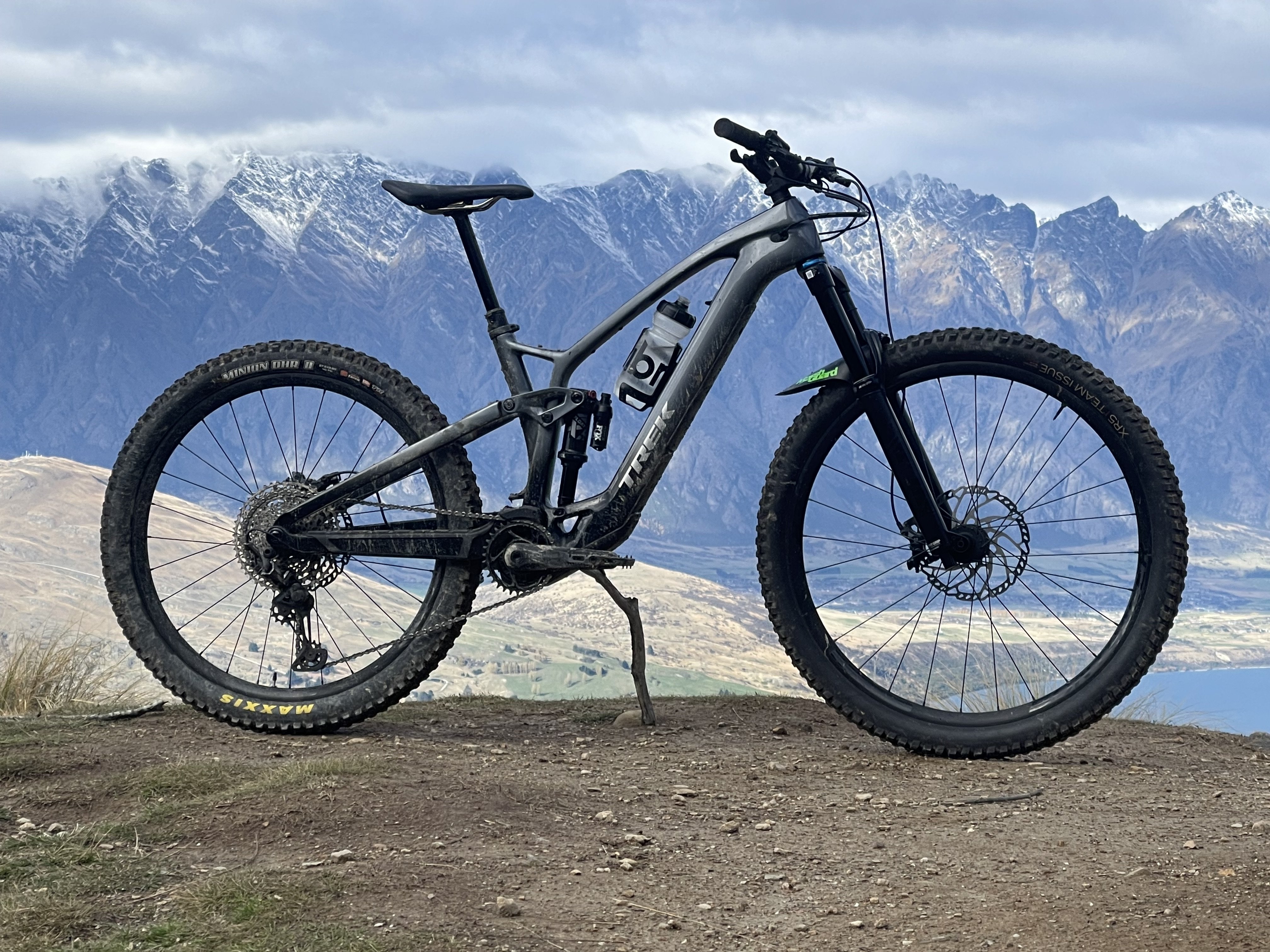

The EXE is in its finished form now with the fork at 160mm and the shock at 152mm. Very happy with how it rides now although I don’t think there are massive gains from any one change. The incremental gains from each mod add up to a better performing package. If I were to rate the mods by added performance and cost ($1 NZD + 60 cents USD) it would be,
1, Mullet + Minion DHR II ($200 NZD - used wheel + New Tyre)
2, Longer travel seatpost - 180mm vs 150mm. ($200NZD - Oneup V2 being specialed out)
3, Extended fork travel from 150mm to 160mm. ($130NZD - replacement airshaft)
4, Remove travel spacers to extend shock travel from 140mm-152mm ($0)
The only improvement to come will be a new front tyre, maybe a Maxxis Assegai. No need for shorter cranks, as Canyon Shawn mentioned 'paying attention to the trail' is all that is required!
