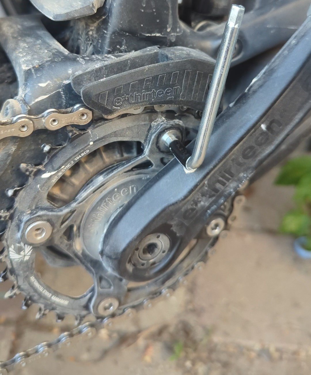

Upgraded to 155mm cranks.
Used the opportunity to also change the chainring. Following some recommendations, changes to xsync chainring paired with xo1 chain.
Pedal strikes are definitely lessened.
Went from 32t stock to 34t. This actually balances the change in crank length nicely.
Added bonus, a quick hack to make lubing the chain easier

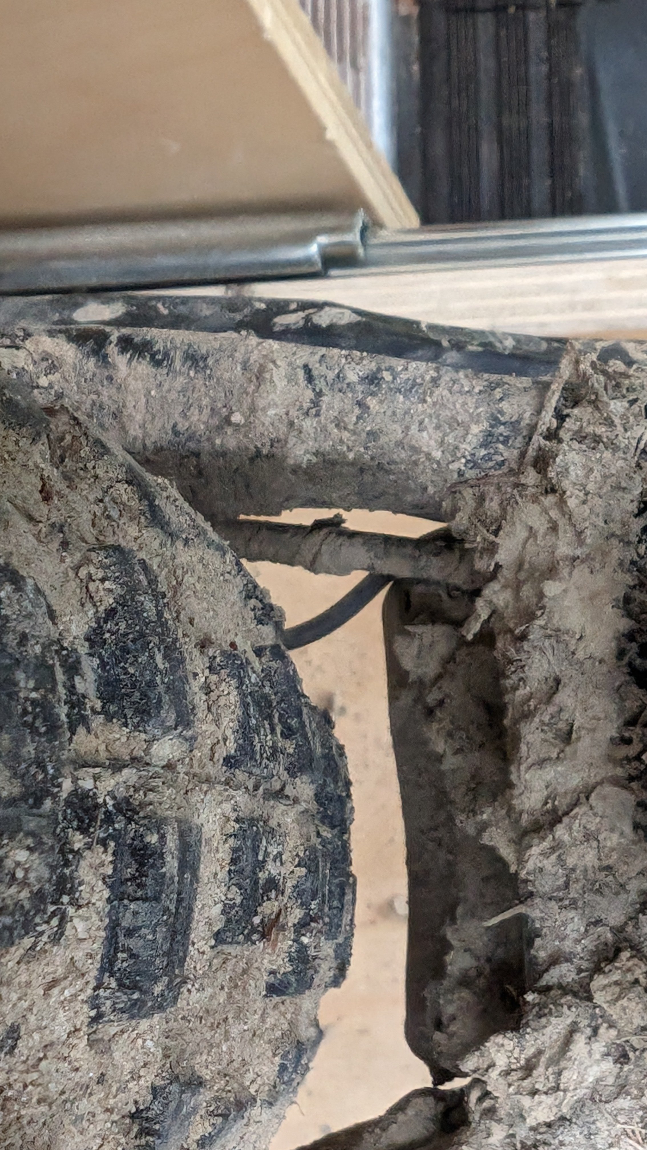

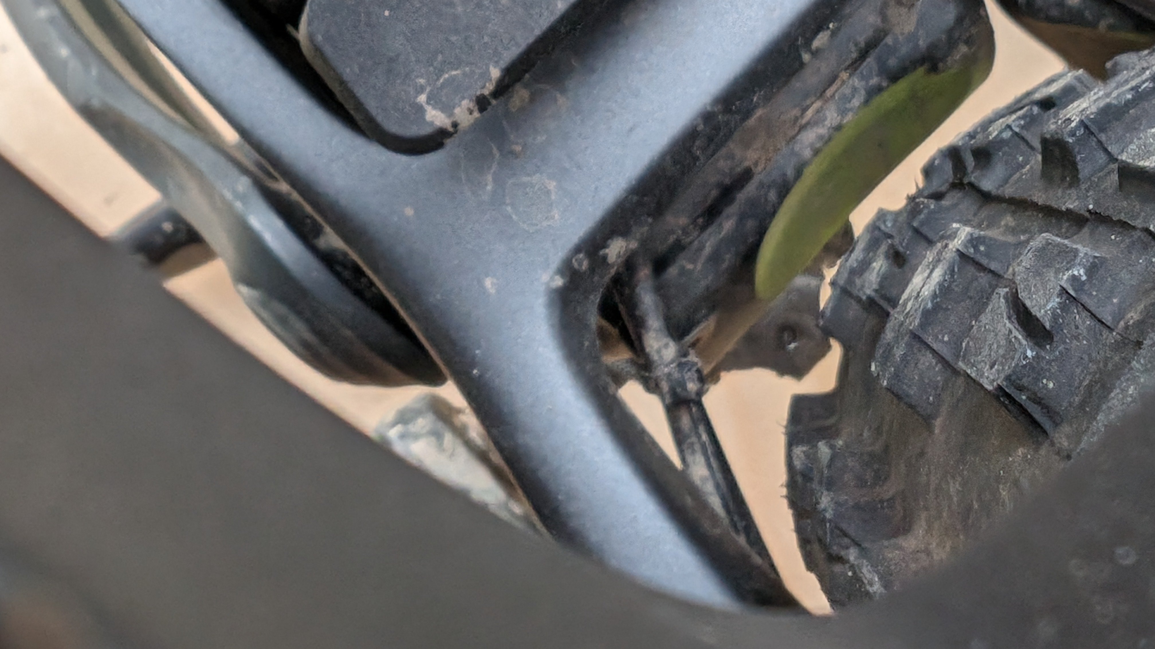

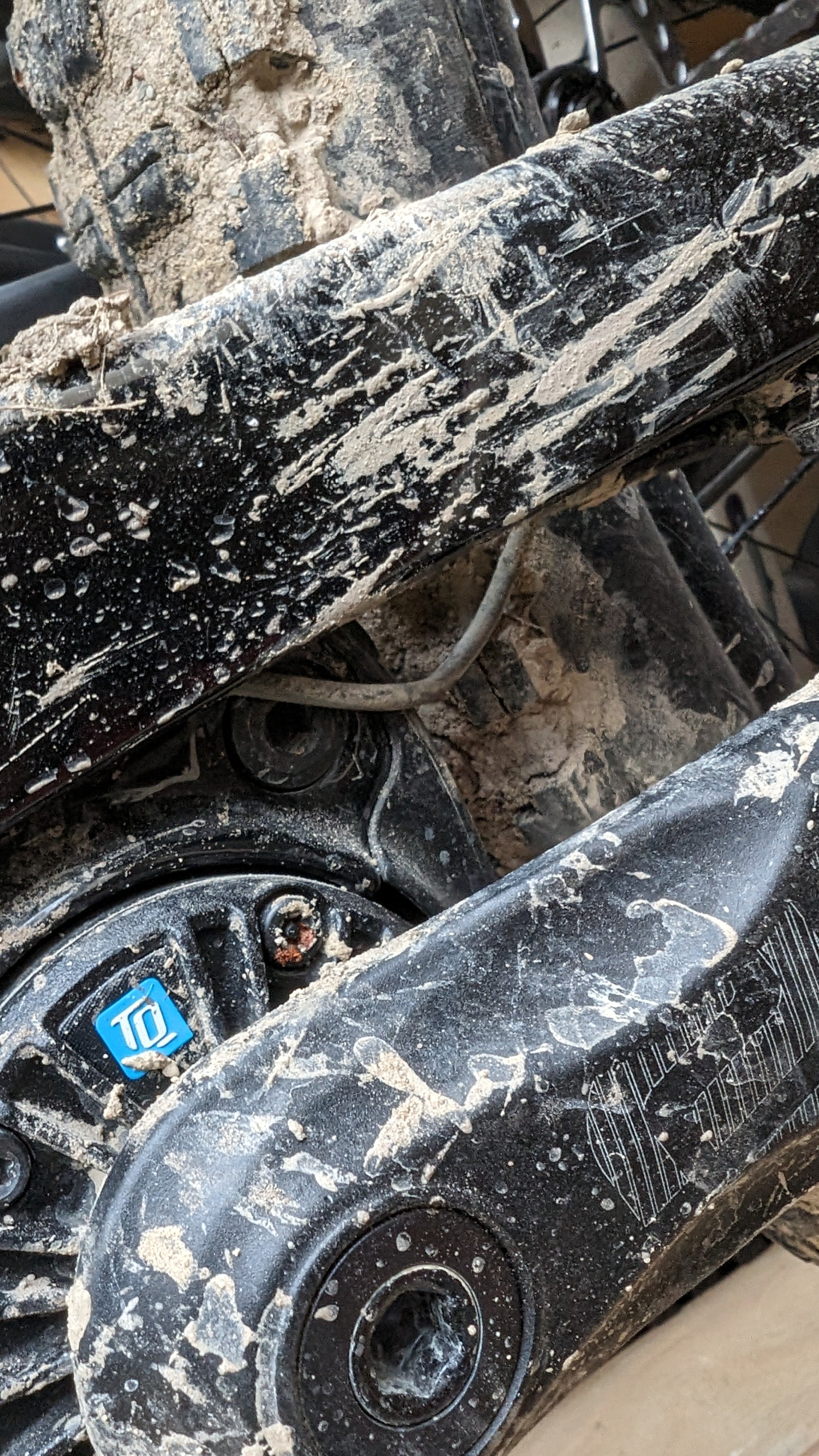

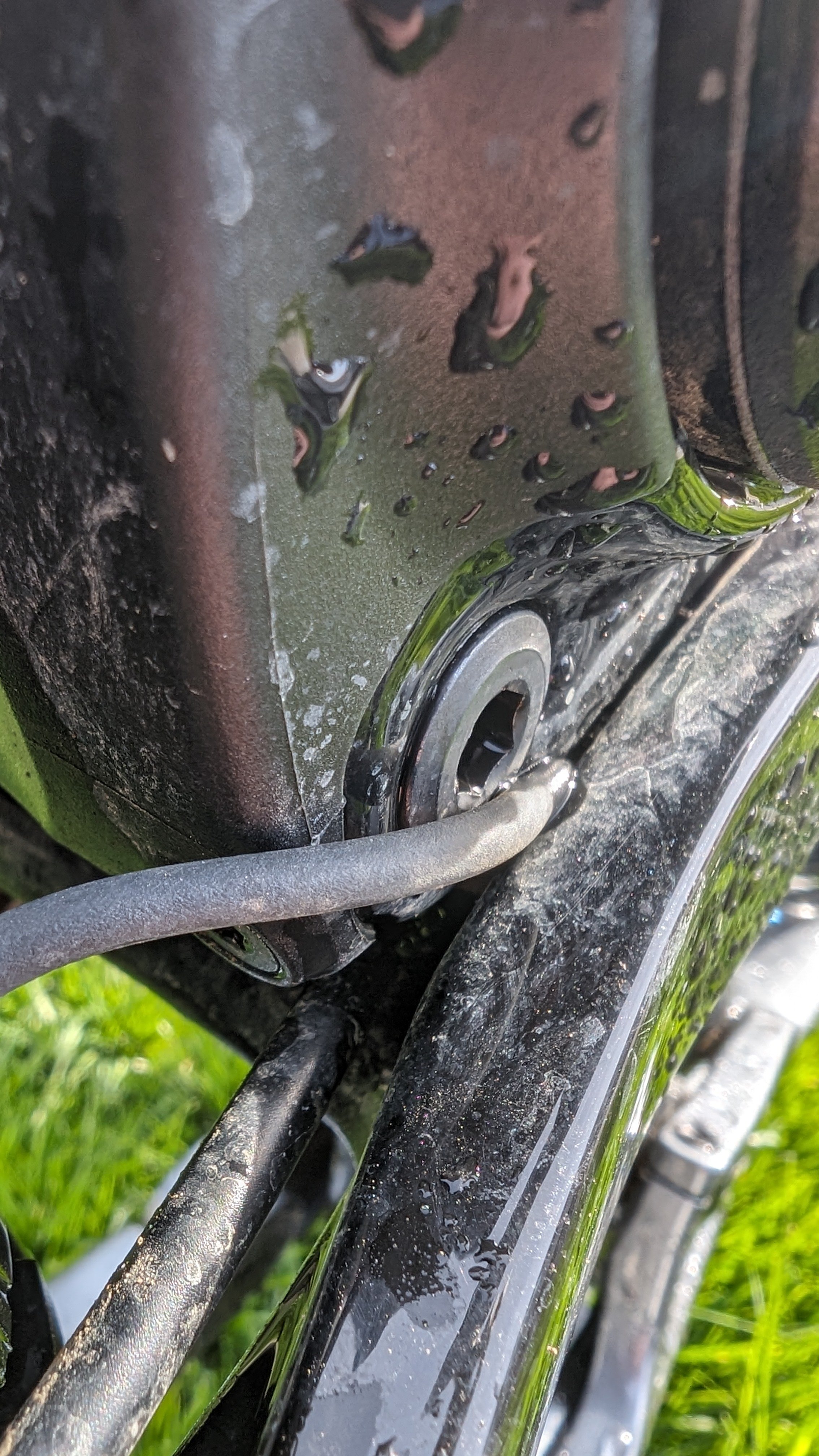

This happened to me yesterday. I lost assist and the "WRN 601 SPD SENS" message scrolled across the screen. A bit later I got assistance back for a few minutes before the error message popped up again.
It appears the speed sensor cable is missing a zip tie and it is wedged between the swingarm and the motor. I'm guessing the wire wasn't hitting the tire while I was riding out of the trail do to suspension sag but It might have gotten snagged over some jumps we hit. I'll update this post when I know more.
Here a few pictures. The muddy tire is my bike. The clean tire is a my wife's bike for reference.

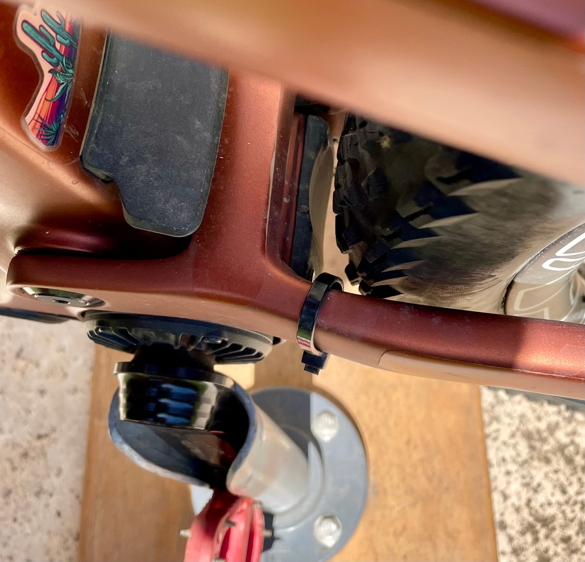

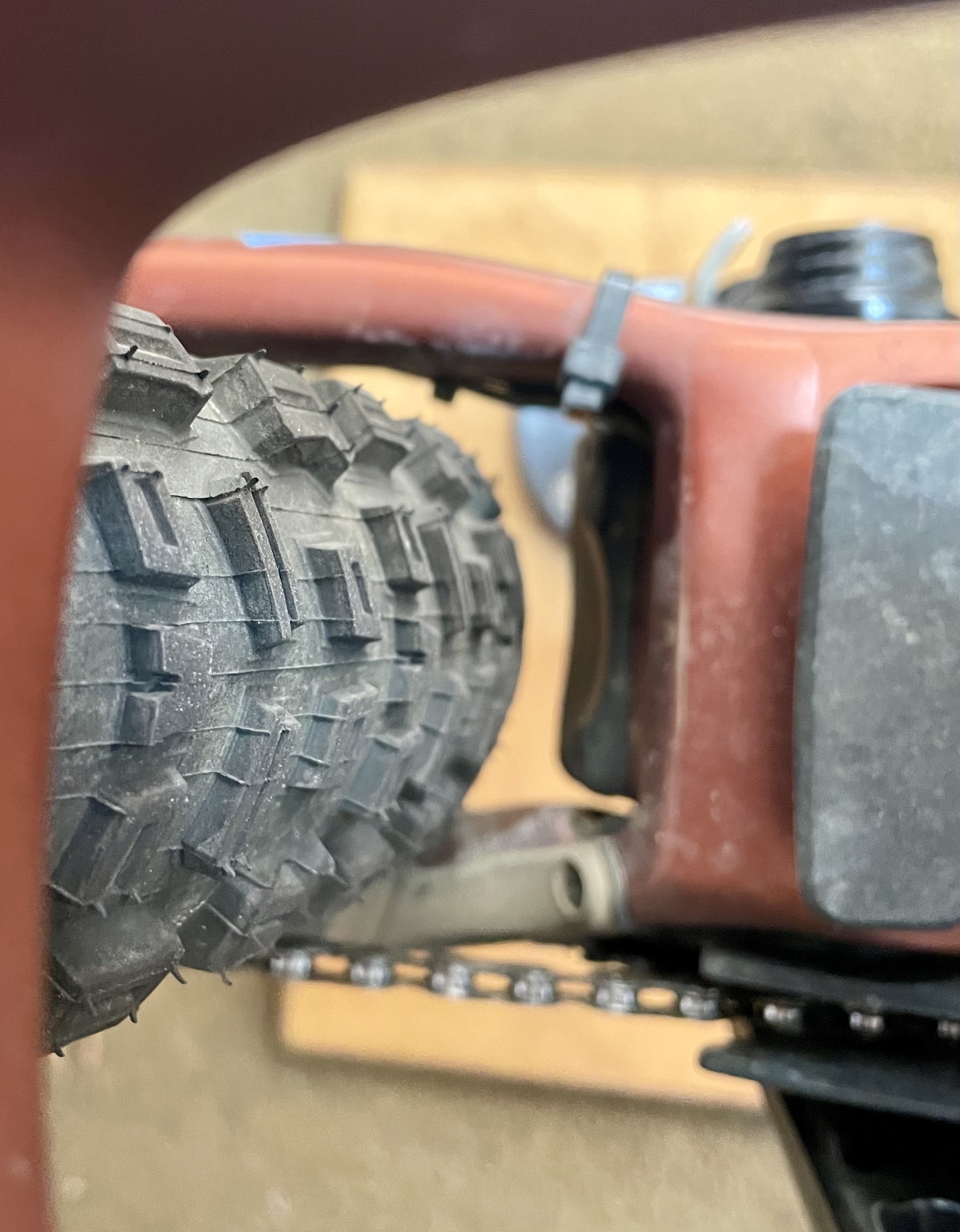

@ohiomoto - We often run wide tires so I used a zip tie to hold the sensor and brake cable against the left chainstay and out of harm’s way. No issues after over 1400 miles.

Here’s my 9.7 with a 29x2.6 Purgatory in back. Plenty of clearance. Zip tie keeps the brake housing and sensor cable safe.

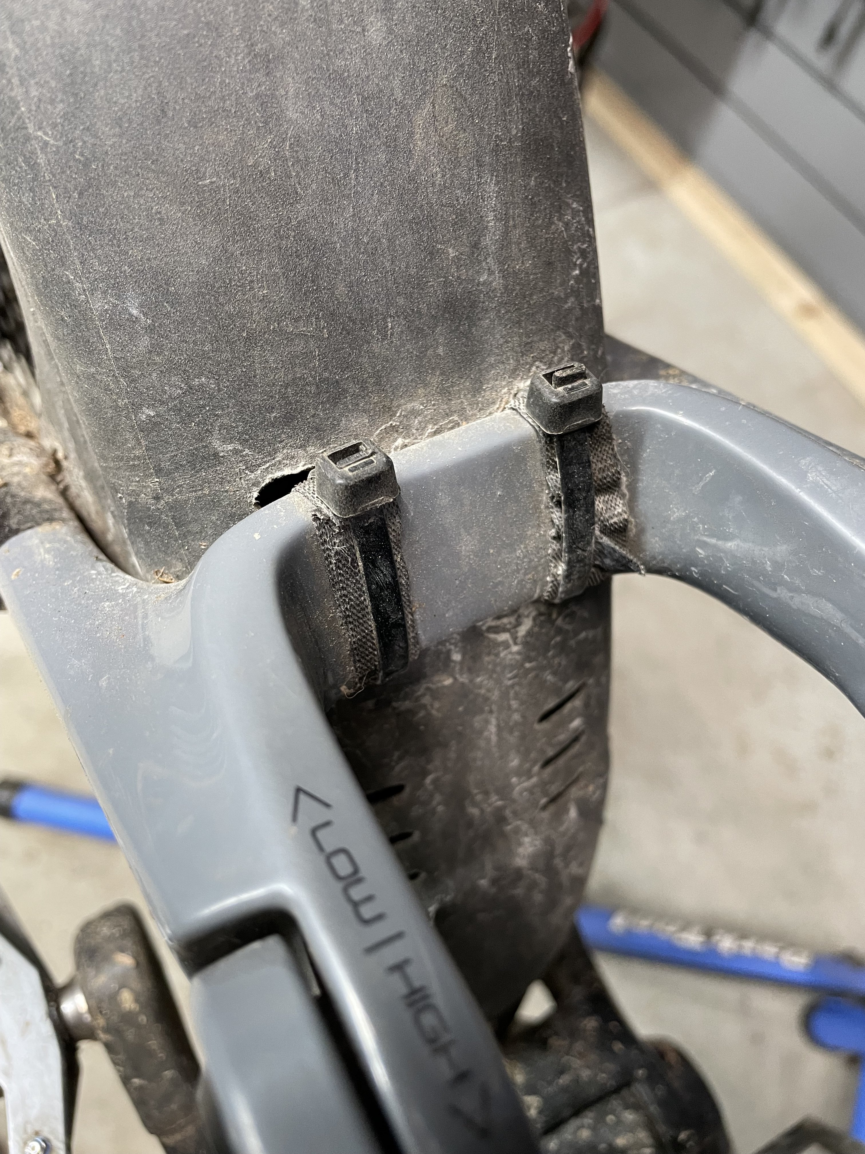

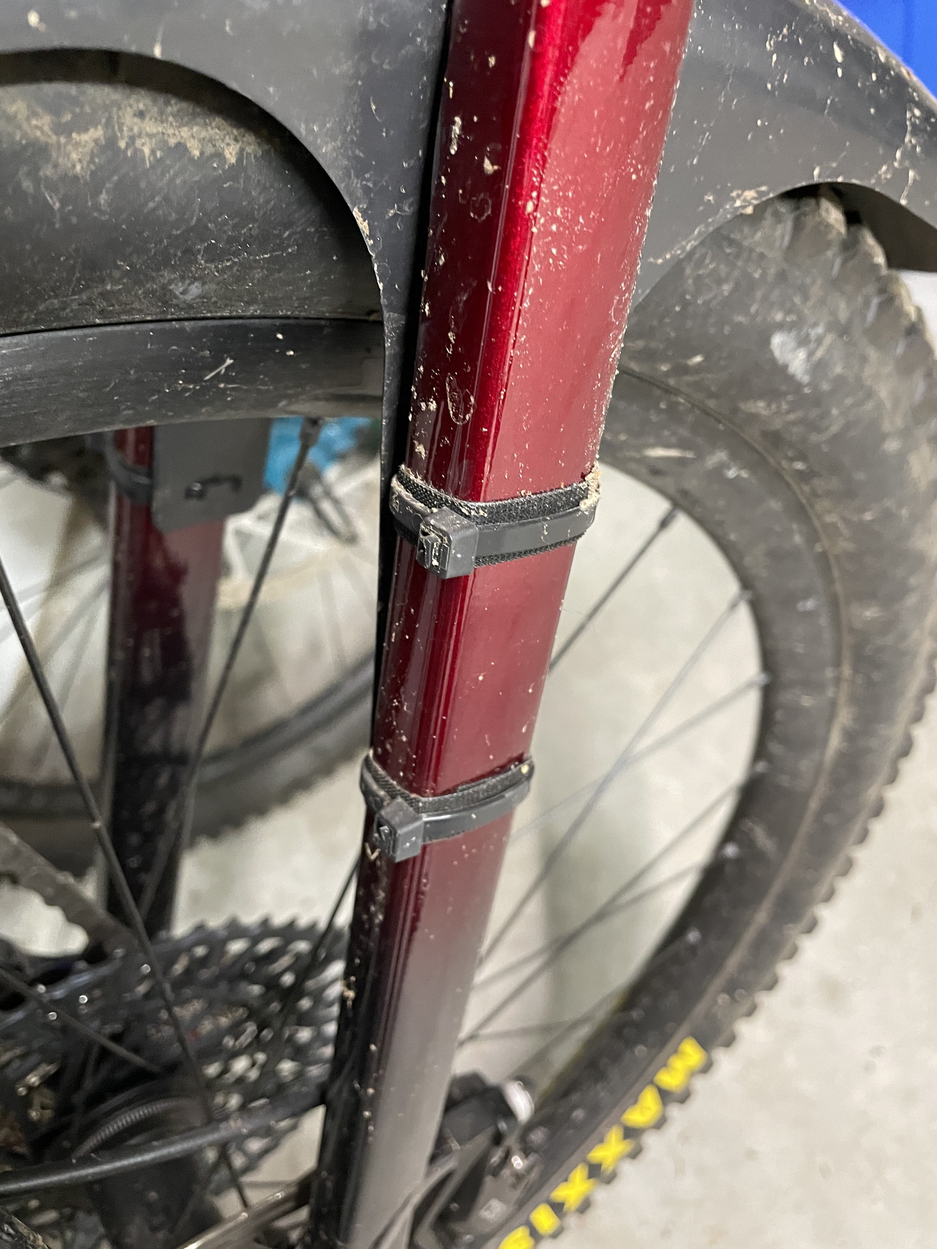

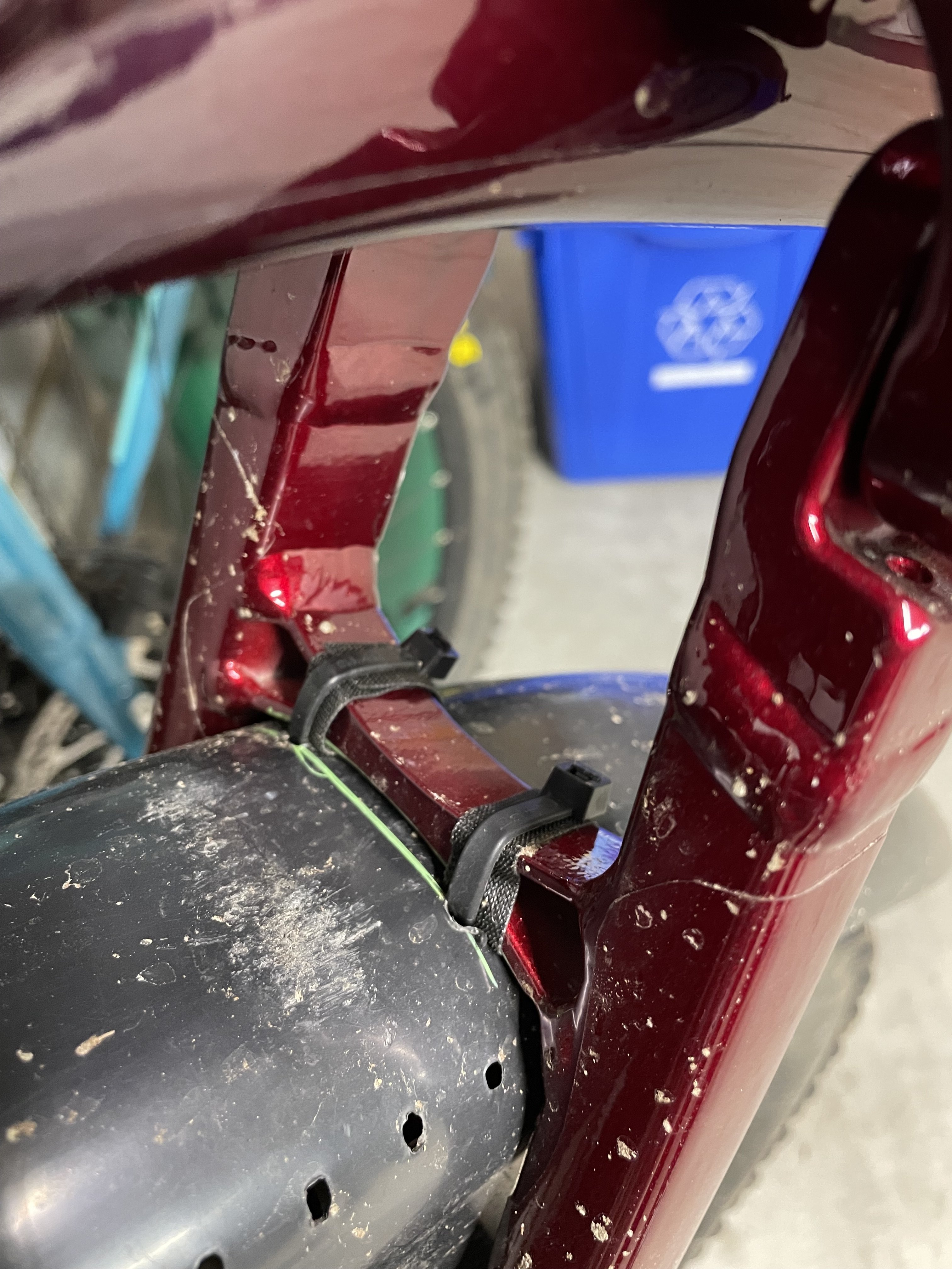

Zip-ties are great for holding back those cables …however they may wear into the paint or carbon after awhile. (Ask how I know).
The rear lower triangle of my Rail 9.7 was worn to the carbon filter when a mechanic thought it would be a good idea to tie back my brake line with a zip-tie. The LBS replaced the lower triangle at their cost.
I use zip-ties for fenders or cables, but I wrap the frame part with soft Velcro first then add the zip-tie.
Seems to help.
View attachment 137793 View attachment 137794 View attachment 137795
I rinsed the mud off of the bike and the cable was definitely pinched. I left the wire as pictured and took it the shop. They extracted the cable and it was damaged. Trek is covering the speed sensor.
