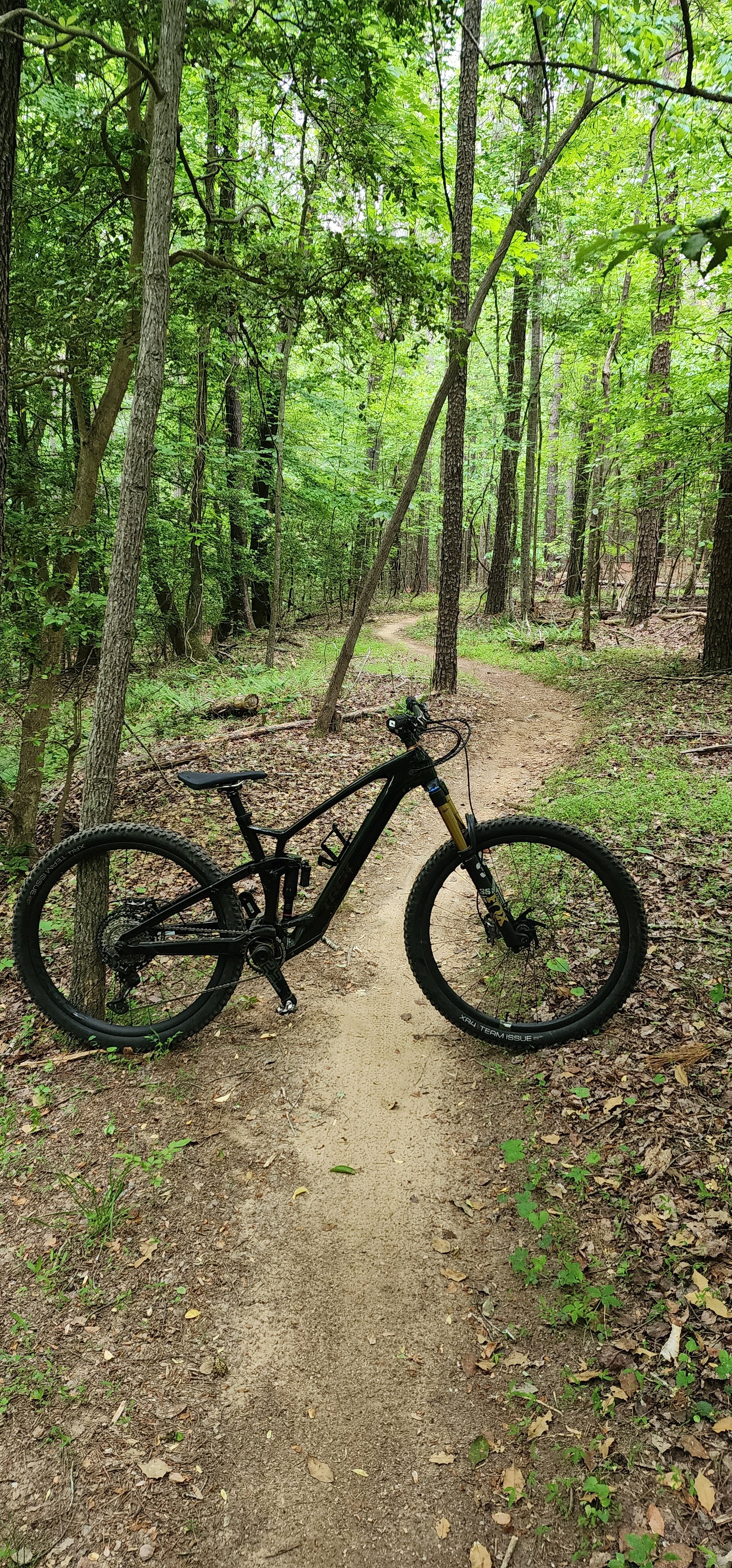

The EXE is in its finished form now with the fork at 160mm and the shock at 152mm.
The only improvement to come will be a new front tyre, maybe a Maxxis Assegai.
Looks great! Assegai up front is a good call, maxgrip casing @18-20psi if you ride wet conditions.

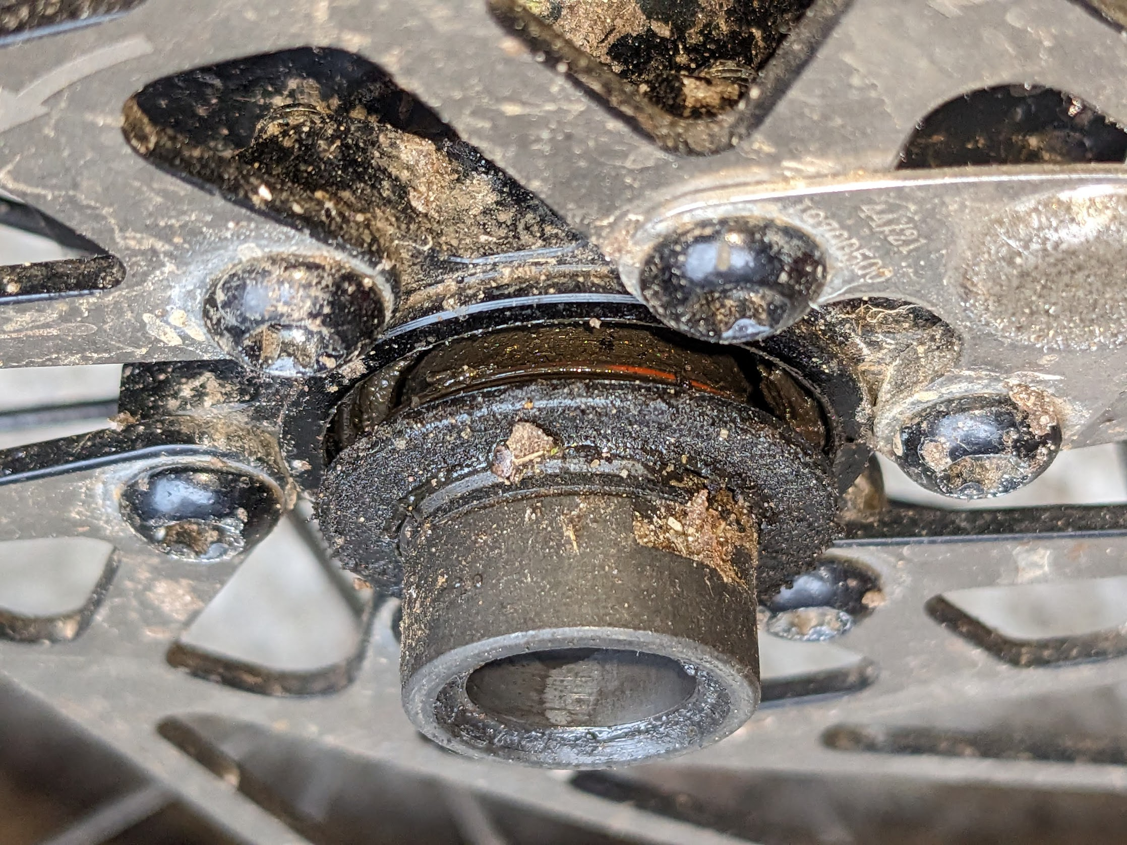

Hmmm. So, reason I asked about maintenance was that on the last ride I was getting some *BAD* noise coming from underneath/behind me. Couldn't locate/diagnose it on the trail, so limped home. Took a look at the rear wheel today, and...
...yeah. Not sure what kind of Bontrager hub my 9.5 got shipped with, but it basically loosened itself a bit and spat out some bearings. It's not working well any more.
