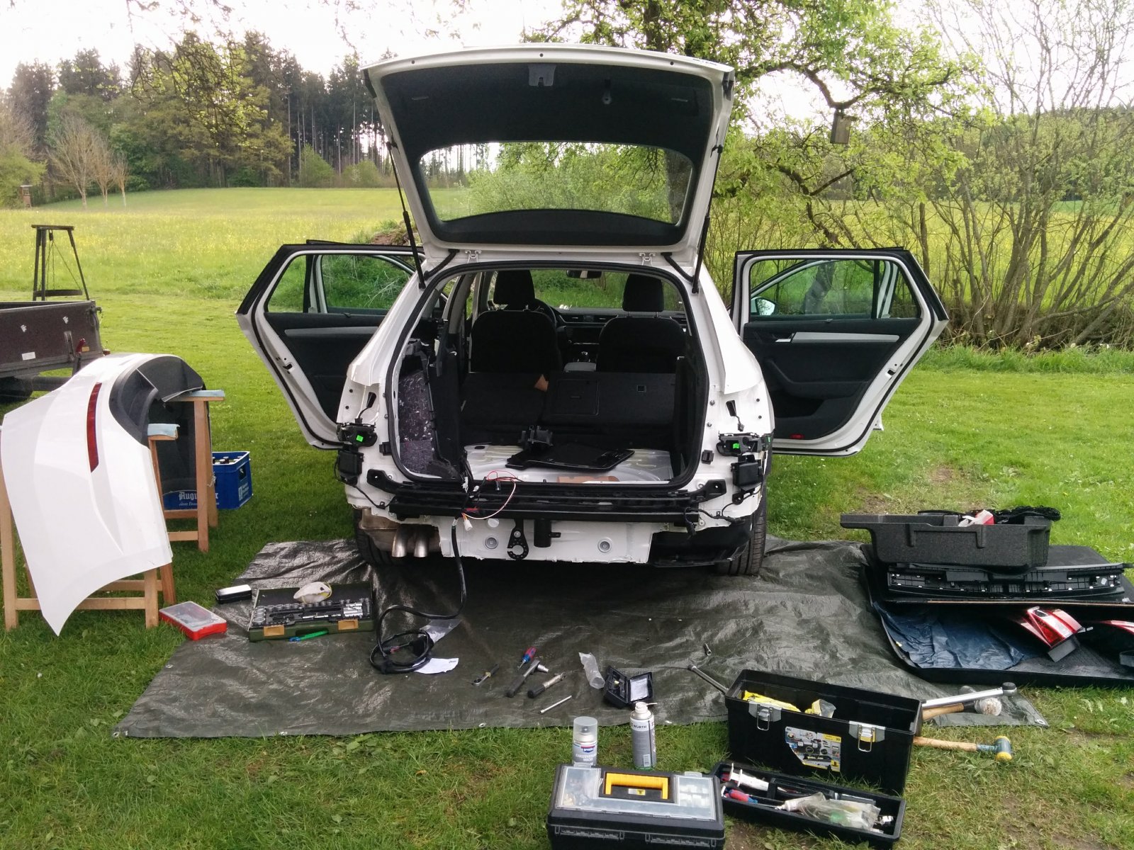

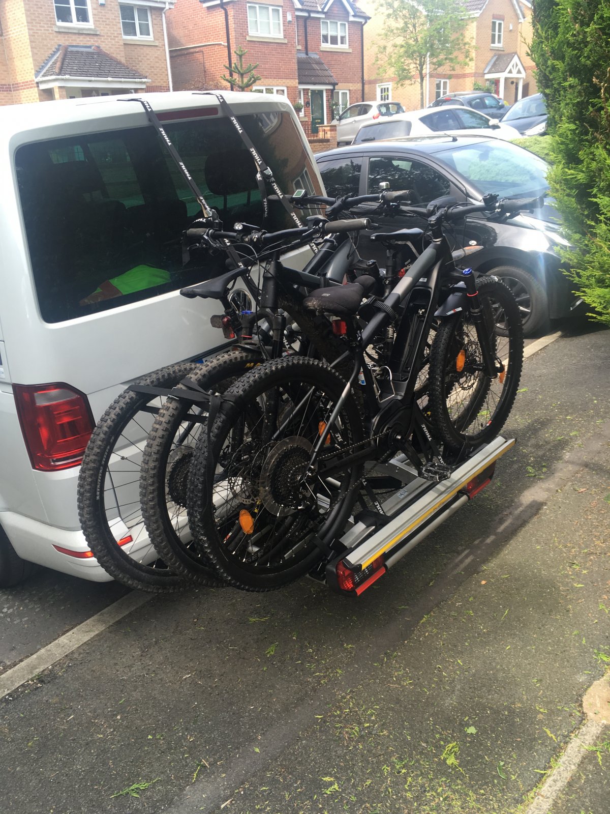

I fitted my towbar myself on my brand new Skoda Superb. Wasn't too difficult, but took me longer than the time they said in the instructions.
I also use the Thule Carrier. I can carry 4 bikes with it. 2 emtbs and 2 Clockworks are within the weight limit.

Wow looks good. What is the weight limit just out of interest?

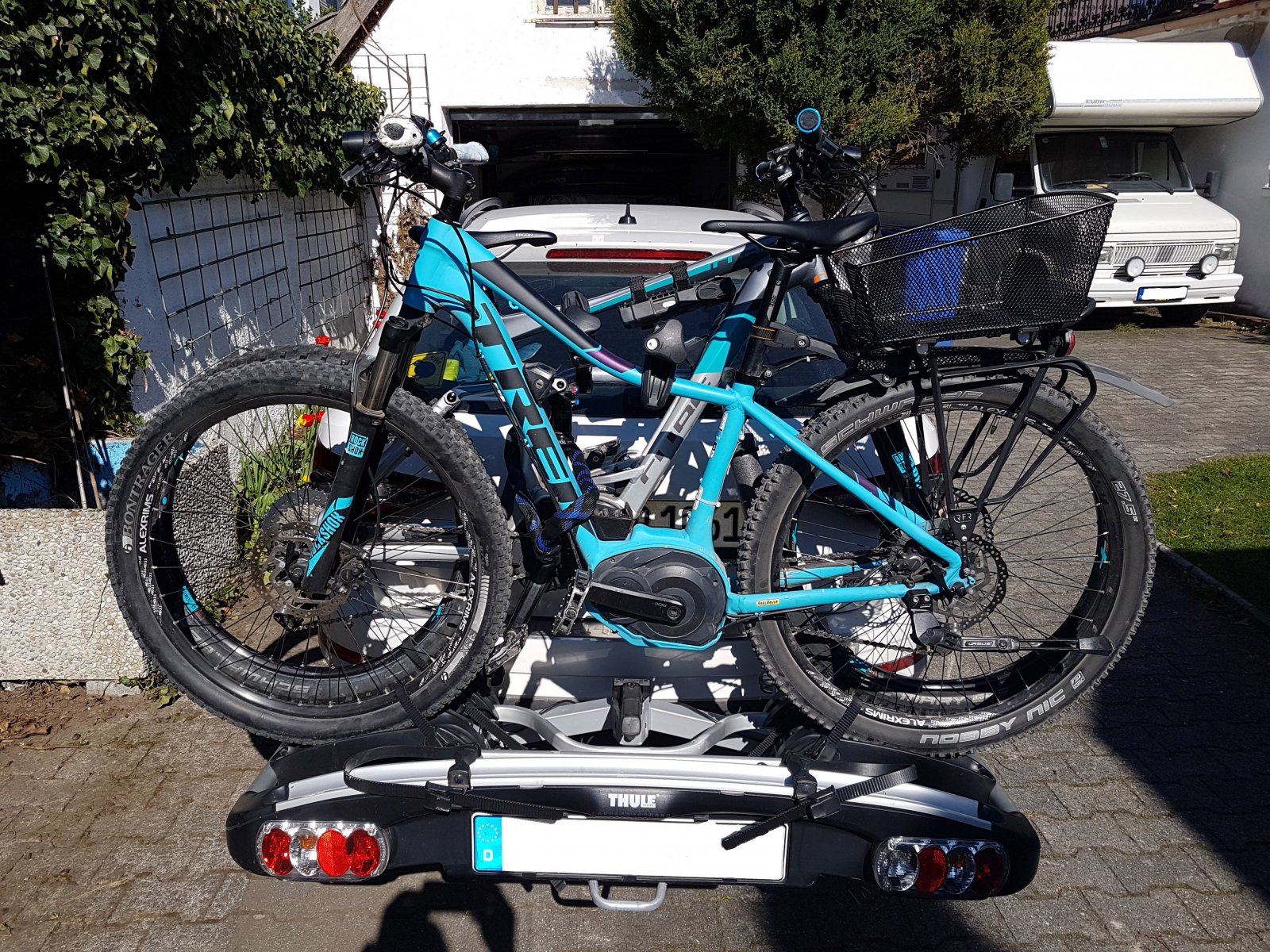

And i can recommend the Thule euroway g2 923!
It’s officially made for 3 bikes but i use it for 2 because it can handle more load. It can also handle 2.8+ thick tyres of e-mtb’s. Another plus of the Thule is that you can individually set the bike length mounts (the black bars where you place the wheels of the mtb).
Here’s a picture with my DH bike in Germany:

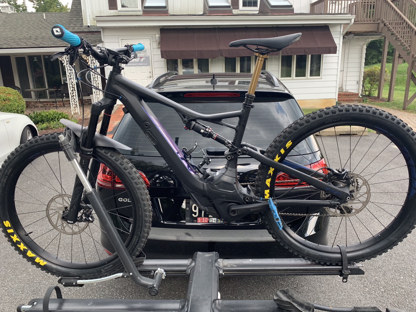

My rig... Kuat Core and aftermarket hitch.
