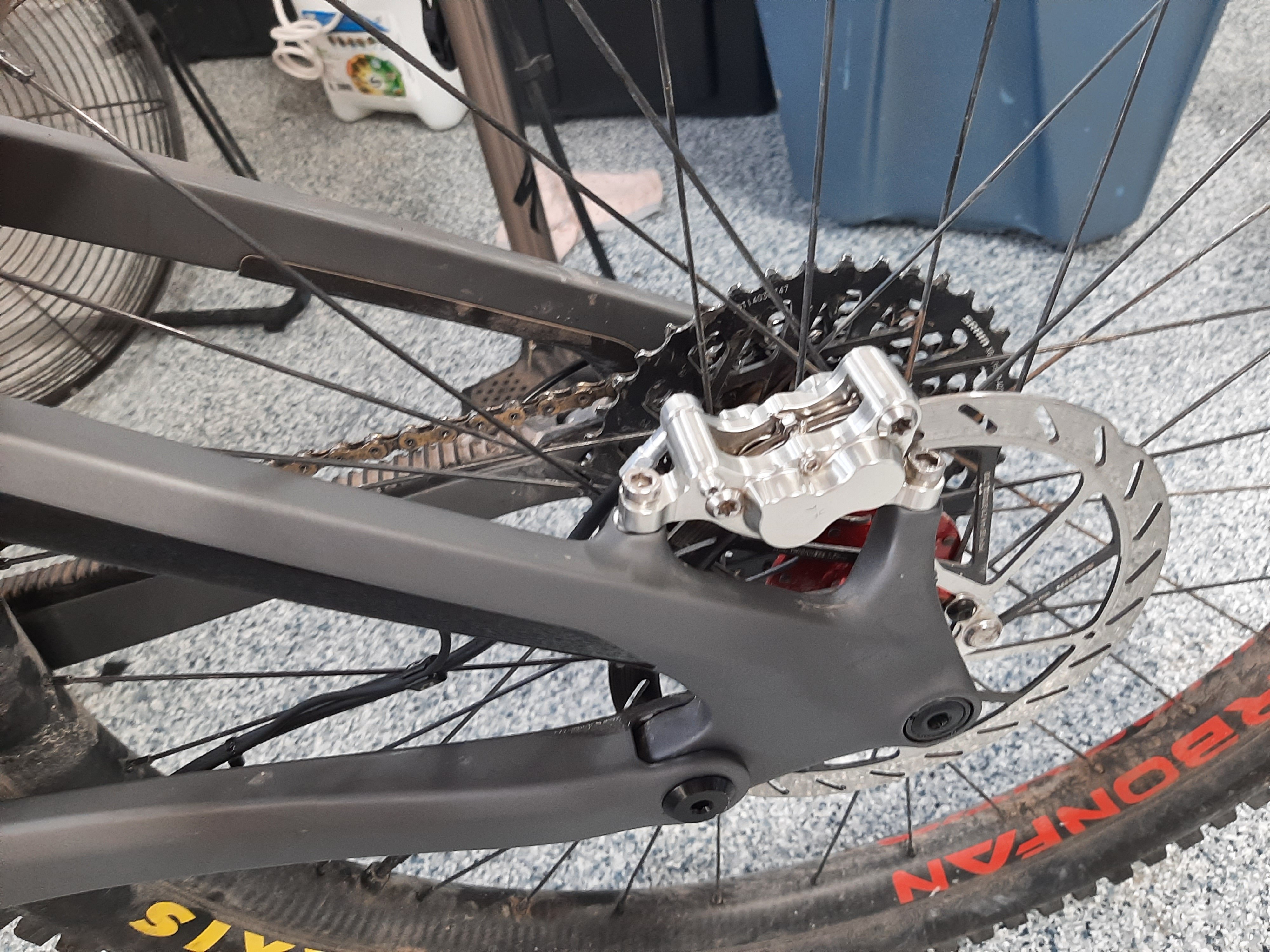

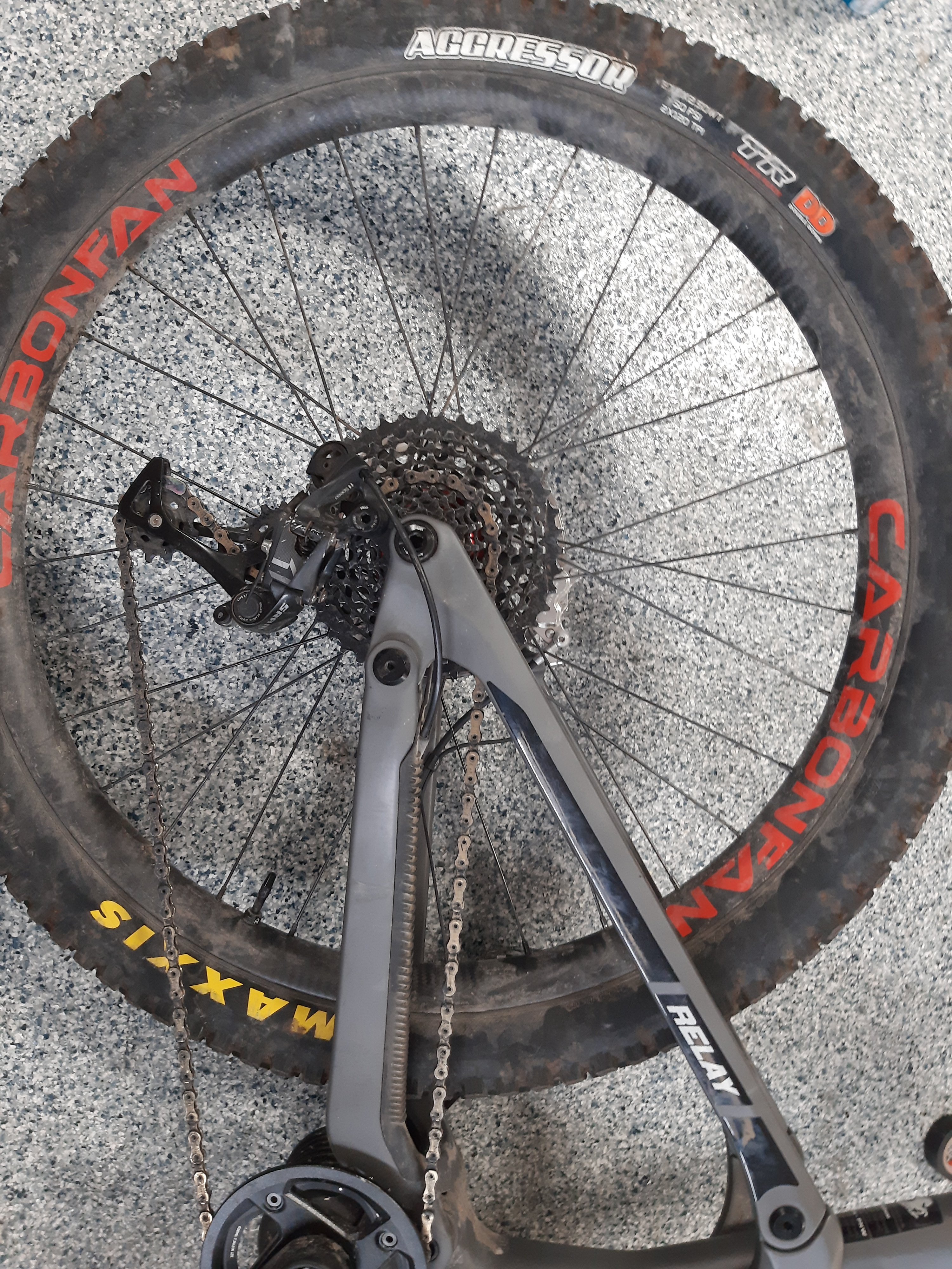

Anyways, I swapped to 11 speed as I prefer it (better clearance, lighter, all steel cassette, no accidental downshift to a 50 tooth) and installed my rear Trickstuff brake (not a fun job!) and it now weighs 43.5#s. That's an XL mullet, dual inserts, 210mm dropper, DD rear tire & Exo+ tires, sturdy wheels, tools, pedals & cage.
I'm pleased with that weight.
