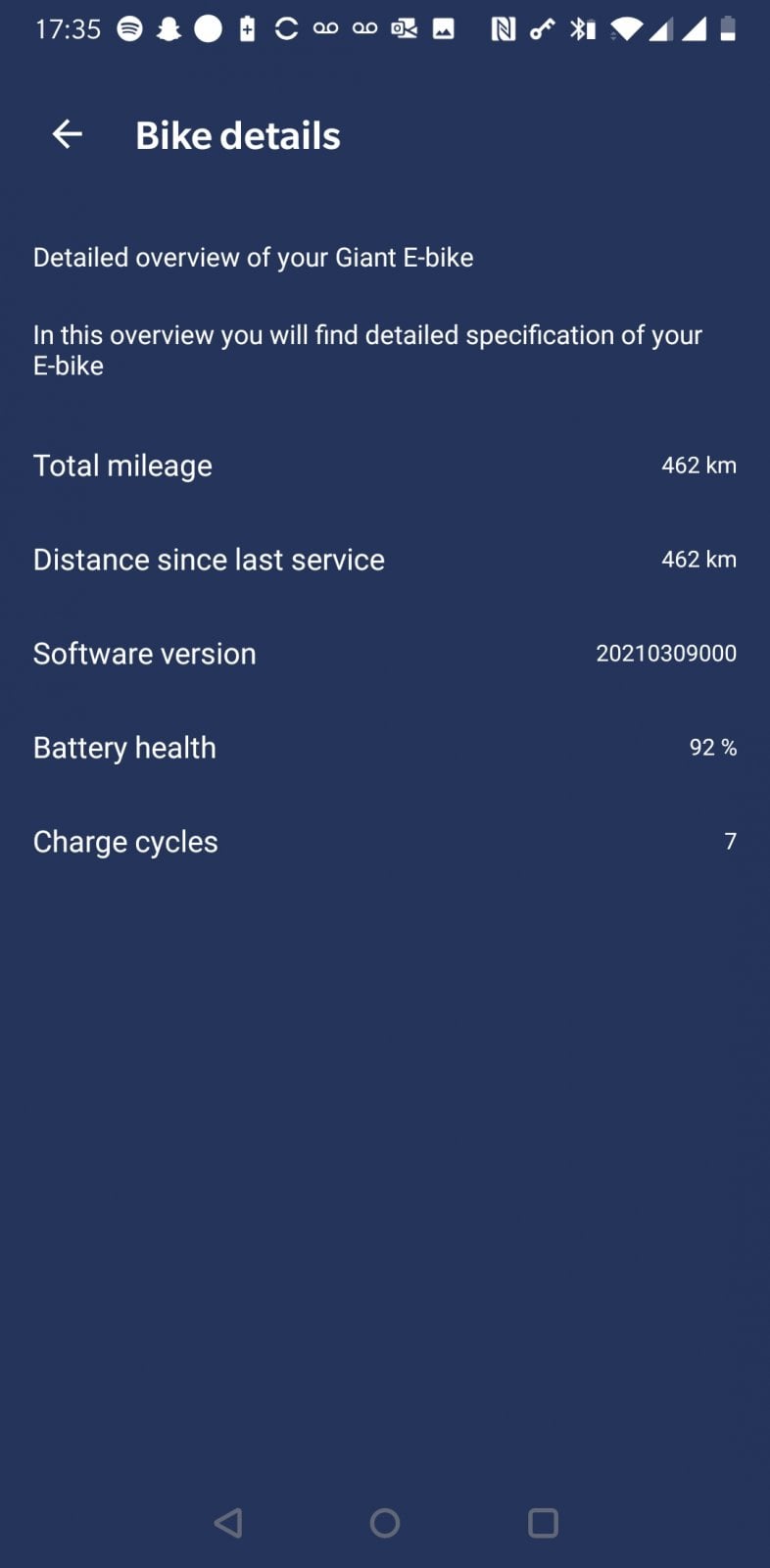

How did you get on? Mines had 7 charges and is at 92% that's not good.
