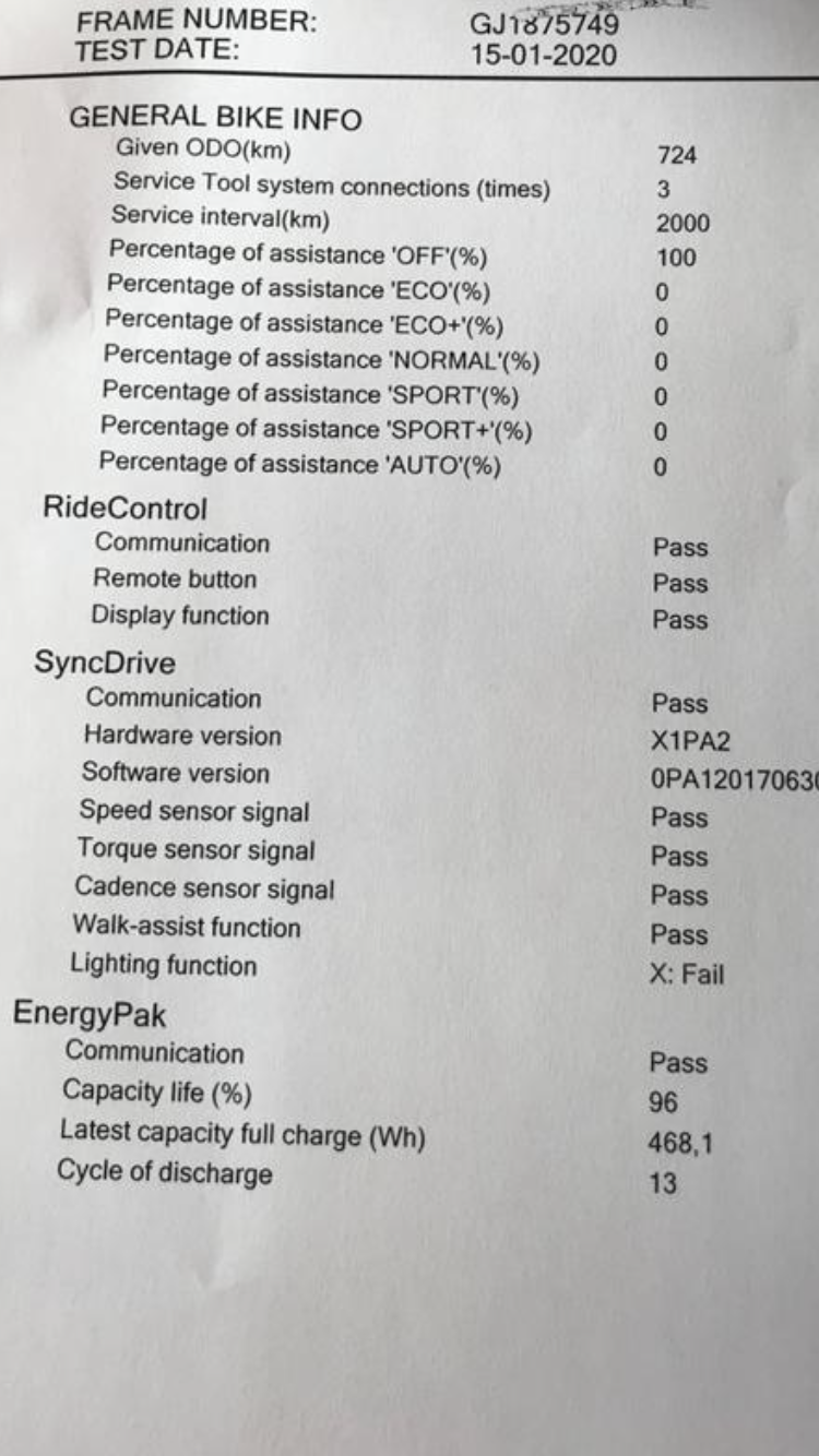

Hi I am looking at buying a used Trance E+2 and the diagnostic report shows capacity at 96%, attached is the report is this a good buy, the price is really good for a 2019 model with 700km.

That report is pretty normal. I algo got 96% after 10 cycles and it has remained at that % after 40 cycles. It is weird that shows no real usage of the drive modes (off 100%???).
When I buy a used bike I am more worried about mechanical issues than electronic, because this motor is pretty solid.
Good Luck!

That report is pretty normal. I algo got 96% after 10 cycles and it has remained at that % after 40 cycles. It is wierd that shows no real usage of the drive modes (off 100%???).
Good Luck!
Thank you KuRi, according to the bike shop that tested it they say that the control was changed. Thanks for the feedback. The price is too good to miss out on for this bike.

I think you need to connect to the bike directly. I tried getting all bluetooth messages from the control and all I got is the same you get on the app :(
