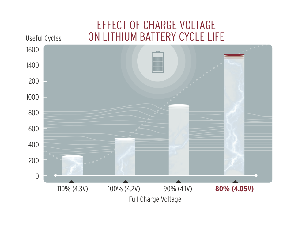

  • Extending battery life cycle by setting charging limit to 80% generally, 100% for longer rides
