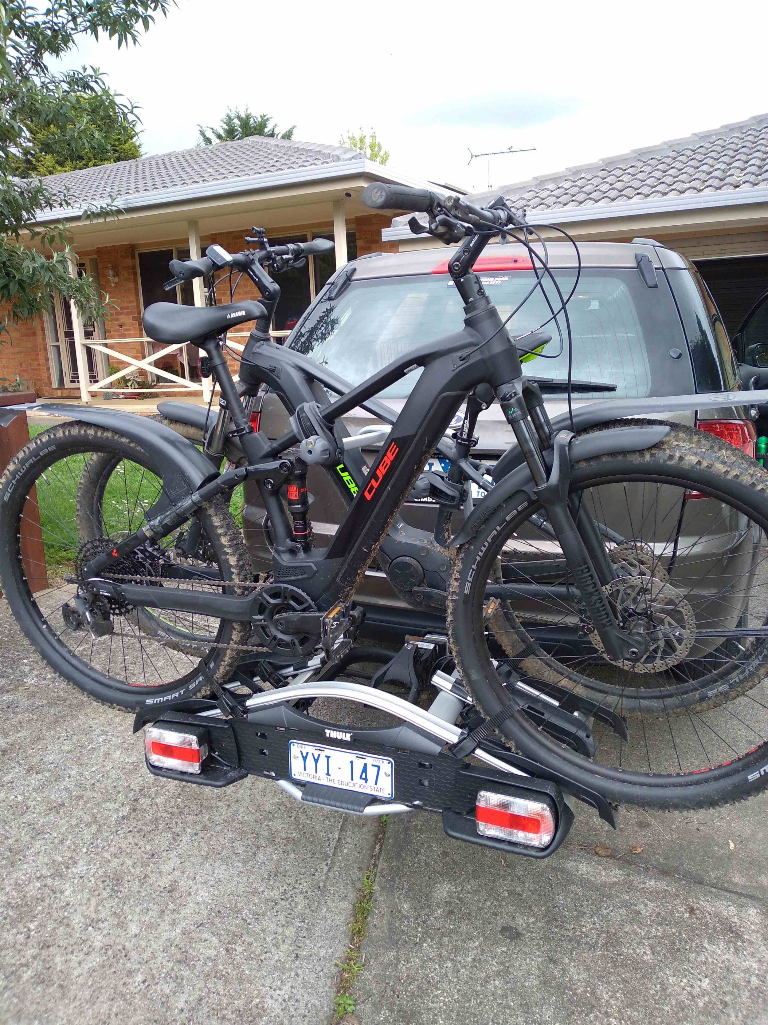

This is an old photo showing 2.6" Smart Sams on the bike; knobby tyres are slightly wider but they still fit ok - got DHR 2.6 on the back now and DHF 2.5 on the front.
The medium Cube Stereo has a ~1225mm wheelbase and I wouldn't want to go much longer on this rack, but it works just fine for our bikes.
I borrowed a Velocompact 2 and it took my Large Cube with 2.6 tyres just, but no problem
Different story when I picked my mate up and added a second e-bike. It was moving about all over due to the excess weight

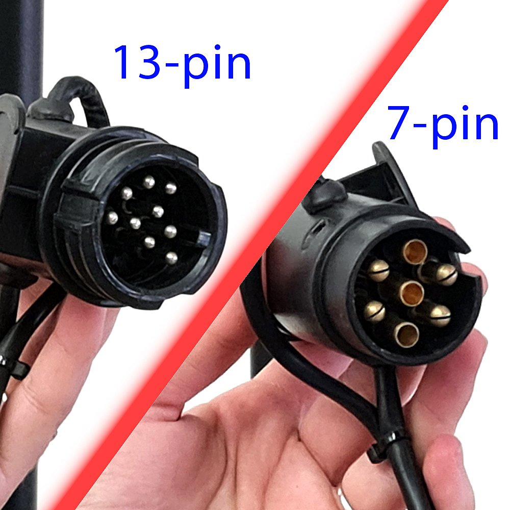

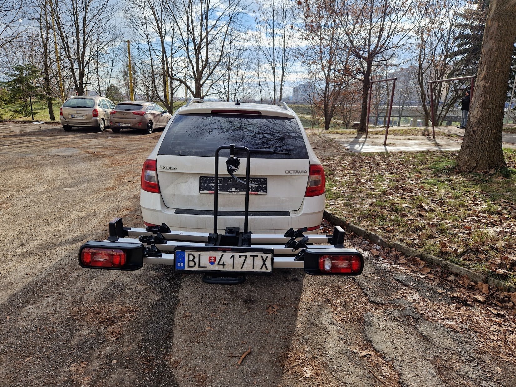

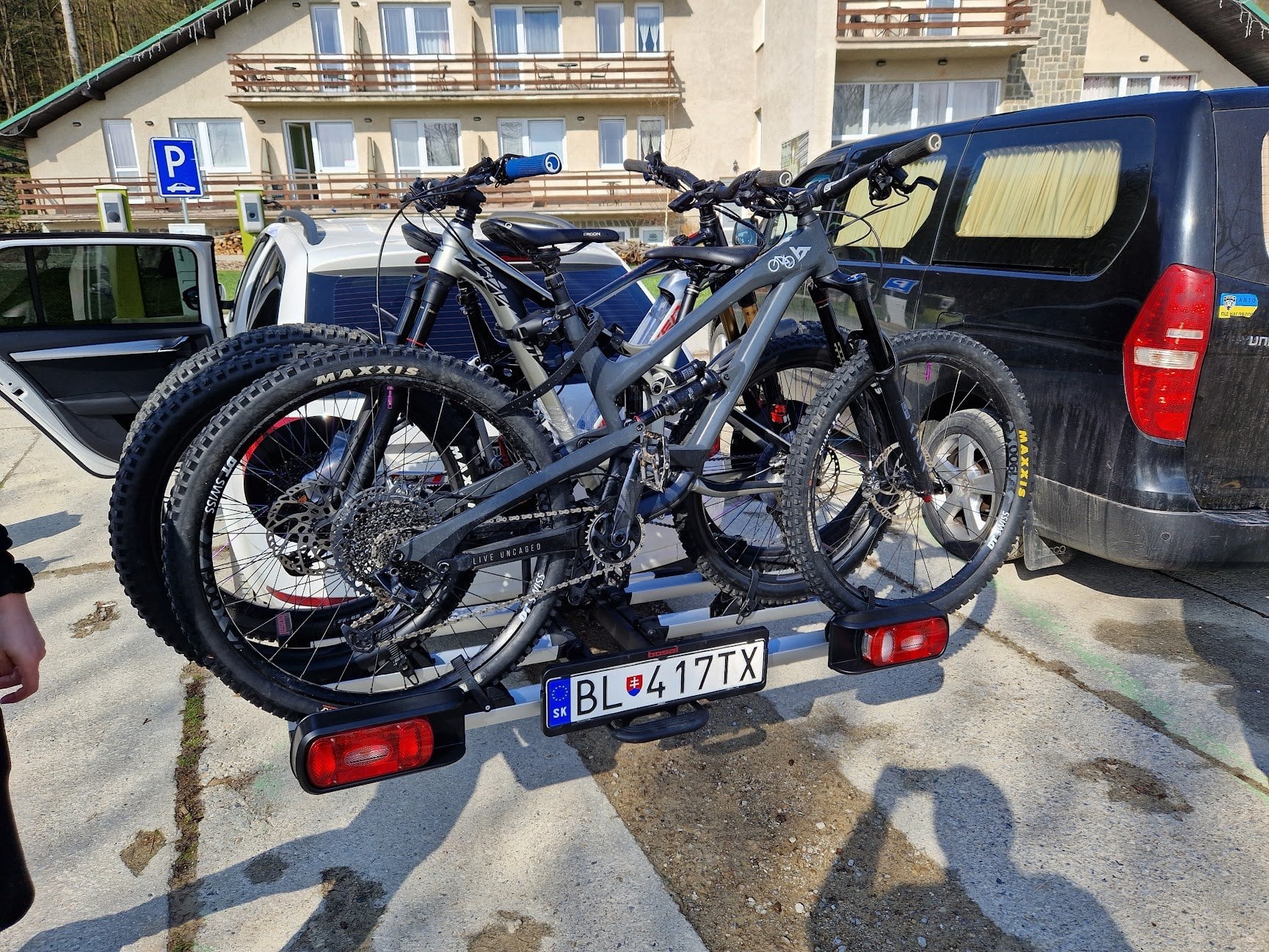

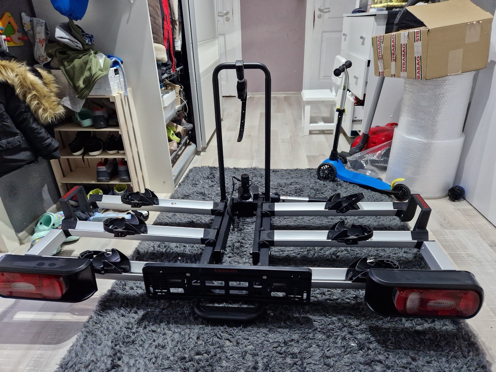

Hi, I am using a bosal comfort pro III. no problem with 3 ebikes, or 2 ebikes and 1 enduro.The belts are wide, the distance between the wheels is up to 150 cm, adapted for the wide tubes of e-bikes, 7 and 13 pin socket, light, handy and strong
20230131_103840.jpg 20230131_103942.jpg 20230131_121235.jpg 20230131_121622.jpg 20230416_092101.jpg upinanie-ebike.jpg zasuvka13-7.jpg

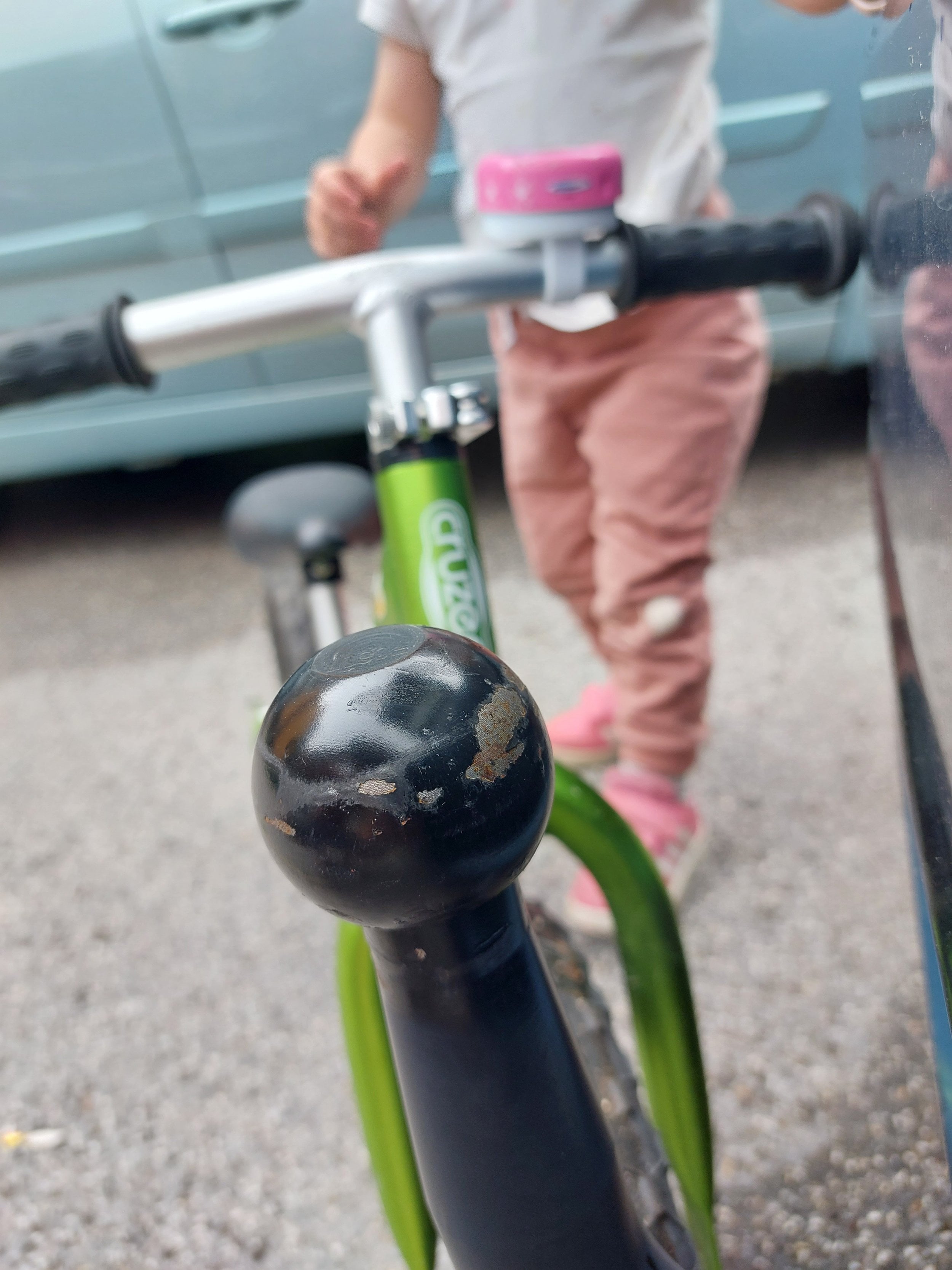

Hey tow ball bike rack experts!
I have thule easy fold xt3 and I love it. It is very easy to use and quick to attach.
But I have a question.

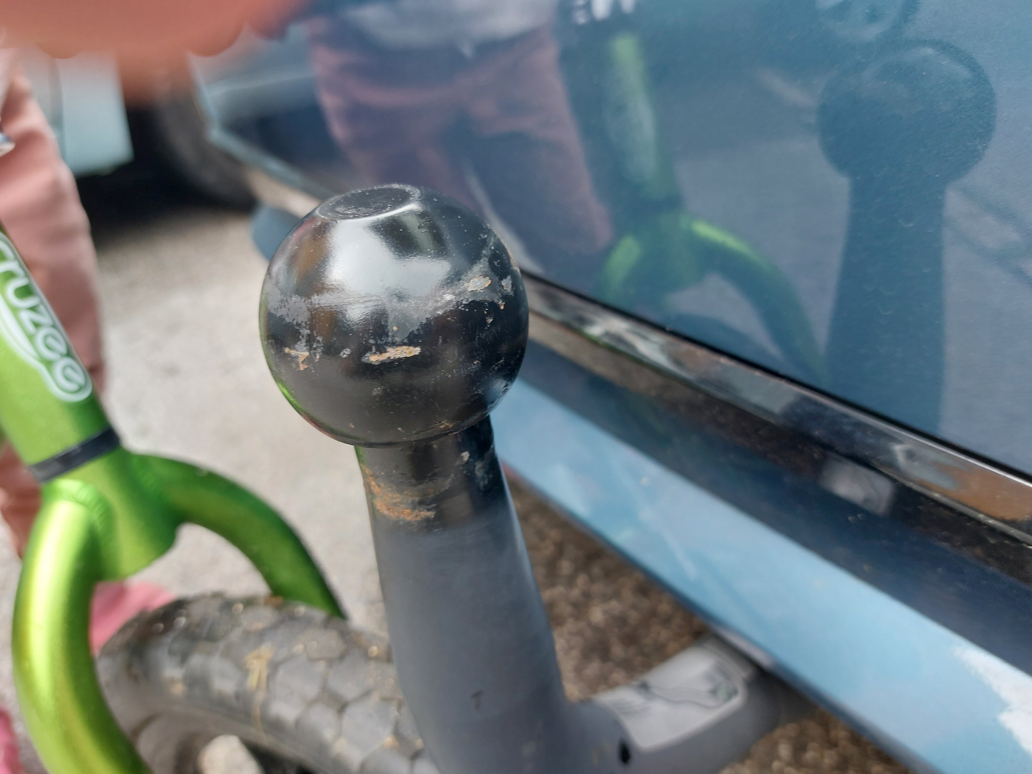

Is it normal, if my towball looks like this after cca 10 uses? Am I clamping it too hard, or is my tow ball not that great? It looks like clamping mechanism removed some of the protective paint, so small rust spots started to appear. I don't use it for towing, only for bike rack.
What do you think?
What do you think?
View attachment 121921 View attachment 121922
Mine is the same, and my previous car was the same too.
I bought a cover for the tow ball (a black rubber thing textured like a golf ball), and I give the ball a quick wipe and put the cover on before I press the button in the boot to put the tow ball away!
Saves it getting rusty whilst under the car…
What do you think?
I don’t understand how a tow-ball could stabilize a bike rack. Unless the torque is extremely high at the hitch position. Even then a slight tilt would seem possible. Maybe I’m missing something? A2” receiver seems to be more secure.
Good to know this is normal. Mine is verticaly detachable(manualy) but I left it on during the winter, with the included plastic cap. Now that I noticed some rust, I will probably be more diligent about detaching it during winter.
Yup, I agree. Clamping force is probably very high, to counteract the torque of 80kg load trying to swing around and move up and down when there are bumps on the road. But it looks like it is kind of working.

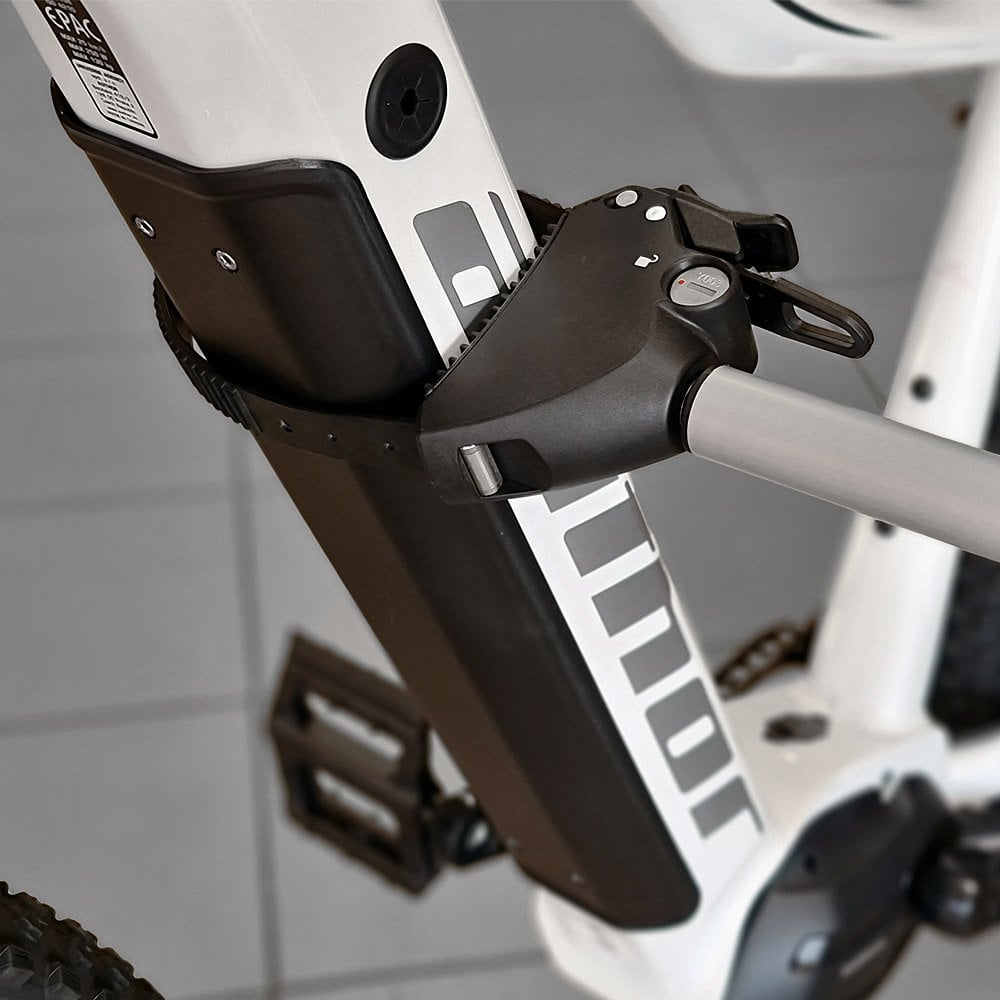

Wanted to share my experience with a rack that I don't see many mentions of online. This is the TX2 rack from a dutch company called Spinder. I got it in Portugal for 600 euros. It's a bit more than the Buzzrack E-Scorpion but the same (or less than) similar Thule racks. In my use, the rack is very high quality and easy to use. Here are a few key features:
  • Rack weight is only 17KG which is important since my car is only rated for 55KG on the tow ball
  • Telescoping arm clamp gives many different clamping options
  • I like the added security of a strap rather than the open style jaw clamp found on most thule racks (the strap goes all the way around the frame)
  • The rack secures to the ball by just moving one lever down, no bolts or other adjustments needed (similar to thule)
  • The light connector has 7 pin on one side and 13 pin on the other side, so no need to worry about how your car is wired for lighting
  • Folds up small for storage in the garage
  • Weight rating is for 60KG total. So you could carry 2 ebikes if your car can handle the weight
  • 1350mm max wheelbase and up to 3" tire
  • Has an add-on for an extra bike, but doesn't seem the most convenient to use. Good for occasional use.
  • Tilting rack for access to the rear
    I prefer bike racks that hold bikes by the wheel rather than the frame, but this is one of the best designs that I have seen available in Europe. Almost like a Thule Epos 2 but half the price.
    One downside is that the rack has some slight side to side movement while driving, but it isn't too concerning and I think this is expected from ball mounted racks. Fine for road use and moderate off road to get to the trailhead. But wouldn't be my first option to mount on the back of an offroader.
