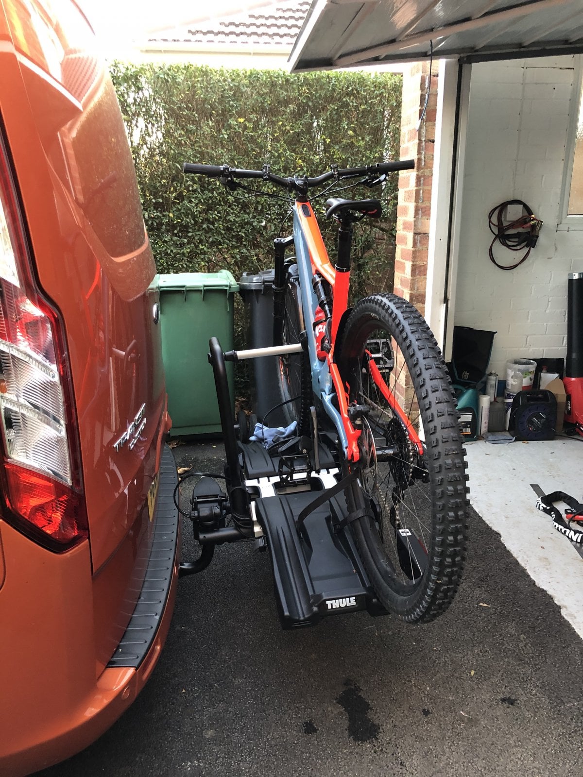

I went for the Thule Easyfold XT2 to put my Spesh Levo on. Really nice bit of kit which ticks some of the boxes like it folds down into a compact shape to lob into the back of the motor.
Unfortunately there seems to be a gap in the market for a tow ball bike carrier that can do the following;
1. Compacts down
2. Has the capacity to carry heavier eBikes
3. Has the distance between bikes
4. Has the wheel base for 135cm +
5. Has tilt to allow a tail gate to open
6. The hitch high that doesn’t foul the tailgate (Ford Transit Custom)
7. Has the distance away from a vertical tailgate so handle bars don’t touch/rub against paintwork
8. Can clamp awkward shaped bikes i.e thicker down tubes or ones that aren’t vertical or horizontal
The Thule struggles with 4, 5, 6, 7 (on the first bike slot) and 8 (managed it but wouldn’t trust) On a Ford Custom.
A mate of mine who has the same van is trying out the Atera Strada DL3 but it’s not for eBikes although if you were to load just 2 bikes you’d be on the cusp of designed spec.
Anyhow, it’s a mine field!
Thule Velospace XT meets all above criteria, except not folding down, but folds flat and takes little space next to wall in my shed. No problem fitting a Levo and Kenevo. In fact I haven’t one across a bike that doesn’t fit as to security of ball hitch, I can stand on the rack and it won’t budge. In short, it does the job brilliantly.
