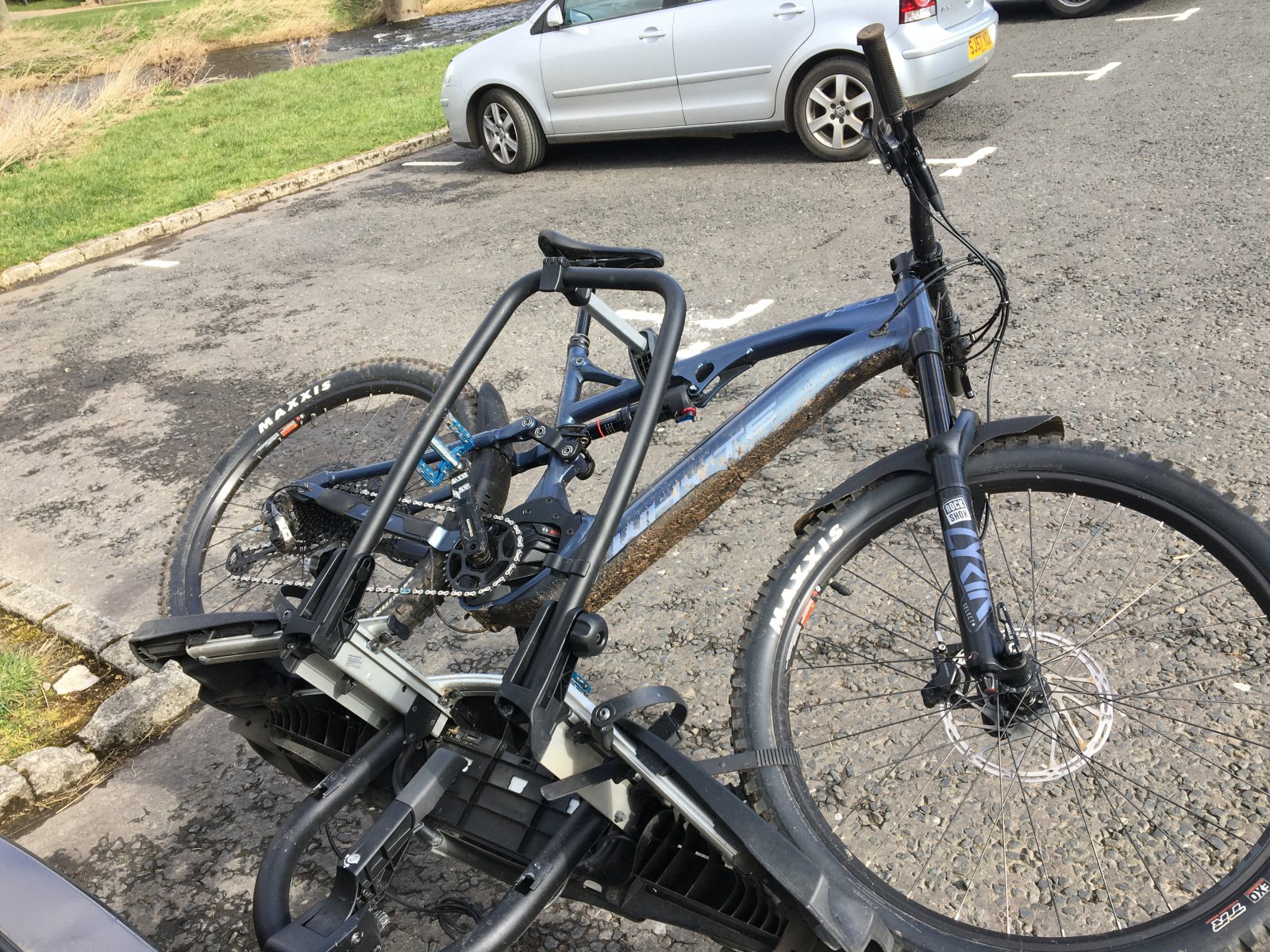

A cautionary tale to those relying solely on the clamp on their tow-bar racks to secure their precious bike.
Twice, my clamp lost its grip on the bike and the bike pivoted down onto the road, where the end of the grip contacted the road. The road acted like a massive grinding wheel and rapidly wore away the grip and the end of the bar. That was in the brief time it took for me to notice and to stop the car. I was lucky on both occasions that there was no other traffic to be avoiding. I was fortunate to be using Ergon GP1 grips that have a substantial alloy body and it took most of the hit. I shudder to think about the damage that may have occurred with only a conventional lock-on grip.
I now take no chances and I wrap a Gorilla strap around the clamp and bike frame in a figure-of-eight fashion to prevent this happening again. If you can't get a Gorilla strap, anything will do; a toe strap for example, a leather belt or even some string!

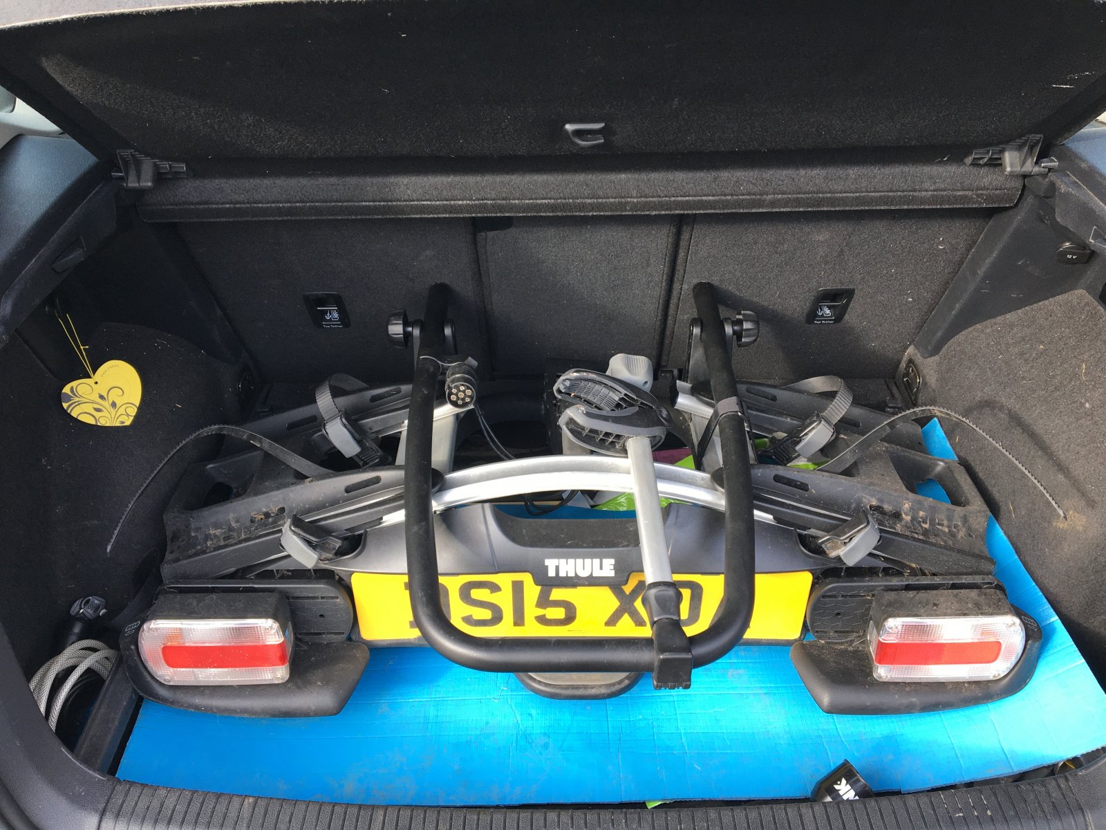

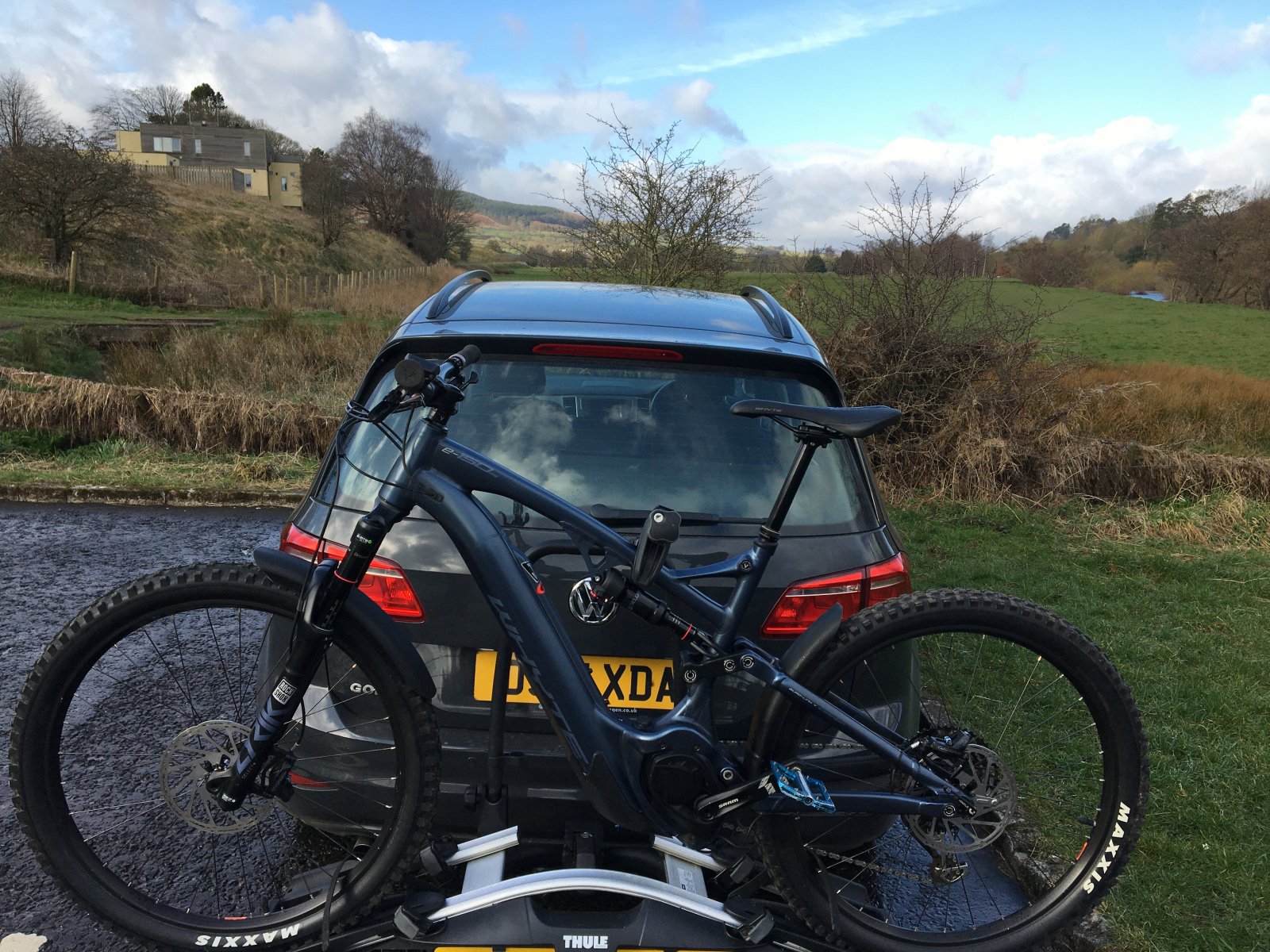

I’ve had two Thule carriers and never had a problem with either off them. I can’t fix a clamp to the seat post but I’m mote than happy to clamp on the frame on my Whyte E-150. Once the bike is secured on the carrier I always double check every thing before I drive off. The clamp knob is lockable so no worries ?

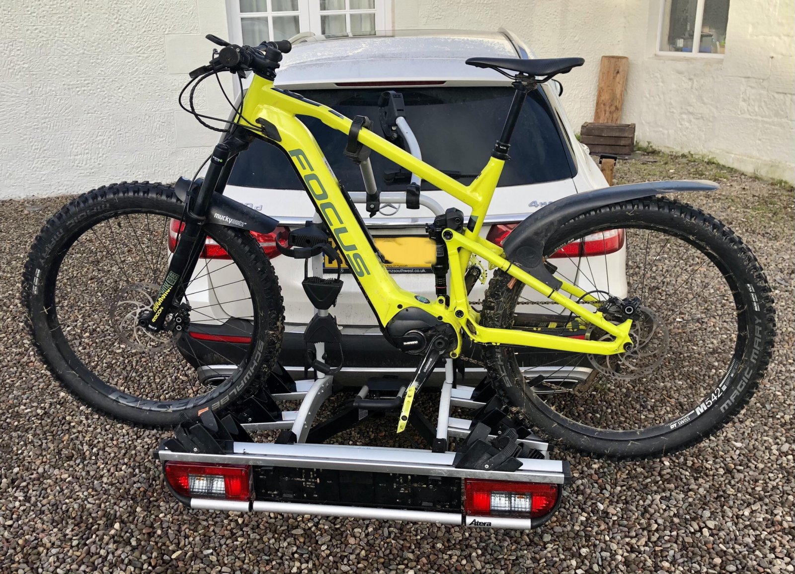

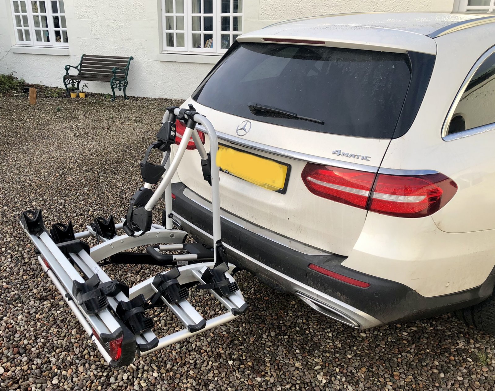

I've been using an Atera Strada M3 for about three years. The mount onto the towball is super easy and I've never had it move. It's so quick that I'll take the rack off and throw it in the boot when I park up for a ride.
I bought the longer wheel straps for two slots as I used to have a plus bike. I've also replaced the longest arm with a Thule arm as they are detachable at both ends, which makes it easier to pick up a friend (or did, when that sort of thing was allowed.
Seems incredibly secure, rated to take e-bikes, and while I also strap a brake lever to stop movement, I'm overall really, really happy with it.

been using the escorpian for a while now and can say it does exactly what it should, mounts easy, very secure and the bikes are a doddle to load. Very happy with it.

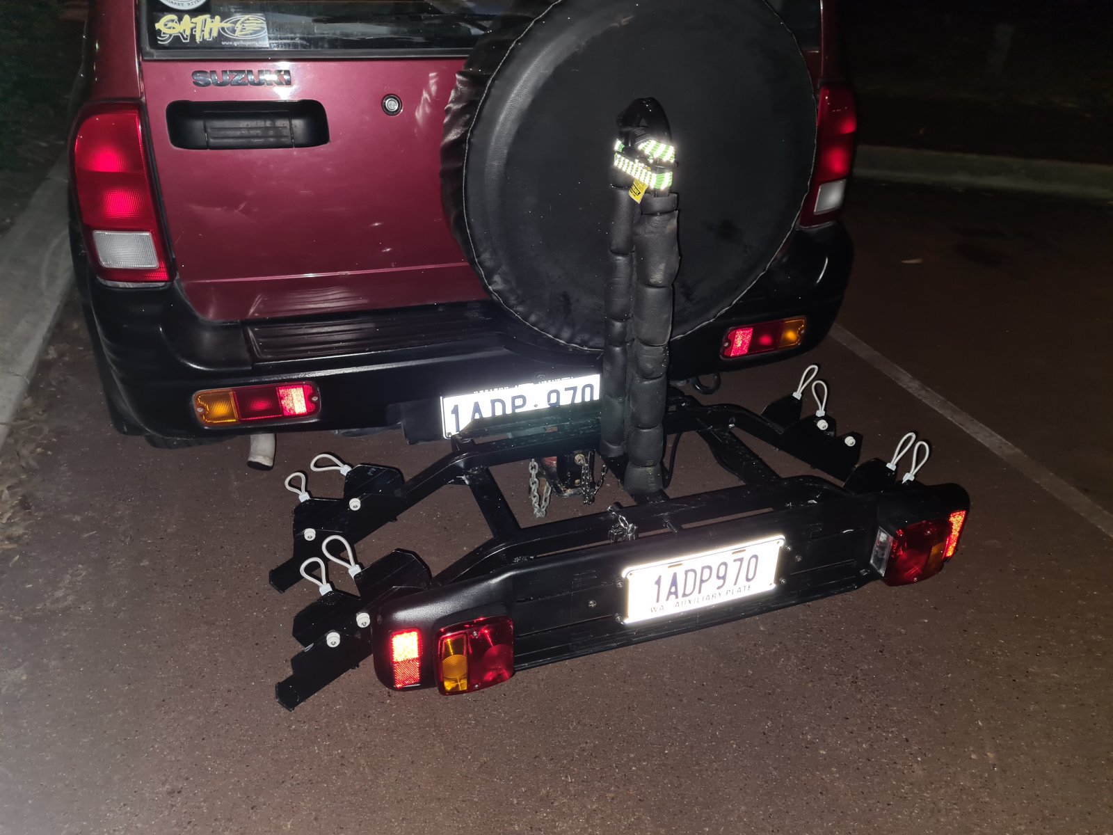

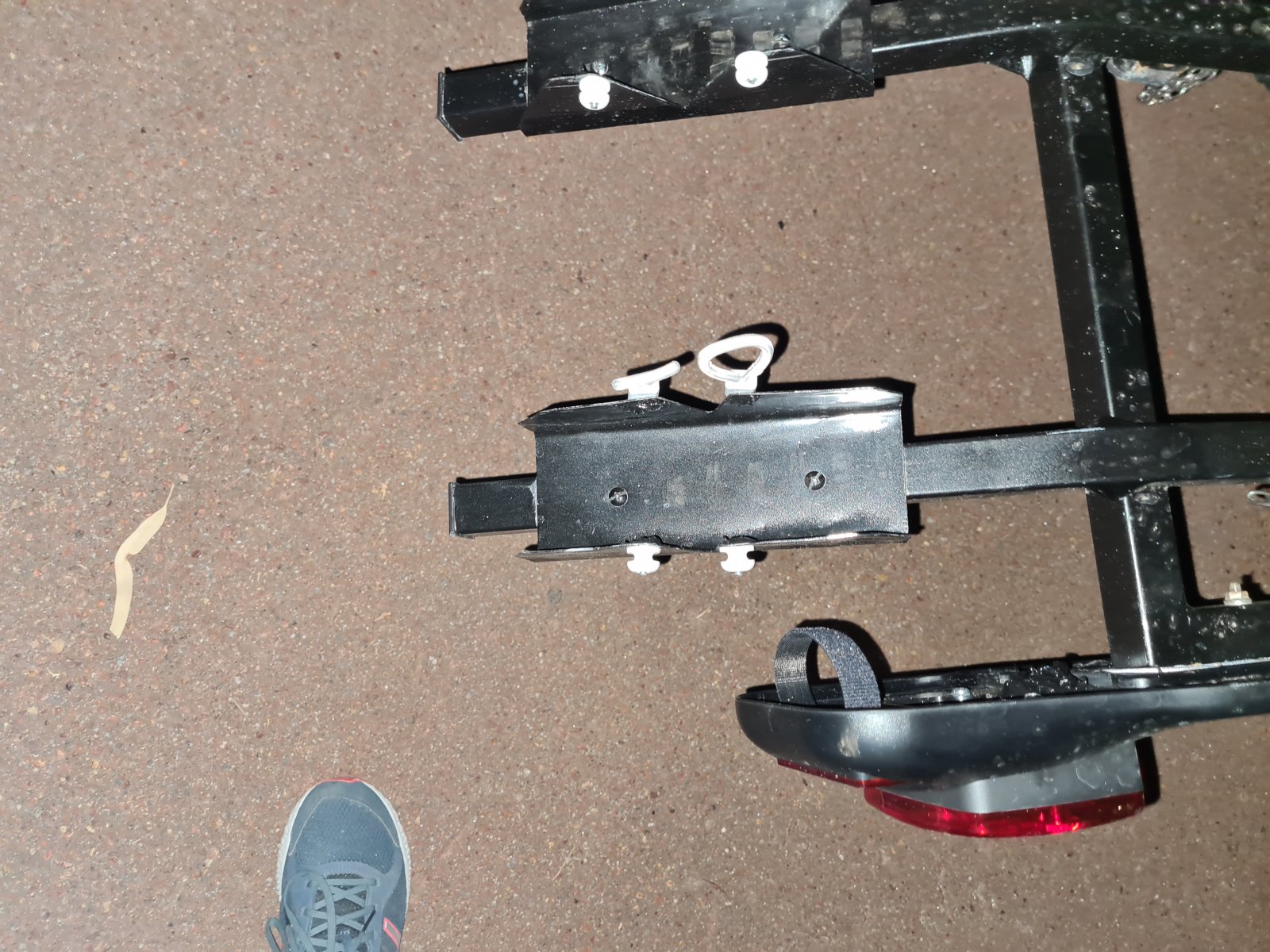

Square tube over square tube with a pin wont swivel to the attachment point
