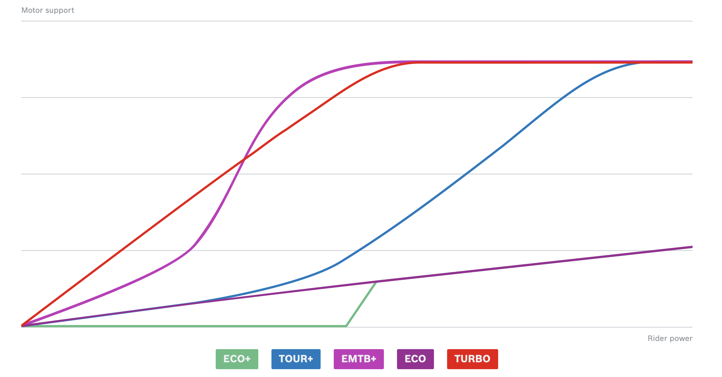

There is a very good interactive line graph comparing any or all of the 13 different modes available.
The three modes you mentioned deliver motor support based either on a constant support percentage (Turbo) or with a dynamic support percentage based on rider power (Tour+ and eMTB). Tour+ does range from 60% to 340% (up to 400% after the performance update) and eMTB does range from 140% to 340% (400% after the performance update), but in addition to different ranges Tour+ needs significantly more rider power to reach the same level of support as eMTB. These two modes simply address different rider needs.
In the graph the three motor support curves look like this
To get a better perspective on the differences I have added the constant modes Eco and Tour. Now you can clearly see how much power you need from the rider before Tour+ reaches support levels above the regular Tour mode.
Thanks Shark58
I had not seen this graph.
My Tour/Tour+ and my eMTB Modes never get to the 'Motor support' level of Turbo as shown in the graph.
You need a rider input of about 300 W to get Tour+ into the Turbo level. With eMTB about 200 W are sufficient to reach the same level.

Now we need to somehow lay over the rider wattage it takes to get those assist numbers.
Not exactly but a good indication is adding the ECO+ mode to the graph.
All modes are shown in standard configuration without any modification in the Flow app. The ECO+ mode starts with the motor in OFF and engages the motor at a predefined rider input. According to the help text in the Flow app the standard engagement point is 200W rider input.
So when you add the line for ECO+, the break, where the support jumps from zero to the 60% of the standard ECO mode is at the 200W rider input point. Assuming the scale for that axis is linear this gives us a good indication of watts needed for the desired motor support.

But there might be a small improvement possible for you. Since you have TOUR+ installed you also have the eMTB mode for standard length cranks installed. This was mandatory for bikes with TOUR+. You could ask your Bosch dealer to install the package that contains TOUR (without +) and eMTB for short cranks.
The eMTB for short cranks mode will need less rider input to reach the higher motor support levels.
