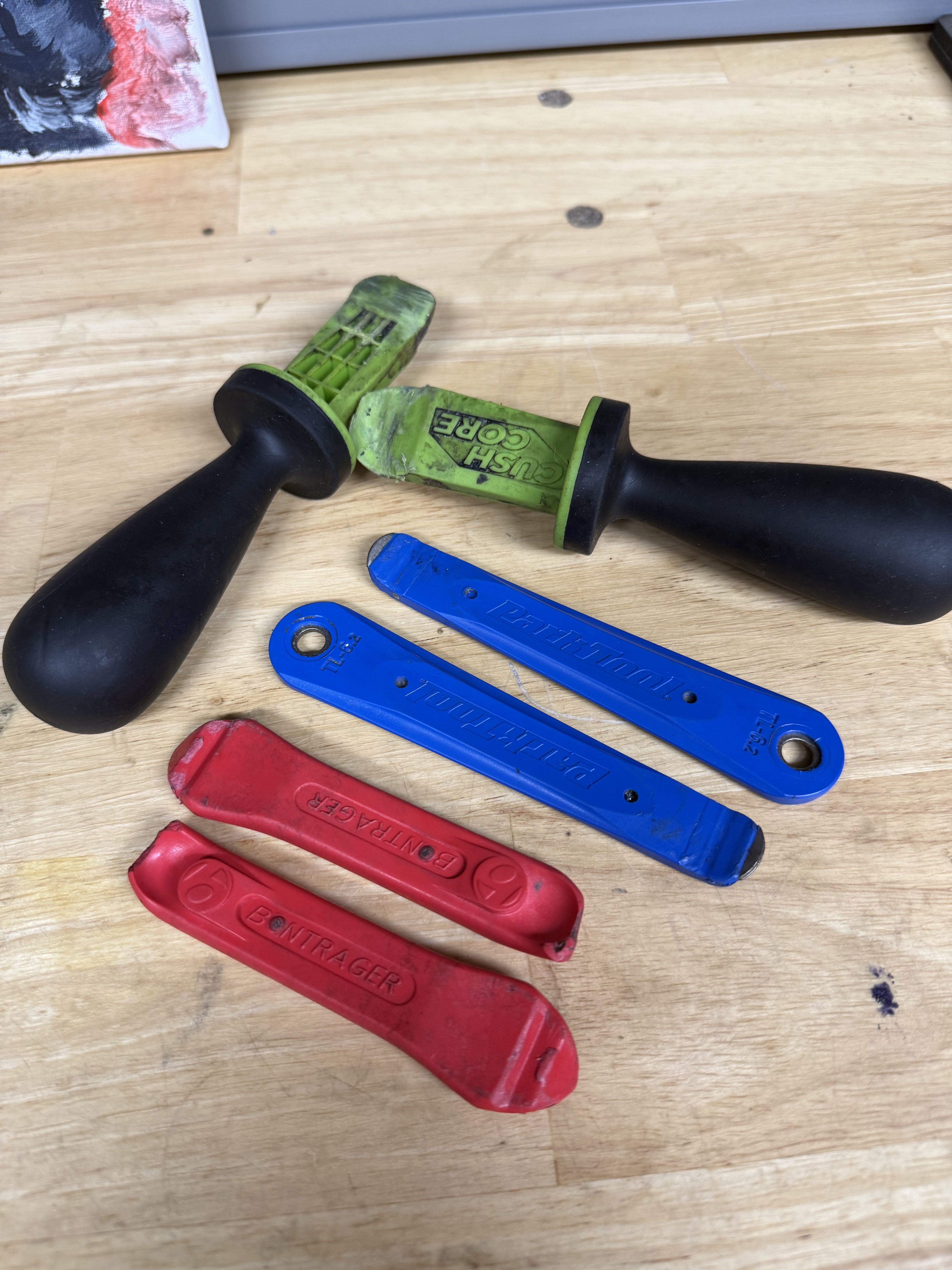

I eventually switched to the Cushcore tire levers. The other ones either broke, cut the rim tape, damaged the rim, or slipped causing more beauty marks on my knuckles.
Chasing the bead around, while installing a cushcore, was a little easier.
