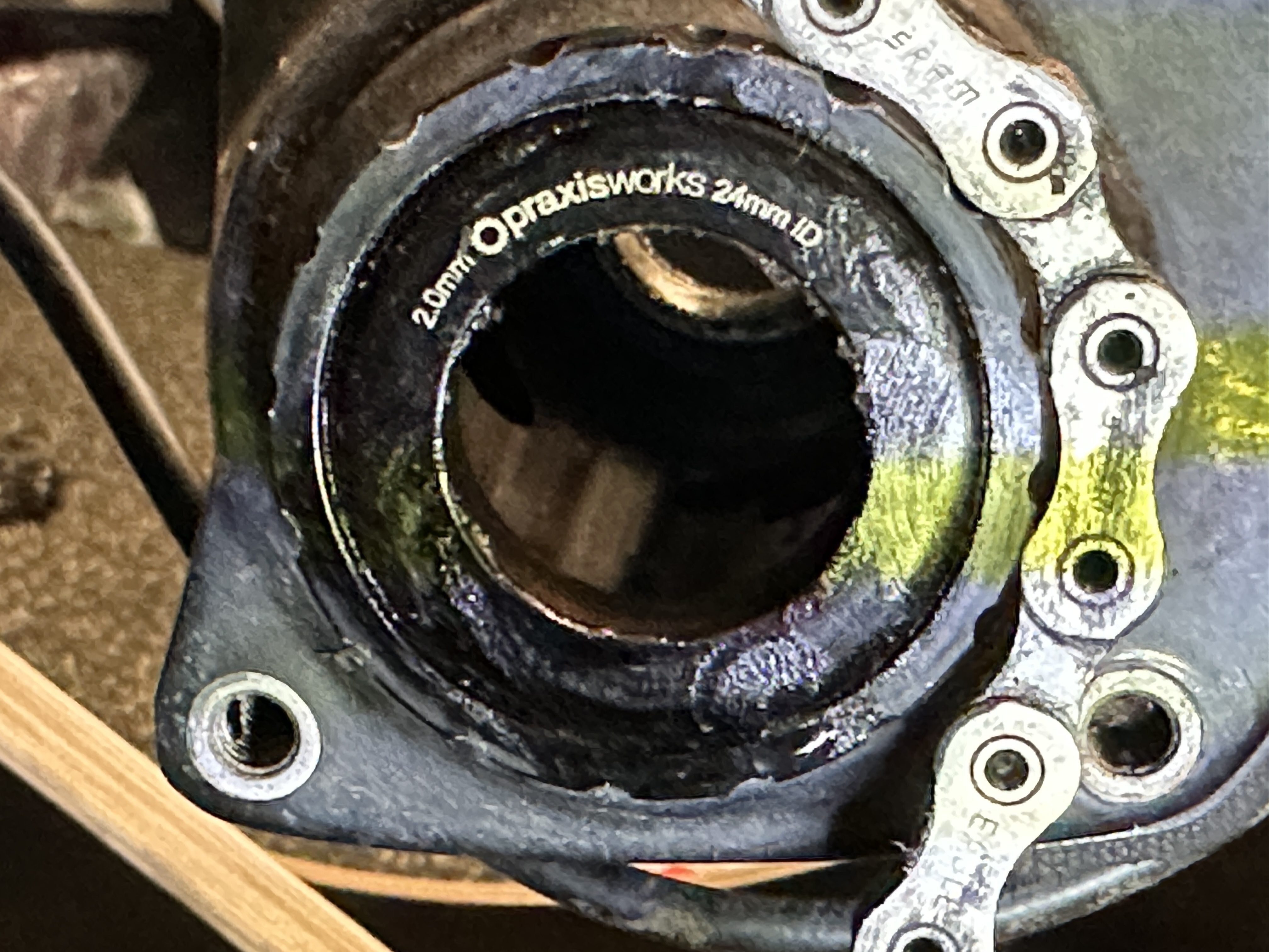

This isn’t eMTB related, but hopefully someone can point me in the right direction…
My mate has been borrowing my heavily upgraded 2017 Stumpjumper (Specialized Stumpjumper FSR Expert Carbon 6Fattie (2017) review - MBR) and coming out for rides with me. I’m on my Levo SL, with the power off.
Anyway… tonight, we were just about completing an 11 mile ride, and he said the pedal felt a bit weird. 5 mins later, he stopped - and pretty much pulled the pedal out of the crank. Both the thread on the pedal axel and inside the crank are ruined. He then pulled the other one, and it came out with little effort too. He only had to walk about half a mile back to the house thankfully.
I had upgraded that bike with Eagle X01 a few years back, so the cranks are carbon X01… but I’m not sure what the the fitment is.
2 questions…
How did this happen? Is it something he’s done? I’ve been riding bikes for a long time, and I’ve never seen this before.
What do I need to buy? The shop upgraded my whole bike groupset… so I don’t know what ‘type’ of crank this is other than an it’s a 170mm SRAM X01 carbon crank.
Clearly, I’m going to need a new set of cranks, and a set of new axels for the DMR Vaults that were on it (or some alternative pedals).

All the ones I find say they’re DUB, but I’m sure these are from before DUB was a thing. What’s the difference?
Also, my friend is about 105kg, and the pedals say they’re suitable for riders up to 85kg. Perhaps that’s the problem?

Did the pedal bearings seize? Although I think you would feel that immediately, unless they were over-torqued and the threads already were done for. Or maybe the pedals were loose and "wiggled" eating away on the threads.
If it´s not DUB it would be GXP. DUB uses a 29mm axle and GXP uses a 24mm drive side and 22mm non-drive side.

I wasn’t riding the bike, but the pedals still spin freely on this axels just now… so they haven’t seized. Also odd how they both ‘went’ at once.
They were torqued up to about 45Nm, but haven’t been touched for years. I didn’t think pedal threads could come loose - since they’re the opposite way to they spin when you ride?
I also didn’t realise how expensive they were as I bought them as part of a groupset. Looks like about £300 for a direct replacement 😩

I guess the easiest thing I can do I remove the cranks just now and take them into my LBS to identify. I don’t want to buy another set and find out they’re the wrong thing.
All photos of SRAM DUB ones say ‘DUB’ across the axel, and also have ‘DUB’ on the self extracting nuts - and mine don’t.
Yes it´s hard these days to find parts for GXP. I have a gravel bike with Sram Red GXP carbon crankset and a power meter spider. I want shorter crankarms for it but I can´t find any mainly because I want to be able to keep the power meter.
In your situation I would look at swapping the BB to DUB and get a DUB crankset.
I figured that would probably be the way forward. I’m sure someone else manufactures a decent carbon crankset other than SRAM, as all the X01 ones I’ve seen are about £300.
If this was my main bike, then I’d pay it… but since it’s used on occasion, then I kind of grudge an expensive repair.

you could try to save the crankarms with helicoil insert.

What's that - tap out the existing thread, and put a new insert in? I saw kits on eBay - approx £50 for a LH and RH tap, and then £12 for inserts. Certainly cheaper, but expensive if it doesn't work.
I guess the other thing I have to consider is I'm either going to have to pay my LBS to remove the GPX BB and fit a DUB one, or buy the correct tools myself 😩
There´s usually small kits that aren´t too expensive. Or you take it to a workshop and let them install new threads.
This is Helicoil

Can you get Helicoil big enough for cranks? I've just helicoiled a bunch of stripped valve cover threads on a Mini Cooper & the kit goes up to M12. Never measured crank diameters but they look wide to me.

According to the video, the Helicoil's are much stronger than the originals... so might be worth a shot.
That was going to be my next question - what size is required!
I see kits like this:
But there's no mention of LH and RH threads?

Helicoil works great on cranks, I have done it before and you can get a set just for this.
A helicoil repair is also stronger than the original aluminium thread.
Or buy an alloy crankset, no need for carbon on a shed banger.
Yes i did mine a few years ago
came as a kit for L+R sides with a drill bit and taps with coils included
i had access to a milling machine and clamped the arms square to drill and tap
Any one doing this just make sure you drill square or the pedals are going to be horrible to ride
There's also companies that will repair and hellicoil them for you (y)

If the threads are aluminum then a helicoil repair will be stronger. I know people who intentionally drill out aluminum threads to install helicoil for taking higher torque.
If you can´t find a decent kit then your local bikeshop, if half decent, should have helicoil toolset for their workshop and can put in new threads for you.
I used to have an expensive kit with all the drills, taps and threads from m4 up to m12. Used it a few times and then it got lost when I moved to a new house 😭

Ok - will check with my LBS and see if they can do it... if not, the guy on eBay for £30 could be worth a shout.
One other thing... the self extracting Hex bolt in the crank has maybe seen better days. When I took them off this morning, it was tricky to get the Allan key back out, as it had turned more than it should.
Can these be replaced?

Yes you can renew the end caps and extraction Bolts (y)
Just google : self extracting crank bolts there is loads of options .

I think this is the one you need. Can be found almost everywhere for around 10 euro.
M15/M22 GXP crank bolt
If you find M18/M30 I think its for DUB cranks.

Awesome - thanks all! Hopefully I can get this all sorted for about £40 rather than £400 for cranks, a new BB and either tools or the shop fitting it.
I'll also need new axels for my pedals, but that's a different issue. The cheap stainless steel ones will probably be best, since they don't have a low weight limit!

I’ve sent them to the guy on eBay. Didn’t realise it was £30 per crank though! He offered the second one for £22 (assume since he can ship both back in 1 package), so a bit of a saving. £52 vs £300-400 though!
I’ve cleaned up the threads on the pedals, and they’re actually fine. They just looked mangled because of all the shards of the crank thread mixed in with them. I’ve also opened them, cleaned and re-greased the axles… which look fine too.
Hopefully the re-built Helicoil cranks and the £10 nut I’ve ordered solve everything!

Put a Re-coil in. These are helicoil style inserts and are typically stronger than the base threads when installed correctly.
Don't use a solid style insert. Use a coil style insert.
I just did a e13 crank after the threads failed, and have a Sram crank that has been repaired with a coil insert that has held up for a number of years like that on my other bike.
The re-coil brand kit is very high quality. The tap is a pilot nose, which means it screws in directly to what ever is left of the old threads and pulls itself in straight as it goes.

Recoil is an Australian brand. 34096-20 is the part number for the left and right kit. But you can also buy just the left or right individually aswell.
The pedal threads are UNEF 9/16 - 20. Left and right hand threads for left and right pedals. Which is a very unusual size, except on bicycles. You won't find that size in a large kit. You will have to purchase that size specifically.
