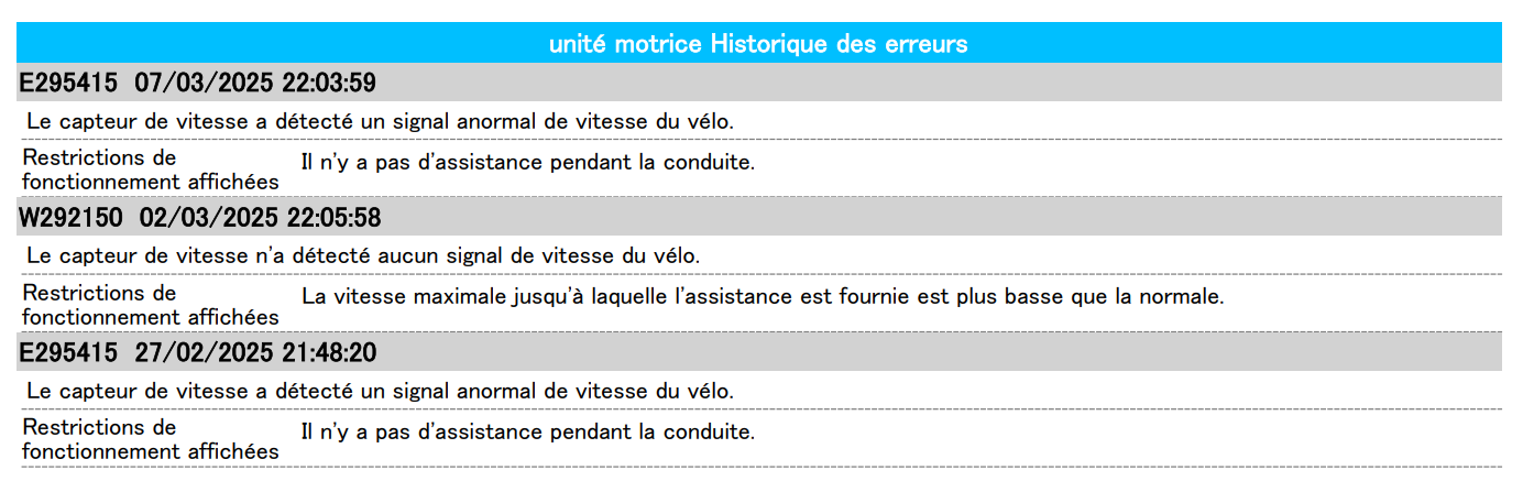

I don't know ? i havn't smartphone (and e-tube off course), i use E-tube pro with shimano interface and yes the E295 are registred (and can't be cancelled, unlike all others errors)

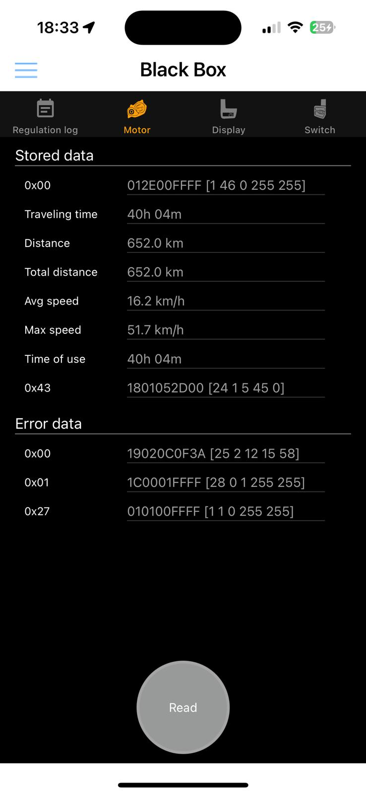

I have ST-Unlocker and found out I have few hexdecimal error codes which I don't know what it means BUT not seen in eTube app.

The E295 error is linked to the modification of transmission (wheel diameter, Nb of teethes), not the magnet of the speed sensor or the brand of the hub.
Why i can affirm that ? beacuse i will had no more error after parameters adjust, Without any modification of any replaced items. And the adjust done are:
Wheel diameter (for the 27.5)
Nb of speed (for the 11V)
Nb of teeths plate (for the 32)
Nb of teeths casette (11/52)

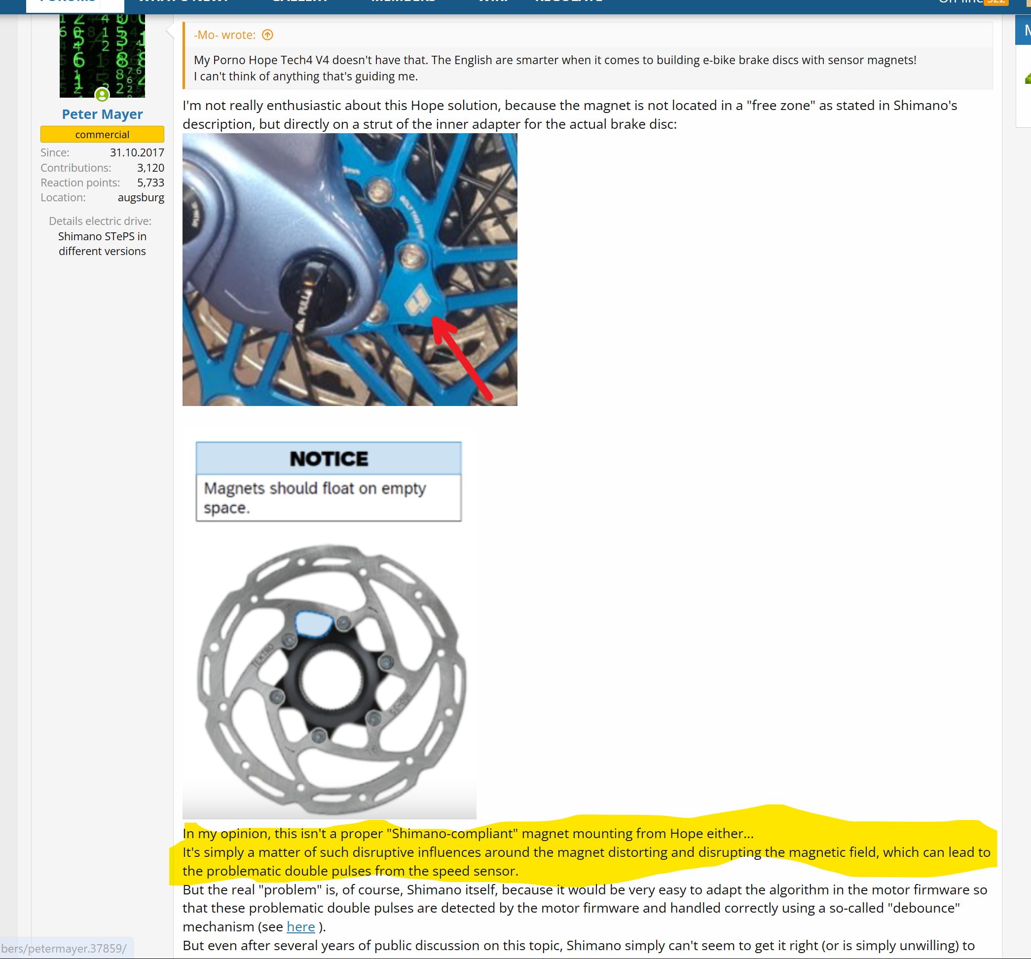

It was discussed in length on the German Pedelec forum by Peter Mayer who writes de-restriction software for the EP801. It's caused by pulses from the magnet and sensor alignment producing double pulses.
The magnets magnetic field cannot be interfered with by any other metal components, otherwise you can get double pulses leading to the Shimano Software thinking you are tampering with the speed signal.
Shimano warn you with the E295 error. But if it continues to happen, you'll get the E299 error and the motor is locked, as Shimano believe you are trying to de-restrict the bike.

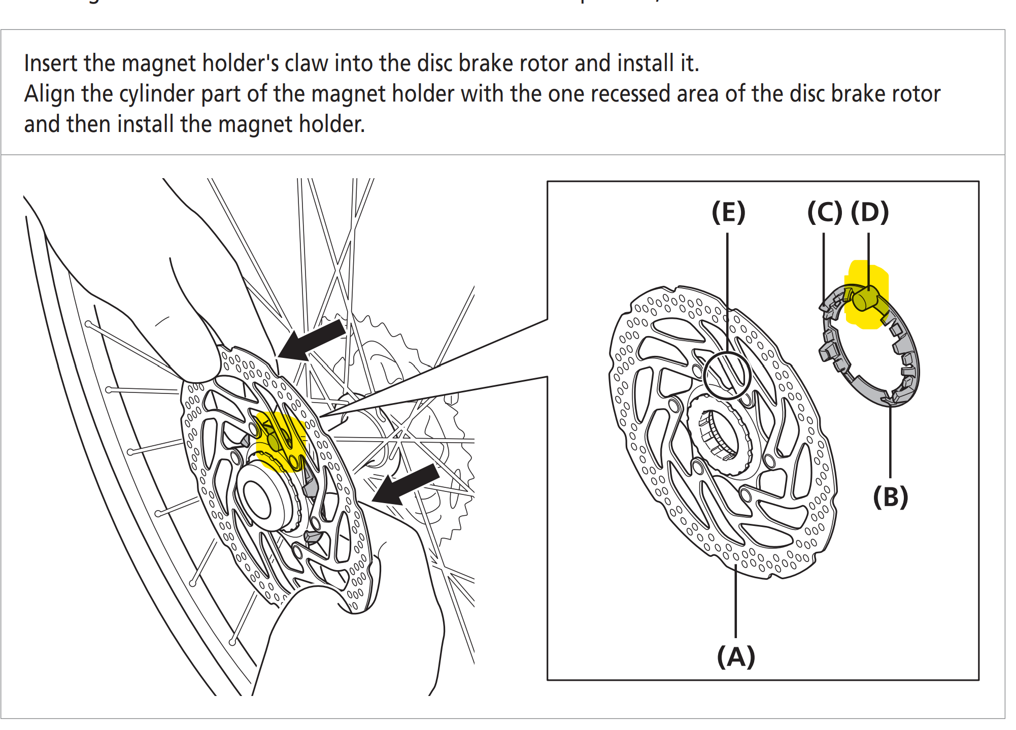

A Shimano Hub, Magnet and Rotor are designed so their alignment always produces clean pulses. Other brands allow for mounting that can produce clean pulses. But as explained by Peter Mayer above. They can also be mounted in a way, where the magnetic field is interfered with by the surrounding metal.
Shimano state in their magnet mounting, that the magnet must have free air around it. This includes behind the magnet. So if the brand of hub, rotor and magnet you are using doesn't allow for this, or you mount it, not in free air. You can get speed sensor signal issues. Leading to E295 and E299 errors.
So here is the Shimano Rotor and Magnet fitting. The magnet clips through the holes in the rotor. So it's not possible to mount it incorrectly and have metal components interfering with the magnetic field. Hence why I recommend Shimano Centrelock hub, rotor and magnet, if you are getting E295 errors with the EP801 or EP6 motor.
I have marked the magnet in yellow.

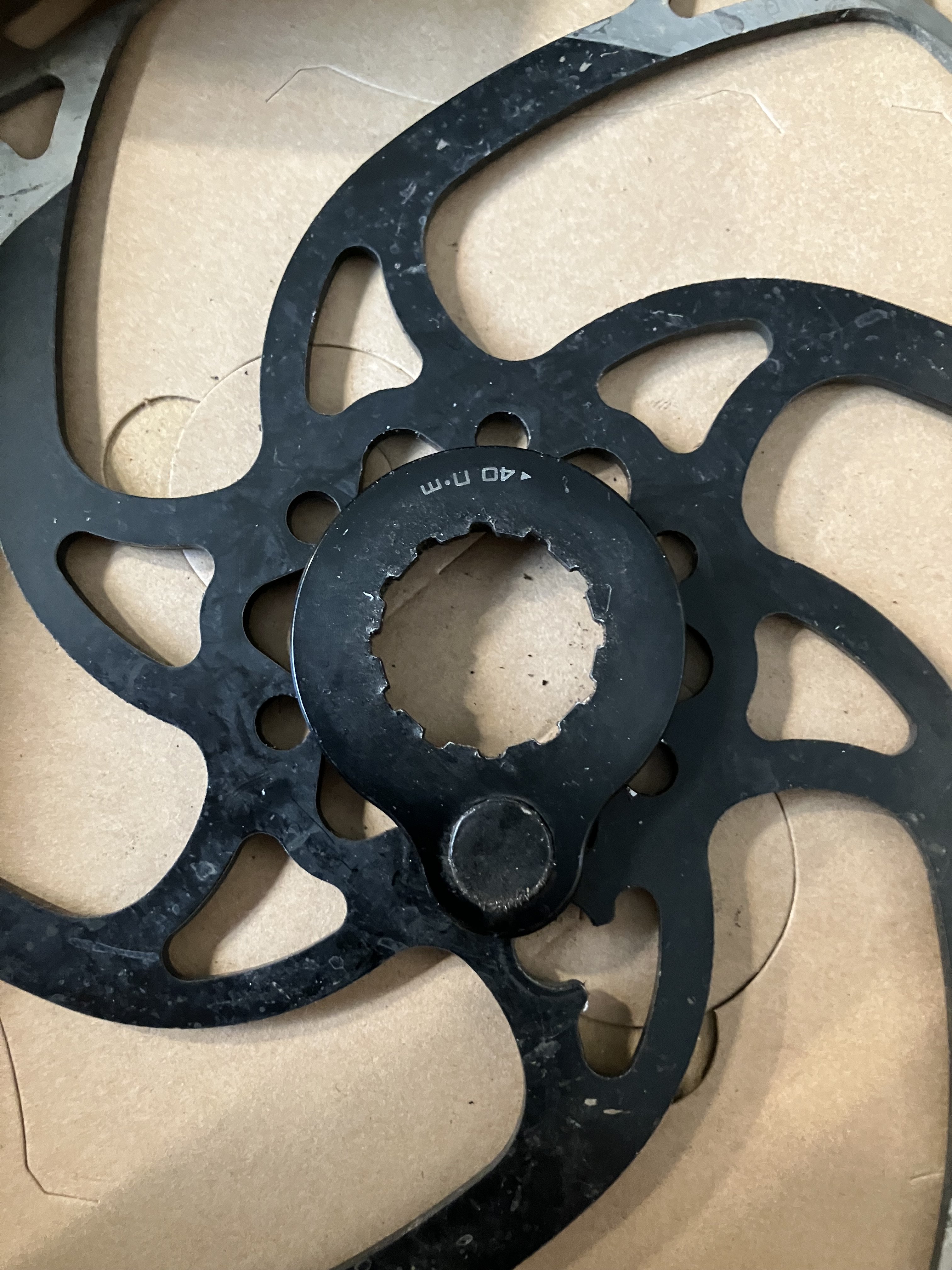

This is picture of 6-bolt Galfer disc from my ep801 bullit. In the middle is Specialized CL lockring with magnet from my Levo2 too. I used that with Shimano rotors from Levo, on this bike. As you can see from Galfer disc, there’s hole close to the Specialized magnet and that’s where you put Galfer magnet. I just took it out because I have new rotors coming. You see that those magnets are not even close to each other or alligned and still, everything works. And bike came with Sram rotors and own magnet. So explain to me, how this works without problem if your theory is right? Just to clafiry, the CL magnet/lockring is to show where the magnet is positioned compared to 6-bolt disc magnet…

To finalze story of the shimano hub. I had riding my bike since 6 months (2 or 3 time by week) after SCOR have parametred my current transmission (27.5, 11V, 32x52) and since this never more err295 (or any other errors), i have used several various hub (DT, ZZTO, etc..), various magnet (centerlock, 6T). I affirm that hub brand and magnet (just necessary that it work to provide speed) have nothing relation with err295. The only disturb (bigger), is that if i would use another transmission, i will need to request another parameters from SCOR. May be ? because i have noted something. e-tube have performed an update and now i cant see the parameters who i can't adjust. May be shimano have removed all of this mistakes ? i don't know, nothing explaination. Somebody would test transmission modifications to see if it still blocking the motor ? ;)
