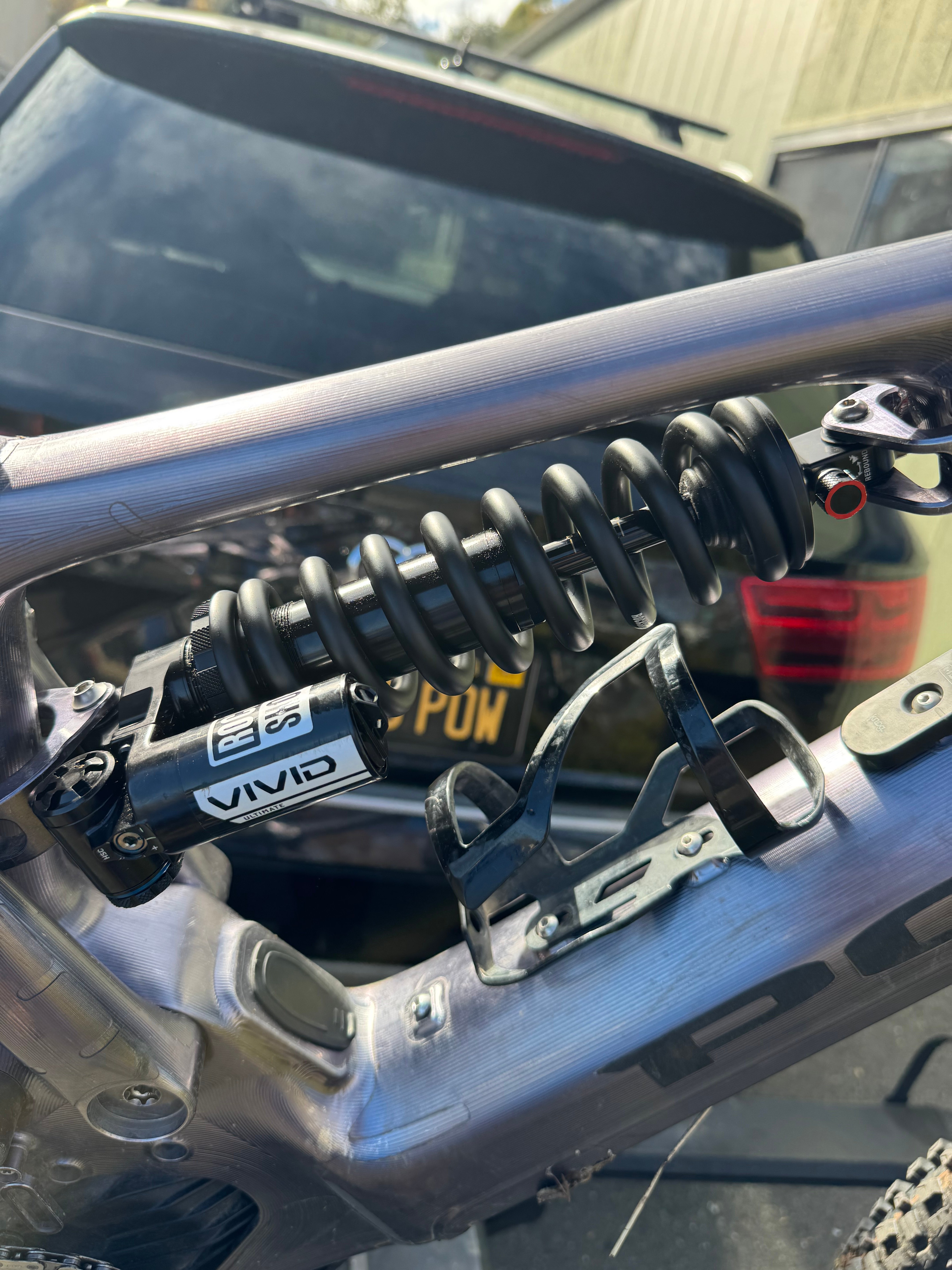

Vivid coil installed today.
Almost 3,000 hard miles with a heavyweight jockey

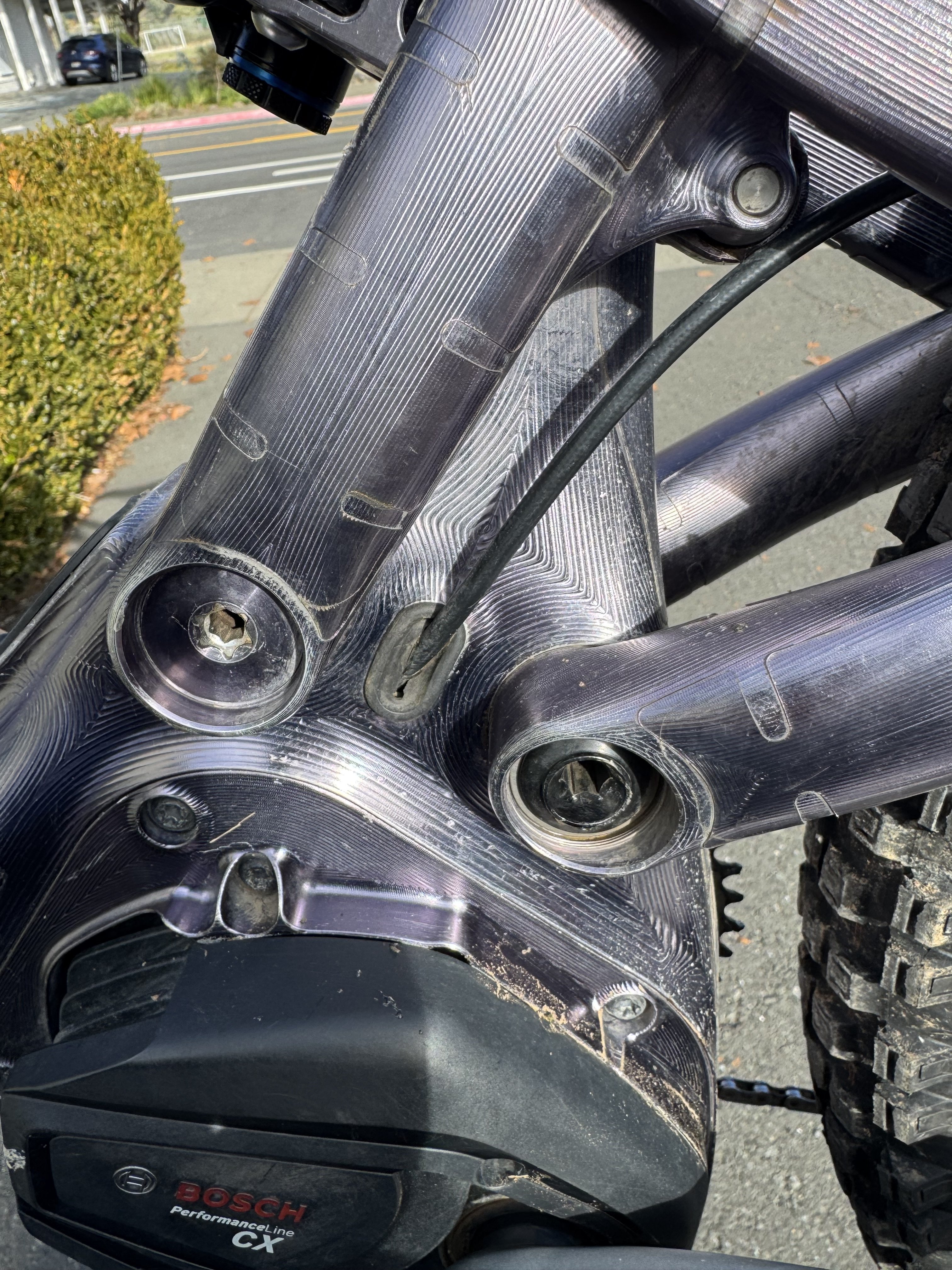

Bosch Warranty replaced motor and battery. RockShox warranty on 2 Zeb uppers for CSU creak. One broken pivot bolt replaced with Dub crank bolt.
Praying swing arms hold up
