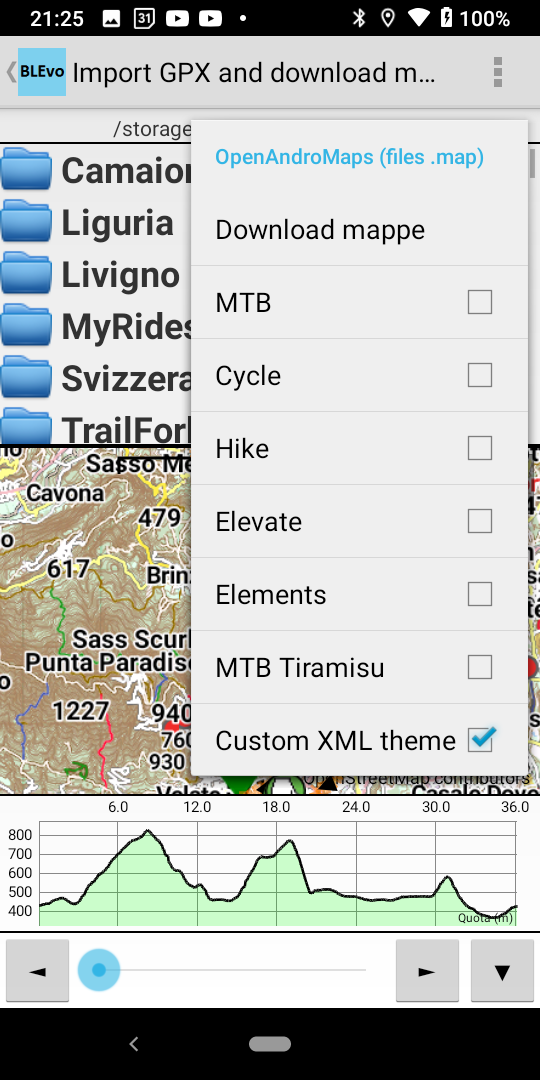

1. Can Blevo app or RC also switch through the Standard Support Modes of the Levo SL (Eco/Trail/Turbo)?
2. Regarding OpenAndroMaps...I made my own Style-File(s), any chance to use them with OAM in Blevo? Havn't found any option to select different styles other than the standard once.
Thank you very much, James

1. No, you can't change the support level, but only the percentage of the assistance.. You can select the step in the RC configuration
2. Sorry but the style cannot be selected..
Merry XMas..

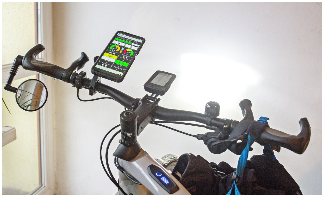

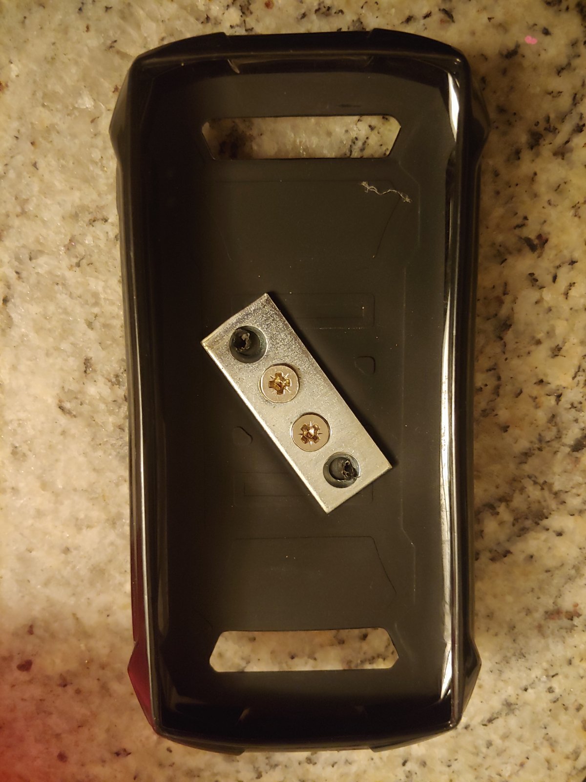

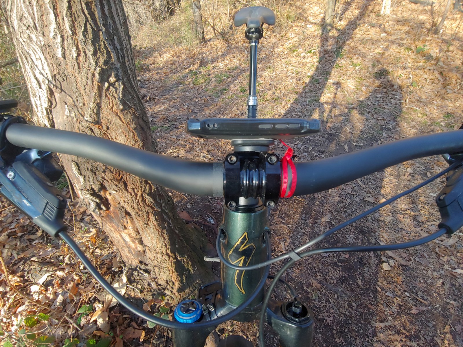

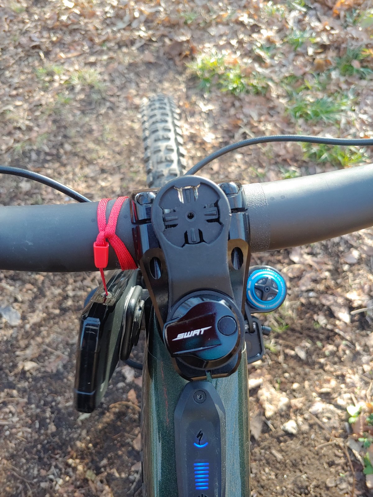

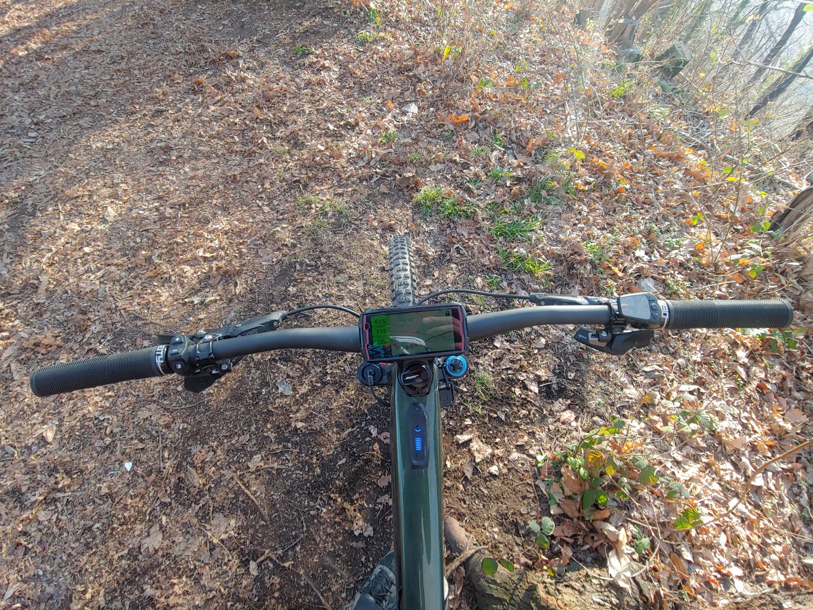

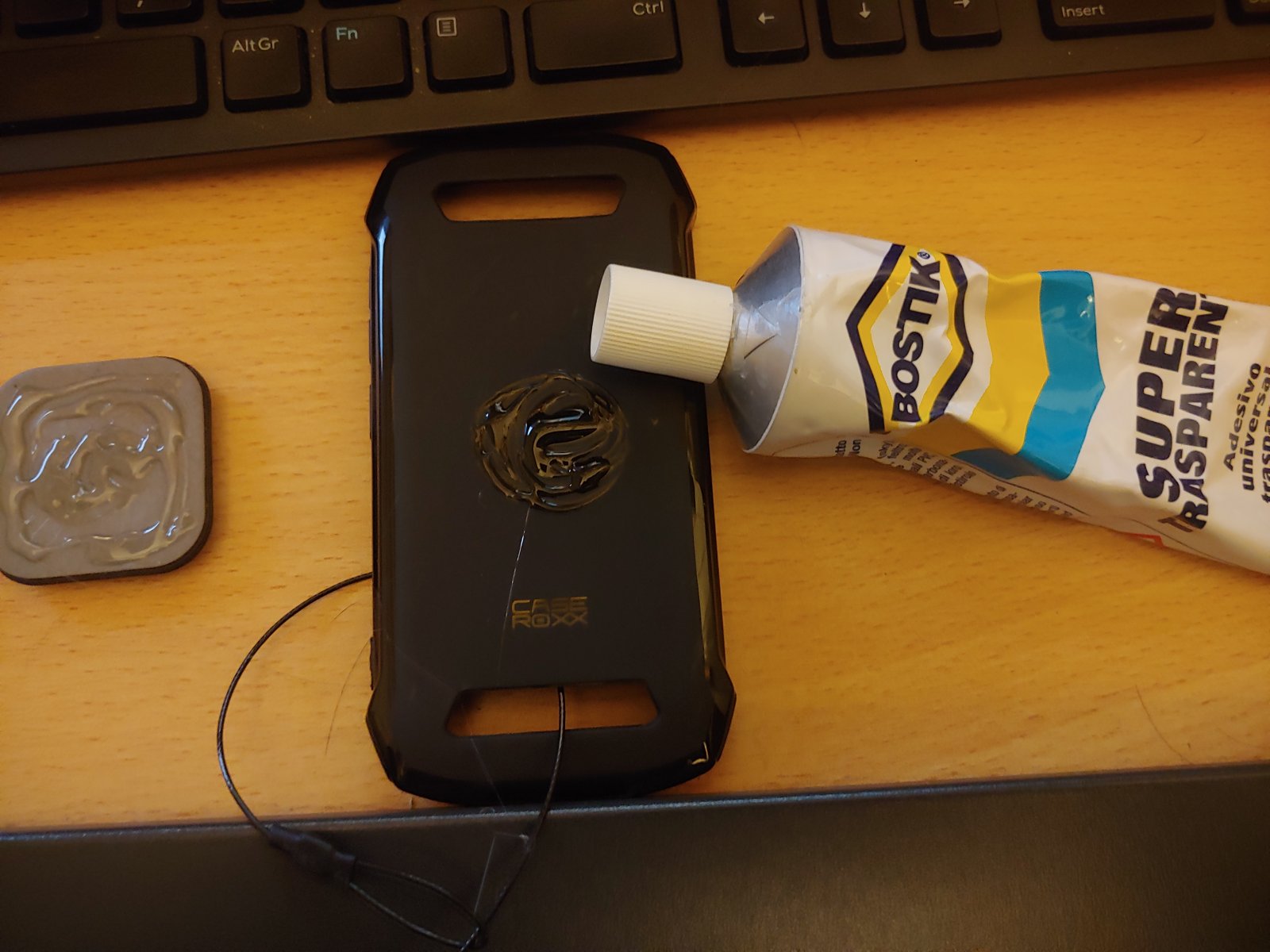

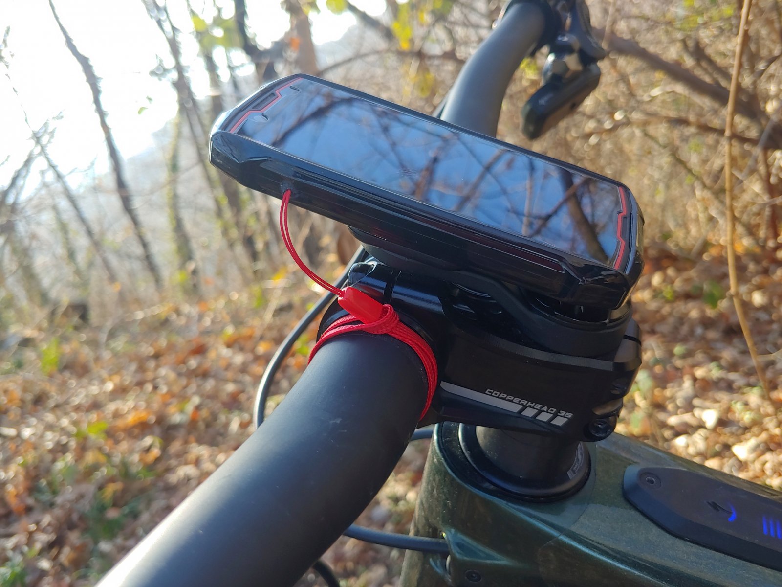

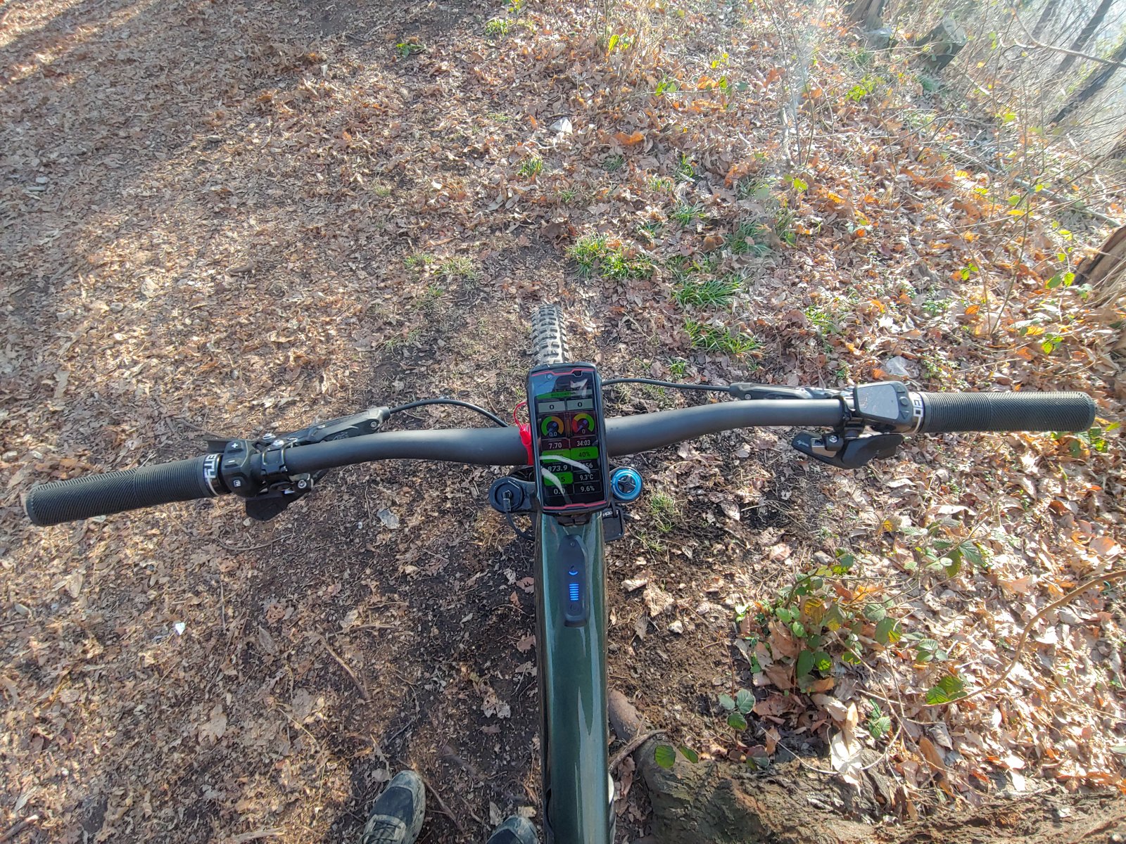

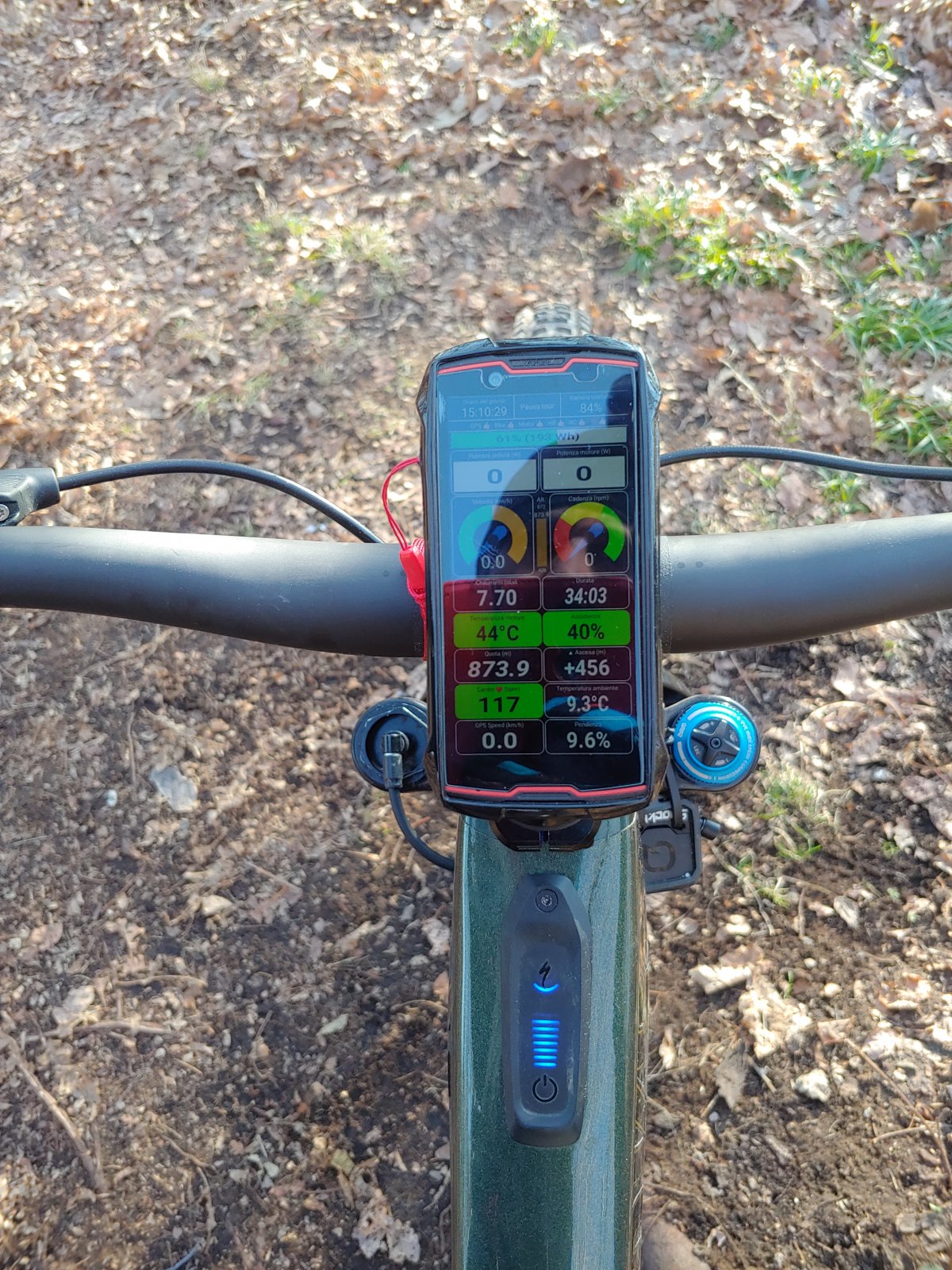

Today I tried a new phone holder. Since I could not find the handlebar attachment for the 35mm diameter I used the solution that attaches to where the SWAT is.
I am attaching the photos.
For me it is a very elegant and solid solution and the phone can be mounted both horizontally and vertically.
PS: for safety I used some screws and Bostik to fix the support because I don't trust much of the adhesive. I saw that there is something a little more professional and I leave you the link.
Link to buy
https://it.aliexpress.com/item/40001828330....373c4c4d58Fb4t
Link to buy
https://it.aliexpress.com/item/32999688469....373c4c4d58Fb4t

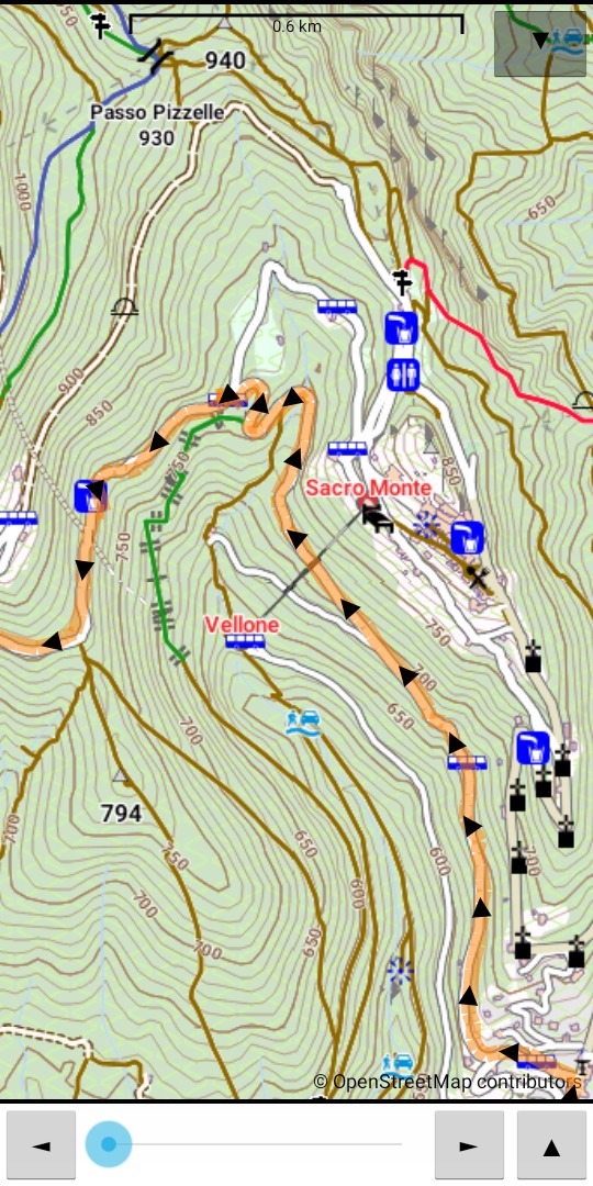

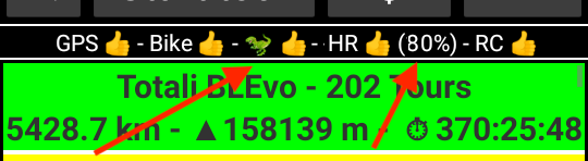

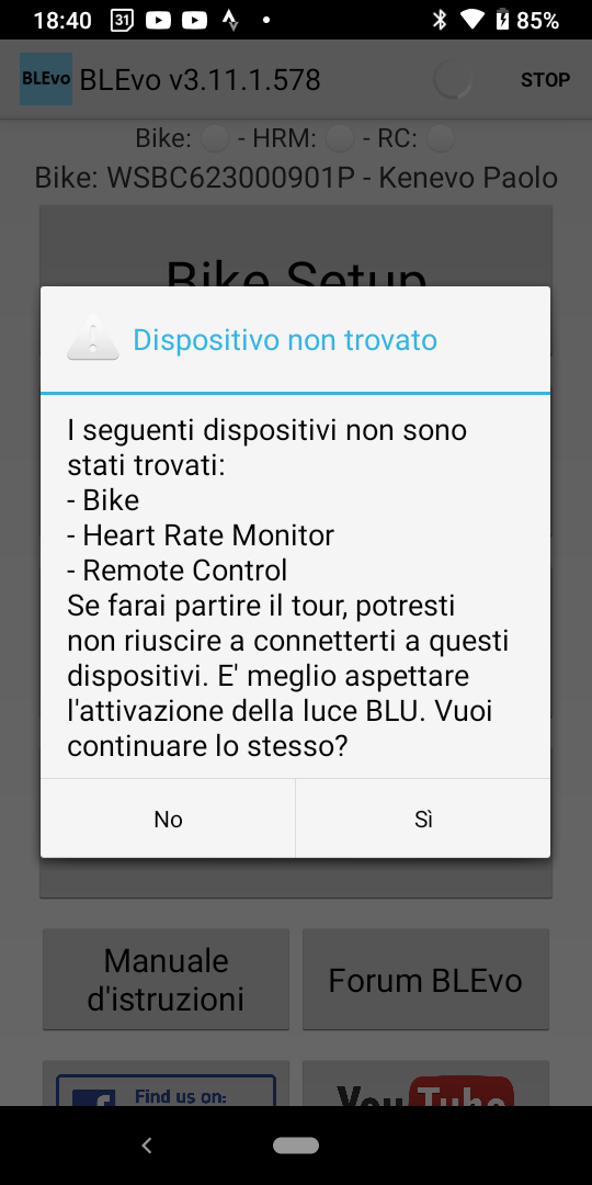

Hi everyone,
I just released version 3.11.1 of BLEvo for Android.
In the new release I have fixed the display of the icons of the points of interest in the Andrompas maps. You can see from the attached image how the fountains, toilets and other points of interest are displayed. Also for this type of map I added the possibility to choose a custom theme, uploading the necessary files in the folder /BLEvo/MAPS/theme/ and selecting the custom theme as you can see from the second screenshot.
I also changed the Levociraptor Gen2 icon to 🦖 so that it doesn't have a red icon on the peripherals status line. I also added the cardio battery percentage. If the battery goes below 40% a yellow LED will appear 🟡 or 👎 depending on the Android version.
Finally, now BLEvo will warn at startup if the peripherals to connected are not found. This is because if BLEvo does not display the BLUE LED 🔵, it may not be able to connect to the peripheral even if it is powered on. I therefore always advise you to wait for the BLUE LED 🔵.
I list all the changes here:
- Now if .map files are run with BLEvo, they are copied to the maps folder
- Added customizable file style for Andromaps (install files in /BLEvo/MAPS/theme/)
- Updated style for Andromaps from Elevate4 to Elevate5
- Added voice message for maximum heart rate last km
- Added percentage of battery charge of the cardio and remote
- Bufix: Now Andromaps maps correctly display images of points of interest
- Forced re-reading of the wheel size at each connection to make a correct count of KM and speed
- Optimized CSV import
- Optimized FIT / TCX file export to avoid strava ascent calculation problems
- Added PRO preset for Smart Power
- Bugfix change and Smart Power configuration selection
- Correct link for the purchase of the remote (multiremote | o-synce Shop)
- Added request to leave without having found the peripherals
- In the home the back does not close the app but puts it in the background
- Correct visualization of the altimetric graph on vertical display
- Levociraptor icon changed to 🦖
- Put yellow dot when cardio battery is below 40%
- Compatibility with VADO 3.32 battery (460wh) added
Enjoy your ride with BLEvo..
