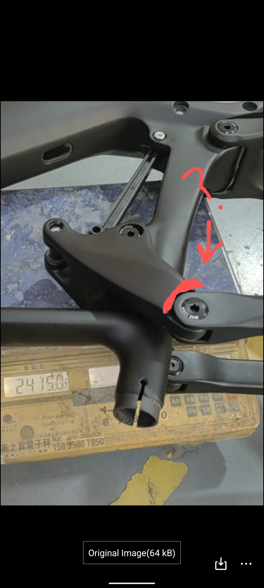

Yep, like 99.9% of the shocks available in the market; the main diff is that these ones its quite easy to change the stroke
Thanks mate. Never did that with a shock (no reason, more travel is always better 😂). Just did this on forks, and here its the other way round. Fork will not fully extend, with effect on installed length….
If this is the problem, just treat the carbon like You would do with aluminum. Take a file an rework the area. I doubt it will weaken the part seriously. There is no force or sideload to be considered in this area imho.
So, literally file or shave off this part of the carbon/alloy (?) rocker arm down (in red) to allow more rotation at this pivot point? This prevents binding and increases travel and should allow the 55 stroke to work? 🤯🤯🤯
Buy a spare rocker arm to play with.
or Ask them to modify it for you (if they haven't sent it yet)
or both
or both
Yeah, that's what I was also thinking! Request a spare.👍
But for now, I'll try to fit the 210x55 to see what happens, take a pic for "science" with the expectation I'll have to "down" stroke it to 52.5 mm.

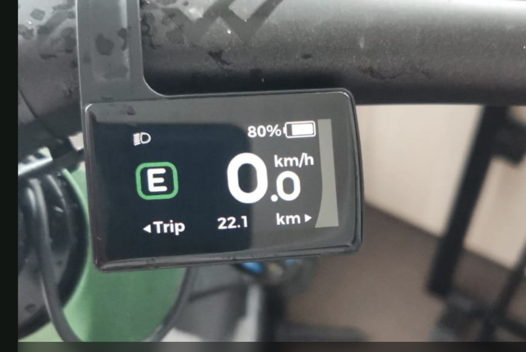

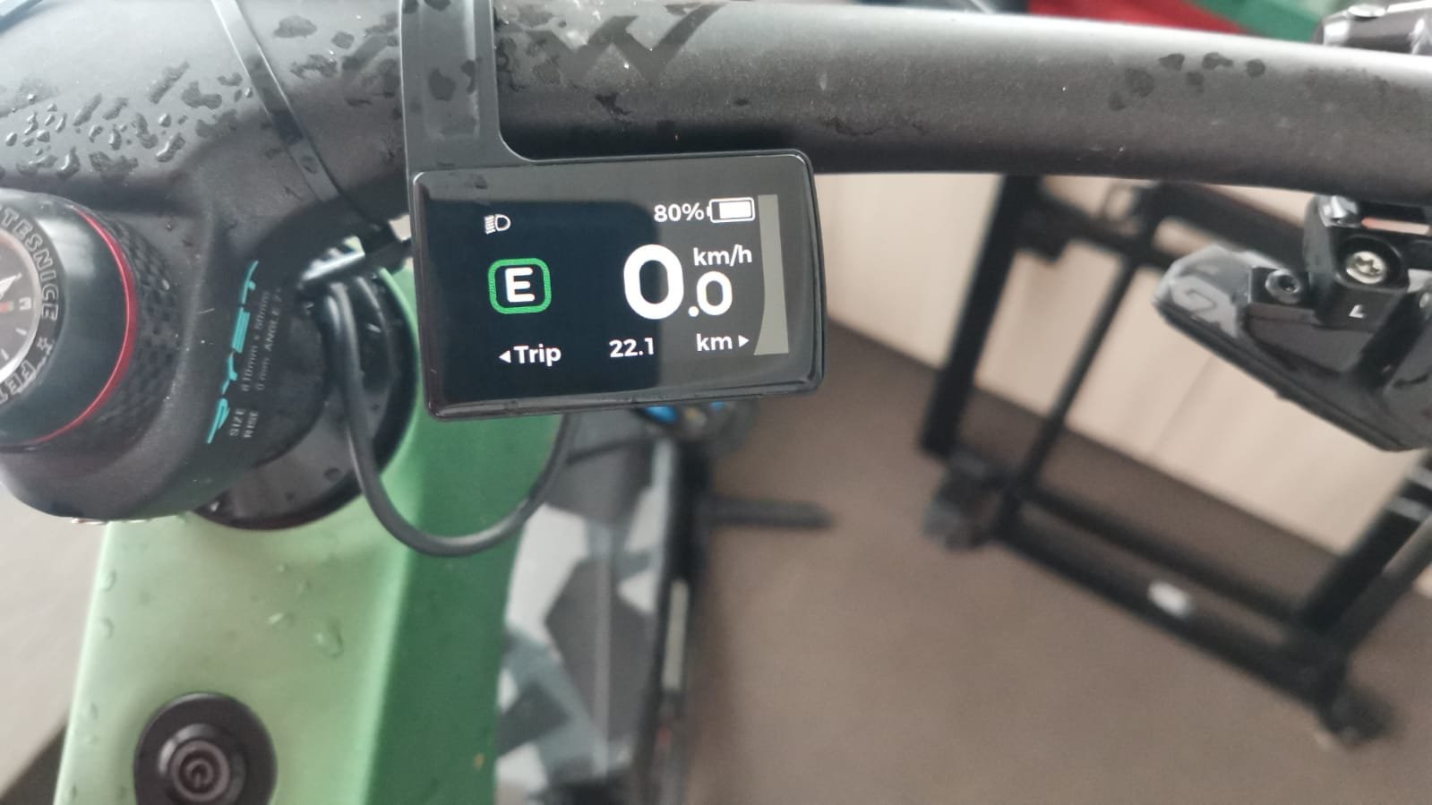

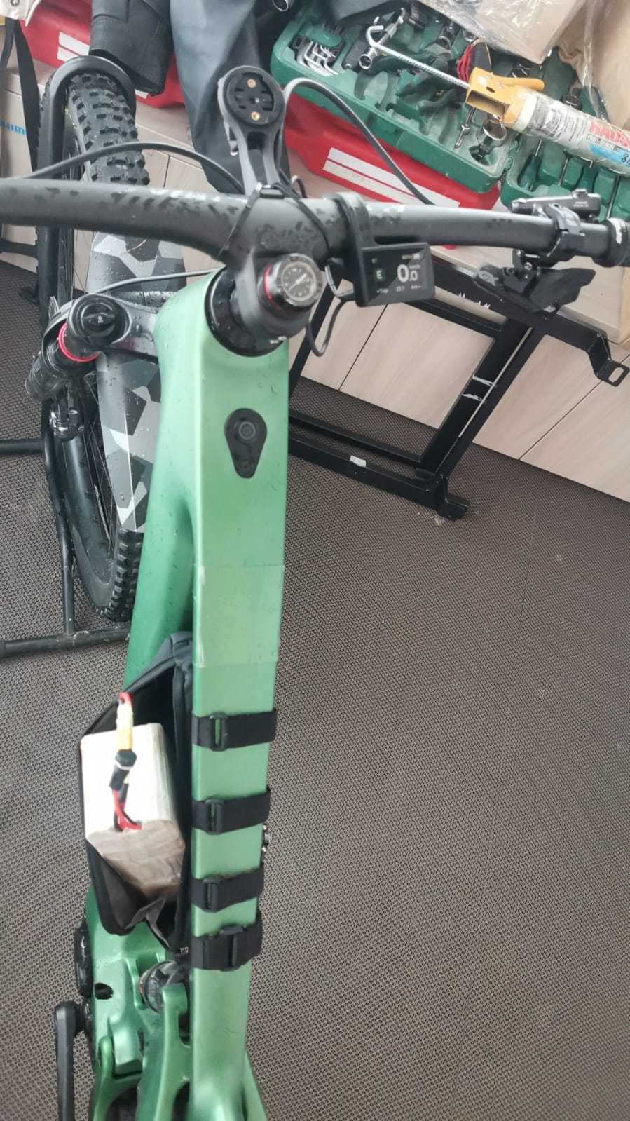

Yes, unless since the motor talks canbus to the display, the motor senses the battery data and it gets sent to the display via the motor connections. The folks here making DIY batteries can relate whether they are seeing the battery status info on their displays or not.

wondering... are there two versions of the M820 motor? One 43v and one 36v? Or is there only one motor that is compatible with both 43v and 36V? i.e. can you switch between batteries of different voltages on the same motor?
