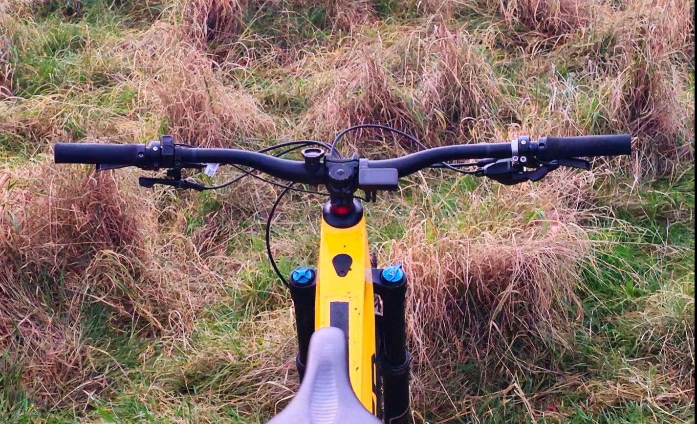

Is that V2 or V3? When did you receive it.
I think he has a Version 2 frame for the coil fitment (V2) and generation 3 (gen 3) motor guard.
Looks like the Gen 3 can take a hit.💪 I'm still waiting for more field data before, and if I buy one!😁

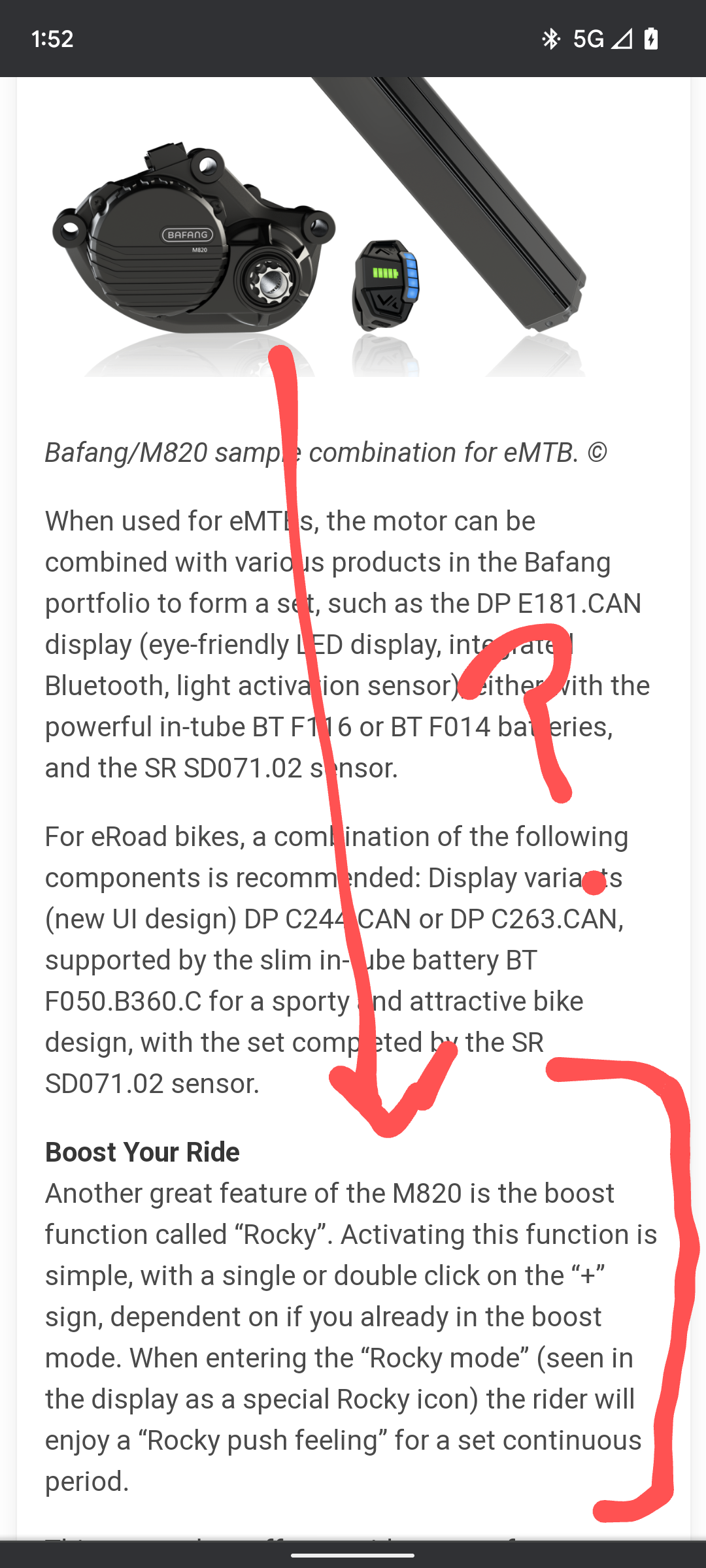

No Rocky mode. Just boost...which is speculated to be about 85-90%+/- of EP801's boost mode. It's continuos duration as well.👊
For boost mode... By default on my remote when i press + to max until it has B does it mean Boost or i need to double press + to enable it

Ok so far I’ve hit that area a number of times over the last few weeks and it seems to be holding up better.

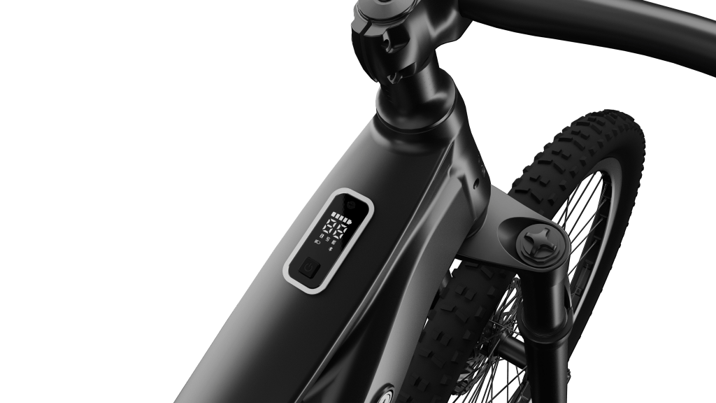

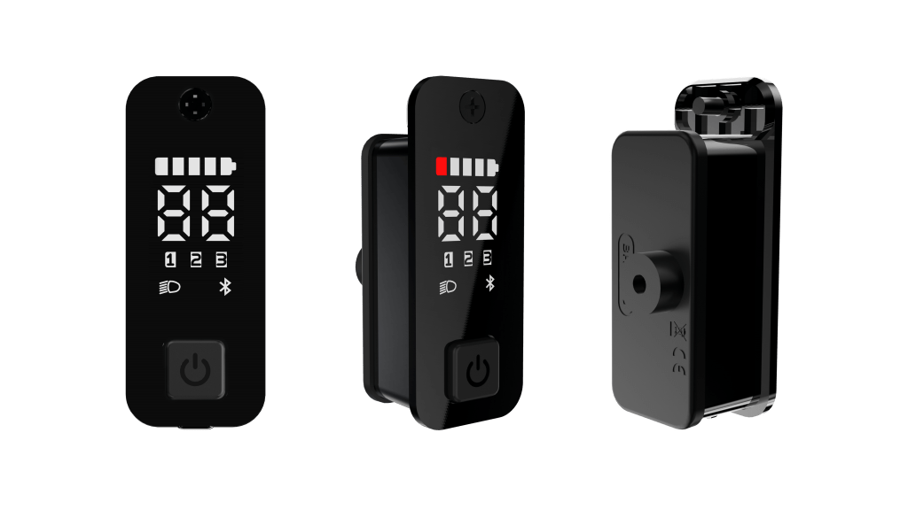

I wonder how easy it would be to retrofit the DP-E165 DIsplay to the CEF50🤔

I don't think any variant or generation of the frame would need reworking.
Moreso, just a revised top tube plate.
...Food for thought!!
Just normal one-push to max or boost.

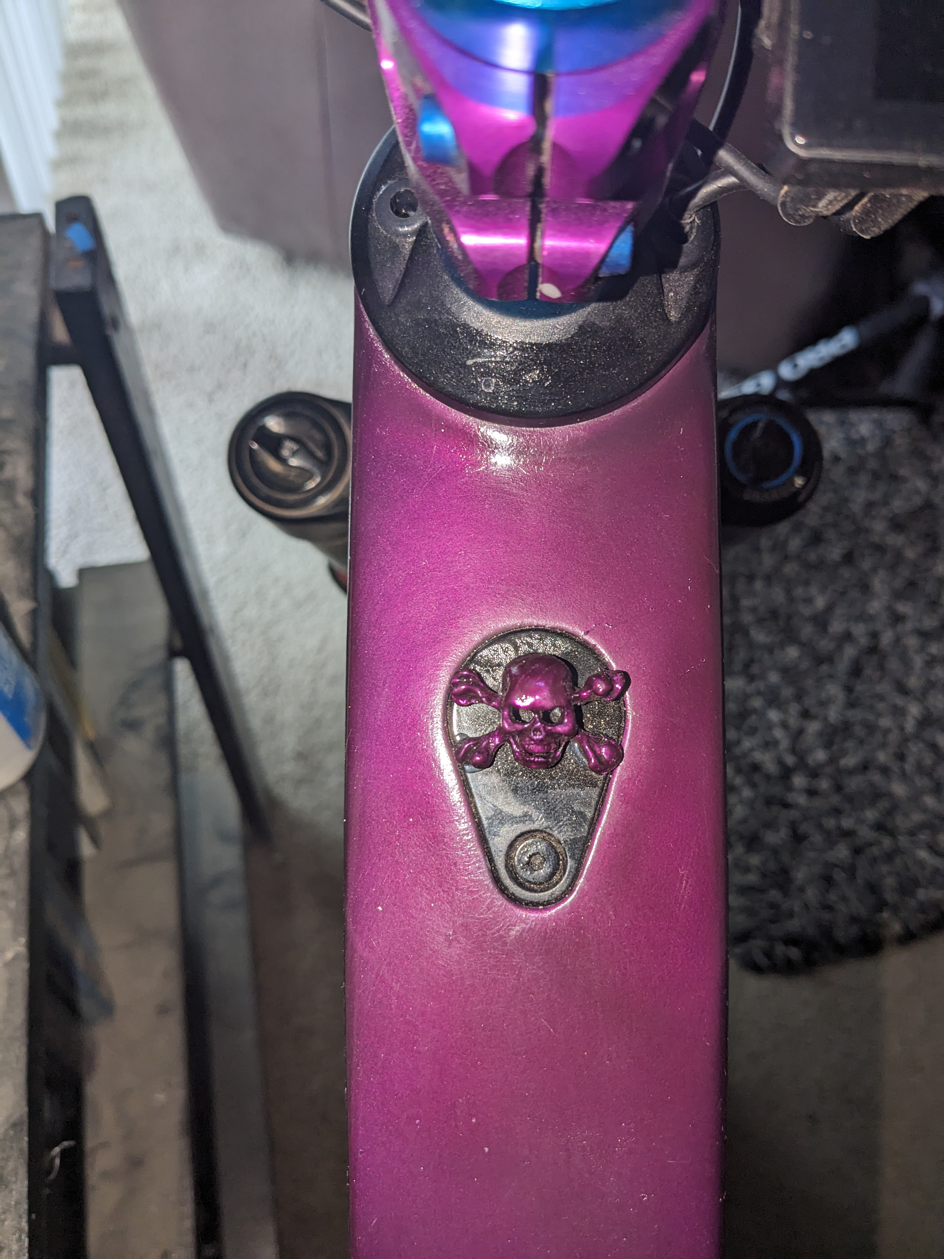

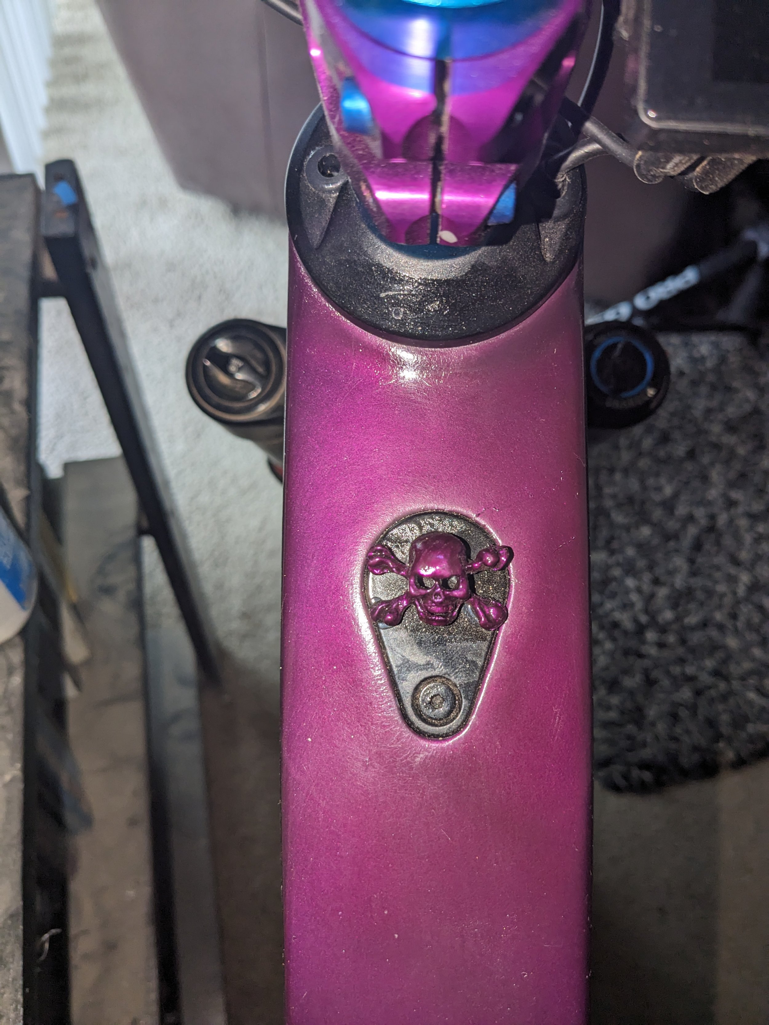

I’m not sure about that. That’s a pretty big cut out.
Yeah, it's a small surface area. Slightly bigger than a USD quarter coin. I tried to be creative (and a little rebellious) with my skull theme and just glued a metal Jolly Roger pennant on to it in order to be at least "functionally cosmetic".🏴‍☠️
I know it's a little off center. But so am I with my humor.😁😅
I would not want it. Have to bend my head too far down to see it. I prefer it up higher on the handlebars.
Me too...it's ok to be on the top tube with good peripheral vision but it's optimal to be more centerish on the bars and probably safest to watch the trail in front simultaneously.

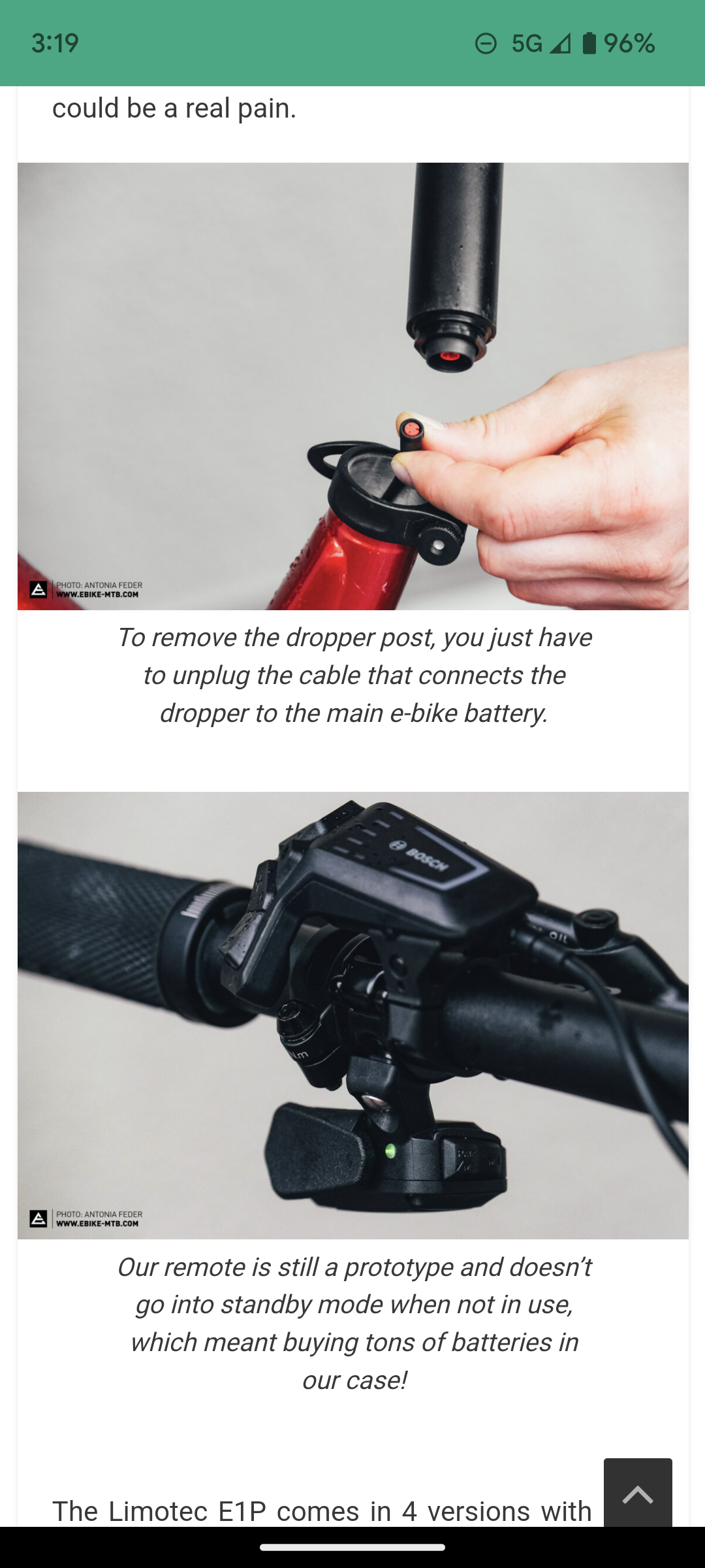

This dropper is $400 USD and wires directly to the motor or main battery not sure which. It's OEM now but available next year.

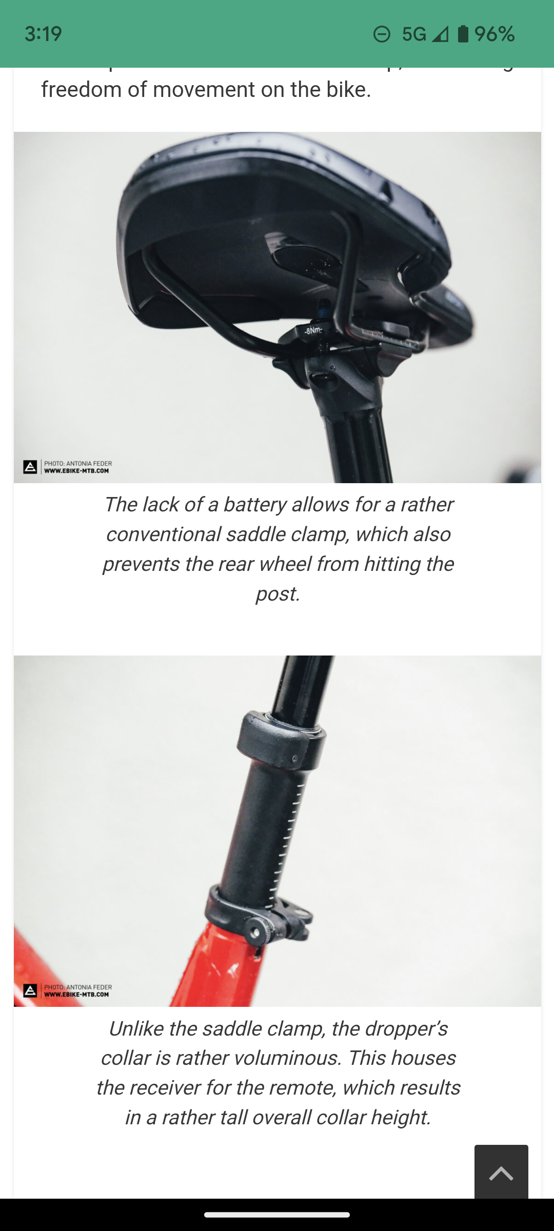

Limotec EP1 dropper post first ride review – the first dropper post especially designed for e-bikes
Features 👇
But how rig a wired dropper to be wireless? Servo needed right?
Yeah so, for my bike, it would NOT be wireless, as it makes everything bigger and more complex and need to charge other batterys, stuff that I am lazy as....like a car, I want it to all run from one main battery....so my interface would just be a wired button on my bar to my PCB that drives the servo... wireless just add extra work and stuffing around IMO, hardwired is the way i fly...
Ok gotcha...I think. No cable for dropper but electronic wire instead to run off main battery with servo and PCB (?). Does that sound right?
I'm thinking the new direct battery e-dropper is the way forward. I run old AXS shifting, so one less hard cable would be nice.
