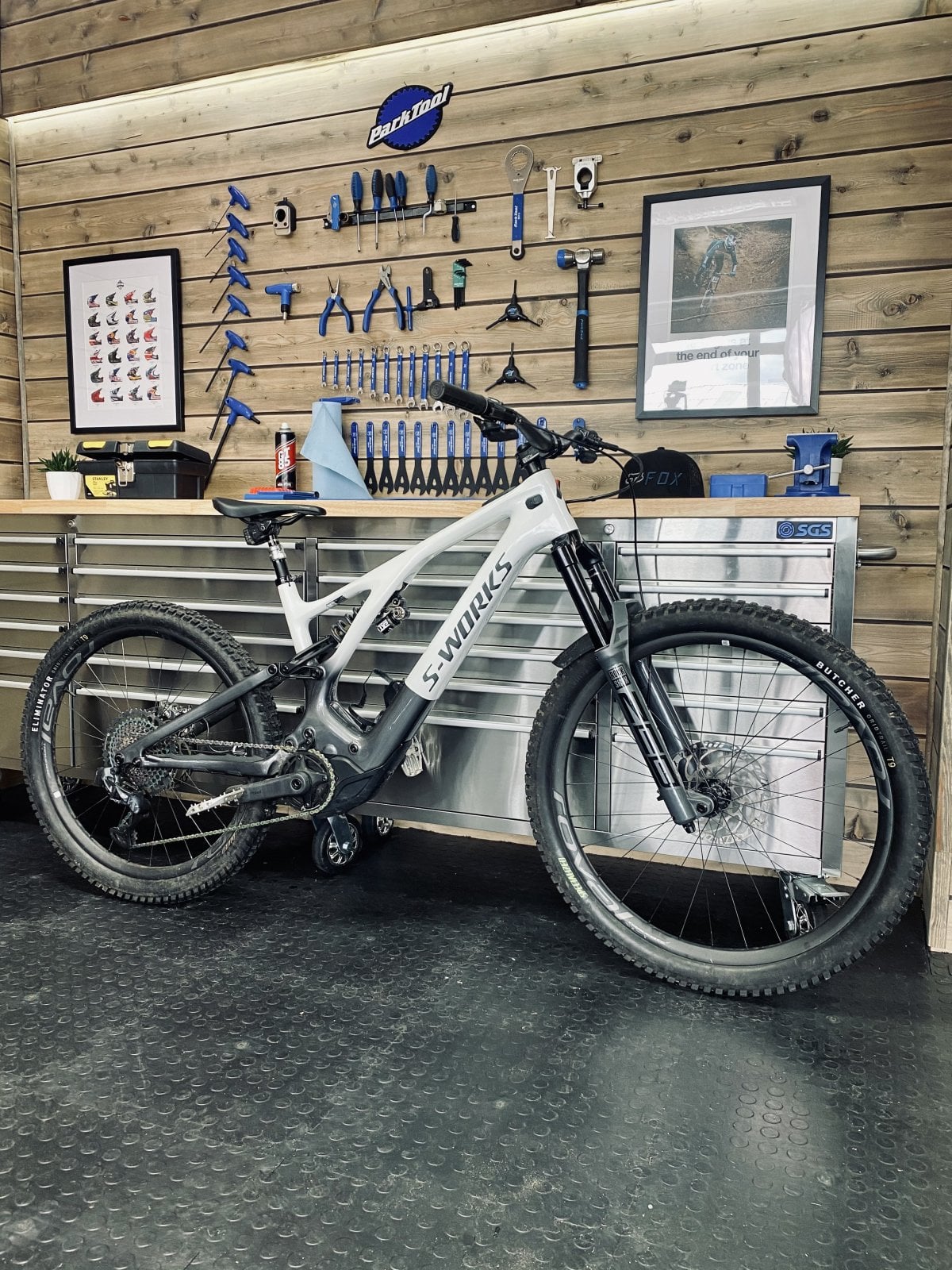

Alright, gave the Fox 38 one last chance this morning. The goal: to get a nice smooth off the top but decent mid stroke with bottom out resistance.
I already mentioned in another post, since riding the Gen 3 Levo, I have been finding after a standard fast ride in the Surrey Hills my hands are a bit battered. Side note... this could be a combination of the stiff carbon wheels, carbon frame and carbon bars.
Rider Weight: 85KG
Tyre PSI: 24f 27r
Fork: Fox Factory 38
Over the past couple of months I have mostly been running the Fox 38 at around 17% sag and about 92psi (my weight riding is 85KG). I've been running it at like this mainly to get it to ride high in travel and not bottom out.
So first ride this morning I wanted to set sag to 20% (which only actually needed around 80 psi, compared to 97 PSI recommended for my 85 KG weight on the fork guide). I hoped that this would improve the small bump compliance and reduce trail chatter. Weirdly this 80 psi seems much too low, but thats just how it is for me to get "correct" sag level on this fork.
First ride: Some roots and basic trails. Felt nice. Definitely a bit smoother. So far so good.
OK next to a drop. Maybe 4 foot to flat. Hit this and CRACK! Nice, harsh bottom out. No worries, 4 foot to flat, maybe thats asking a bit much with fairly low psi. Faff around with HCS and LSC a bit. Hit it again, same thing, crack!.
Next hit a jump, 8-10 foot, nice landing. CRACK! Bottomed the F outta it again. So 80 psi, 2 tokens, feels nice on the trails, but no way near enough support.
Back home, put another token in it. So now 3 tokens, set sag to 20%. Do the runs again. CRACK! she bottoms out.
Next I played with the PSI, adding 3 psi after each bottom out to try to find the sweet spot. I try and tune the fork to what I will typically be riding, use all available travel and try to keep it fairly comfortable.
In the end I found a setting that *almost* works, but hit a jump about 15 foot, CRACK, bottom out again.
To summarise, my particular fork needs a decent amount of PSI to run pretty low sag (15-17%) to keep it running high in the travel, definitely closer to their recommended settings for my weight, at the expense of rider comfort. And when my hands start getting battered on the trail it actually makes feeling the front tyre, feedback and grip levels a but more difficult...
I'm now gonna go fit the Zeb
