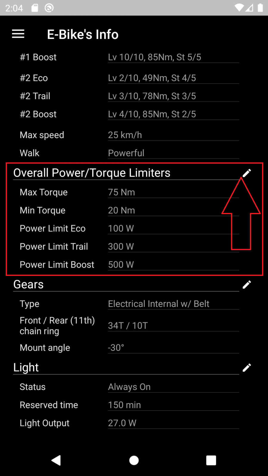

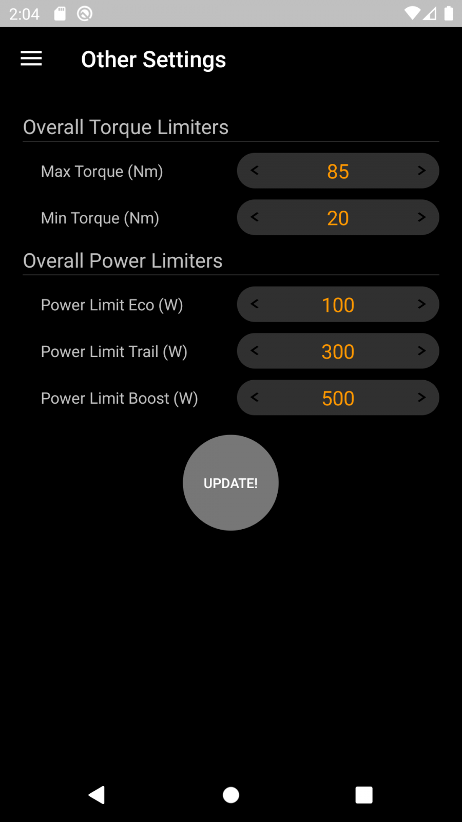

ok...I am going to try this...I see the NM slider (to go from 60-85), Is there a setting/slider somewhere to raise the overall watt output above 350?
It's in the same place as the torque limits!
p.s. Those settings are available for the Premium licence

If you have the premium license on ST Unlocker try it...you can adjust Watts and NM, so in theory it would runlike a normal ep8 just drain your battery faster...you would be the first!
