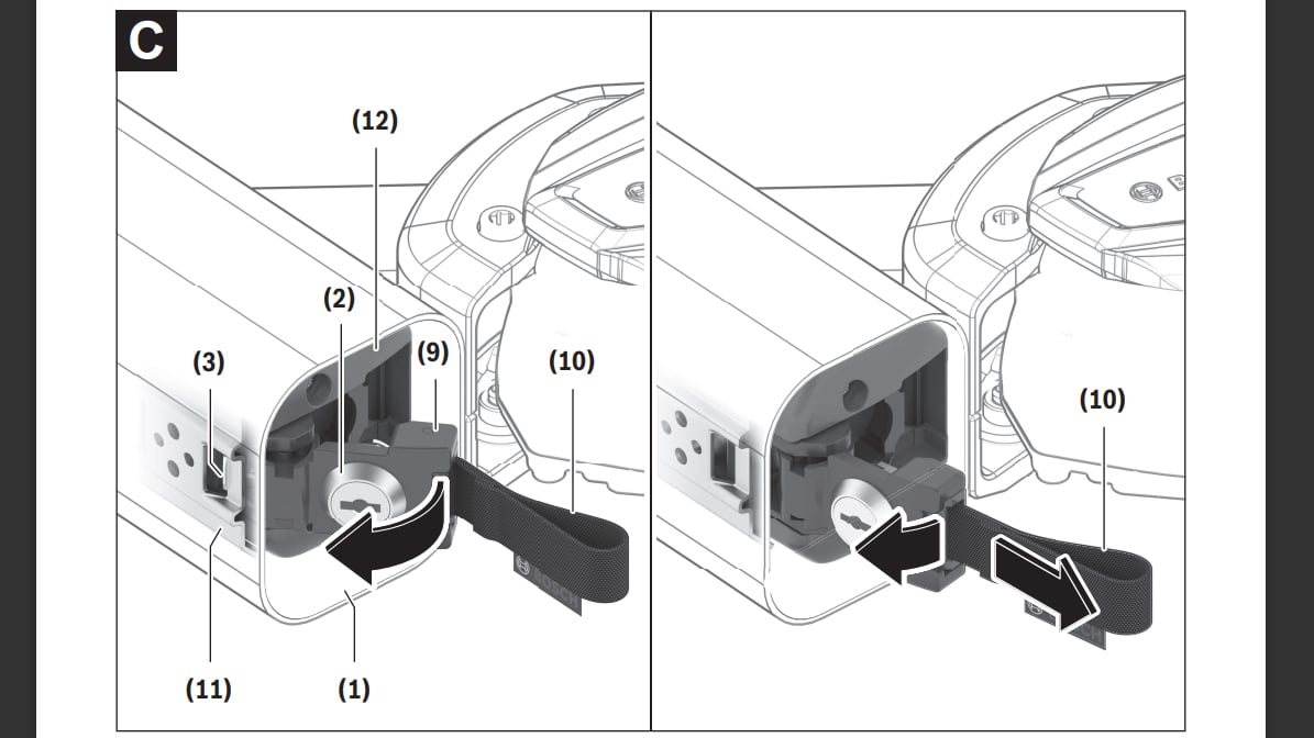

The latch mechanism is made to be able to be able to take a lock with a key.
I wonder if using the lock with a locking "deadbolt" would make it stronger with the deadbolt taking the weight.

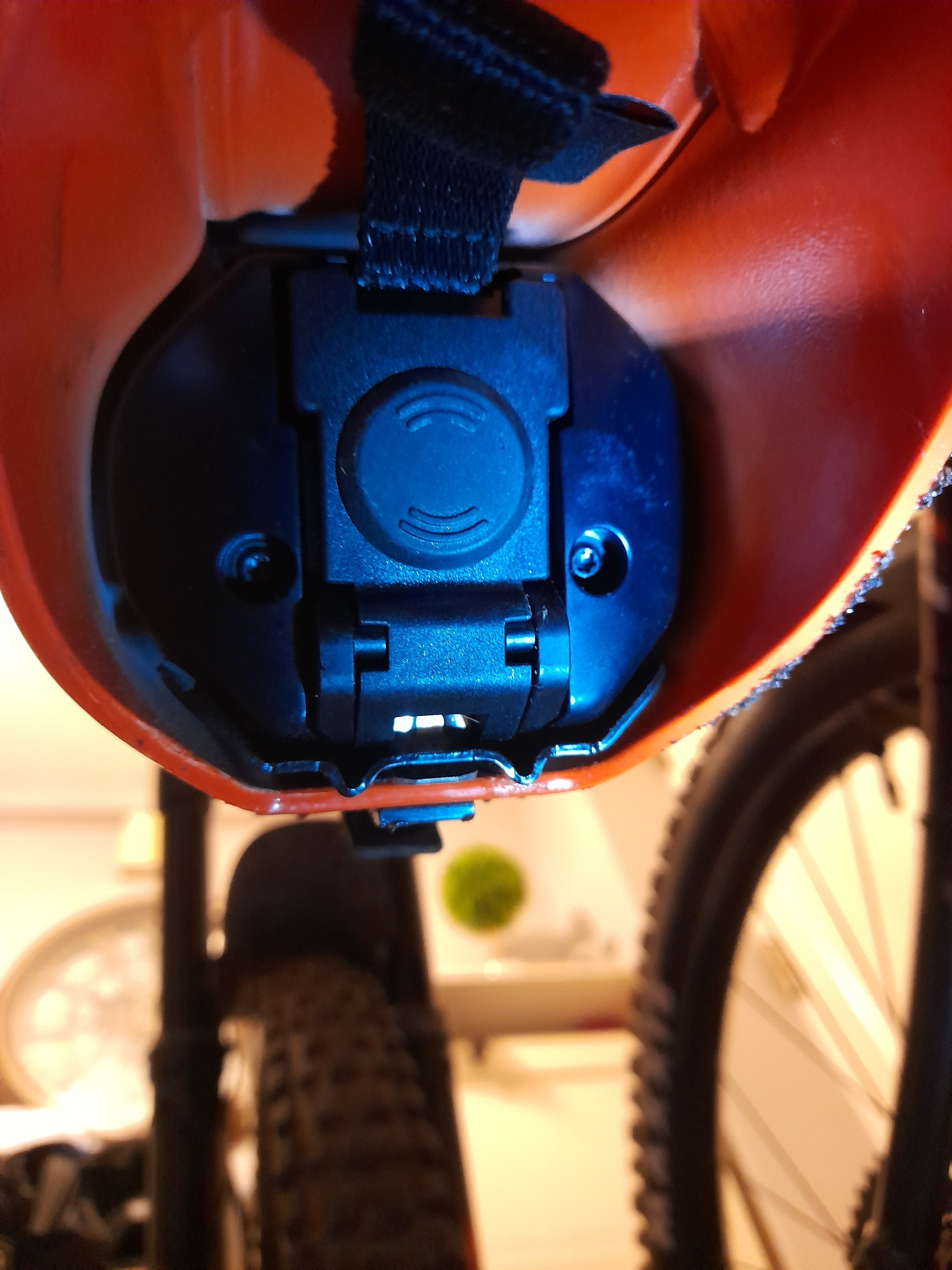

In the meantime I investigated battery connector inside the frame and I see it has some play. Currently that’s my primary suspect for engine cut-offs and rattle.
Does anyone know how that connector looks like, how it’s mounted and if there is any adjustment there.
@Rob Rides EMTB , you built your bike yourself, do you have any photos of that connector by any chance?

I just received the latch with the Abus lock, and it doesn't seem to be much stronger than the stock Bosch latch.
The lock does not add any additional support, in my opinion.
I was hoping some part of the weight would be resting on the lock itself, as it's placed centrally in the mechanism, but unfortunately, there is still a gap so that the whole weight of the battery is still resting on the little tabs that are getting broken.

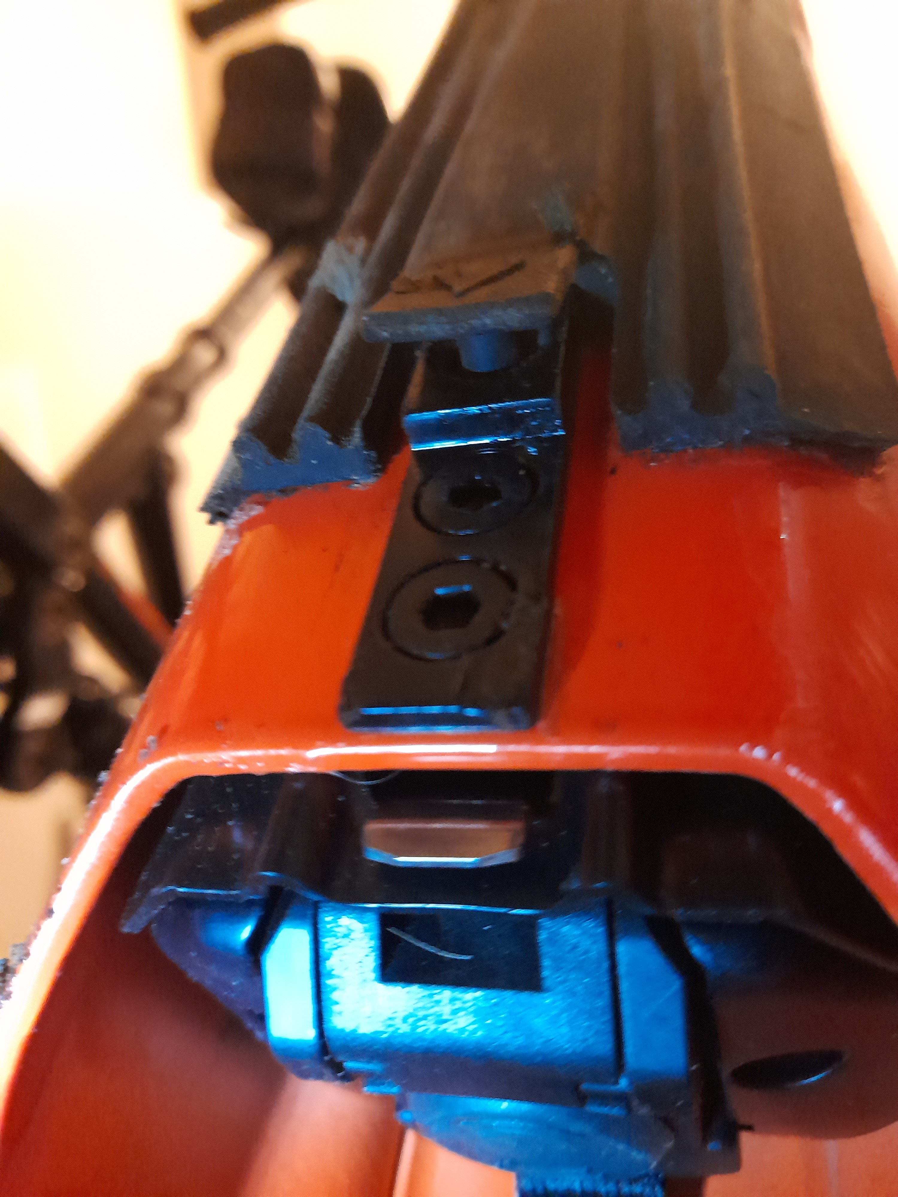

For enclosed downtubes the Bosch rail system option is called "axial" or vertikal in German I believe. It is black painted steel and the pic below shows it is fixed in the downtube with 2 closely positioned bolts at the top and bottom. On my bike those bolts are clearly visible on the downtube. The rail is specified as the one for 750w/h batteries but it looks like it actually has 3 positions for the battery connector....presumably 750, 625 and 500.
I am guessing that the battery connector complete with wired connections, is fixed to the rail before the rail is inserted. On my bike all those cables are then fed into clips on the rail. The bottom 2 bolts would be easy to align and then the top bolts would also align.
So .....the point of showing this.....it should be relatively easy to remove the rail complete with battery connector at the top for inspection.
Ps.......prior to bikes using the Bosch Smart system Whyte located the battery connector at the bottom of the battery but it did not use the Bosch rail. It was reliable but made battery removal and install awkward.

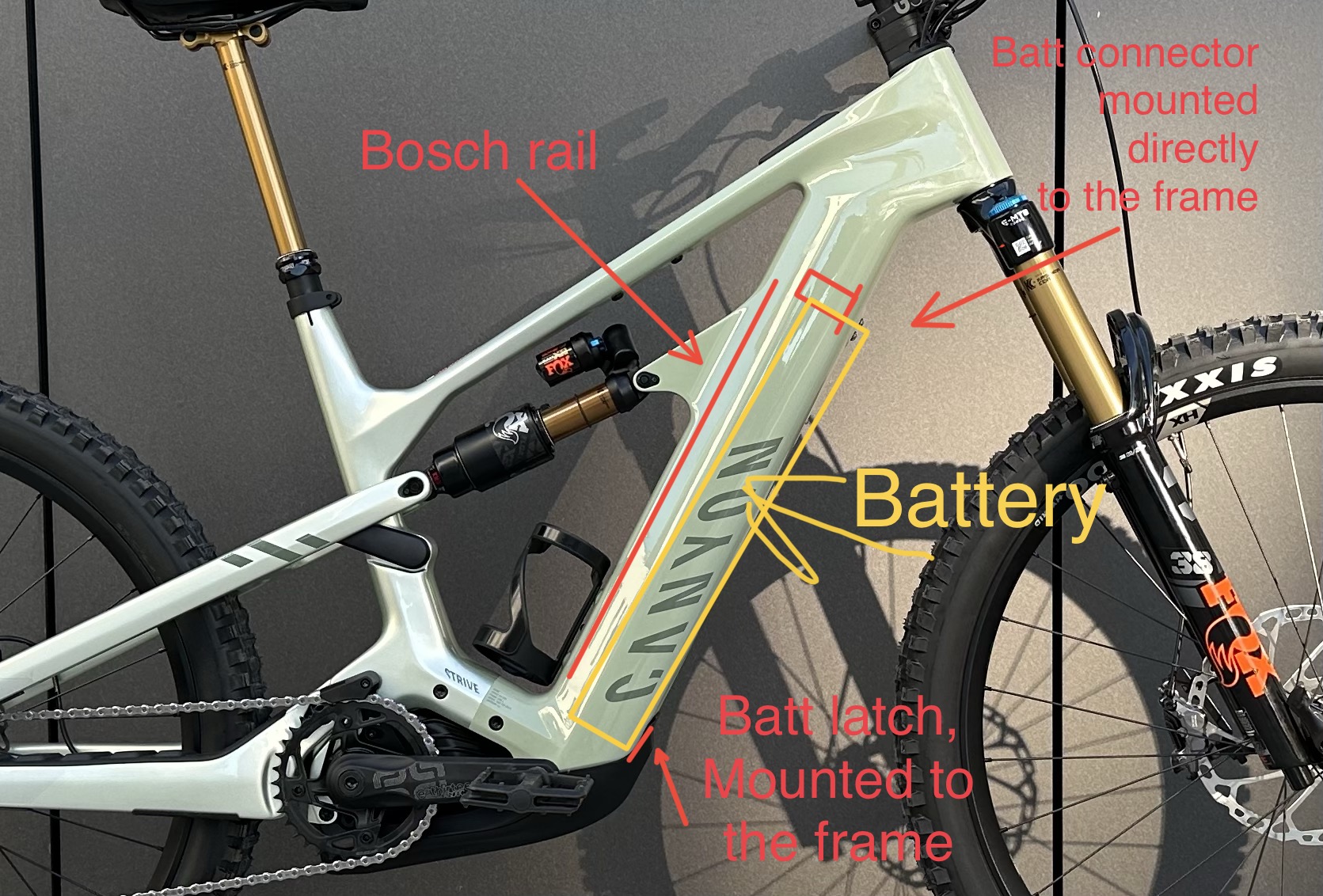

UPDATE: It's actually a cable rail, not a Bosch mounting rail, that sits in the upper part of the downtube.
In the Strive:ON Canyon decided to put this rail on the upper side of the downtube, and it seems that the rail itself is not doing anything other than covering the cables.
The battery connector and the latch for securing the battery are both mounted on the bottom part of the downtube, directly to the carbon frame. They're not connected to the Bosch rail cable rail.
As a result, the battery weight is not resting on the rail but on the battery latch and the connector.
*Sorry for my poor drawing skills, hopefully, you can see what's happening.
The battery connector and the latch for securing the battery are both mounted on the bottom part of the downtube, directly to the carbon frame. They're not connected to the Bosch rail.
*Sorry for my poor drawing skills, hopefully, you can see what's going on.
That makes perfect sense. It seems that other manufacturers have the battery ‘resting’ on the rail which makes perfect sense for an almost 5kg component, whereas Canyon have chosen to have the battery directly on the downtube and secured either end by the connector block and latch. In the case of the Canyon, is the rail actually serving any design purpose at all?
Note - my Strive:On is yet to be delivered so I can’t check my own bike.
I'm honestly not sure, it looks like it's just there to secure the cables in the downtube.
The cables are running from the motor, under the rail, up to the battery connector and the controller.
Now when I look at it, I'm not even sure if that is a Bosch rail or just a cable rail.

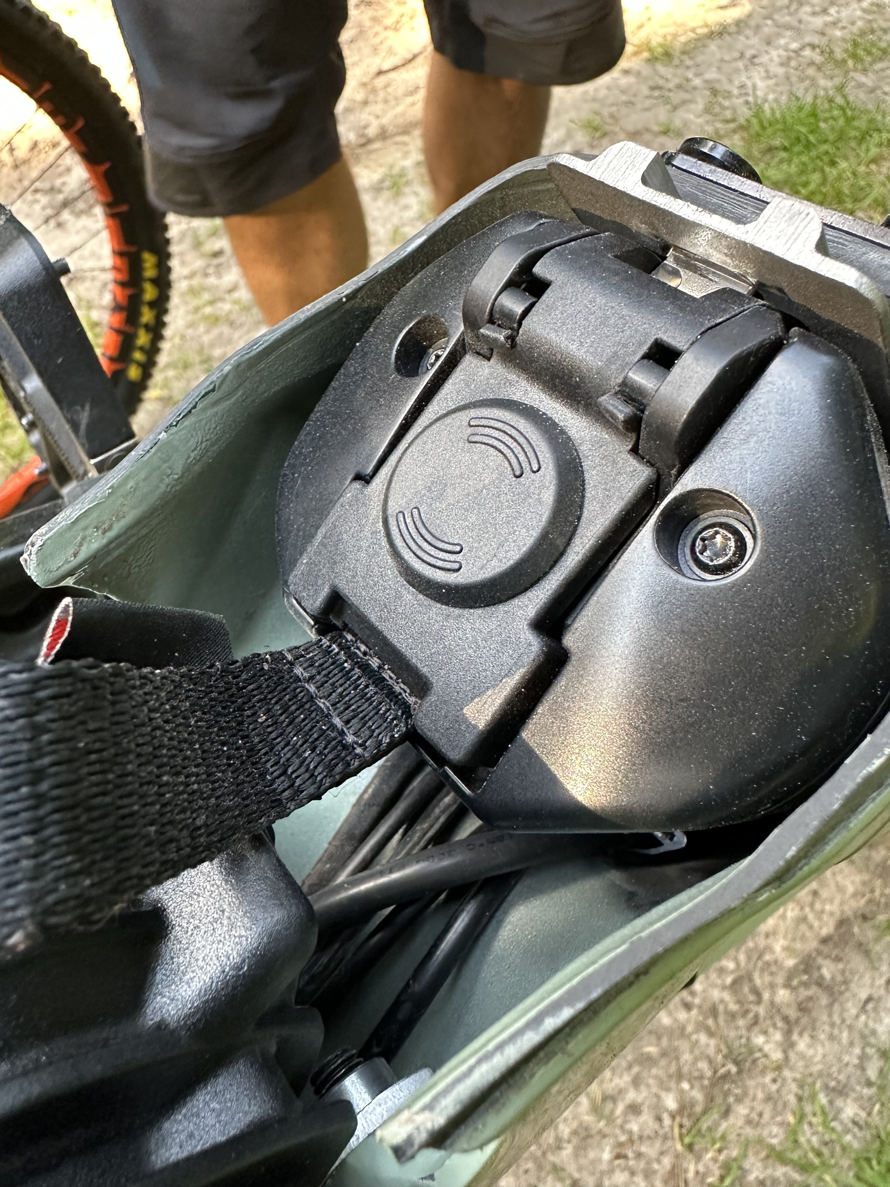

(The bike is obviously upside down, I rotated the photo to show how it's placed in the normal riding position).

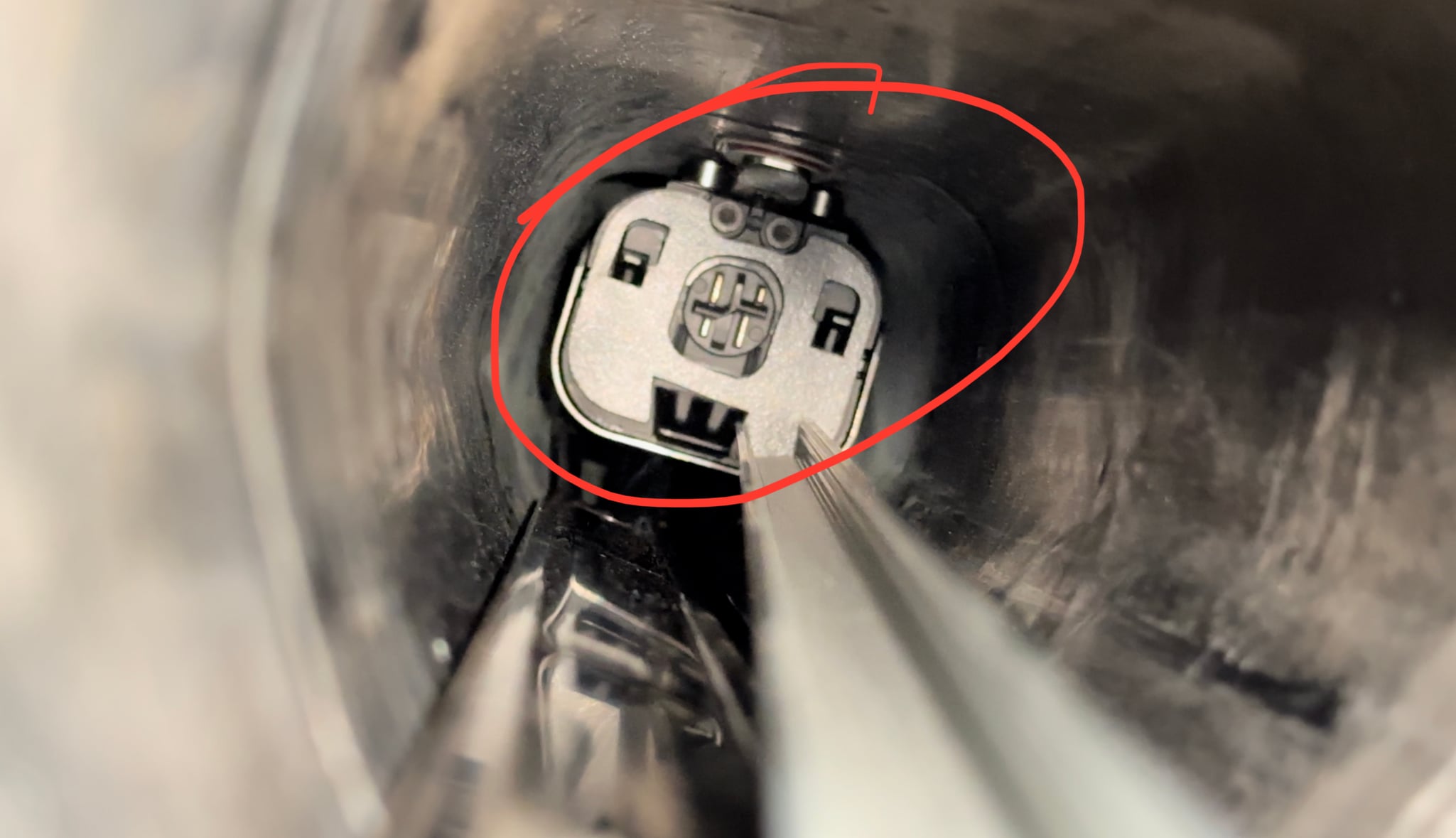

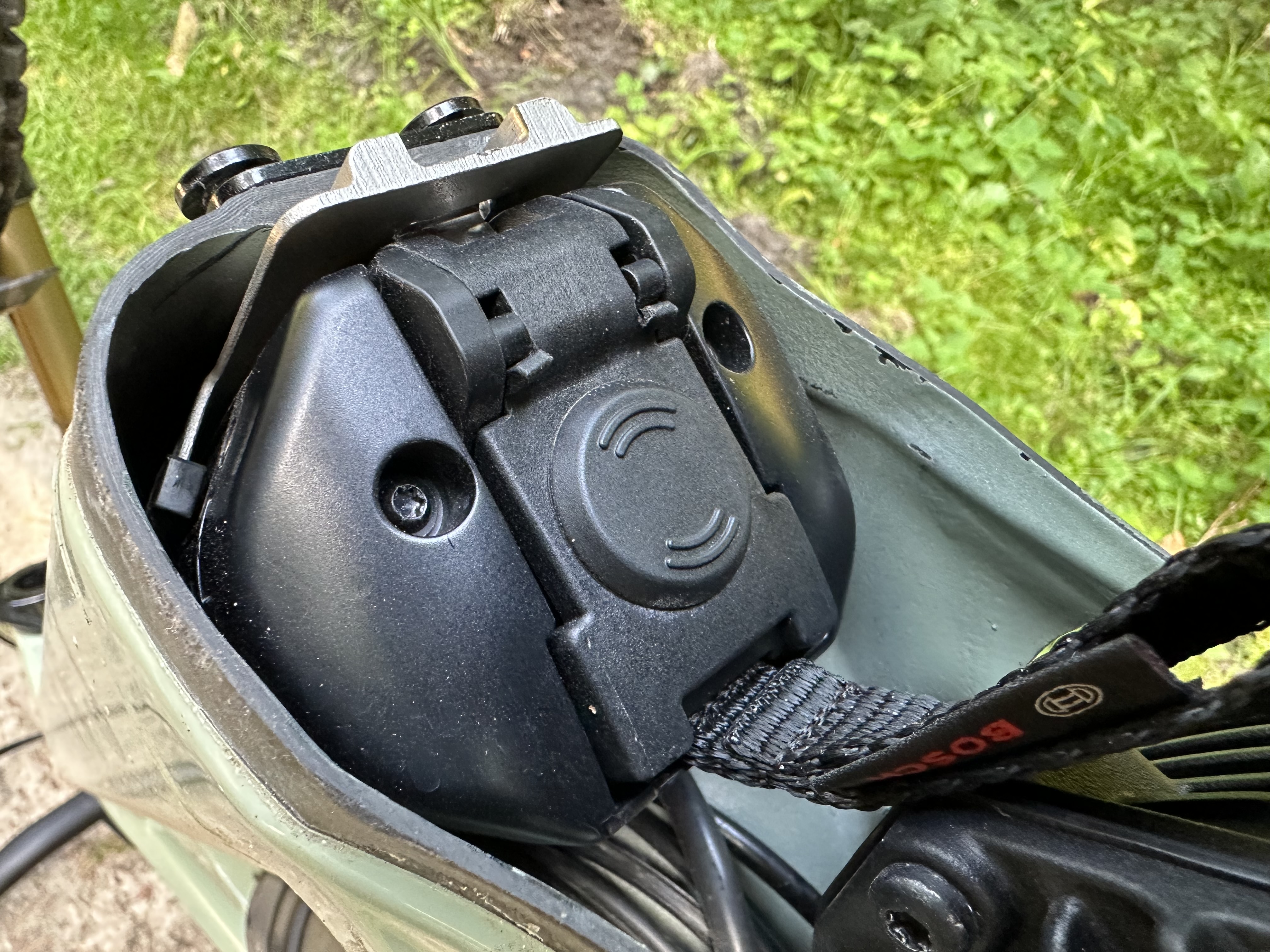

The wire rail is on the top; - not sure if that's the Bosch rail, or something else.
The connector is mounted directly to the lower part of the downtube, the same as the battery fastening latch.
Here is the close-up of the connector itself:
PS. Sorry for my filthy downtube, I didn't have time to clean it, and this thing is ridden a lot 😅 🤣
That seems really strange. Wonder why they decided against using the rail.
well done .....you are right...that is not the Bosch rail system it is just a cable holder.
I am not sure I agree with you a bout the cause of your problems however. The issue looks to be similar to the issue that plagued Trek Rail models....specifically the battery is not secured well enough to prevent it moving. In fact I can see nothing in your photos to keep the battery secure other than the cradle/ latch bracket at the bottom and the a ctual battery connector at the top. If the battery has the a bility to rattle a bout it will destroy both the latch and the battery connector over time. So the solution as far as I can see is to find a way of securing the battery along its length. With the Trek Rail, owners resorted to inserting various types of packing material in the downtube and a pad on top of the battery connector to take up any play. Your planned mod to the latch may help take out some top to bottom play but it will not prevent any lateral movement of the battery so I think both aspects need to be addressed.
given how far the latch holder ally component protudes beyond the bottom of the downtube, maybe the downtube is not long enough to use the Bosch Rail..........or they decided against the extra weight it involves? Poor decision if so!
So from what I can see, they have ‘sandwiched’ a Bosch battery (and latch) between a Bosch terminal / connector block and a Canyon mount
I’m not an engineer, but I would imagine that any flex in the downtube would cause the distance between the two connecting points to expand and contract and that may lead to the intermittent power issues which some have experienced. Had there been an independent rail for the battery (and connecting points) then this may improve the situation.
There seems to be ample space around the battery and terminal point, I wonder if the Canyon mount could be removed and the Bosch rail installed instead?
another observation is that the latch piece is ally whereas the Bosch rail is steel. The slot provided on the ally section for the latch will wear, and that will enable things to come loose over time. It is a design issue that Canyon need to rectify in my book.
