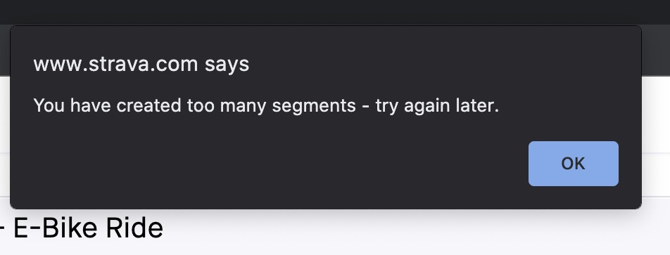

Strava limits how many segments can be made at one time. Try again 24 hours later.
Wont work! Does it work for anyone else ? Seems like strava has changed its code.
are you sure it's not creating some segments up to the max number that Strava allows per day (10?) and then refusing to create any more (until you run the script again later)?
Yeah, havent made segments for a week or so… asked my buddy that I did install it for as well, he gets the same error. Was at the same time as they updated a lot of features in strava.
