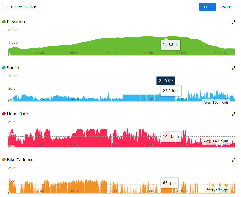

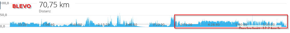

I have this strange Software Bug my Levo (2020 Comp) developed that I was able to capture by acident on my last ride.
I normaly record all my rides with my Garmin Fenix Watch mounted to the handlebar and I have seen this bug now and than but a reboot of the bike ususaly solves it and I didnt think of it. What happens is that the speed sensor constantly sends 26,9kph even if you stop.

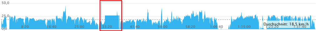

So on my last ride we wanted to ride a tour I got as GPX and since I am having a hard time following routes on the tiny display of the Garmin watch I decidet to mount my phone running Blevo and use the map feature there (works great btw) while keeping the watch on my arm and record as usual. When we came home and stoped the activity I was suprised that the Garmin congratulated me on a new record. So when reviewing the data I found that this strange bug hit once more and the Garmin also recordet a distance that did not match the route.
Investigating further I imported the GPX from Blevo into garmin, here are some screen shots of the same ride:

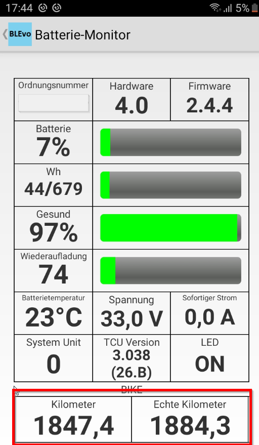

My first thought was that the problem lies with Garmin but than I looked at the Battery Monitor in Blevo and it now shows a difference in "km" and "real km"
In fact I could not care less what bugs me is that it now looks like I have tampered with the bike and the speed restriction and how it will affect warranty,
and yes the battery has 74 charge cycles this is the 3rd Motor the bike itself has 4800km on it.

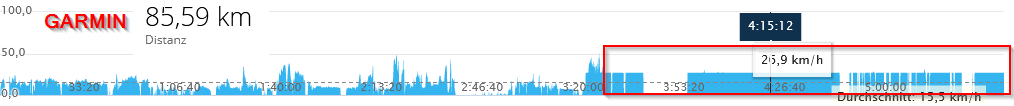

To follow up on myself, went for a ride and it did it again (this time without Blevo), also my statement in the first post that it shows it even if you stop is not correct it just feels like it. When you stop it takes 5-10sec to drop to 0 and when you start pedalling again it immediately is back at 26kph
Red part zoomed in:

My watch is also a Fenix 6x but as I said before I dont think the issue lies with Garmin, if you happen to have Blevo it would be interesting to know what your Battery monitor says about "km" and "real km". Also I started to click through my old activitys and found at least 3 more with this bug all of them show values between 25 and 27 kph so right after the motor cuts out. It also seems that the problem started with my 2nd Motor so Iam narrowing it down to the speedsensor or TCU.

Found it, speed frozen at 27,2 km/h:
thank you, yea that looks familiar I realy appreciate you looking into it! It always makes you feel better to know that you are not the only one with a problem like that. Do you run the latest firmware? because I dont.

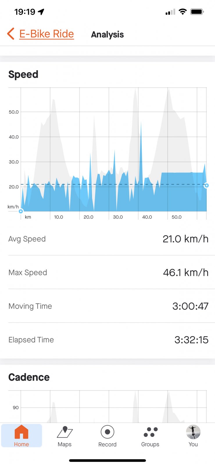

Hi ! Same bug here. I have a Garmin Epix watch and the Garmin Edge recording speed/ cad from my turbo levo expert. They both report the speed freeze at the same time/ same random value (probably the last being sent). I think the tcu stop broadcasting the speed for some reason… after shut/ start of the tcu, speed value comes back…
Hopefully Spez will fix this bug in next release. Annoying…

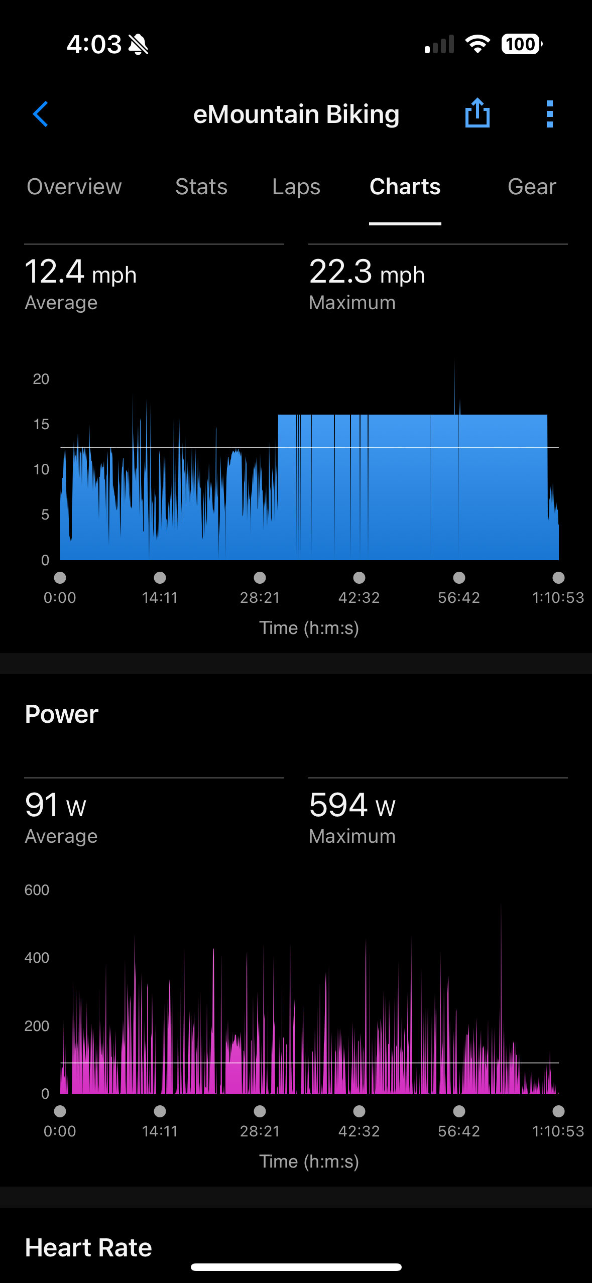

I just noticed my 22 levo GEN 3 has started to do the same thing where it gets stuck at 16.2 miles an hour according to my Garmin edge 1030 plus. Did anyone ever figure out a solution to this problem? Is it as simple as a firmware update at a specialized dealer? My Bike only has maybe 500 miles on it and this issue happens at around the 50 minute to one hour mark when riding.
Digging through my garmin data I found this for what was my ride. No surge in power felt although once it got stuck at 16mph it did feel as though there was marginally more assist.
