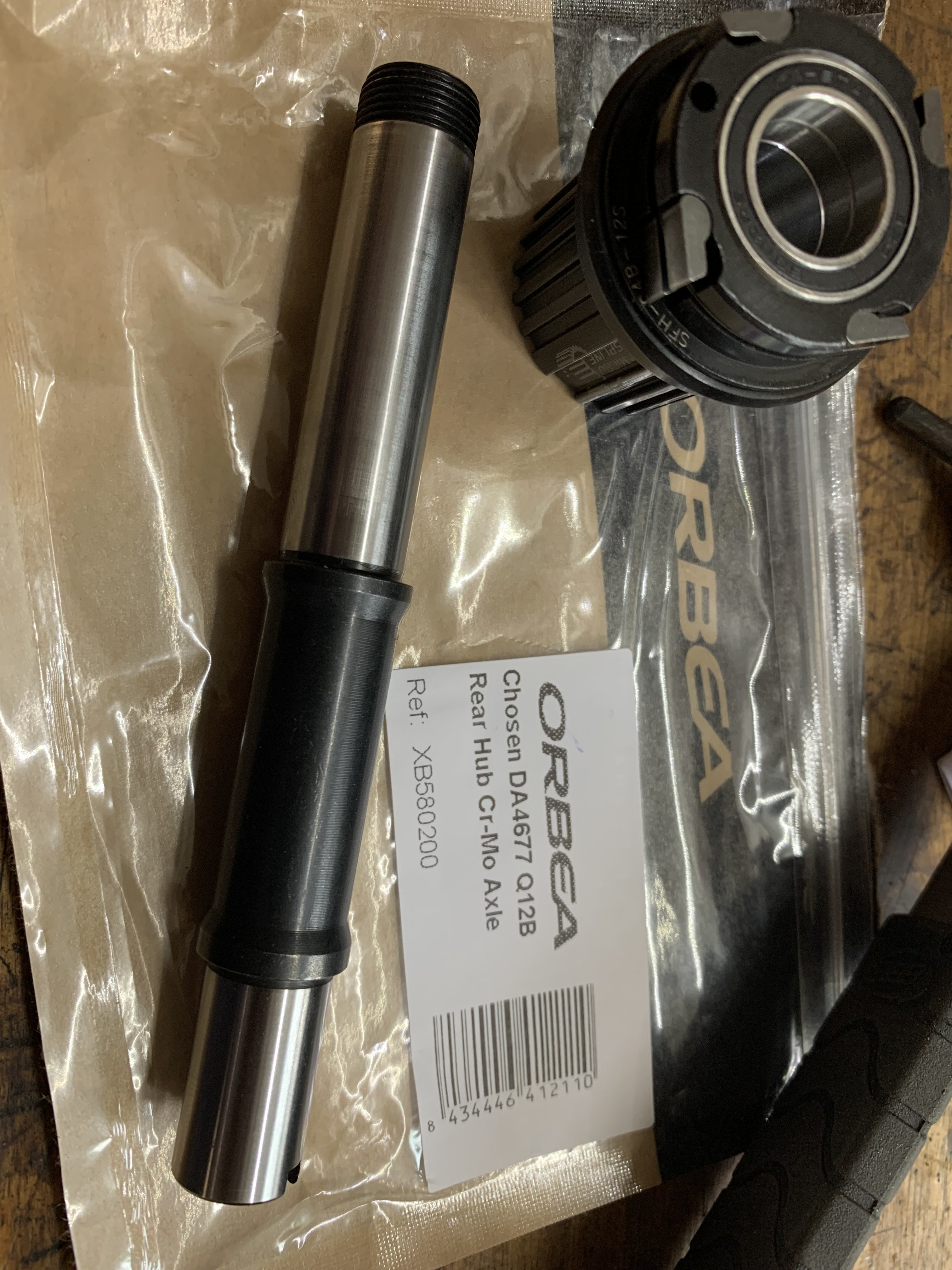

You don’t want that alloy shaft, it should be chromoly steel as the replacement free hub is. There’s numerous people have had the shaft snap or wear through
Here’s the steel shaft part number (edit, again, posted so many times I’ve forgotten where😄) they supplied under warranty next to the warranty replacement free hub. As you can see the material is black, steel. V the whiter alloy of original we get originally
Is the front an alloy axle too do you know? Is that a waste of time too? Might tell the shop it's not satisfactory if it doesn't come with the axle.

Yes if you replace under warranty they send you the correct chromoly steel one
But replace the axle as well as it snaps or wears through in some cases
It’s covered on here somewhere
