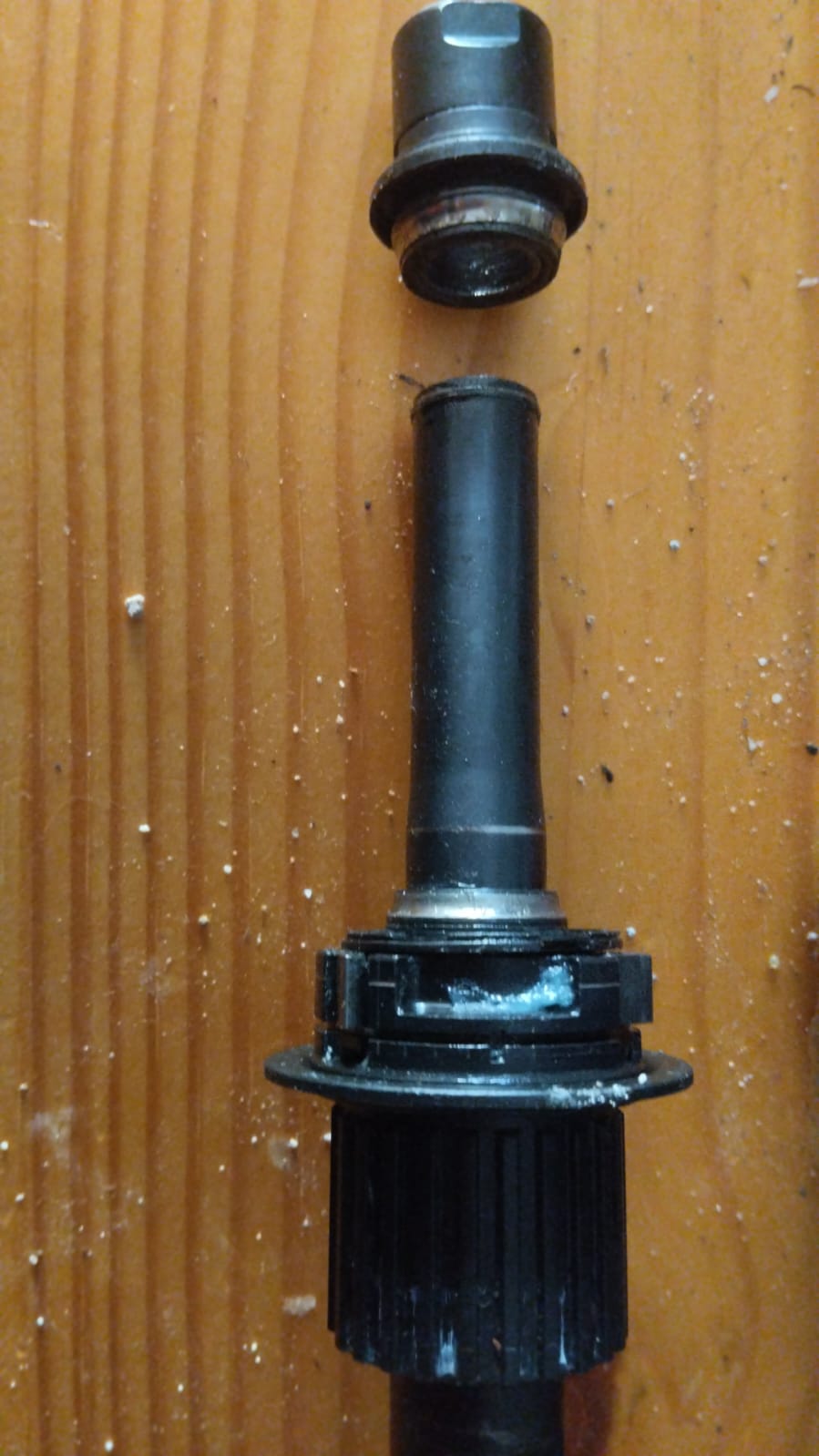

Stock H15 rear hub is destroyed after 4 weeks

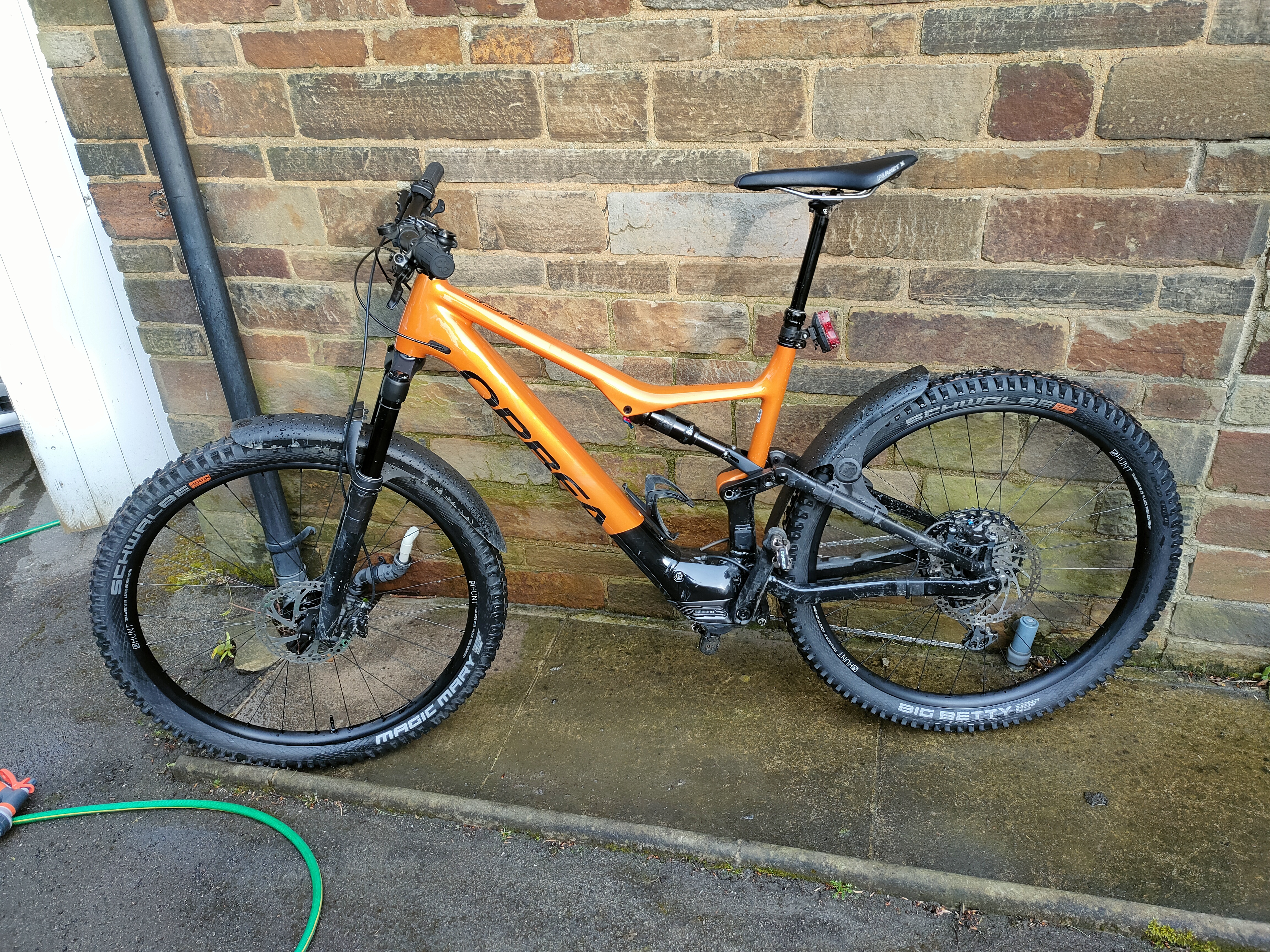

Looks like a new one Lee (y) They are a nice looking bike, although I notice you've lost half of your rear mudguard :)
It's identifying as a short mudguard at the moment while it's dry round here, when it gets muddier again it will identify as a full mudguard.... ;):)

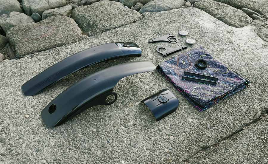

It's a muckynutz and you can take part of it off when you don't need it.... (y)
I haven't seen that type of guard before - I assumed you were one of the young'uns who prefer to be covered in mud rather than deface the bike :)

Here's my hub after 119km, just starting to deform, now retired so it can't cause any problems. To unscrew the axle I put the 'spanner' side in a vice with two hex keys in the slots, then used two large screwdrivers on the slotted axle.

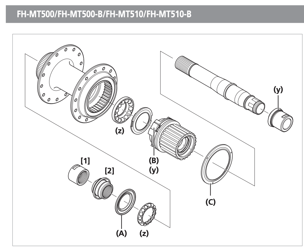

Just wanted to give you a quick update after getting my wheel replaced under warranty about 6 months ago because of those pesky hub issues. They hooked me up with a brand spanking new wheel with the MT510 hub, which seemed solid at first. But then I started noticing some problems with the cassette, and I blamed it on the chain wearing out. So, I replaced the chain, but it still didn't work smoothly, though it did the job.
Then, last week, I was doing some maintenance and when I took off the rear wheel, it slipped right out of my hands. Man, I was so confused! It wasn't until I checked the hub maintenance handbook that I realized what had happened. The freakin' axle had snapped! I've probably been riding around with a snapped axle for who knows how long. Seriously, these Shimano axles are crap!

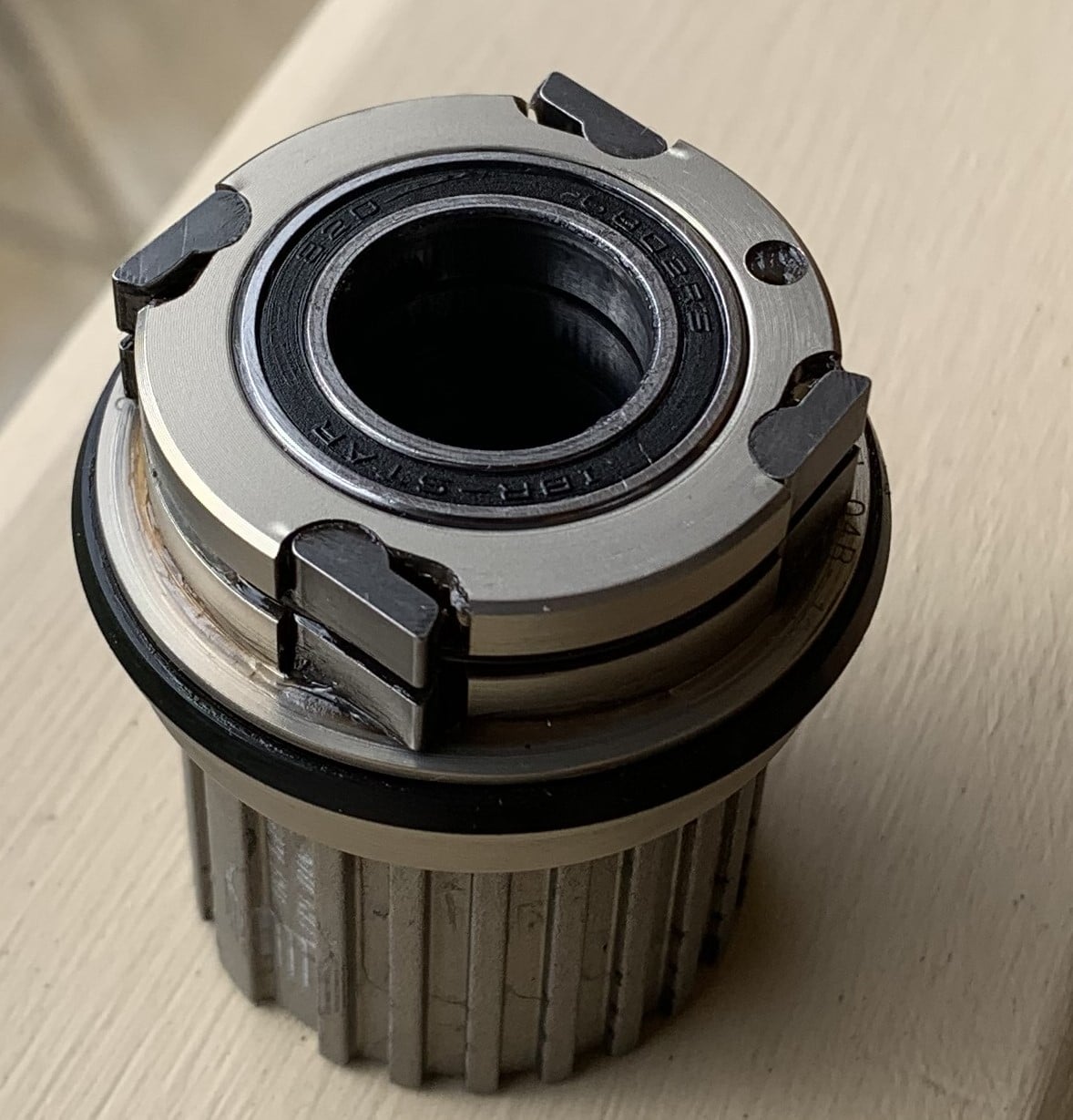

Hi, bit of a worrying update on the factory wheels, finally got word from the dealer and orbea have sent a replacement freehub - supposedly upgraded. No new wheel and no replacement hub. I've contacted them and told them it's pointless as the rubbish axle is already scrap just from trying to get it off. So for anyone hoping to get a replacement wheel you might not have the option.

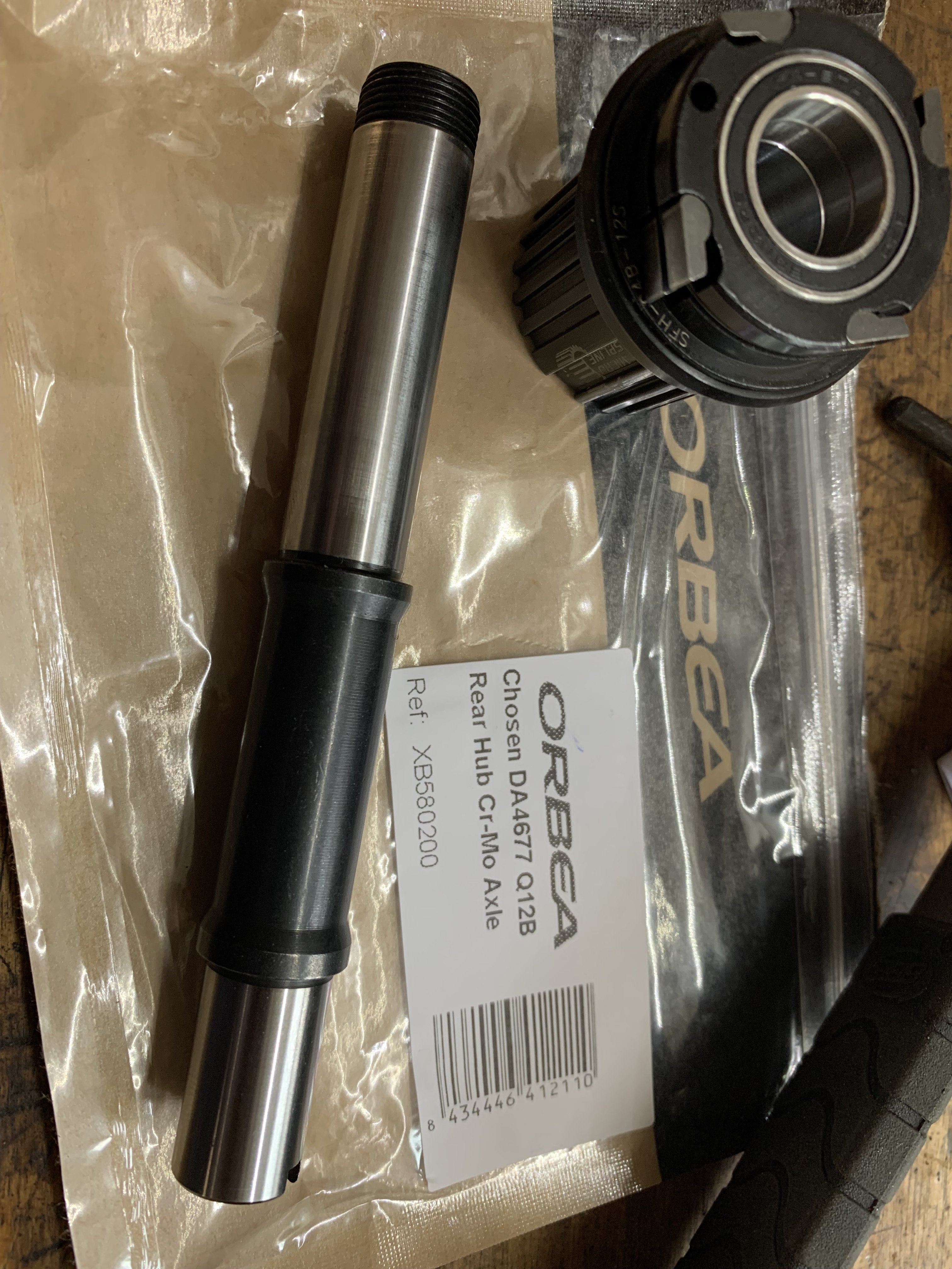

I wouldn't trust that soft Aluminium axle, it's fitted again, but I had to file it and it didn't just fit easily on the non drive side, frankly had to force it on due to deforming - I wouldn't trust it on the bike for any longevity!!
The steel Orbea alternative is about 50 quid I think, if you can find it!!
You don’t want that alloy shaft, it should be chromoly steel as the replacement free hub is. There’s numerous people have had the shaft snap or wear through
Here’s the steel shaft part number (edit, again, posted so many times I’ve forgotten where😄) they supplied under warranty next to the warranty replacement free hub. As you can see the material is black, steel. V the whiter alloy of original we get originally
