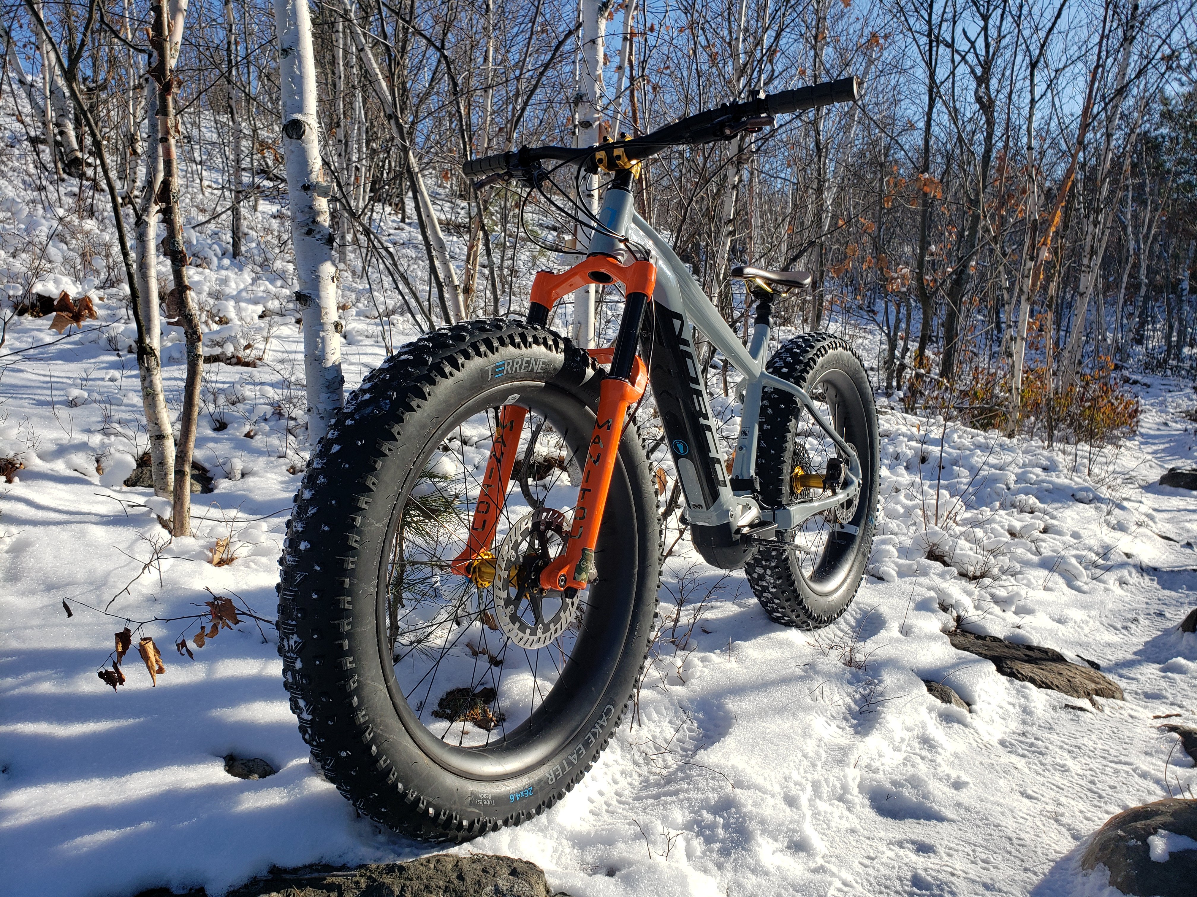

I can understand a cheaper hub grenading but I'm over here waiting for an i9 warranty claim. My hub spun the ratchet ring inside the hub shell, still sounded fine peadlling backwards but would also freewheel going forwards lol. This was on a Norco bigfoot vlt fat bike and the failure happened on the 4th or 5th ride after putting the new wheelset on. .
The skinny version of the same i9 hub is still doing its job on my Bullit after 12xxkm so go figure..

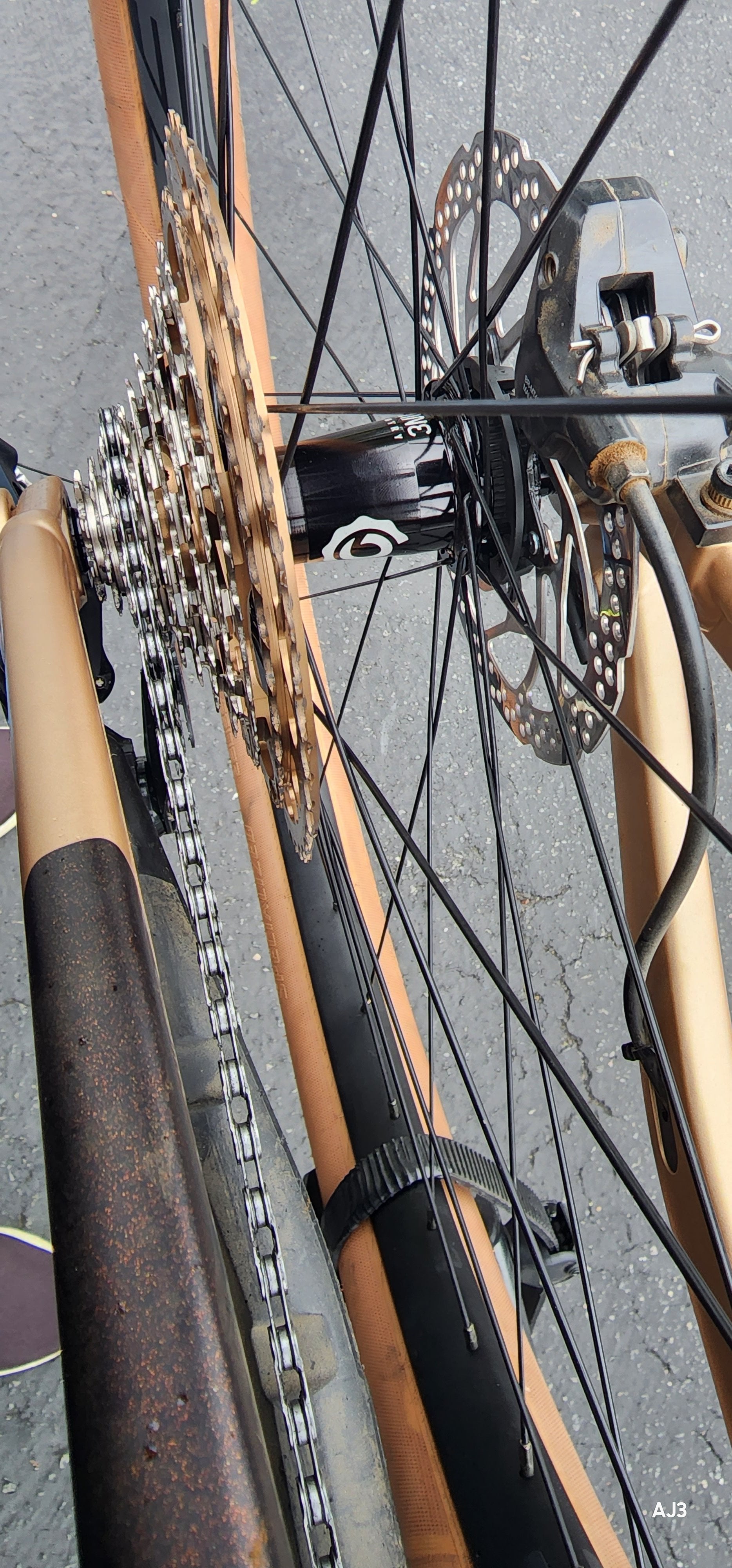

Have an H30 with the Shimano labeled hub...wanted an e-13 cassette which required an XD driver so had an i9 hydra laces to the wheels... we'll see how it goes
