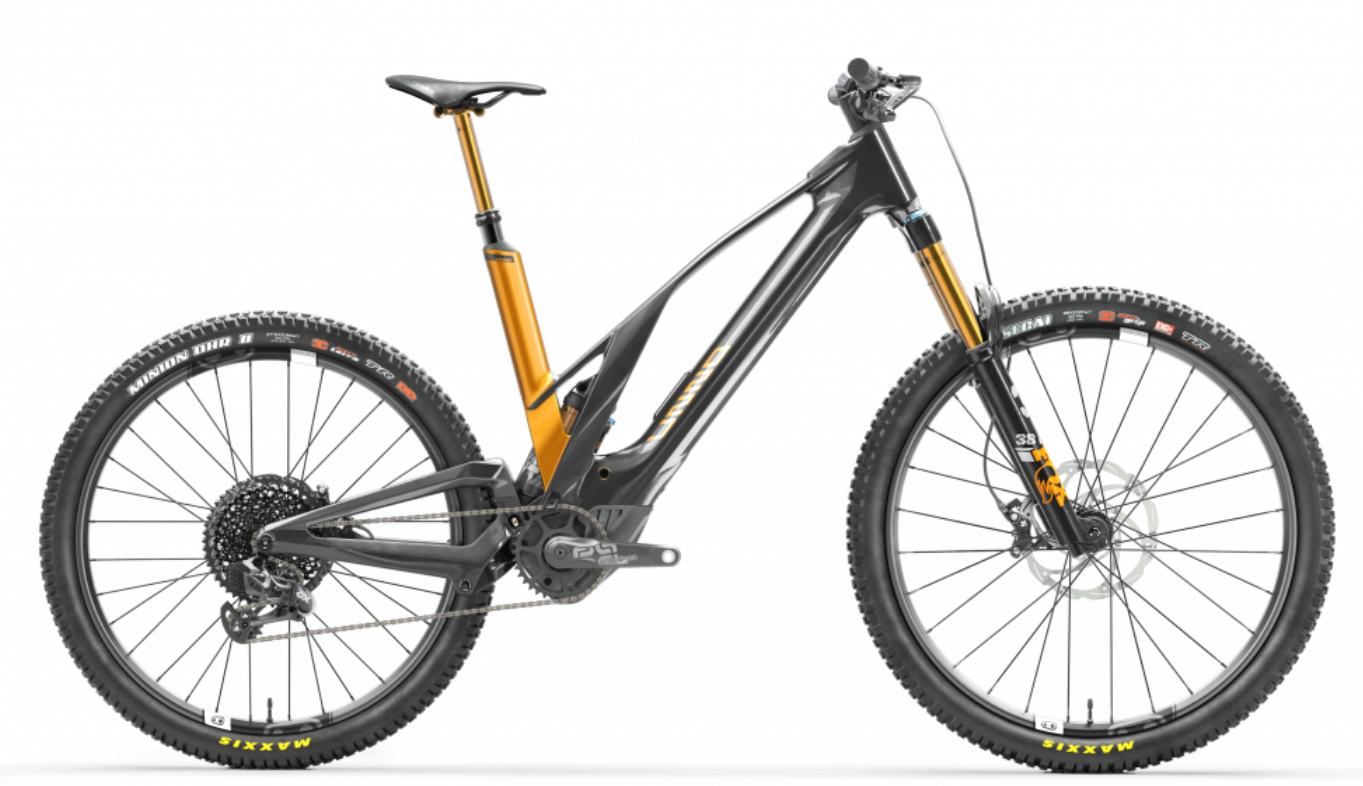

Something like an Unno Mith has quite a steeply angled top tube and might give better standover ?

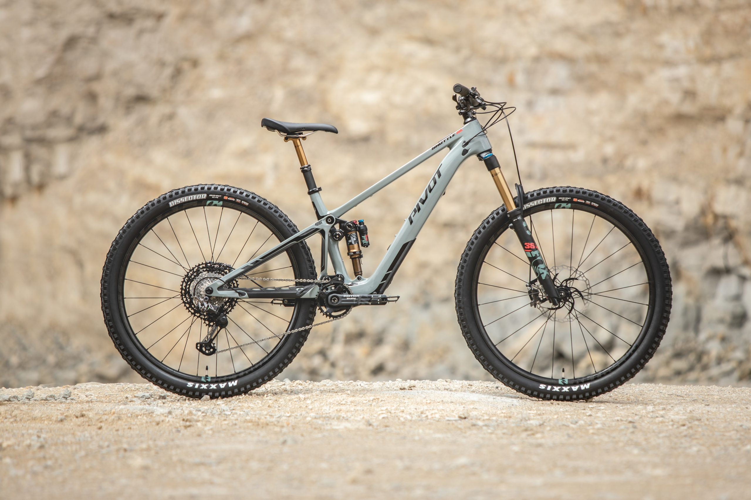

A pivot shuttle SL has quite a low top tube also.
