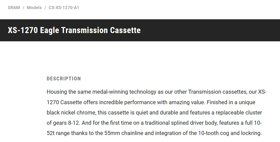

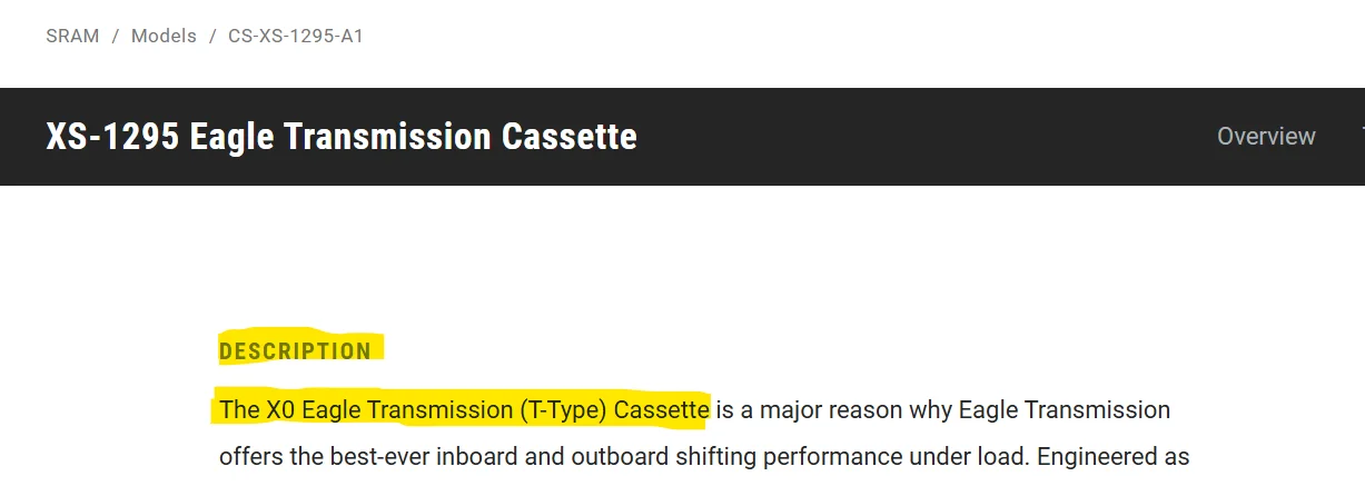

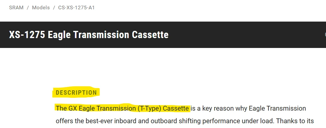

There is no SRAM XO cassette!. If you have a full XO groupset the cassette is a XS 1295 which fits on a XD freehub.....same way as every other SRAM XD compatable cassette. No threadlocker should be used.
Maybe you need to identify exactly what cassette you have by reading the description or reference number on the back face of the cassette.
