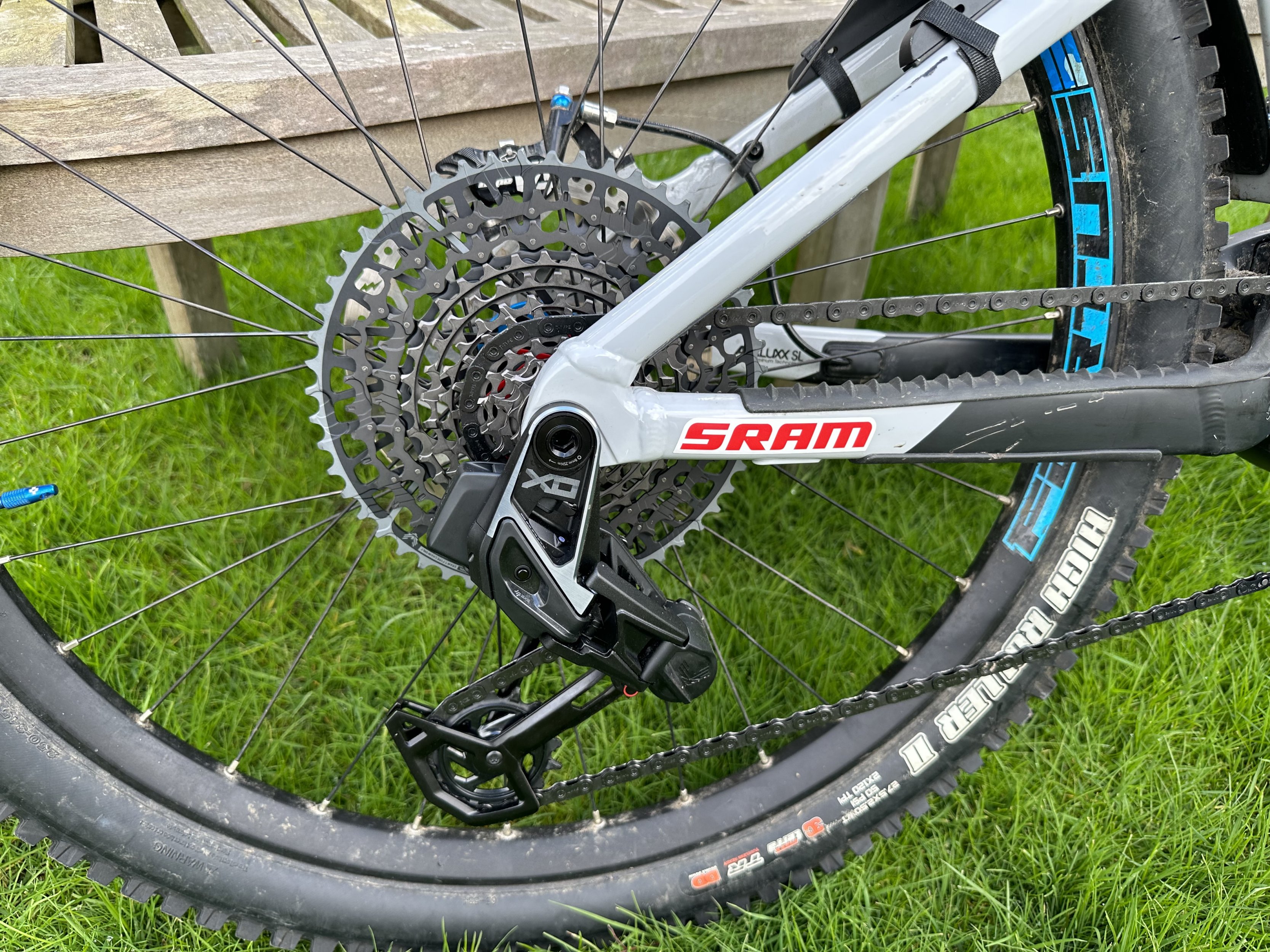

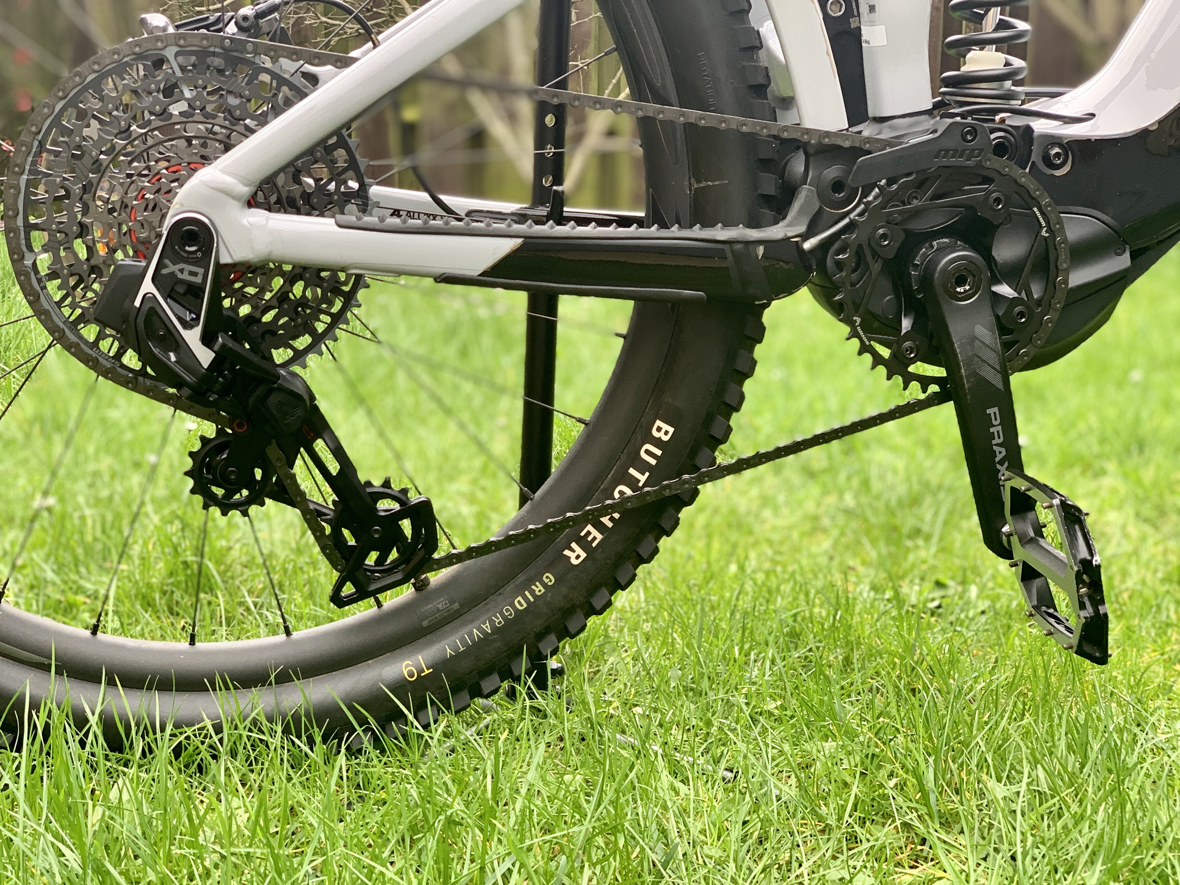

That is one hell of a great step by step guide!

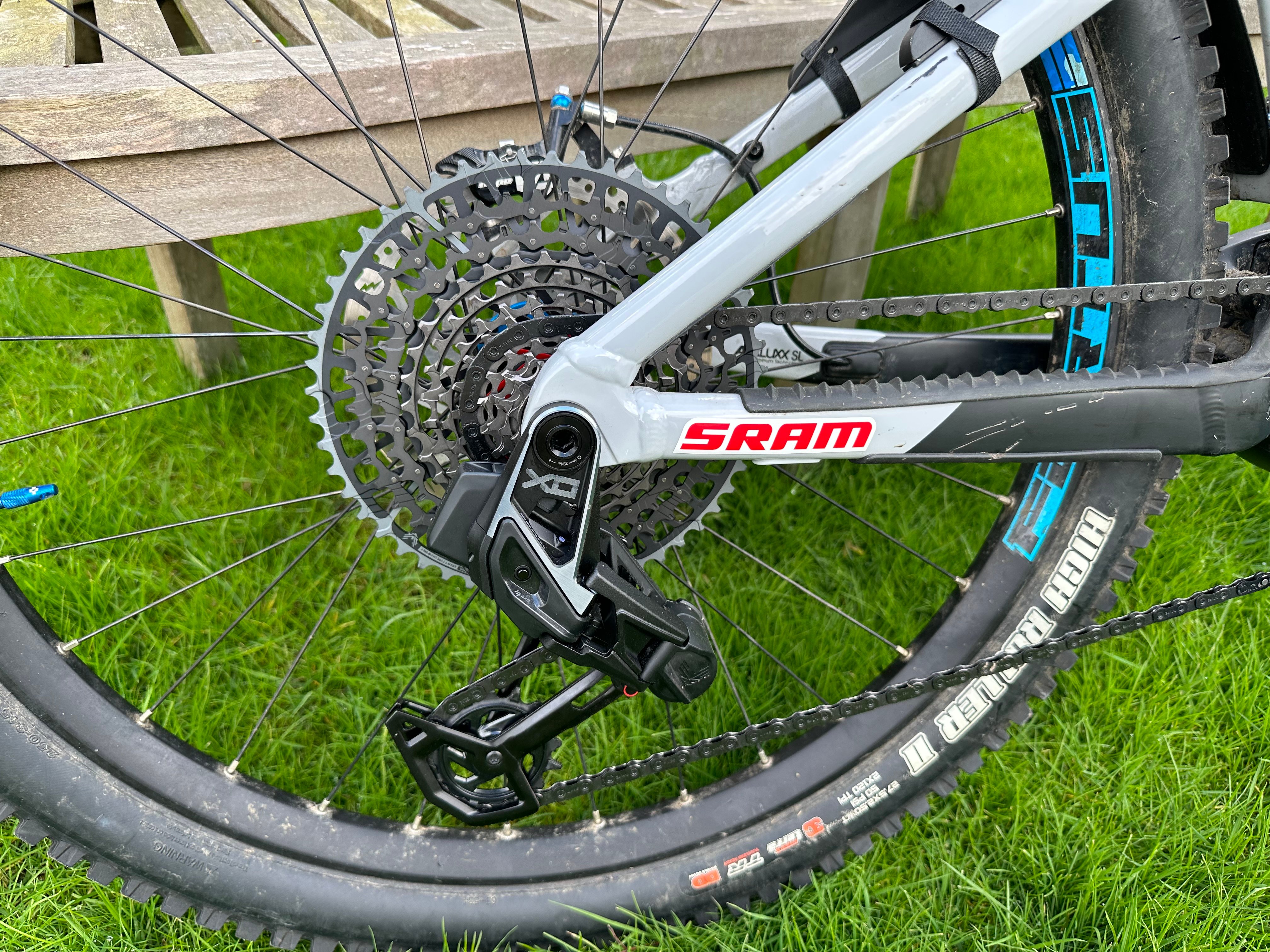

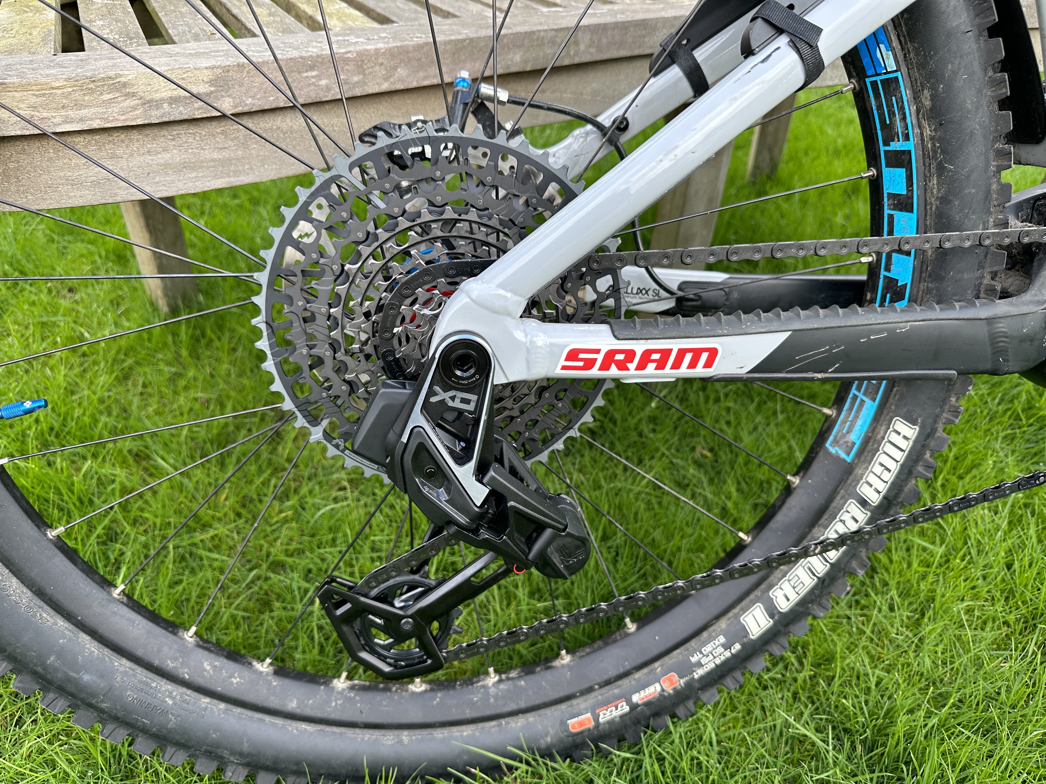

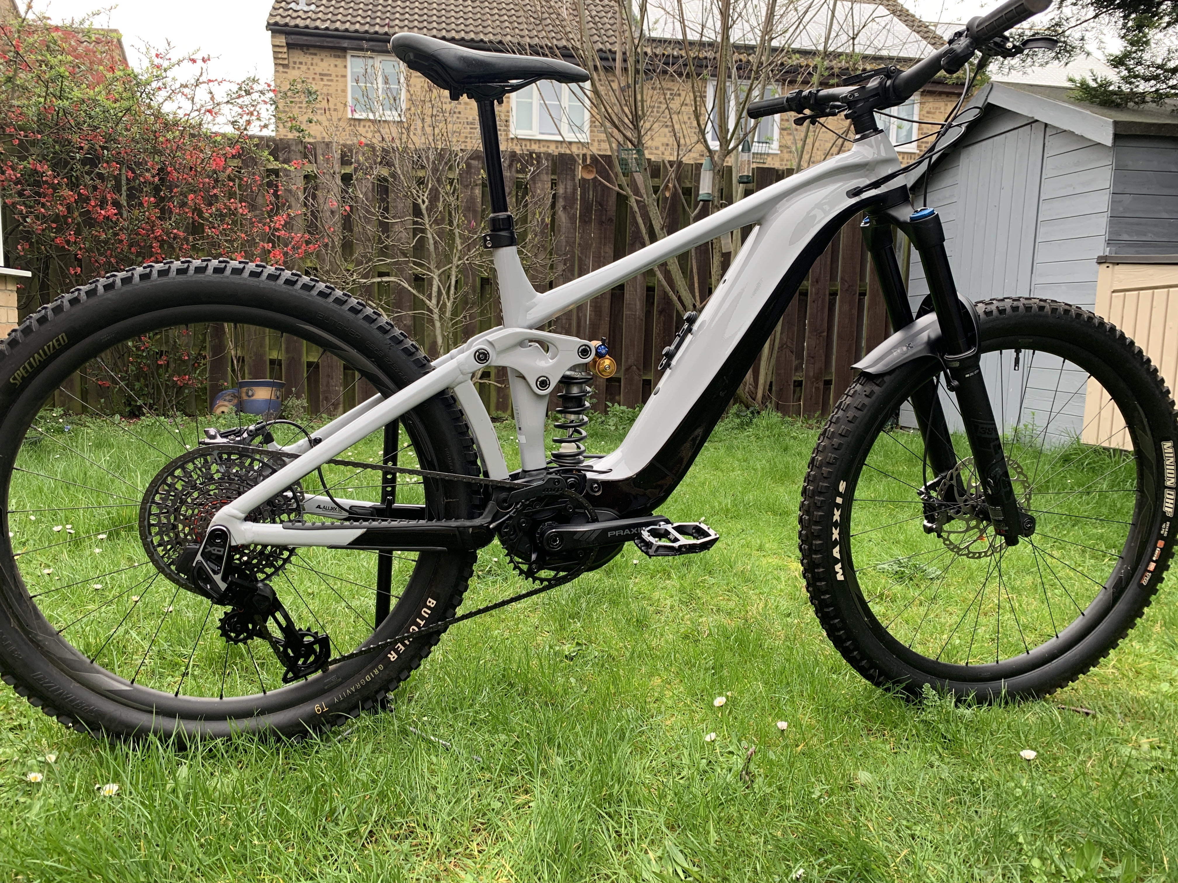

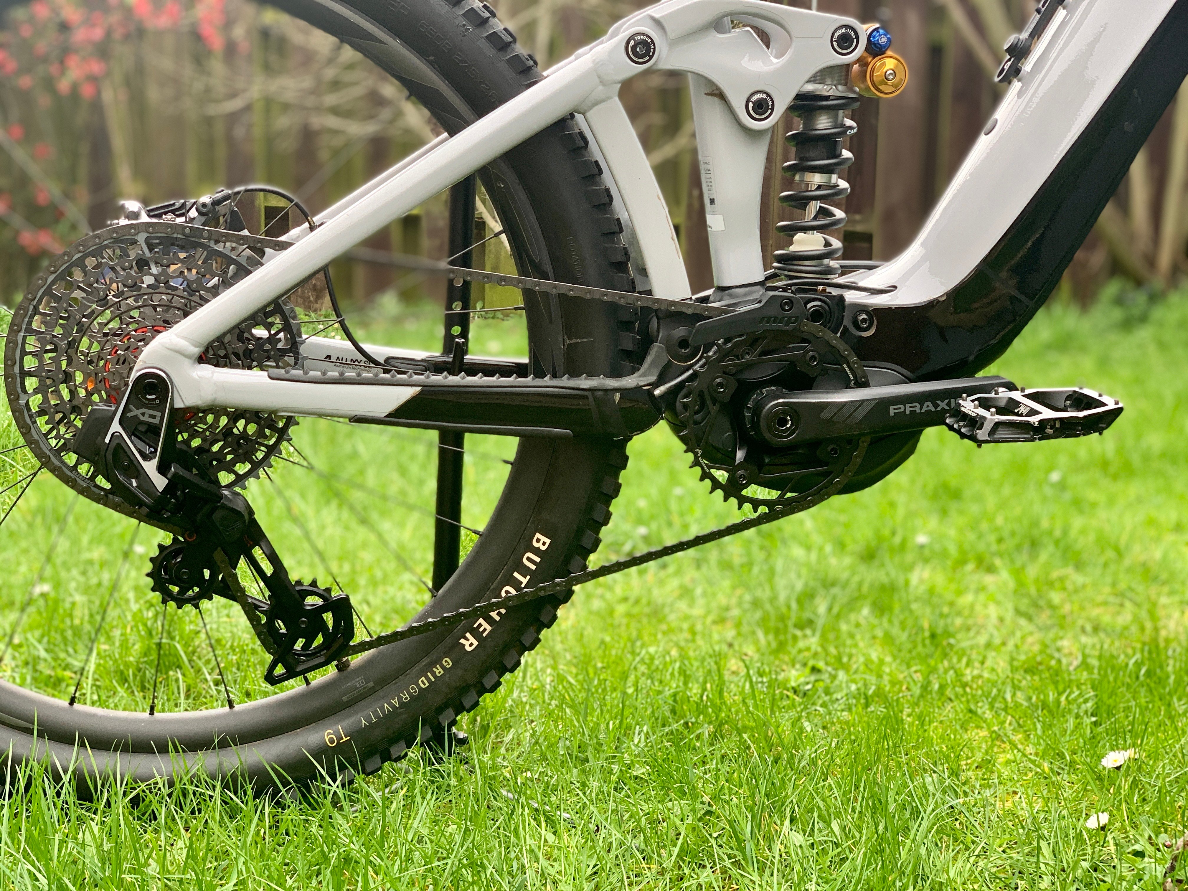

Would you mind posting pictures of your Reign E+ with the new Transmission ?
LJR69
Jan 4, 2022
79
98
Sure. Here you go

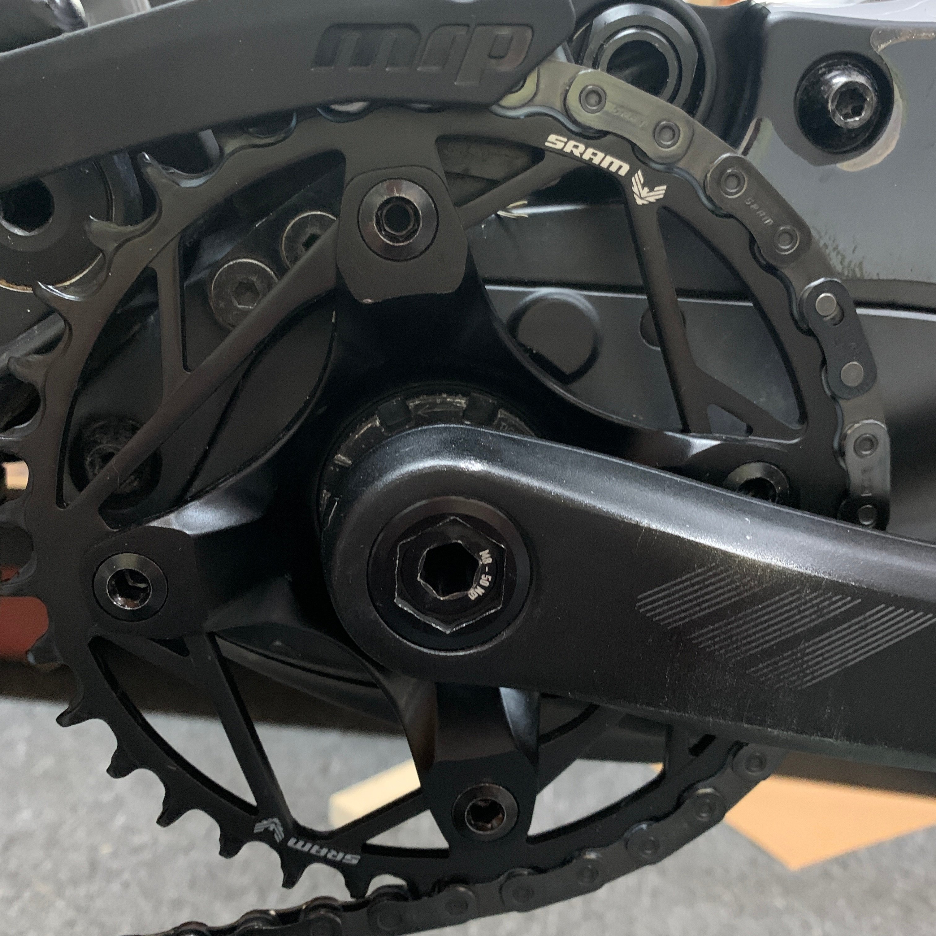

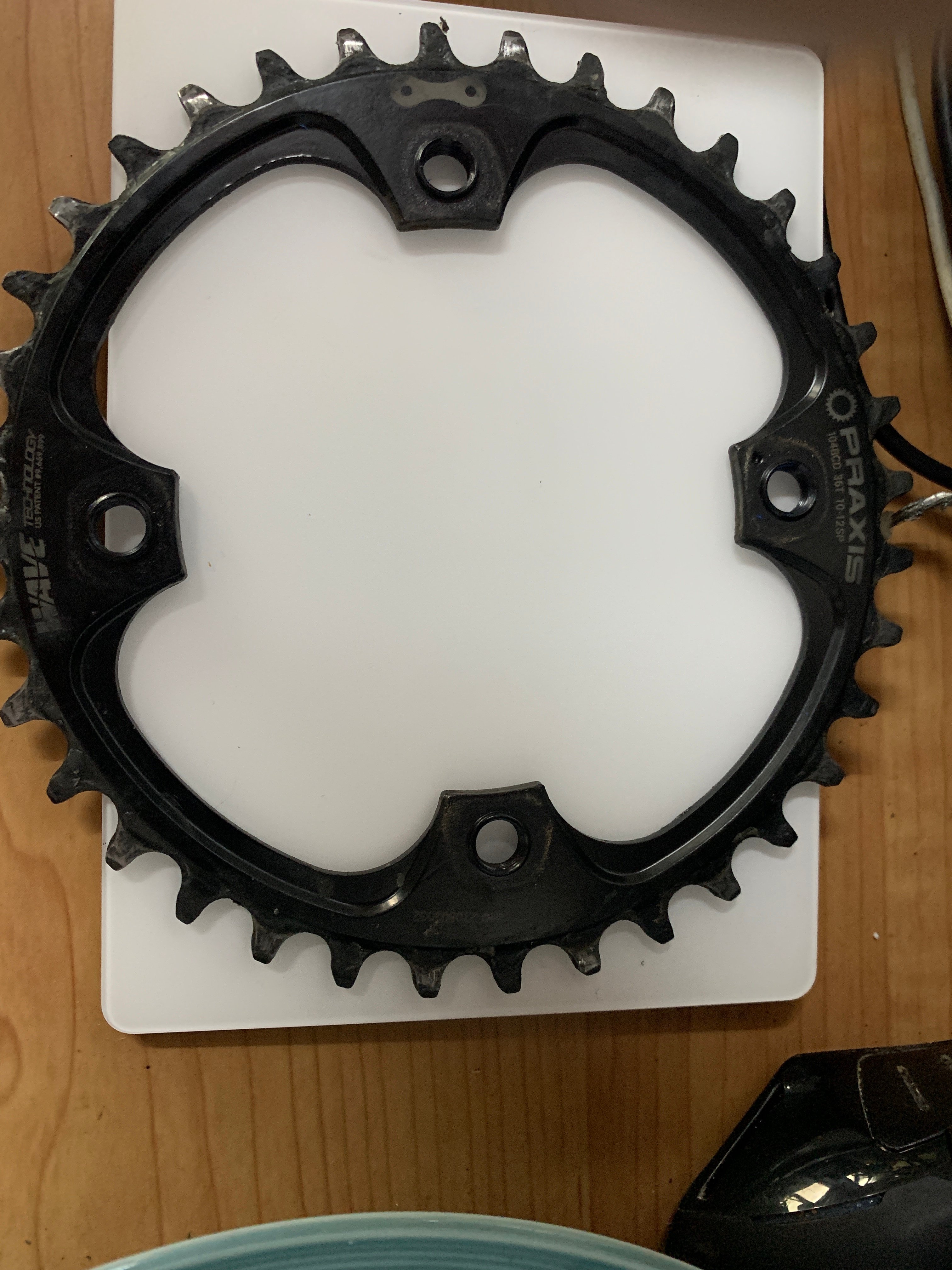

lol I thought the same, and while you can remove the Praxis chainring without removing the chainring nut, you cannot replace it with the SRAM AXS chainring. The reason is that there is more material toward that centre of the SRAM ring and as such there's not enough room to loop the ring around the back of the spider (like you can with the original Praixs chainring). I tried everything to get it to loop round the back, it was close, but just couldn't make it fit. In the end I removed the spider and sorted it that way.
Here's an image to show what I mean (first image Praxis, second is the SRAM)
View attachment 110699 View attachment 110700

You can get the crank arms that are used on the Bosch. They are ISIS compatible and I spoke to SRAM directly about that. However, the cranks for the e-bike version are not that special looking and so I just stuck with the Praxis (for now) and saved about £160 (UK) as a result.
Great step to step guide. Unfortunately I fount it too late and I had already mounted AXS XO on my Reign E+0. I don't know if the center nut (the center spider) is the same in the E+0 but I was able to install the SRAM X0 chainring without removing the center nut. It was not easy, I have to say, but after a few tries It went into position.
