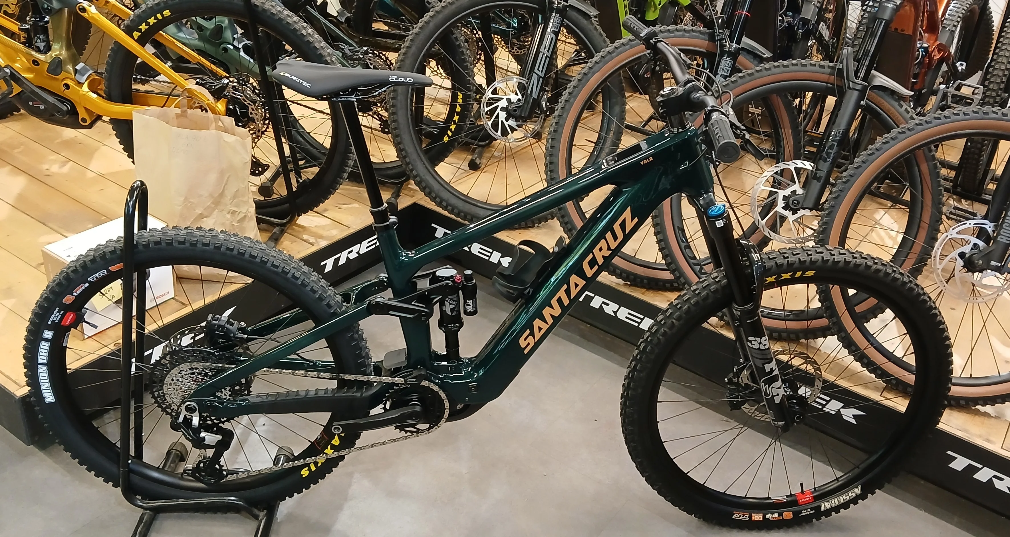

I agree completely. I wasn't aware that I was putting them on a pedestal. What I was praising was the response by e13, which has been very supportive and very quick, both to me and to the Sherwood Pines Cycles, the Santa Cruz dealer involved, which is fair.
The reason that I was able to get straight through the the global head of support for e13 so quickly was that he contacted me earlier this year and I had his email address. There was a thread earlier this year, something like "what hub would you recommend?". I responded that whatever you choose don't make it an e13 one and gave details of why. Basically four hub failures all under warranty. Oh and a e13 chain device on a 2x that caused more chain hang ups than anything else. Once removed, the front rings and chain worked perfectly. I didn't do warrnaty claim, I just removed it and sold it on eBay. In addition, I am aware of the various problems that other e13 products have had, all of which fed my "anything but e13" mindset.
Anyway, the USA e13 guy contacted me and asked for more details. I provided them chapter and verse, etc. All of this was reported on here. Since that first problem, I have never bought any e13 product. What I have had has always come as standard with a new bike. So, the first e13 hub since the last one and what happened! In some frustration and a lot of irritation, but politely of course, I emailed the guy at e13 in the USofA. You have read the rest.
I remain to be convinced about the cause of the problem. It could be the hub, but the odds are against it. It seems more logical that the cassette is in the clear. Cassette fitting of course could also be a culprit. E13 are adamant that they are in the clear and that my case is not the first (the ninth in fact, although I don't know over what timescale that is measured). They have not shared any reasons as to why they are convinced, just work that they have done.
They continue to be supportive. I don't know if they had any influence on the decision by Sherwood Pines Cycles to lend me a rear wheel for as long as I need it. But their UK guy they told me that they are committed to getting me back on the trail asap.

Maybe the cassette and chain just no longer looked new! The chain was also replaced, along with new saddle and grips and a new rear tyre. As I said the bike was immaculate and it came with a full two-year warranty plus the usual Santa Cruz lifetime warrnty on frame bearings and rims. I will not be returning the bike as no longer fit for purpose. I was aware of what I was buying and I thought it was a bargain.

I had a couple of emails from the head of support in the UK, the guy that spoke to the mechanic and others at Sherwood Pines Cycles.
First one dated 24th Jun'26
Hi Steve,
Joe here from e*thirteen UK.
Firstly, I'm sorry to hear you've experienced this issue, especially so soon after purchasing the bike.
I've spoken directly with Darren at Sherwood Pines and discussed the situation in more detail following Chris's assessment. From the information available, the issue appears to have originated from the cassette assembly loosening and subsequently causing damage to the driver assembly.
Whilst the root cause does not appear to be with the hub itself, we're more than willing to help where we can and support Sherwood Pines in getting you back up and running as quickly as possible.
At this stage, Sherwood Pines will be carrying out the inspection and repair work, so they will be the best source of updates regarding progress. I'll continue to support them from our side and assist with any parts requirements as needed.
If you have any questions in the meantime, please don't hesitate to get in touch.
Kind regards,
(Darren is the mechanic that dealt with my issue in the first place.)
Second one, same date, 4 hours later
Hey Steve,
............ Like Sherwood Pines we value riders, and we want you get back on the trails asap.
One Thing I did mention to Darren, ........... We would be happy to explore upgrading you on to a Sidekick Hub . We would offer you a 50% discount as a good will gesture to make this easier, and it's a perfect opportunity to make the upgrade while the wheel is in the workshop.
I'm not sure what Sram will offer, In the early days of this fault occurring we were taking full responsibility as we couldn’t identify what was causing the fault. This included paying for the labour of wheel rebuild and also paying for the new cassette on top of supplying a new hub free of charge. I'm not certain on what stance Sram will take but from the 8 case's we have had we have not had a repeat of the fault once a new cassette was fitted......
I'm glad you will be able to ride relatively soon.
Keep in touch.
My case is number nine. And for the record, I politely rejected the offer of 50% off a Sidekick hub.

So e13 have had 8 failures. None failed again when a new cassette was fitted....well you had a new cassette and it failed. They are being super attentive but is that all about protecting their brand? Then they offered you a discount on a better hub!! So what is less good about the one you have?
I dont know the Santa Cruz range of bkkes but it looks like the Vala is fitted with SRAM XS 1270 cassette. So T Type compatable with a splined freehub. Installation and servicing is therefore different to non T Type and TType fitted to a XD freehub ( 1275 cassettes).
Allowing grease or dirt on the area of the freehub that has factory applied locktite ...or even worse actually putting grease there......is likely to lead to the locknut loosening. I suspect that could be the issue here. SRAM recommend re- applying loctite there if tbe cassette has been removed more than 5 times.
I have both variations , XS 1275 on my Whyte E160 and XS 1270 on my Whyte Elyte EVO.
