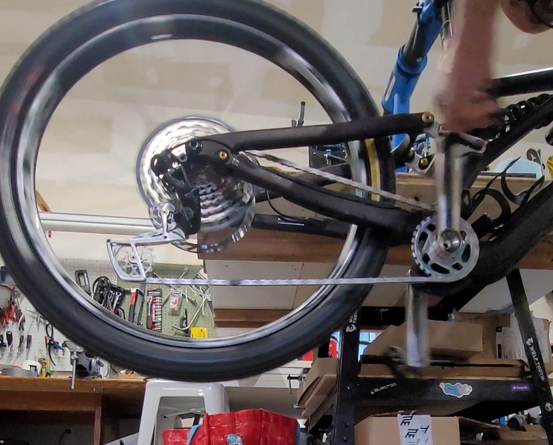

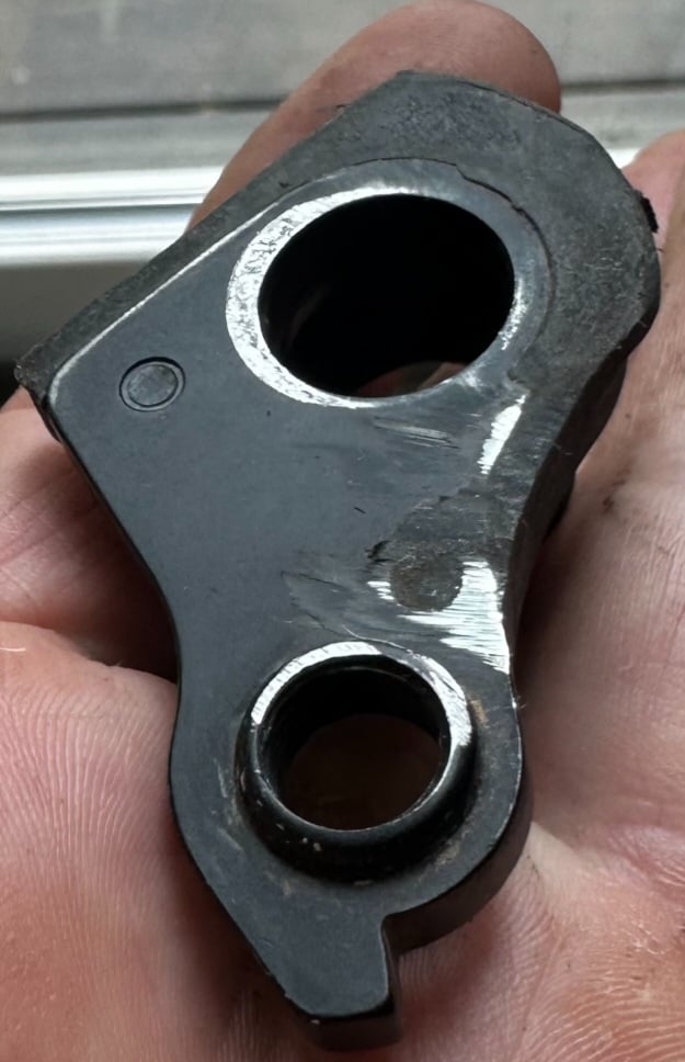

T-type cassette and chain works great with regular xx1 derailleur and shifter paired with a nsb t-type chainring.
Griding the lip inside of the hanger is required to have enough space for the cassette.
