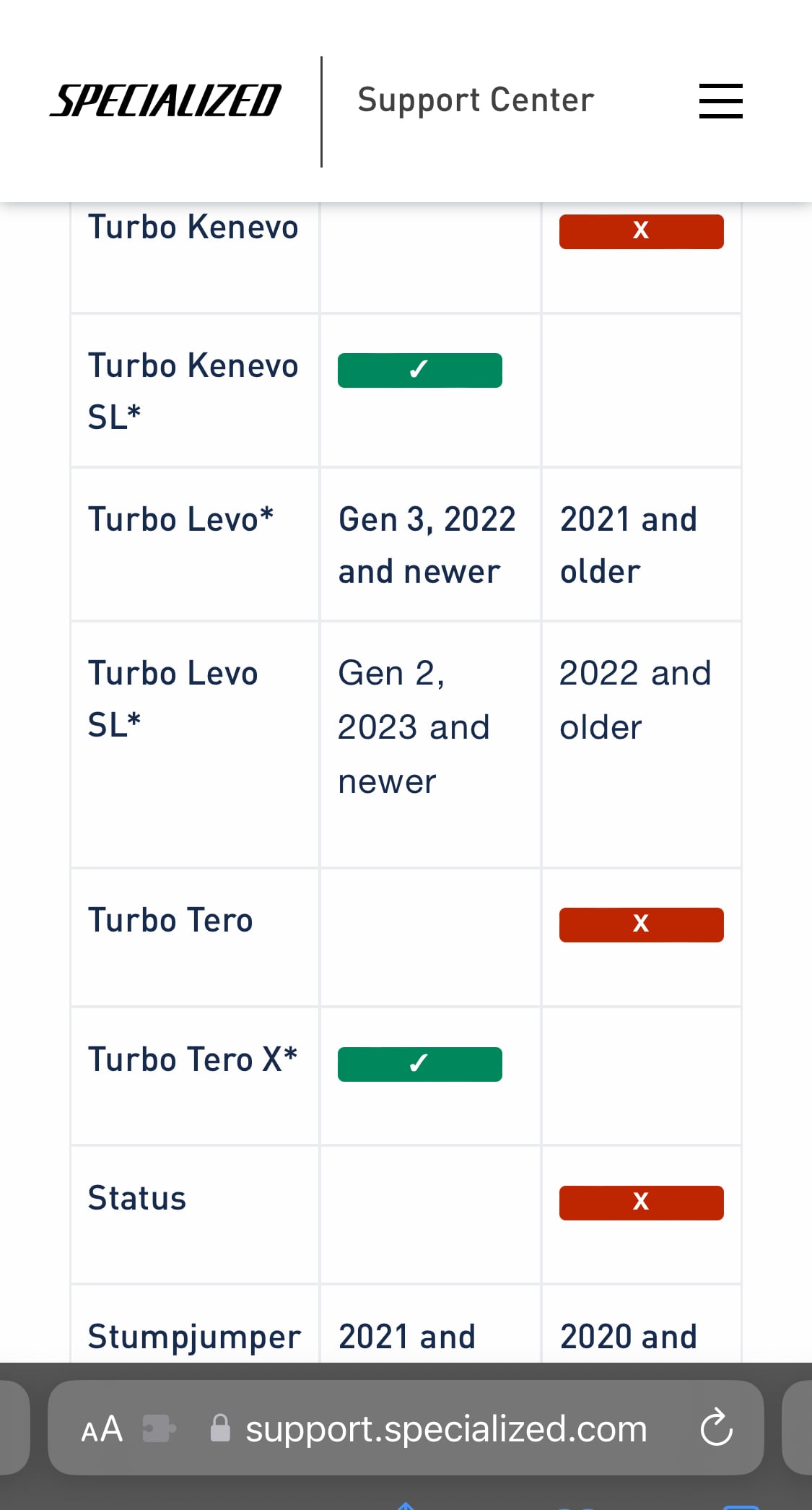

I am reading this on the Specialized official website:
"All Levo SL Gen 2 frames feature the SRAM UDH and are compatible with SRAM Eagle Transmission. For 2023, SRAM Eagle Transmission will be included on S-Works and Pro models."
So they are compatible with Gen 2 Levos? Is that right?
The Gen 2 Levo SL is compatible, but Gen 2 Levo isn’t, as far as I can work out from Specialized?

Yep, I suppose I was just pointing out that Gen 2 Levo SLs are compatible, ie come with UDH, but ‘full fat’ Gen 2 Levos won’t be, as the frames don’t have UDH.

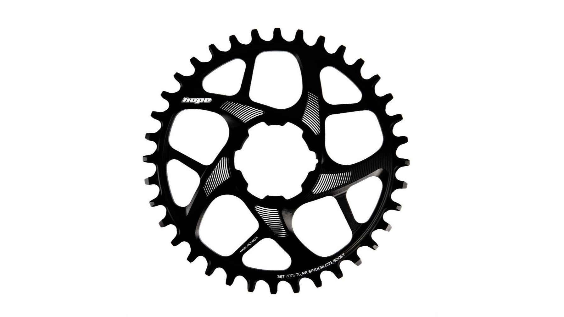

I'm thinking of buying the t type transmission for my 2023 gen3 levo pro, as my original transmission is worn.
I'm totally confused though as to whether it fits directly on or if you have to mess about modifying it to fit properly. I don't want to have to fit the full kit with the cranks if i can avoid it, as I have praxis carbon ones already on along with a hope 36t chainring.
Are you able to just get the xx kit without the cranks and will it work with the hope chainring or do I have to get the full kit? Also is it necessary to have to get the T type flat chain and cassette or is it compatible with the standard cassettes?

Says Hope have a new chainring that is compatible, I don't know if the one you have would be compatible

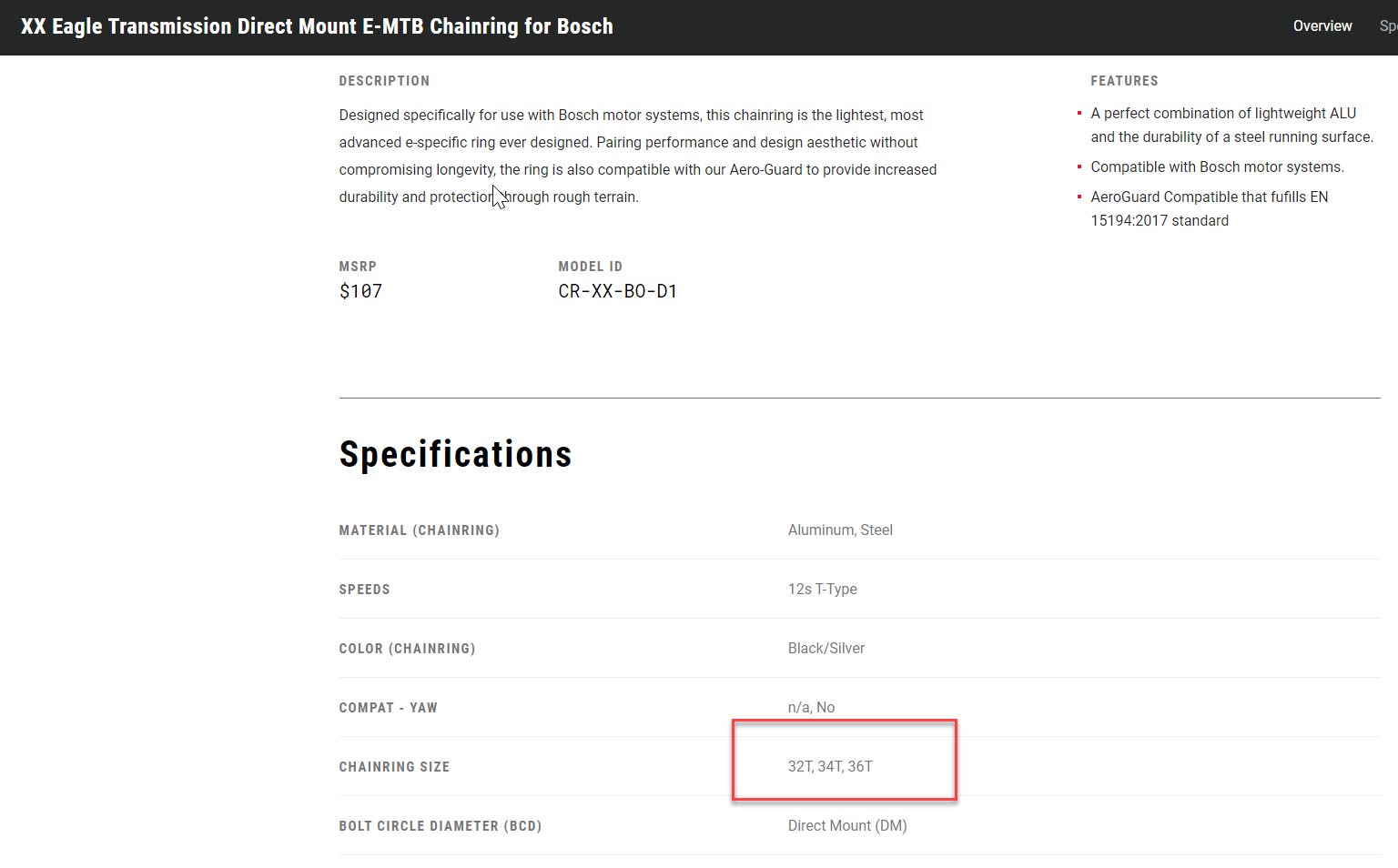

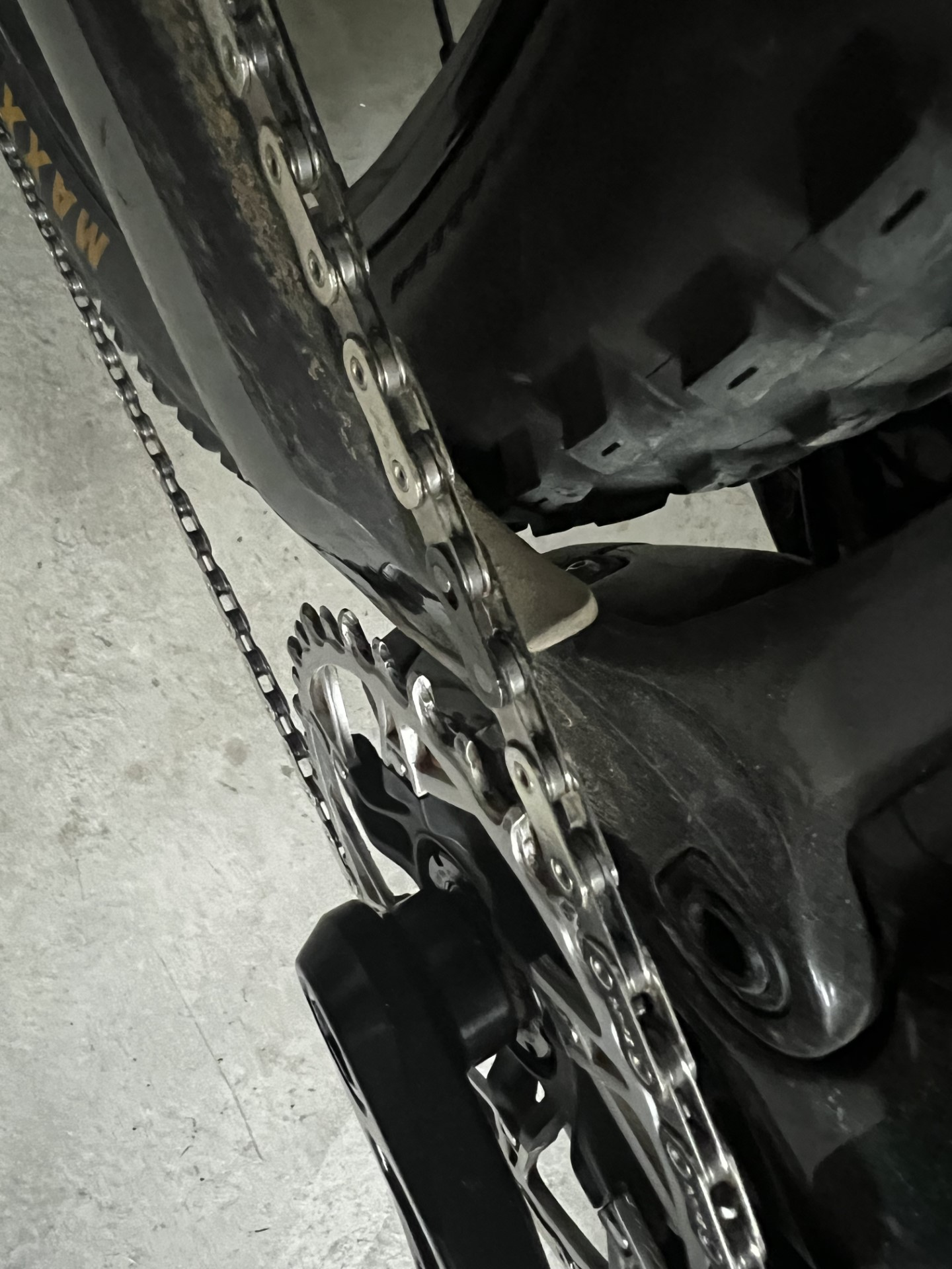

I’d also like to know what other Bosch compatible chain rings there are?
34T because the 36T is terrifyingly close to the chainstays.
This info is readily available on the SRAM website. Also, the 36 tooth fits with great clearance on the rail due the 55mm chain line.
36tooth on Rail

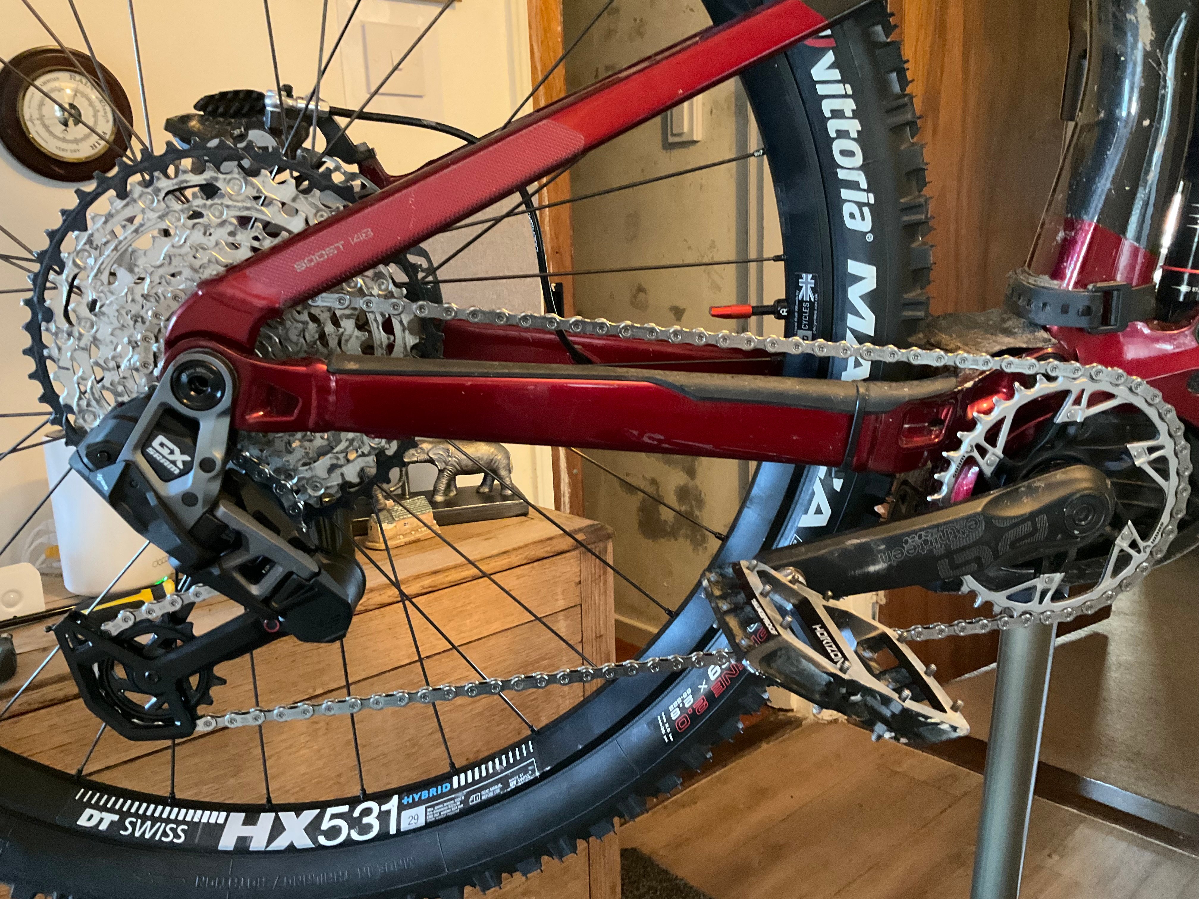

For anyone that’s interested, I finally got round to testing the GX T-Type mech with a Shimano 10/51 cassette and a Shimano 12 speed chain and T-Type Bosch 36 toothed chainring on a 2021 Trek Rail.
By following the exact same setup as the full T-Type system on the AXS app I can confirm that it does work, the only change I had to make was adjust the microshift down to down, after that all gears changed well, the only gripe I have is that the Shimano chain is quite noisy on the SRAM chainring so I "wouldn’t" recommend running it with the SRAM chainring and Shimano chain (edited to keep everyone happy)

Why go through the expense of installing the XX chain ring only to run a Shimano chain? Of course it’s going to be noisy as it does not fit together correctly despite the illusion it is working fine. If you are hell bent on keeping the chain put the Burgtec on asap and save the wear and tear on both ring and chain.
By following the exact same setup as the full T-Type system on the AXS app I can confirm that it does work, the only change I had to make was adjust the microshift down to down, after that all gears changed well, the only gripe I have is that the Shimano chain is quite noisy on the SRAM chainring however that may change after bedding in, if not my Burgtec chainring work fine with Shimano chains…. If I get round to it later (and another set of hands)I’ll take a video of it shifting through the gears.
100% agree, this is a bad idea and only likely to cause you trouble in the future, just do it properly.
Also you are missing the best part of being able to shift under full power

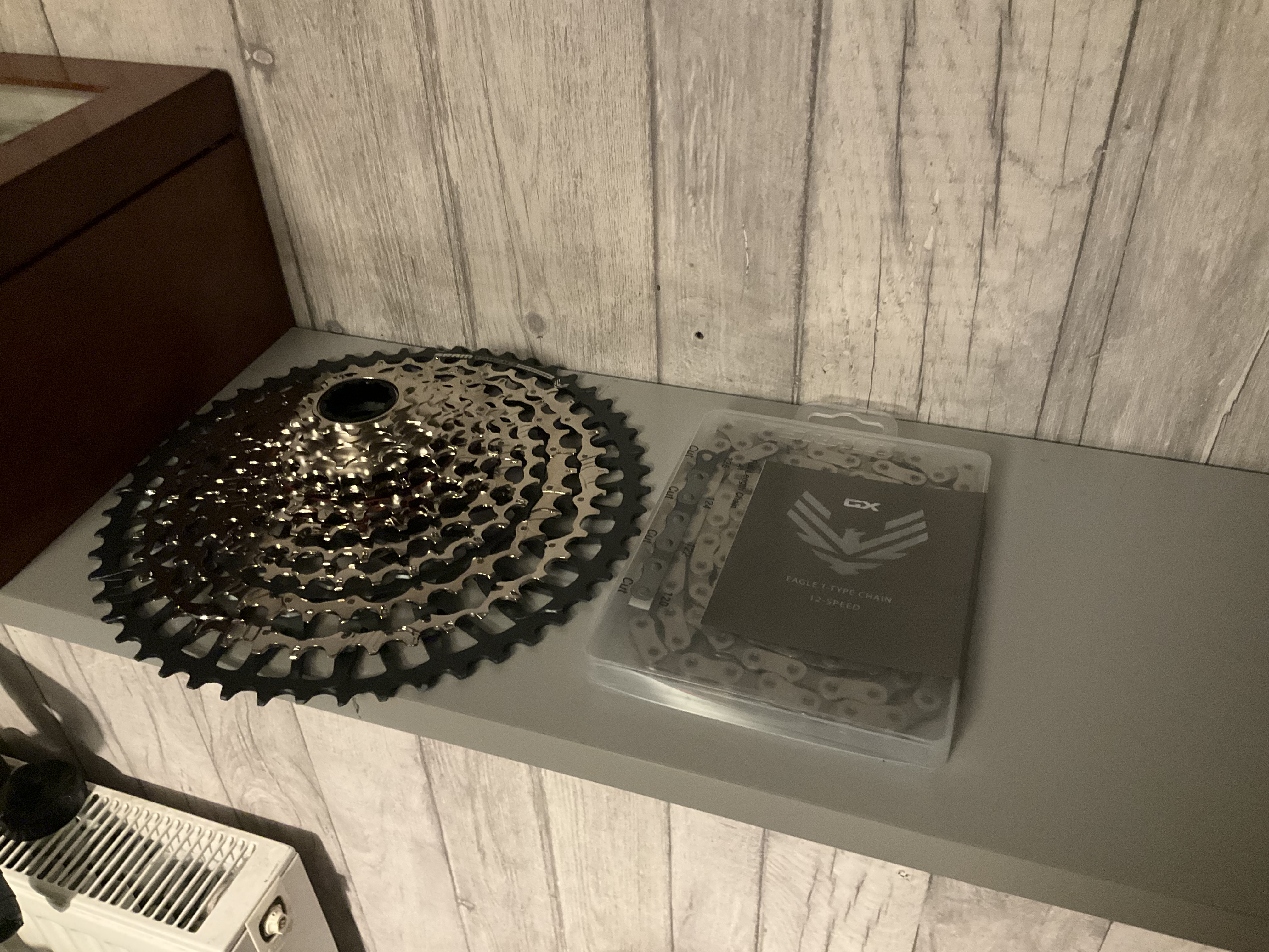

It’s ok guys yous don’t need to worry as the correct parts are going on as soon as my XD driver freehub turns up this morning, besides I’m pretty sure the name of this thread is to see what’s compatible or not? I simply had the parts and the time to see what works and what doesn’t! I now know that the cassette and chain works fine with the mech but I wouldn’t bother with the SRAM chainring
