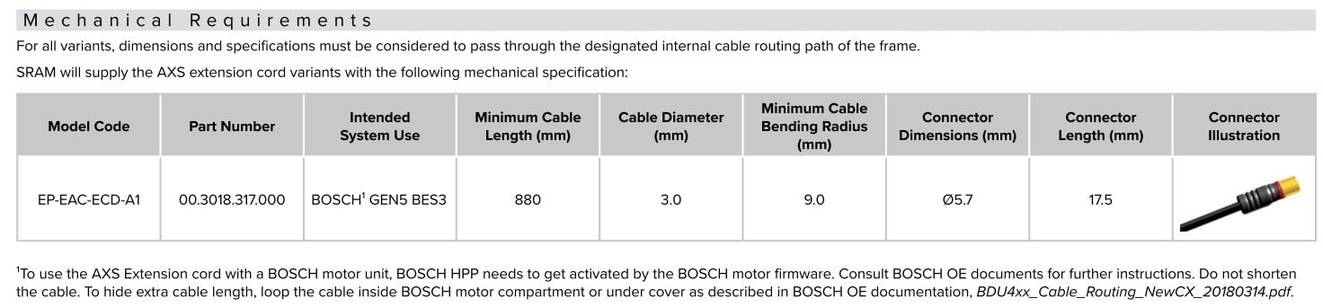

I like the system (except controller paddle), but would like to upgrade it – replace the derailleurs battery with power supply from main ebike battery. SRAM has such option - the upper version of Scott Patron has these feature as a standard setup. The problem is that cannot find the part numbers of SRAM wire interface. The only what I have found
My Scott representative said that battery interface is a SRAM part (not Scott’s) and provided me the part number ( 00.3018.317.000.) but I cannot find it in the net, so either the part number is wrong or the system is so new.
Does anybody knows part number of the interface?

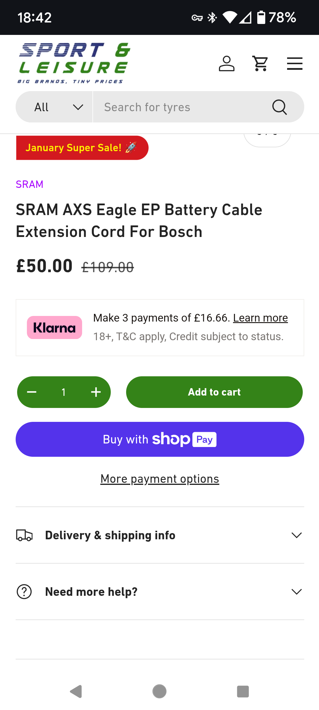

At this price it's tempting but does it need switching on by a Bosch dealer?
Anybody want the cable doesn't fit my crestline £50 posted ?? Never been opened
I checked the voltage on my AXS battery fully charged was 8.4v so it looks like it's a 2s battery. I have been trying to source the correct cable for months now from Trek and SRAM for my Ex-e but I keep getting the run around and nobody can tell me what the part number is. After seeing the cost of that extender linked in this thread I took matters into my own hands and made my own.... So far I have tested it with a bench power supply at 8v and it works great! I ordered a regulator to step down the 13v coming from the TQ smart box to 8v and will wire it in and go for a ride later this week. So far it looks promising. I have my garmin wired in to charge off the bike too from the pogo pins on the back of the device.
