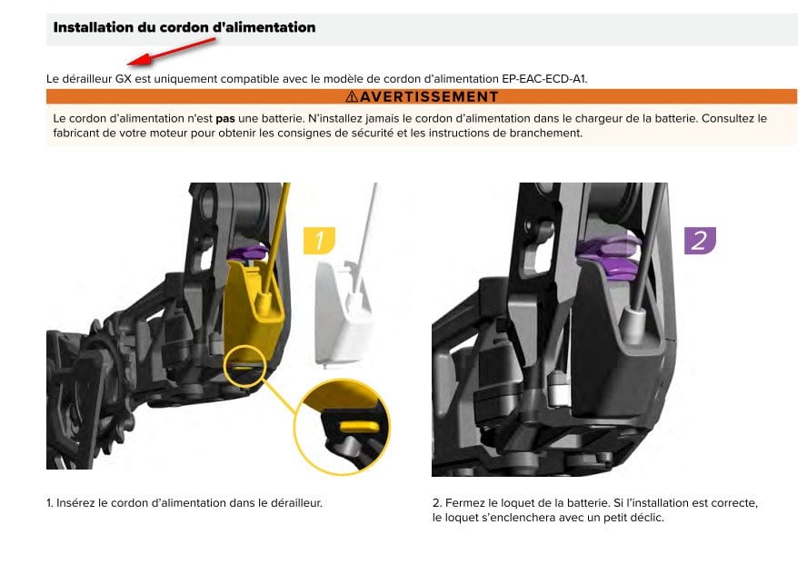

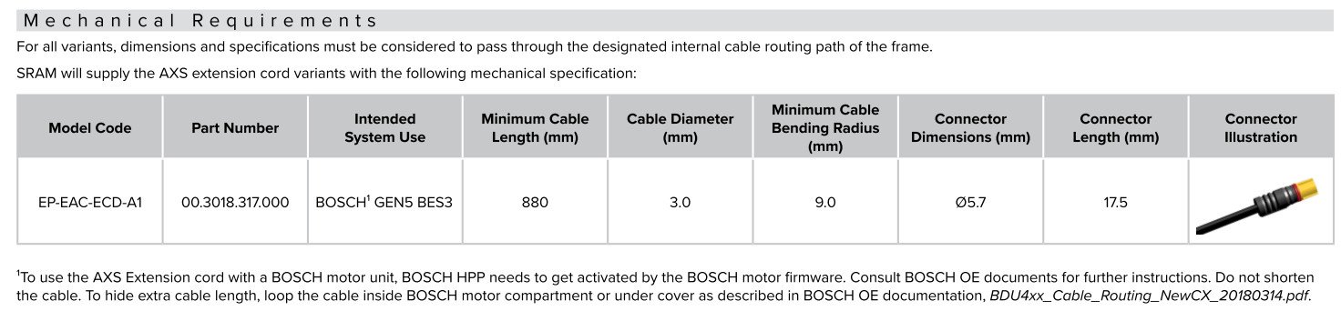

This may (or may not) help, I asked SRAM about the cord that's listed in the AXS manual.
Keen eye! I believe you are seeing the OE-only AXS extension cord for Bosch motors, which allows your derailleur to be powered off of the e-bike battery. Unfortunately, this is not available for aftermarket purchase as it is a feature that has to be hardlined into the bike from the factory. As such, the only way to get this would be to purchase a bike that comes stock featuring this part.
It's a shame they don't sell them to end users, they're missing a trick!

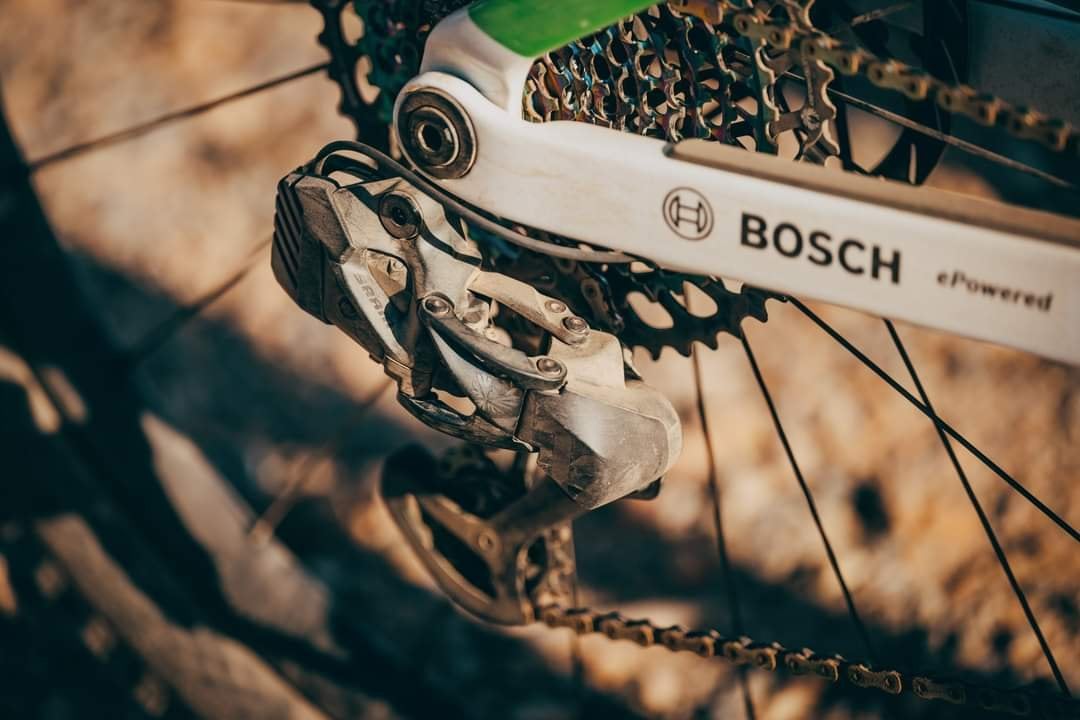

It is on the Trek Rail 9
Rail9GXAXS_23_36992_A_Alt9
In the picture you posted of the new AXS GX mounted on the Trek Rail 9…what is the cable housing for? It seems to exit the chain stay and enters the AXS GX derailer. I wonder what the purpose of that is?
Edit: Ah, never mind. Auxiliary power to the GX. (I should have read previous posts).
Looks like the power cord for AXS is pictured in the exploded view in the post below.

My Rail came with this, but I've replaced the AXS non-T-Type with GX T-Type which tucks the battery away differently to the XX/XO derailleurs. Unfortunately, the wired dummy battery can't be used. I'm hoping there's another version in the works that will suit GX.
Update: SRAM have said they don’t have any plans to introduce a GX T-Type compatible wired battery.
Mise à jour : SRAM a déclaré qu'il n'envisageait pas d'introduire une batterie filaire compatible GX T-Type.
Bizarre, dans le manuel utilisateur AXS 2023 en page 11, il y a ce message :
Et dans le second manuel "eagle-transmission-frame-fit-specifications", en page 14, il y a la référence pour moteur Bosch Gen4 Smart System. Mais je ne le trouve pas !
