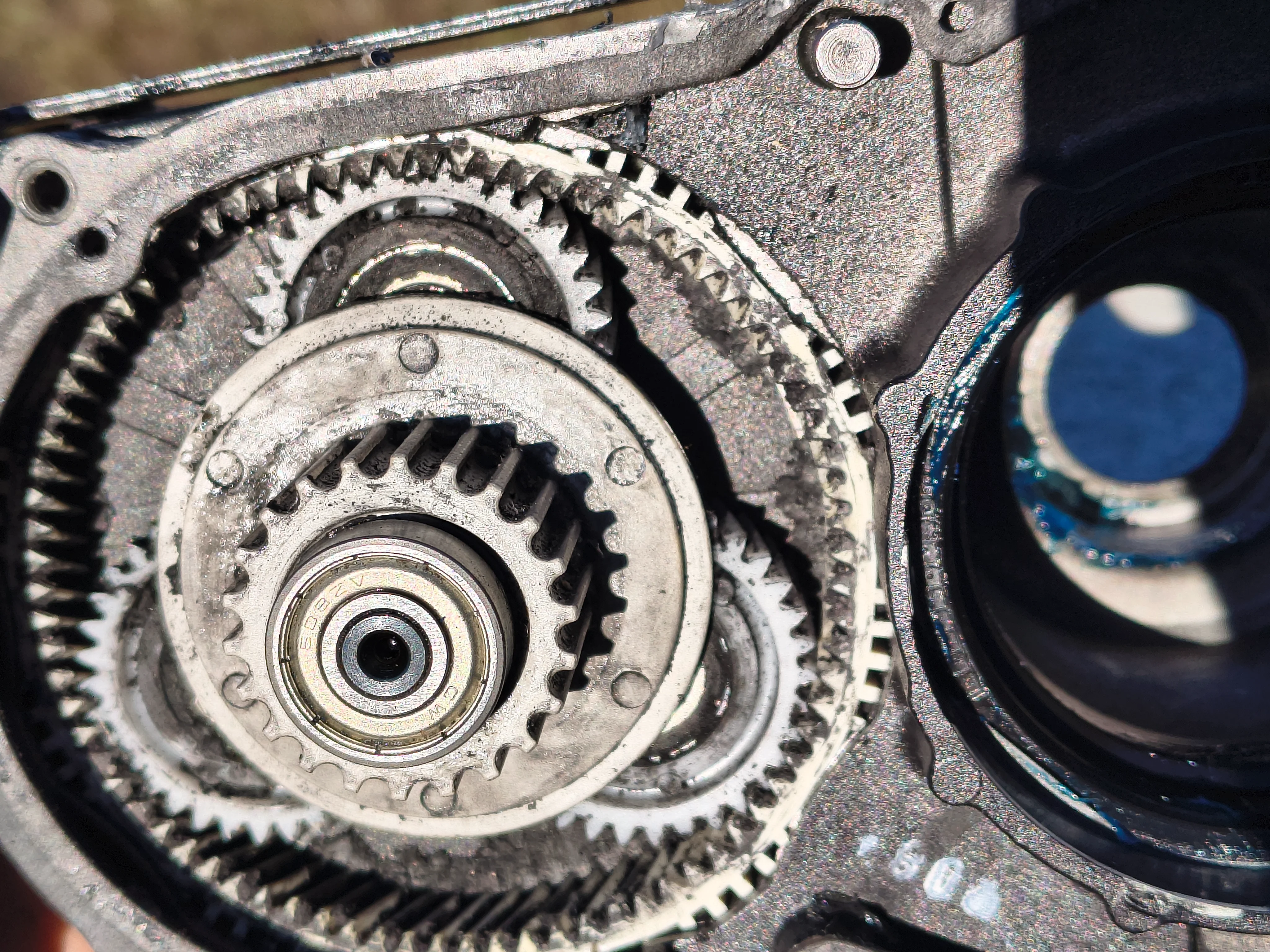

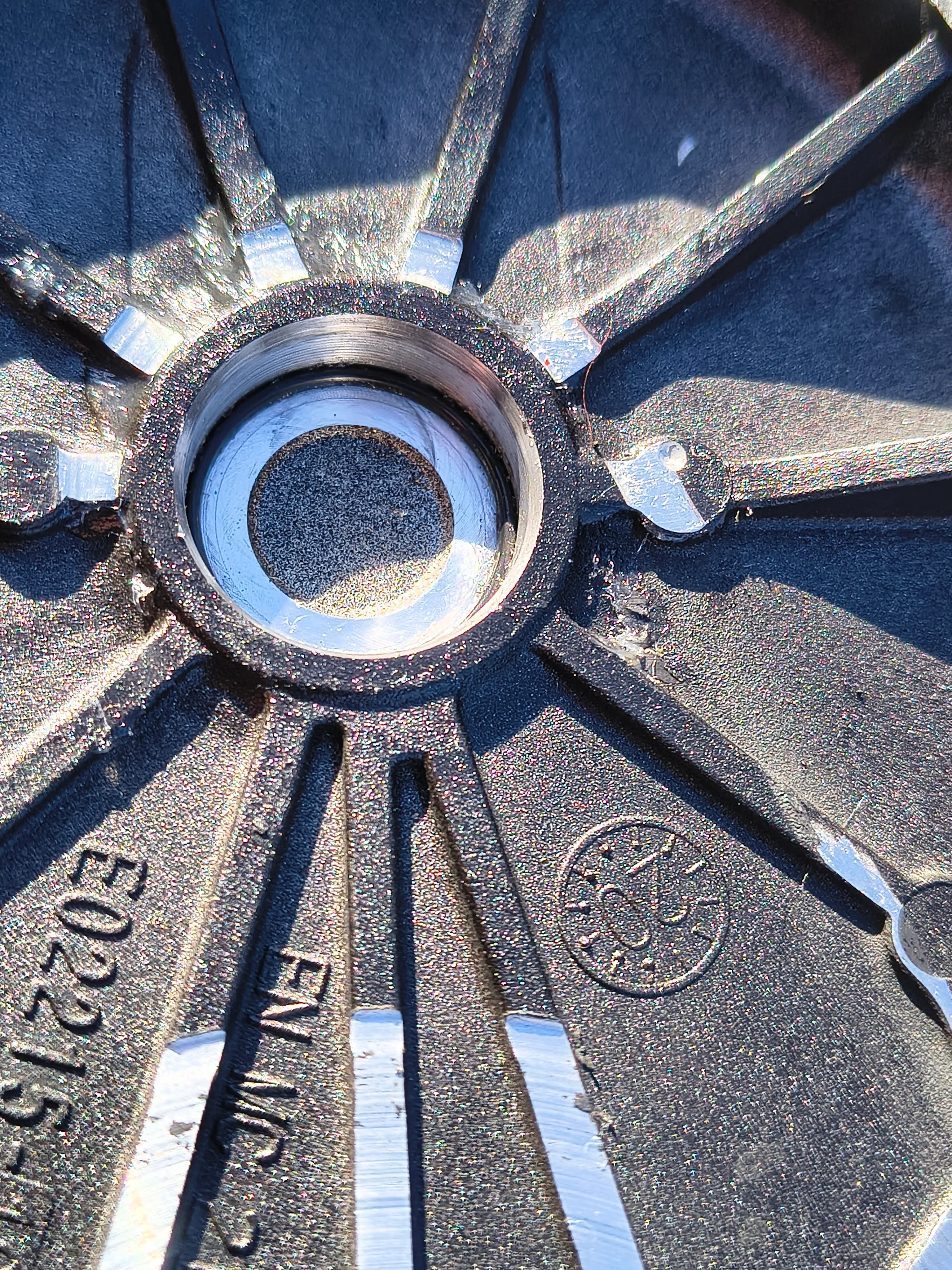

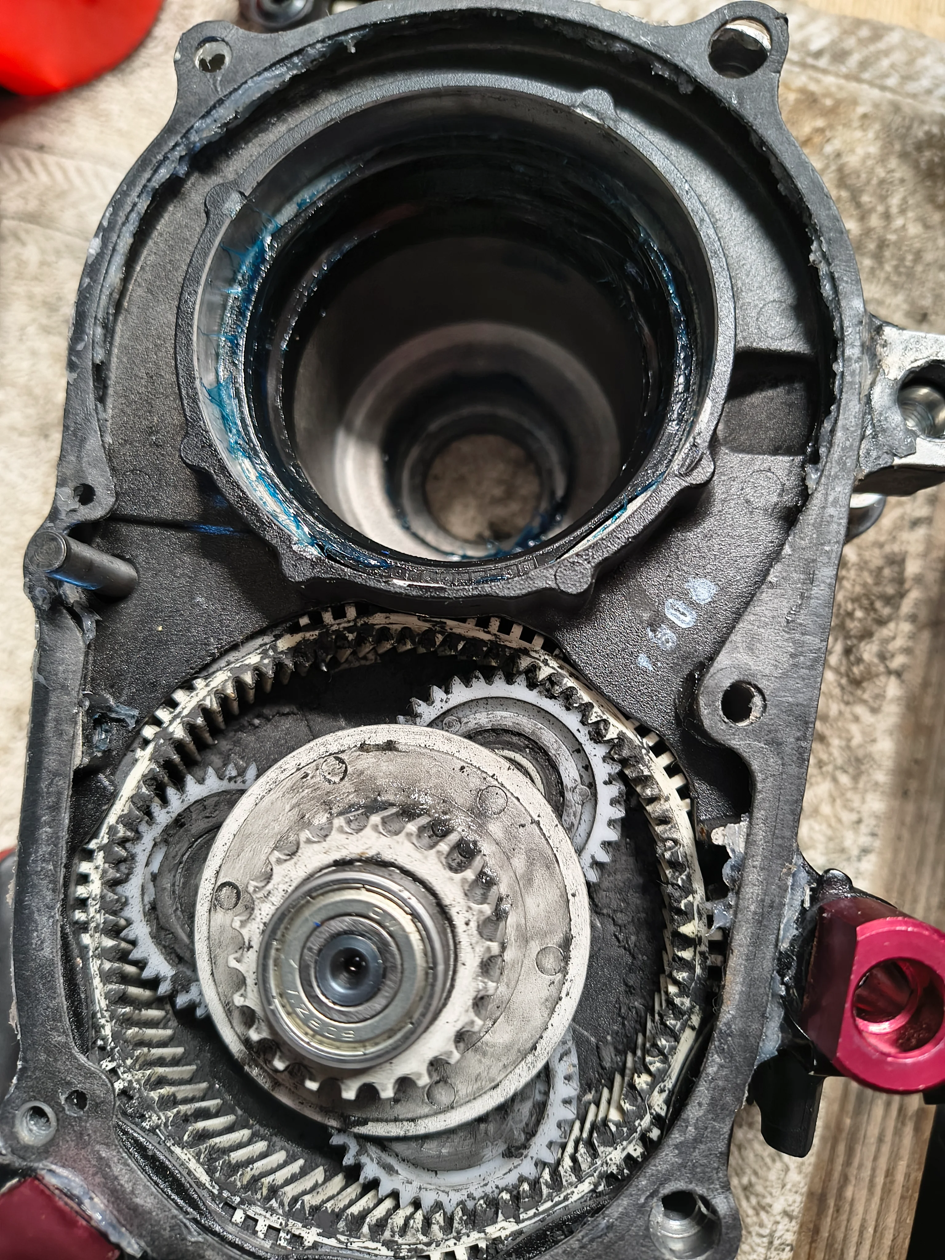

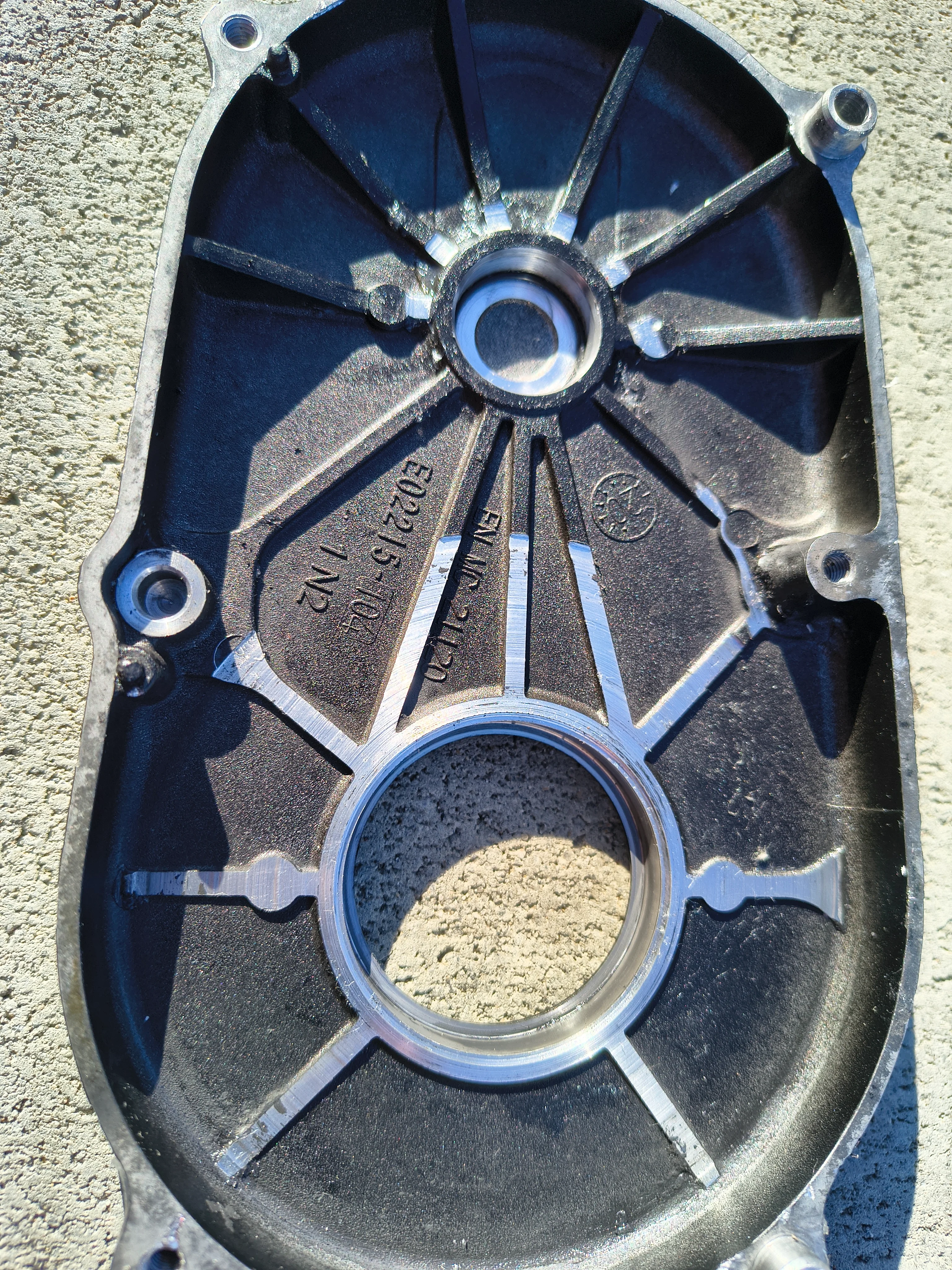

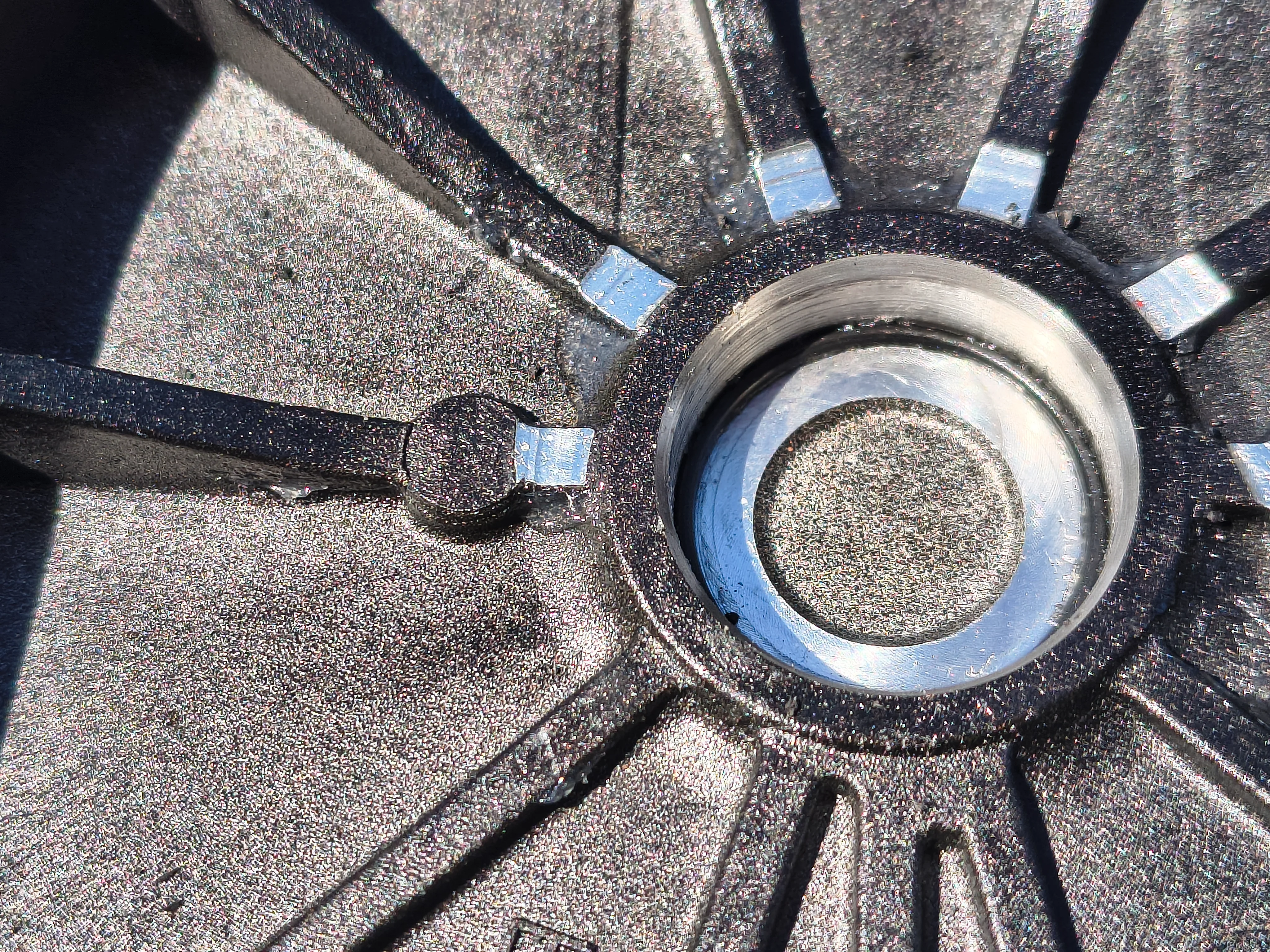

completely dead when I pedal 184304 184305 184306 184307 184308 184309 184310

Looking at your photos: The wear marks on the belt cover ribs you mentioned are consistent with a belt that's been running misaligned or under incorrect tension for some time - which can also indicate the pulleys weren't running true. Worth checking the pulley alignment visually once the cover's off again.
The torque sensor angle is now my prime suspect, especially given you replaced the crank bearing. Here's the specific mechanism:
